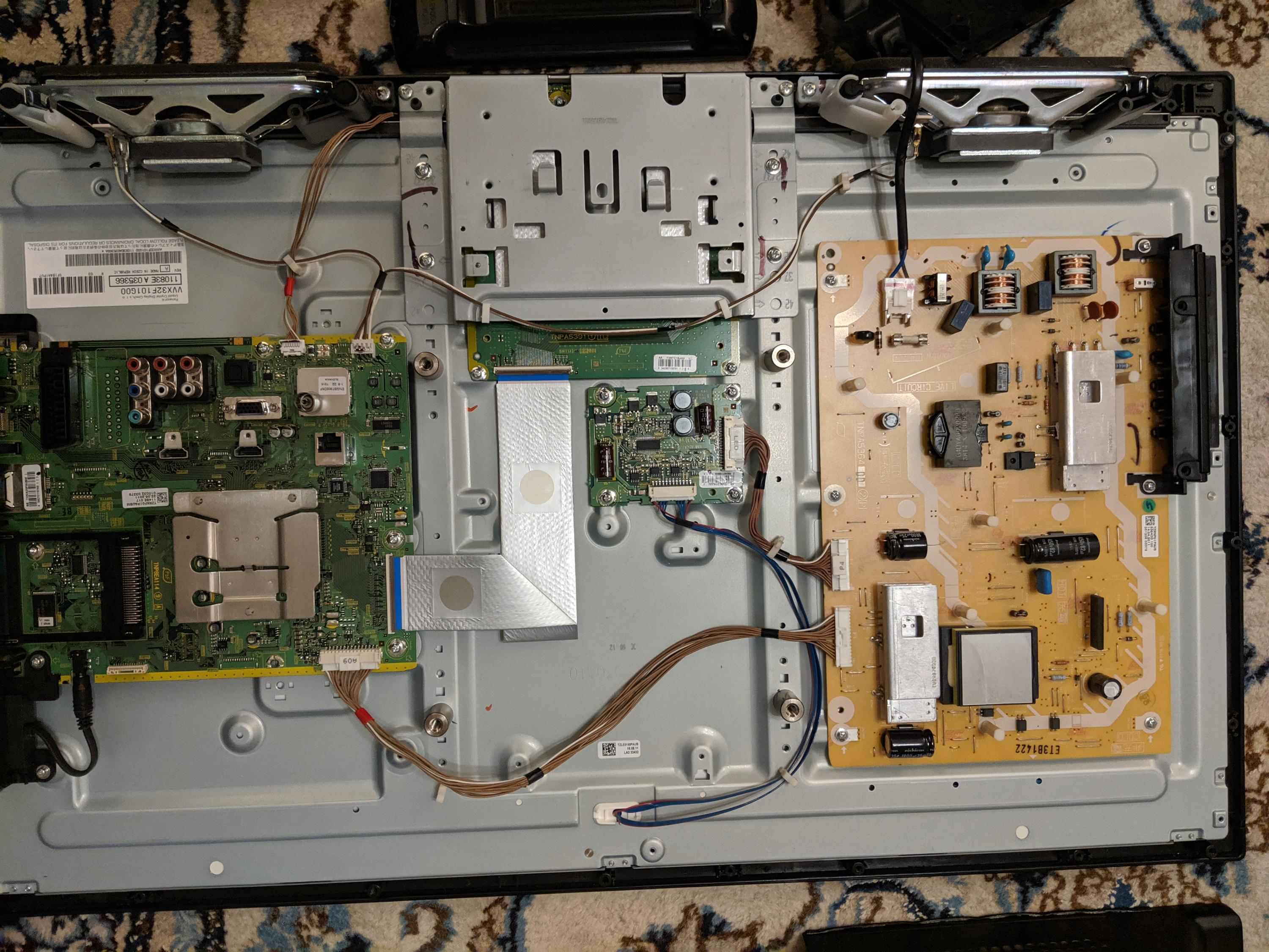

        Re: Panasonic Viera TX-L32E3B won't power up, green LED flashing
        It helps if we can see the boards and how they are connected together although looking at your voltages I'd investigate the backlights and circuitry as pin 4/12 is BL_SOS.
          I've uploaded an image in case that helps

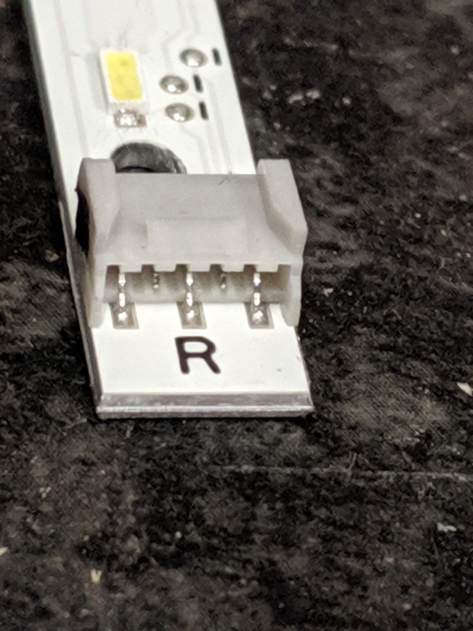

                    OK thanks. I have dismantled too many parts to test the LED strips using the TV power supply. Do you know approximately what the I-V operating point of each LED should be? I could connect each LED to a current limited bench top power supply. Does 3V limited to 10mA seem reasonable to light up each LED without damaging it?
                    Here's a photo of the connector - I can't see any problem with them.
                    • diif
                      • Feb 2014
                      • 6978
                      • England
                      Around 200mA to test the LEDs properly.

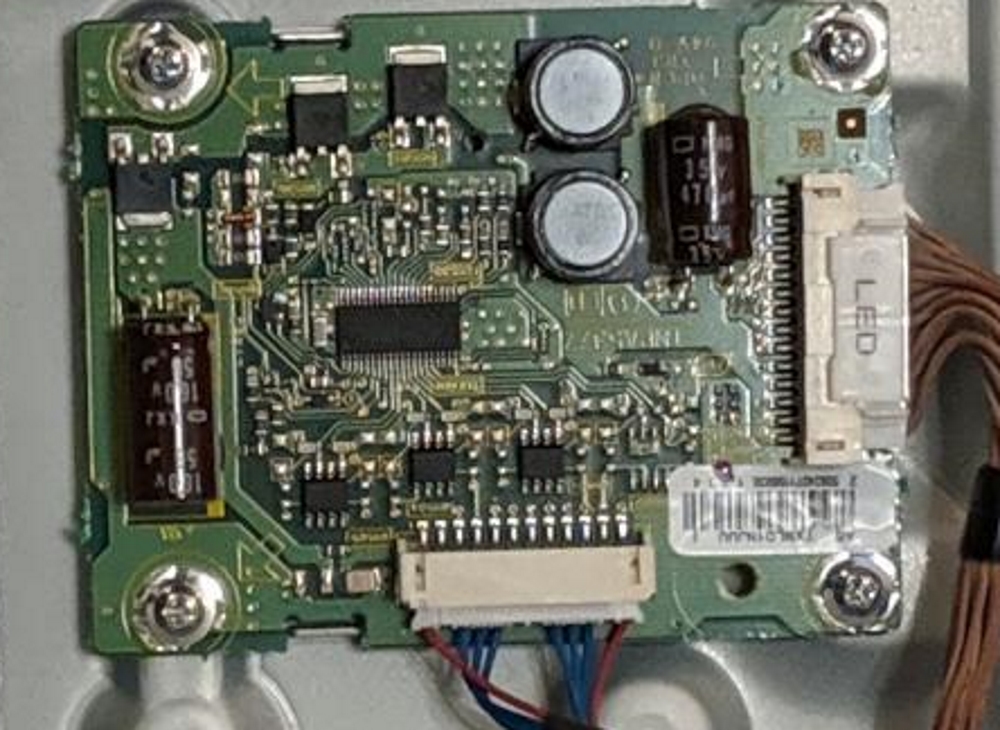

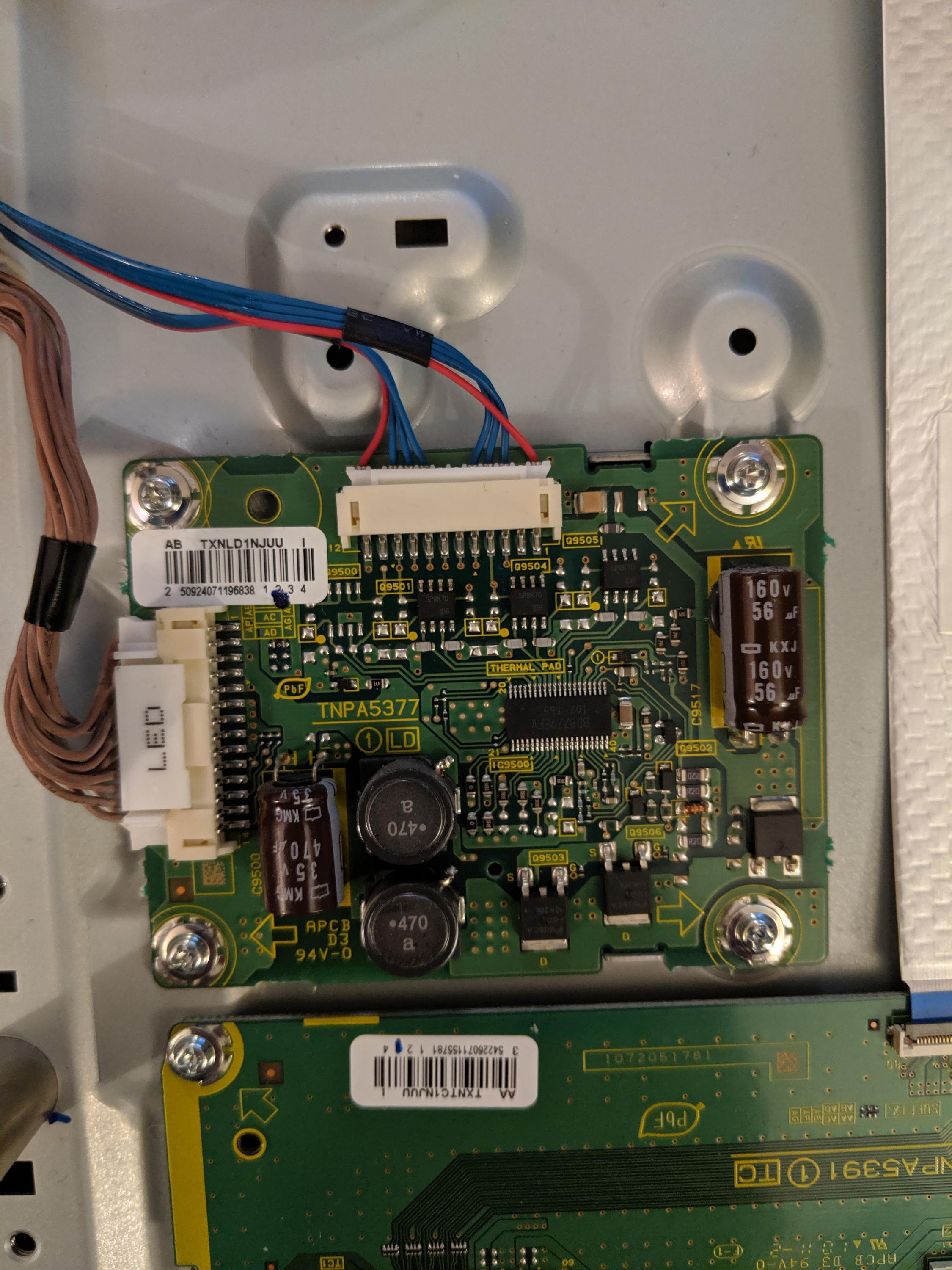

                              Can I see good clear straight shot of the LED power supply?
                              This panel has 6 LED strings, the two brown wires are the Anode of the 6 LED strings are tied together and connected to the LED Boosted Voltage power supply, the Blue wires are the Cathode return for each one of the 6 LED strings, each return wire is connected to the PWM controlled MOSFET for maintaining the constant current, there 3 Dual-MOSFET 8-pin chip right next to the LED connector. You need to keep black probe of the meter on the chassis and red probe on one of the Blue wire then turn on the TV to see what you get, then turn off the TV and repeat ehe same test on the other 5 blue wires.
                                Here's the LED driver.
                                Returning to the LED strips themselves, my bench top power supply only goes up to about 30V so I cannot test each string of 14 LEDs using 42V limited to 200mA. However I have tested each individual LED and they all work but the IV characteristic of the individual LEDs was very strange. I had to bias them with at least 5.1V forward voltage before they light up individually (with the power supply leads directly across each LED one at a time). The the current has to be limited to about 2mA otherwise they go dangerously bright.
                                Help! what's going on with these LEDs! I checked the voltage with a second meter and it's definitely correct.
                                  They are dual LED per package.
