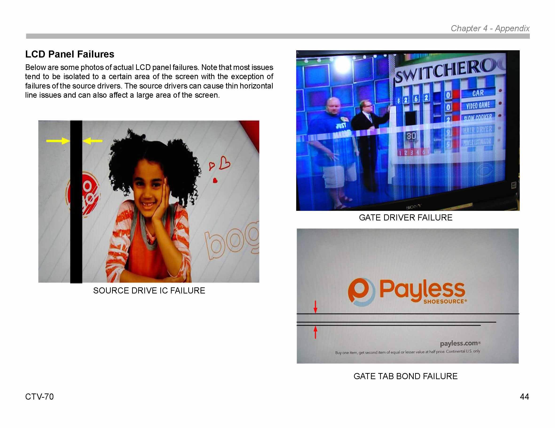

    I'm currently having some difficulties with my LG 42LV4400. It started the other day after I left the room and left my TV and Ps3 (connected via HDMI) on while doing some stuff. I had a pretty long session of Need for Speed going on. Went back in later and the colors were kinda weird (inverted looking almost?!) then the bar on the left showed up. The TV looked kinda washed out with a smokey grey then I turned it off for a while and the smokey grey left but a black bar appeared in the middle. I took some advice and cleaned the ribbon cable connectors and nothing happened. Any help or suggestions would be great.

    The black band looks like it has dead TFT driver IC which is part of the LCD panel which is not replaceable.

      Not replaceable? So unable to be repaired in anyway I assume. Well damn. Thanks for the heads up on the problem. Now I can look forward to a new TV purchase.

        You need new panel, I would sell the boards, speakers, stands, remote on EBAY, look at shopjimmy.com to get some idea how much your parts are worth.
