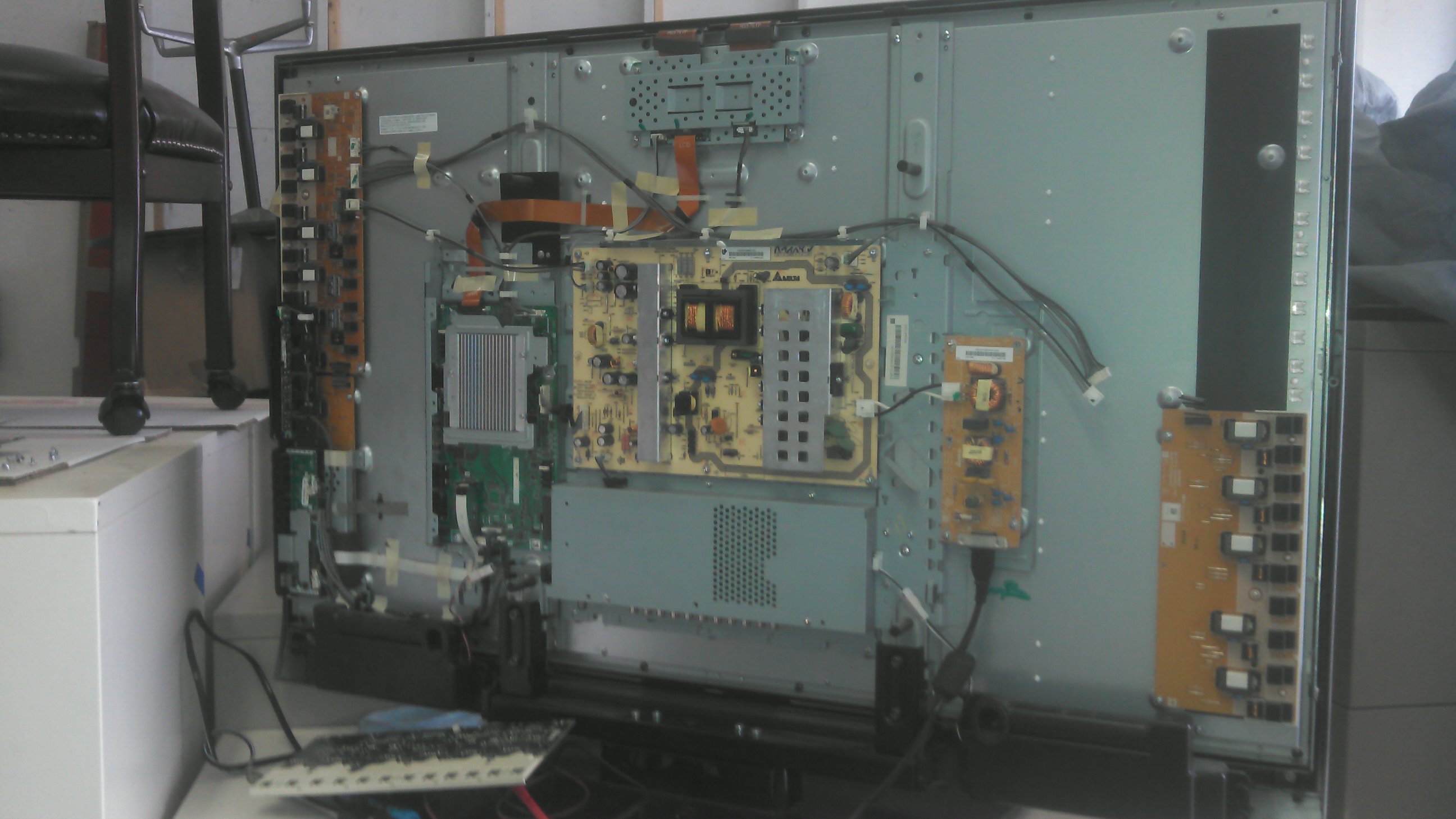

    Initial symptom - no action but constant 1 second interval of blinking green power light.
    Found reset sequence and green power light was constant for maybe 10 seconds then set would "click" off. However, before dying, screen would flash about 6-8 times. Fairly uniform.
    Disconnected 60V/12 V power leads to the inverter boards and using reset power would stay on. Hit the on/off button, set would shut down in a controlled manner and start back up when the on/off button was depressed. By start back up I mean the two red lights on the main board would flash.
    When reset and on, I plugged the right side inverter boards in at the inverter board (three wires from the main power board) and a flash at the connector was seen and instant shut down. Repeated routine for left side (right side disconnected) and same.

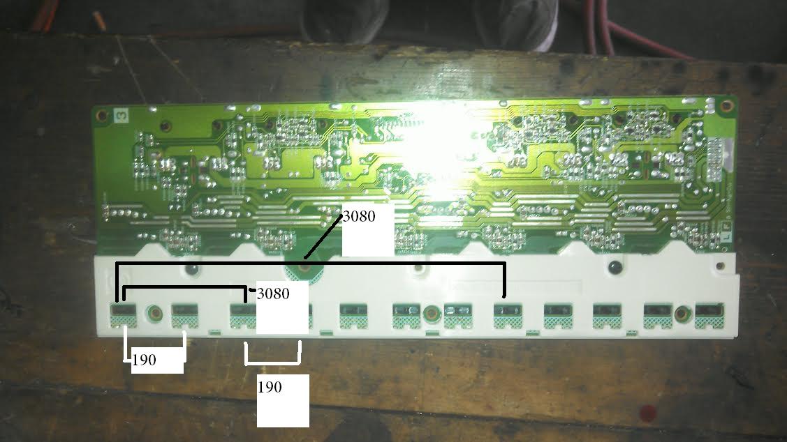

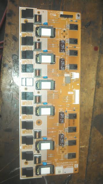

    Pulled inverter boards, farted around in full layman style with an ohm meter and found nothing weird.
    - mosfet thingies (noob here) were all consistent when 4 legs were tested among each other. Two of the four connectors had full continuity, let's say #1 and #3. No other hint of internal breakdown. All were consistent.
    - Transformers were all consistent. Around 190 ohms.
    - Single fuse on each side - top inverter board - had continuity.
    - Resistance among all board lamp contacts was the same - 3080 ohms - unless I tested a pair that were associated with a single transformer. Then resistance was 190.
    Put boards back on but left them unconnected from lamps. Plugged in, all is good (main board two flashing lights) Pushed inverter boards onto lamp connectors after five minutes and nothing happens. It does not die but no flashing screen.

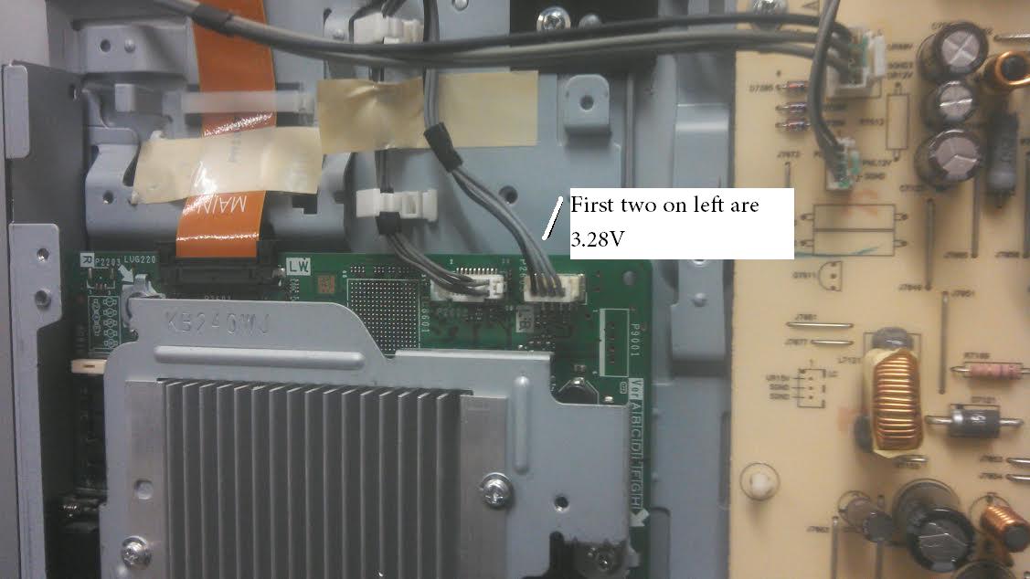

                            There is one cluster of wires that lead to the master inverter board from the main board. Four wires in total. One black, three grey.
                            The black wire and one of the grey wires feed 3.28 V to the inverter board. When I press the primary on/off button to on (with the DVD player on and playing), It takes a few seconds to spool up the voltage, but once hitting the 3.28 V, I can hear the audio and the screen flashes with DVD video observable.
                            It is steady once the 3.28 is achieved.
                            Edit: Please advise of add'l pics you may require. I am thankful for your help.

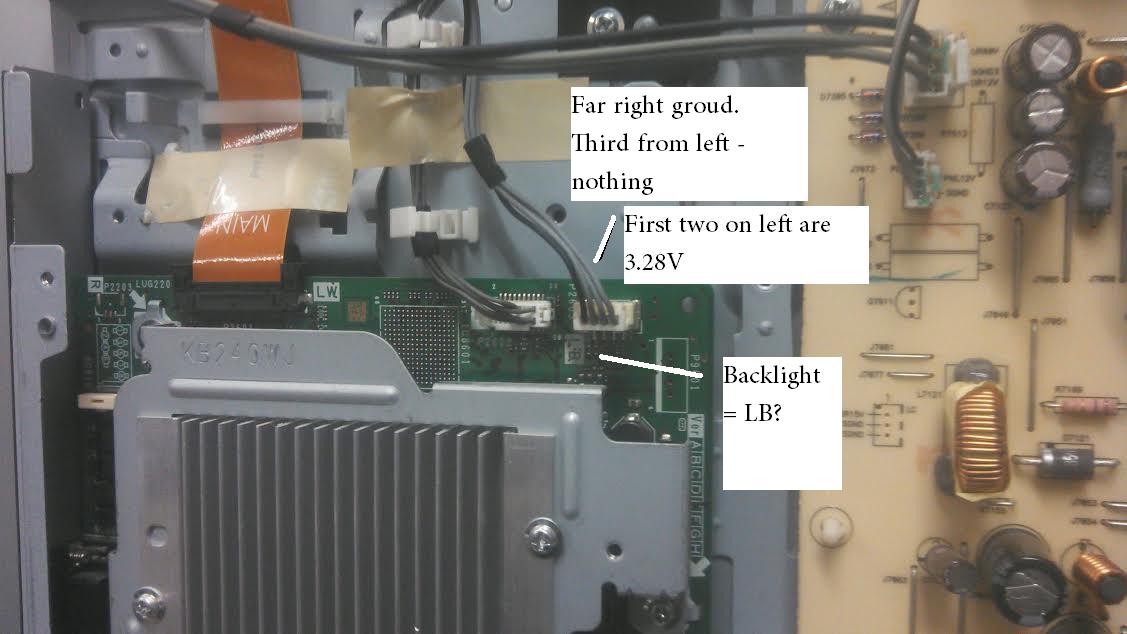

                              I am assuming the two wires that I found voltage from the main board to the master inverter are the what turn the backlights on.
                              Would there be an indication on the main board of what BL on/off is?
                              Of the four wires (main to inverter), one grounds to the case, two have voltage, and the fourth, I find no voltage or ground.

                                There are letters "LB" on main board is this BL?
                                • Bob Kontak
                                  • Dec 2013
                                  • 25
                                  Re: Sharp LC 46D64U Screen flashes then dies
                                  Anybody?
                                  • johnboy1313
                                    • Nov 2012
                                    • 1959
                                    It looks like LB is the connector designation.

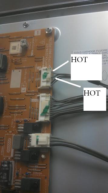

                                        From main power board there is one set of wires that feeds the left set of inverters and one set of wires that feed the right set of inverters.
                                        Their voltage appears to be ok.
                                        From the separate main control board, The LB connector mentioned, two wires of four feed 3.28V to the master inverter board. Is this enough power? Is there a minimum it requires? If so, say 12v, I need to look upstream vs downstream.
