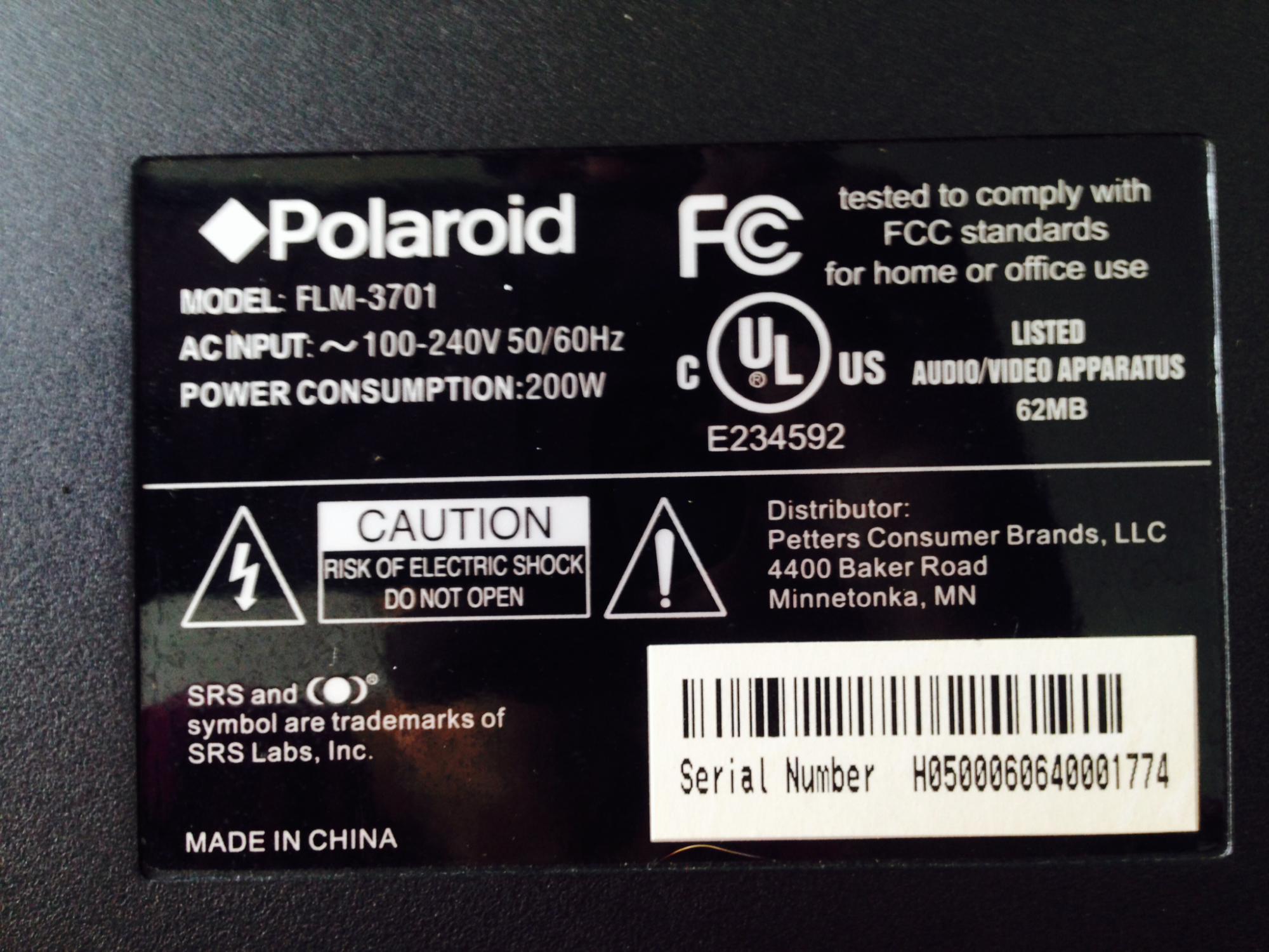

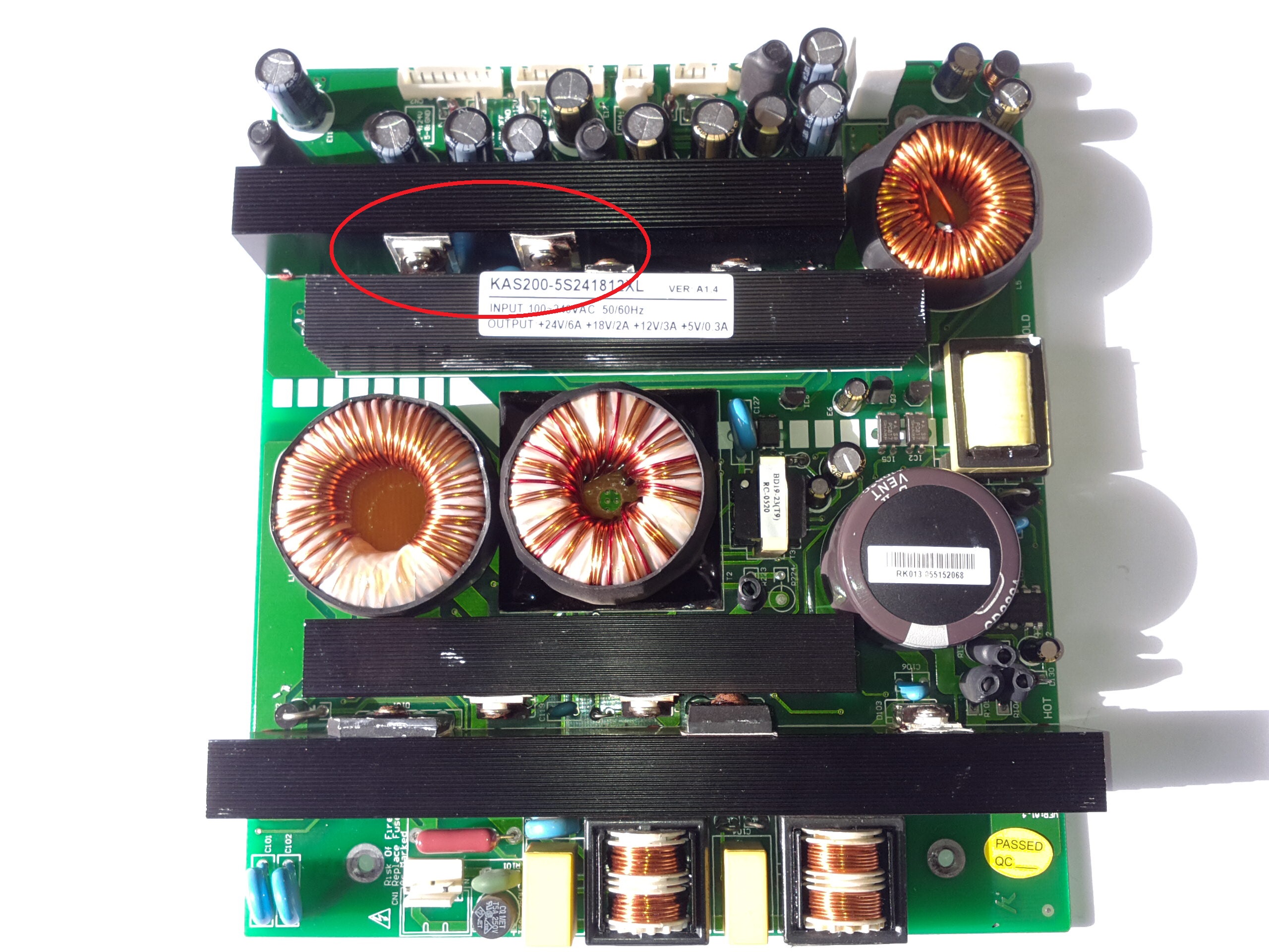

    This unit is a Polaroid FLM 3701 (monitor only / no tuner)
    Build date 2005

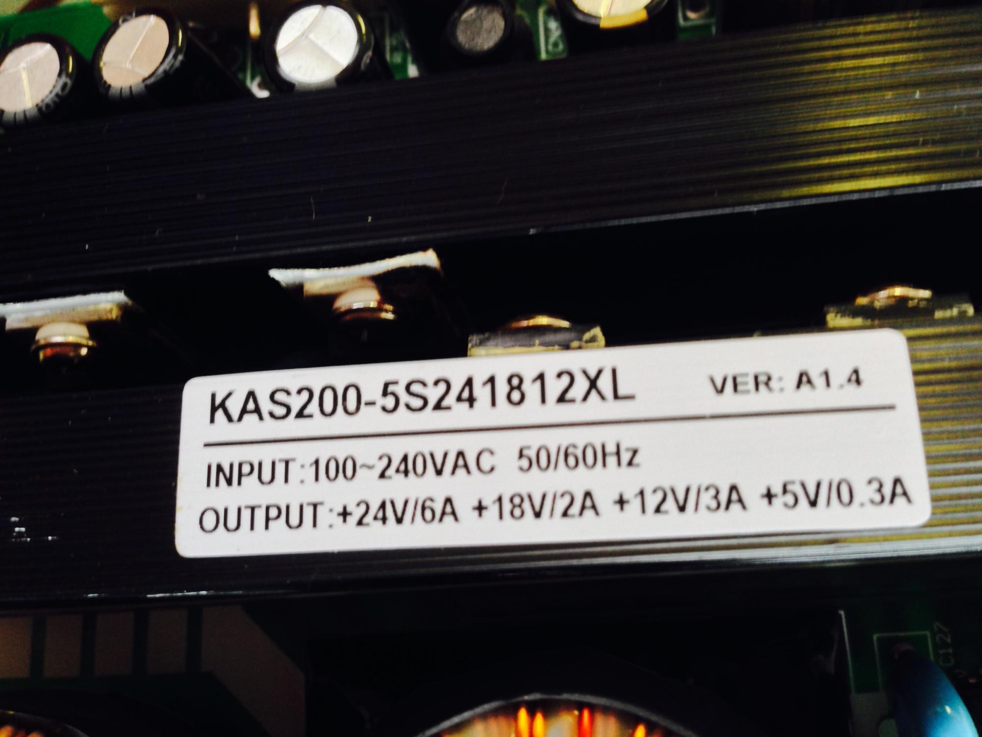

    It utilizes a KAS200-5s241812xL Power Supply (LC-37K7)
    This thread is a carry-over from a blown PFC Film Cap (474k 450v), which has since been solved.
    BACKGROUND:
    Came home one day after a really bad lightning storm = TV won't turn on.
    No power - no red/blue lights - dead.

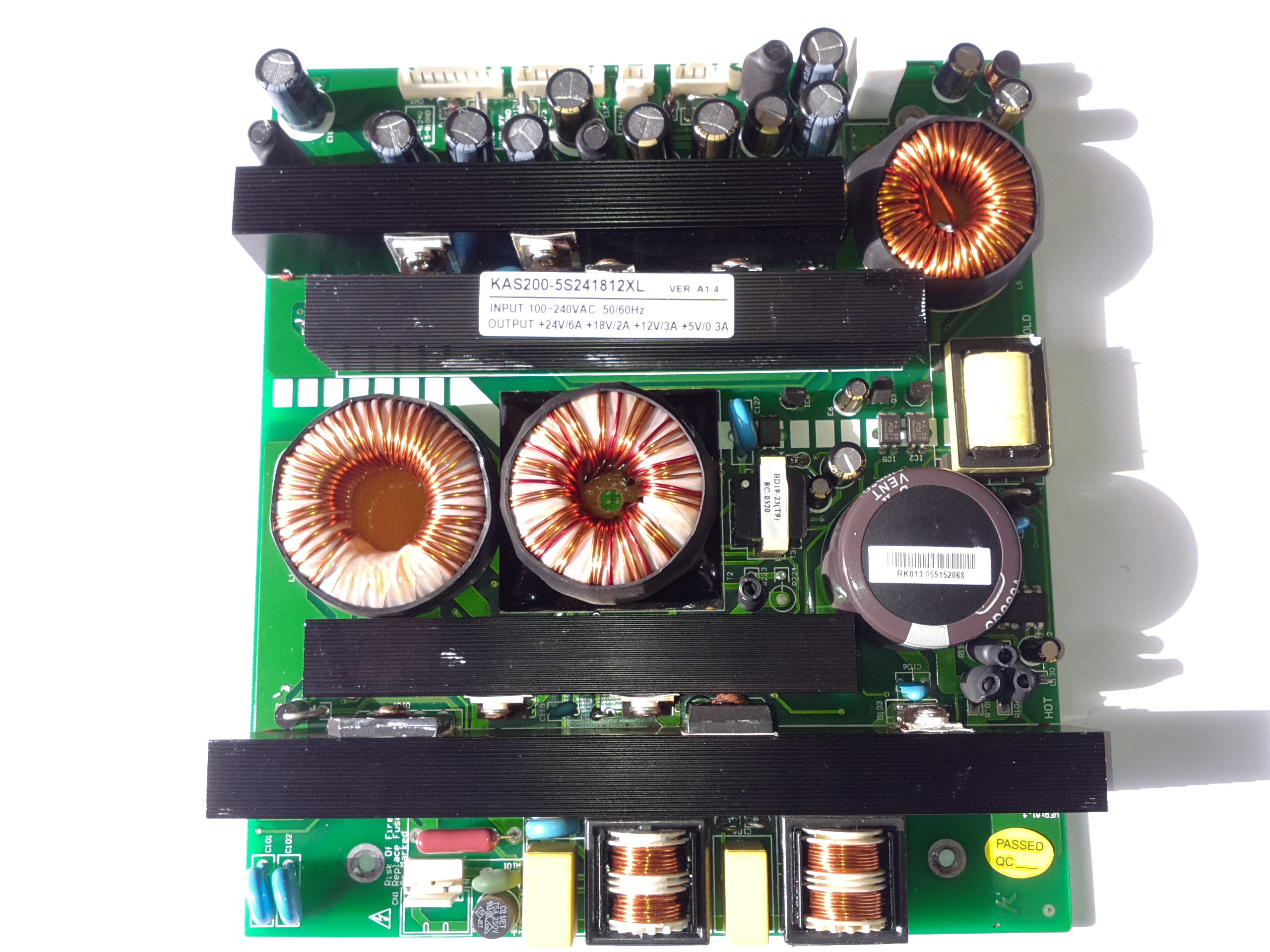

    Pulled out the Power supply board and replaced all the Caps with new ones from LCD Alt.
    All but the 450v 150uf large cap - extremely rare to go (as I've been told).
    During repair found the PFC 474k 450v Film Cap at the input of the power supply was melted.
    After lots of help from others here - I found a suitable replacement.
    The 5vdc standby power has now been restored to the set, and the red standby light illuminates (problem solved).
    Progress.
    Which brings us to TODAY:
    The P/S is still producing very low or no output voltage during the power/on command.
    24v only generates about 18v before shutdown (3-4 secs.)
    18v only generates about 12v before shutdown
    12v only generates about 0.7v before shutdown
    Since there is a 5vdc standby being sent - and -
    a 5volt return signal from the CPU (power/on) command switch,
    I'm assuming that the problem still lies within the Power supply boards ability to generated the regulated voltages.
    Without an accurate diagram, theoretical application is only getting me so far.
    Anyone have any thoughts or ideas ???

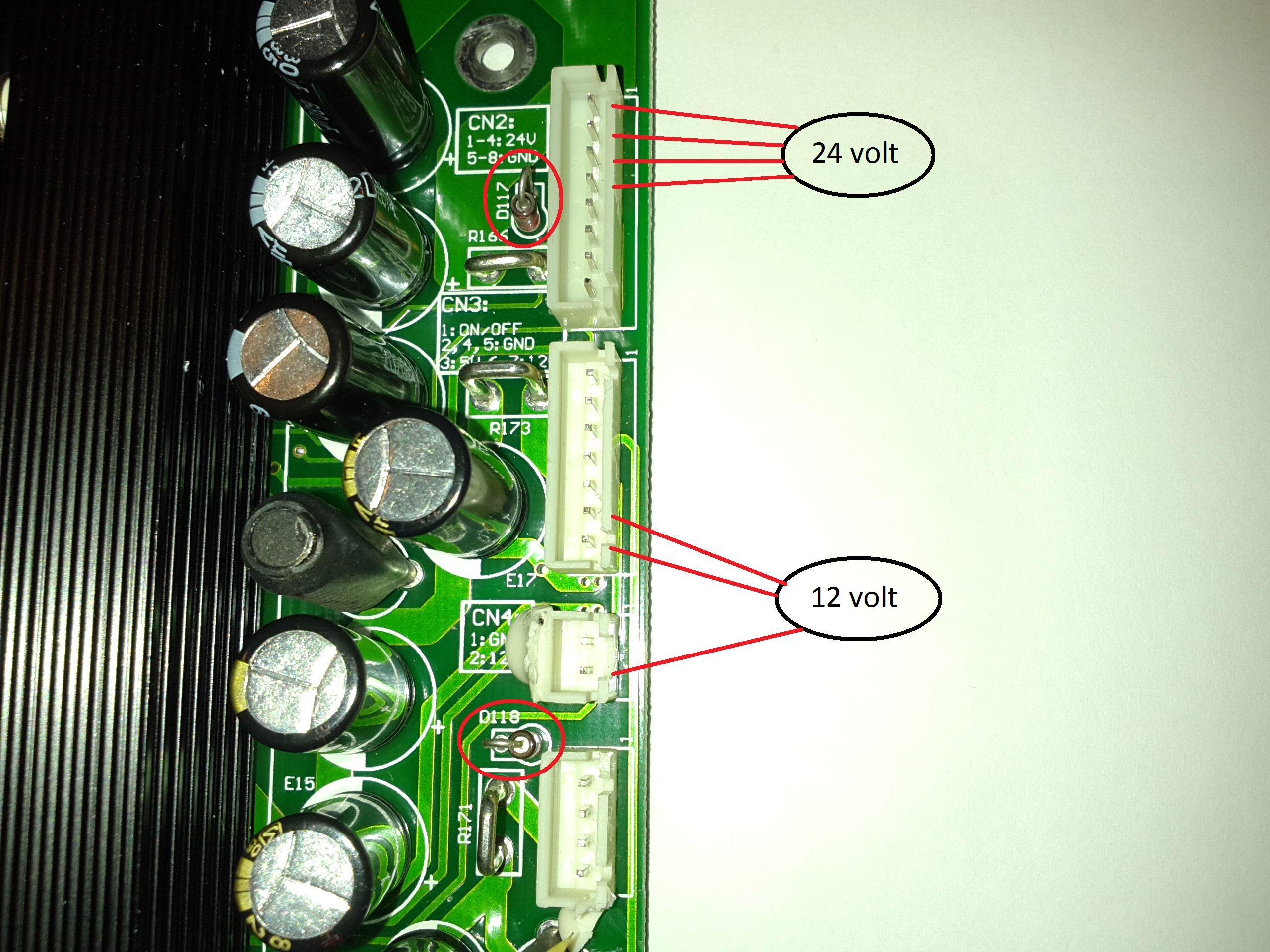

    Since 12V is so low, I would check the diode for the 12V output, and see if it is shorted.
      Re: Polaroid PSU output power
      Thanks for the help Tom66.
      I'm assuming the diode for the 12volt is the D118.
      I pulled it out and it tested good (about 750 & infinity).
      I also pulled out what assume is the 24volt (D117).
      It tested good as well.
      I may have to start pulling out the transistors.
      The upper casings where the screw hold downs are (to the heatsinks) appear to have melted. Not sure if that is actually affecting the integrity of the current flow.
      Nor am I sure which transistor is operating which leg of the supply.
      Any other help you could provide would be great,

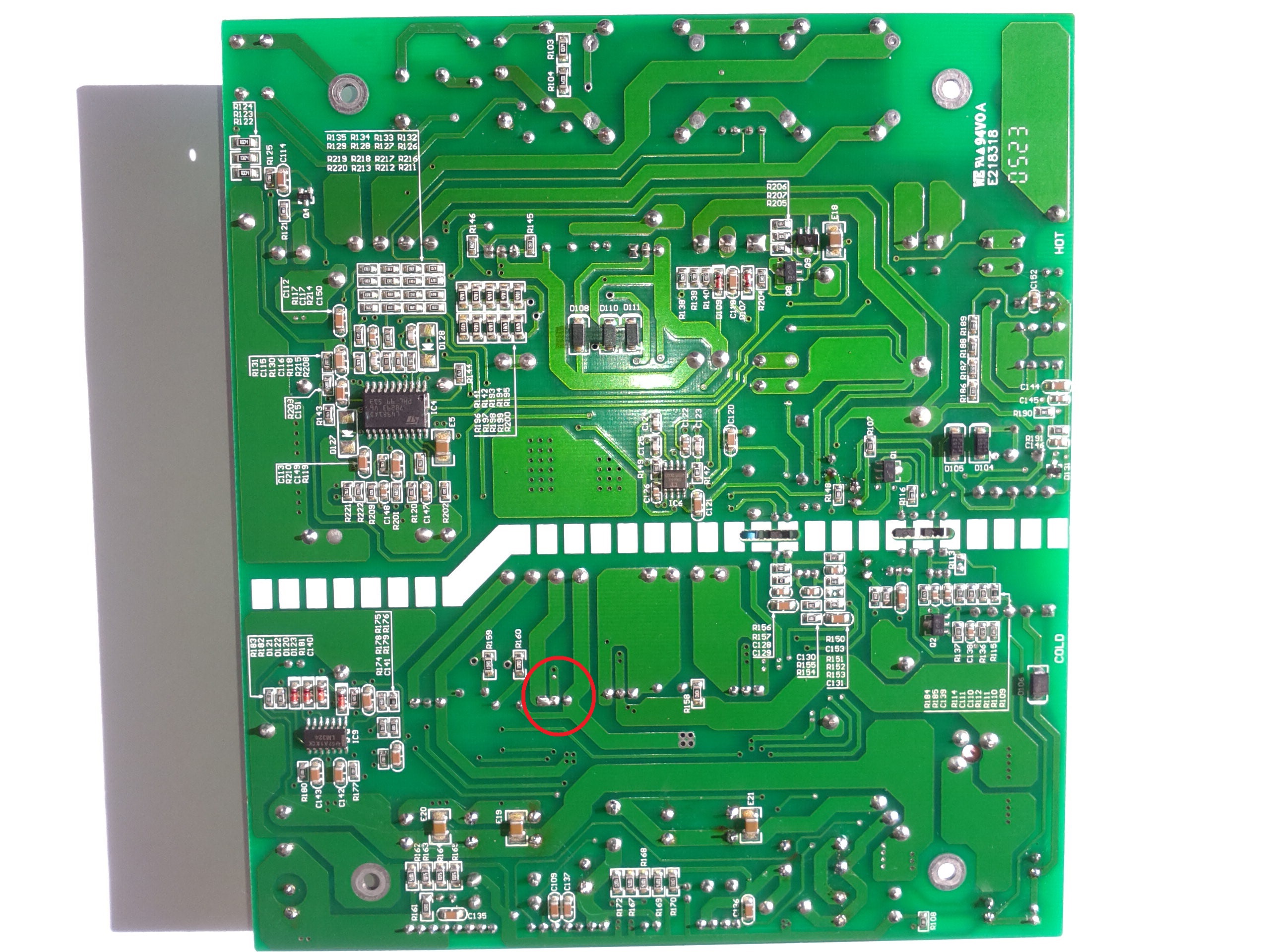

        Just found this on the D116.
        It is the flip side of the transistor on the right of the last picture highlighted.
        None of the others appear to be like this - they all have good clean solders.
        I'm not sure if this a factory designed bridge (?) - or the result of a power surge melting the solder into it.
        Any thoughts ???
          Success !!!!
          That was it.
          I put a soldering wick on the bridge and eliminated it.
          Powered up the set --- and full function !
          A year and a half and 25 bucks later - it lives once again
          Thanks to everyone for helping.
          On to the next one

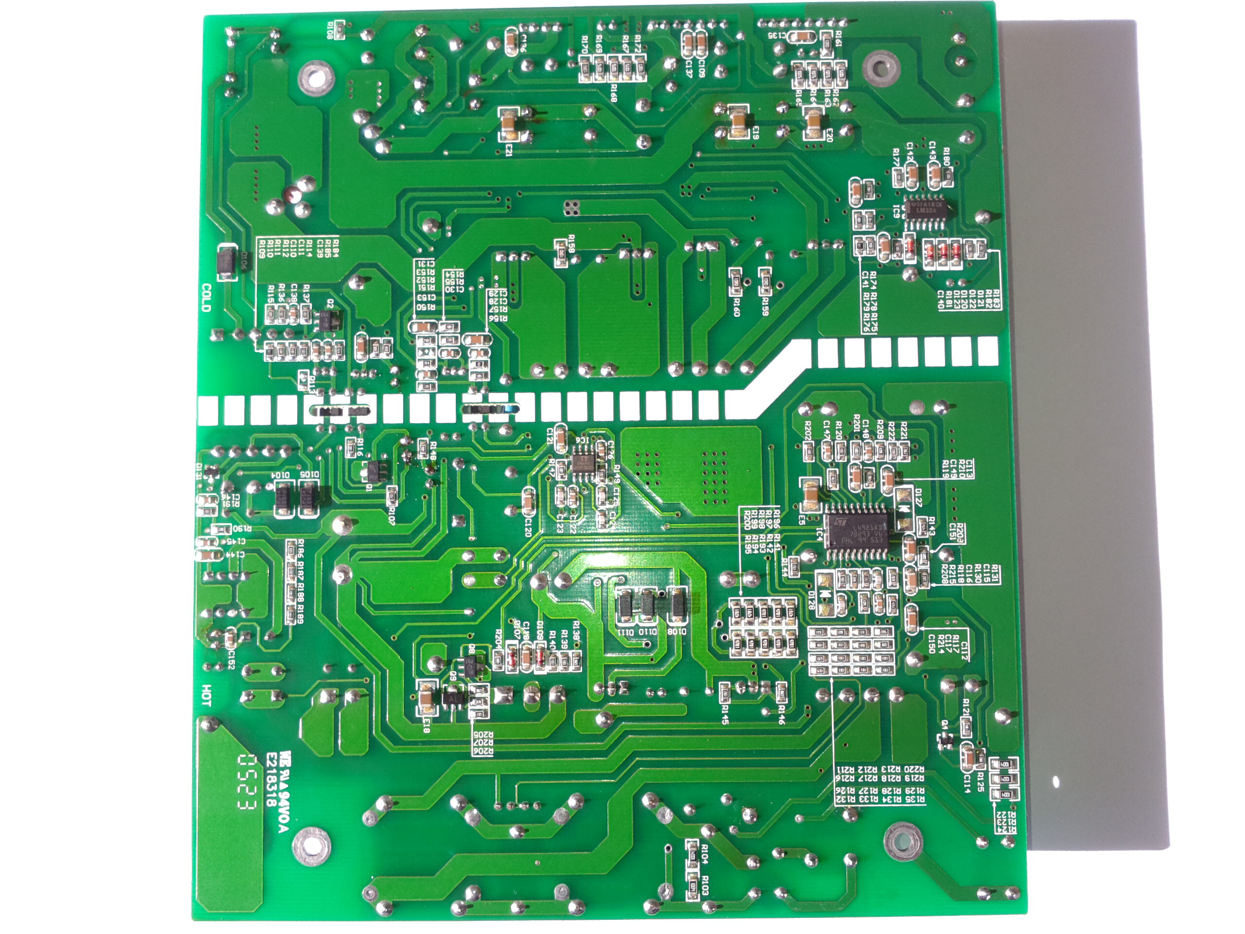

                            Great site, I just joined.Anyone know where the find a schematic with voltages for this power supply. ine is dead across the dotted line.
                              Add I replaced all 6 of the 680uf caps because they were rounded on the top
                                whats the exact power board numbers so we can see if we can find a schematic for it.
                                  kas200-5s2418112xl
                                    I guess my big question is what carries the voltage across the dotted line on the board. all the test points on the 110v side have power,everything on the slave side is dead.Looks like the only bridge components are a cap, a xformer. three tiny square thingies with 4 legs (technical term),and a coil.Trying to back trace to a dead part.
                                      kas200-5s2418112xl
                                      schematic i think.
                                        Your power supply is just like the one as shown in post 3?
