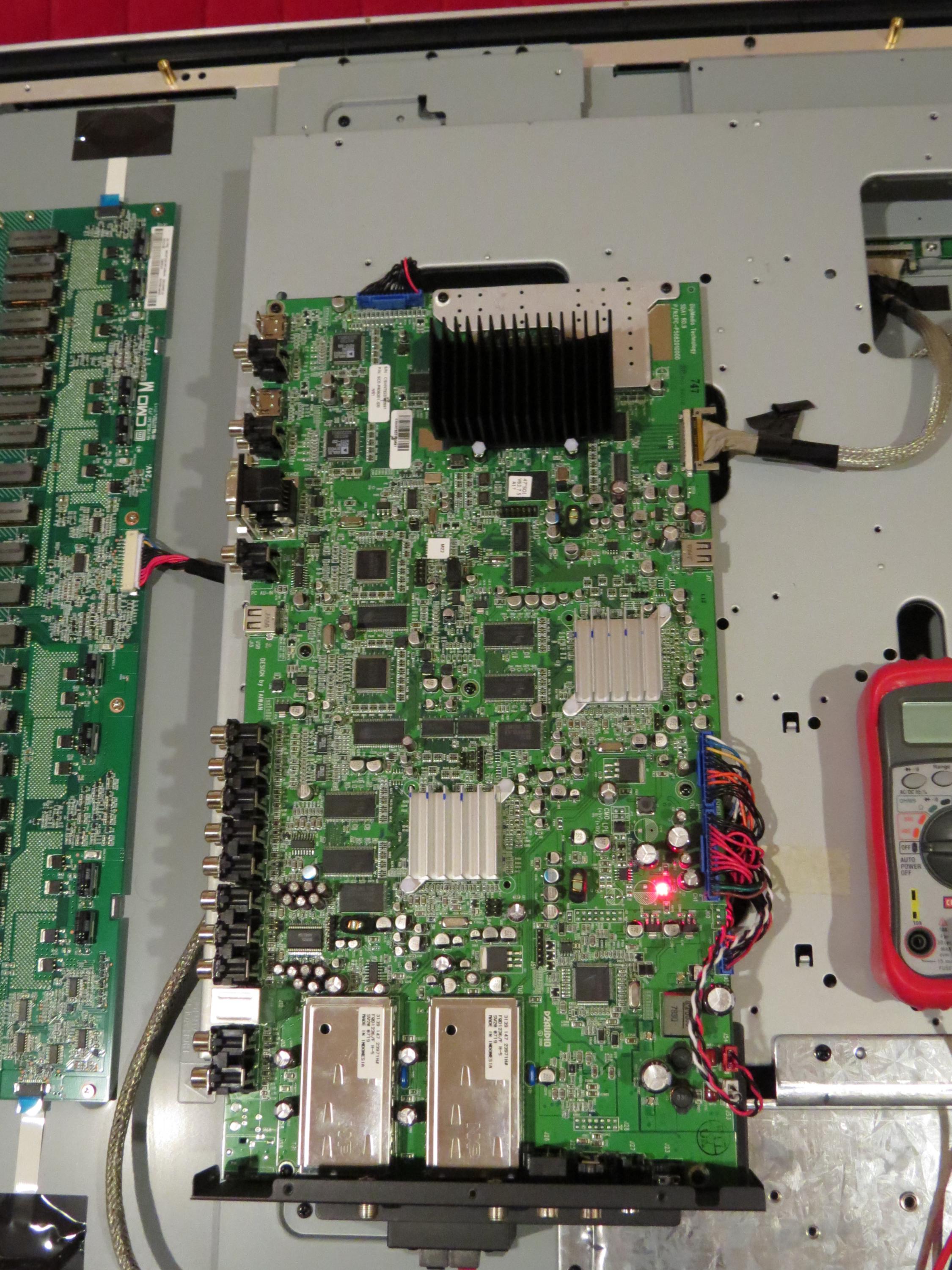

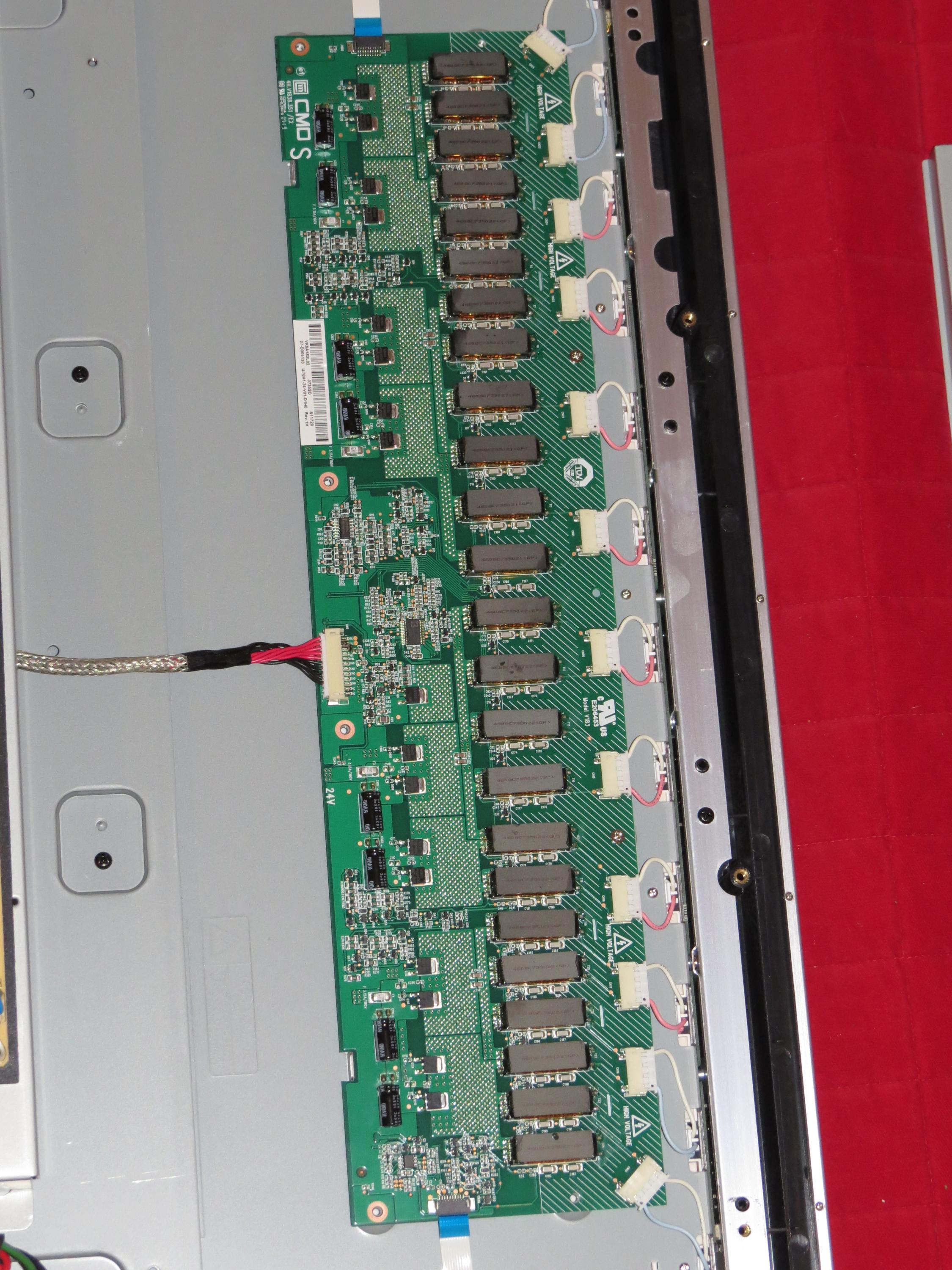

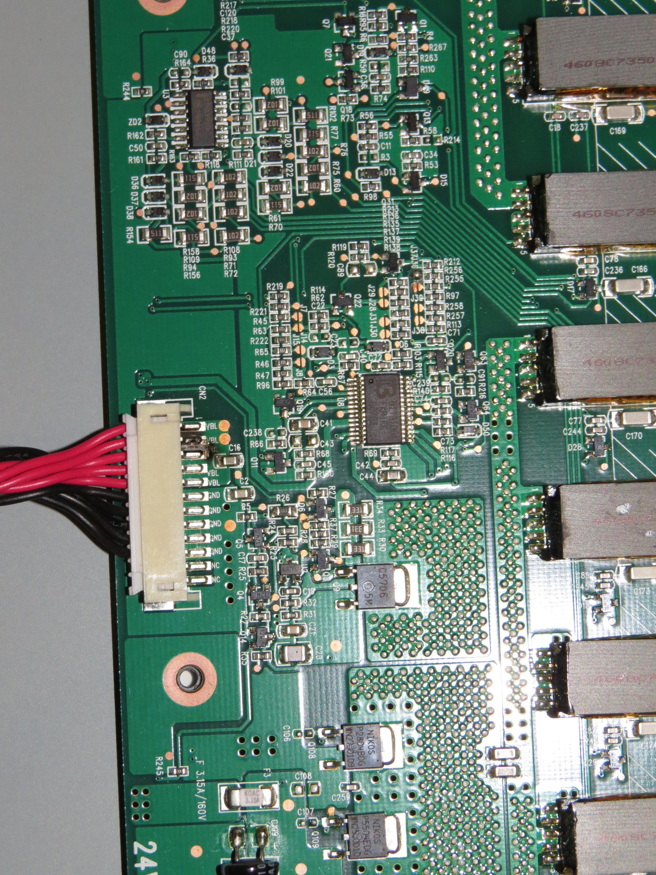

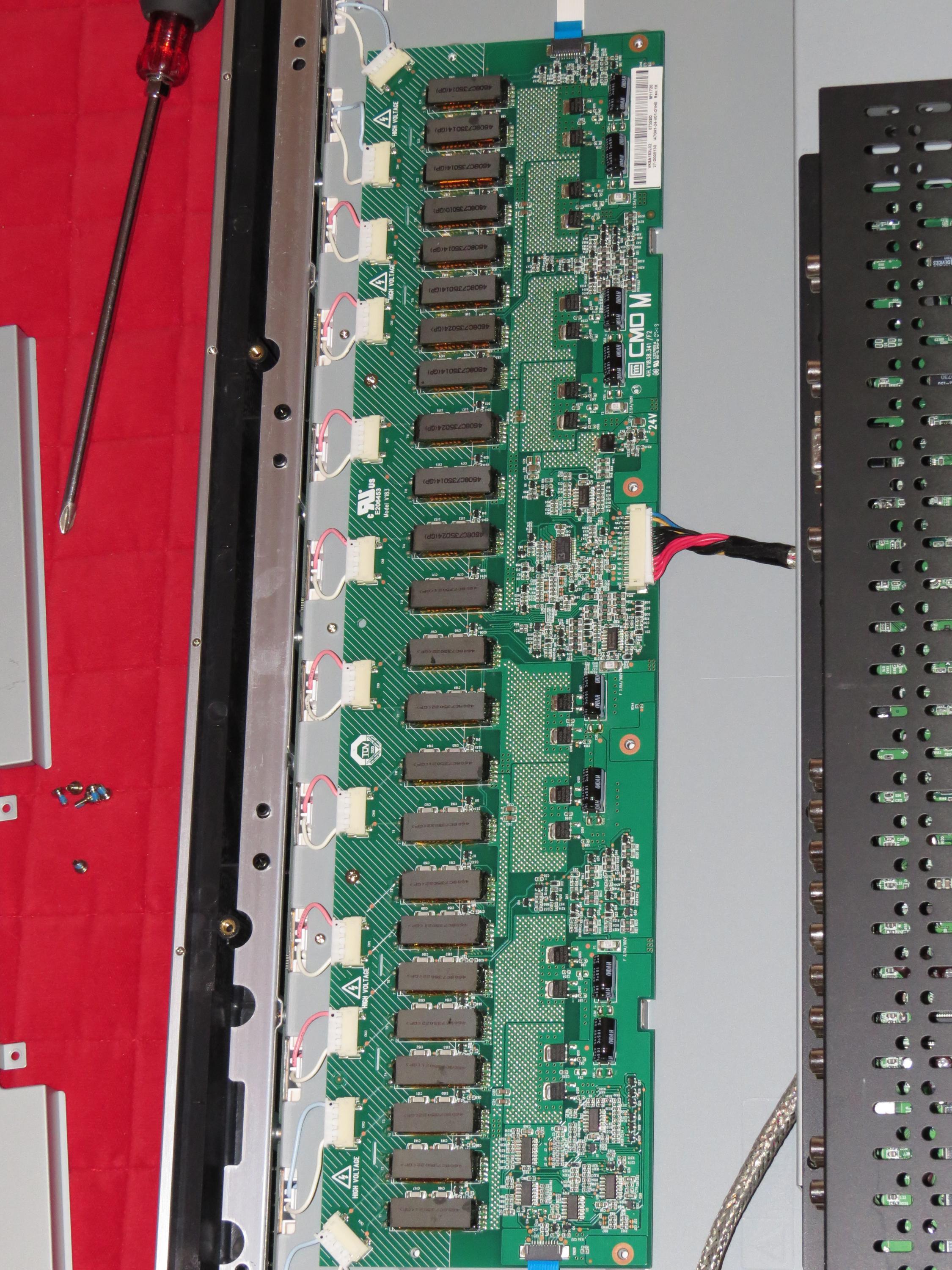

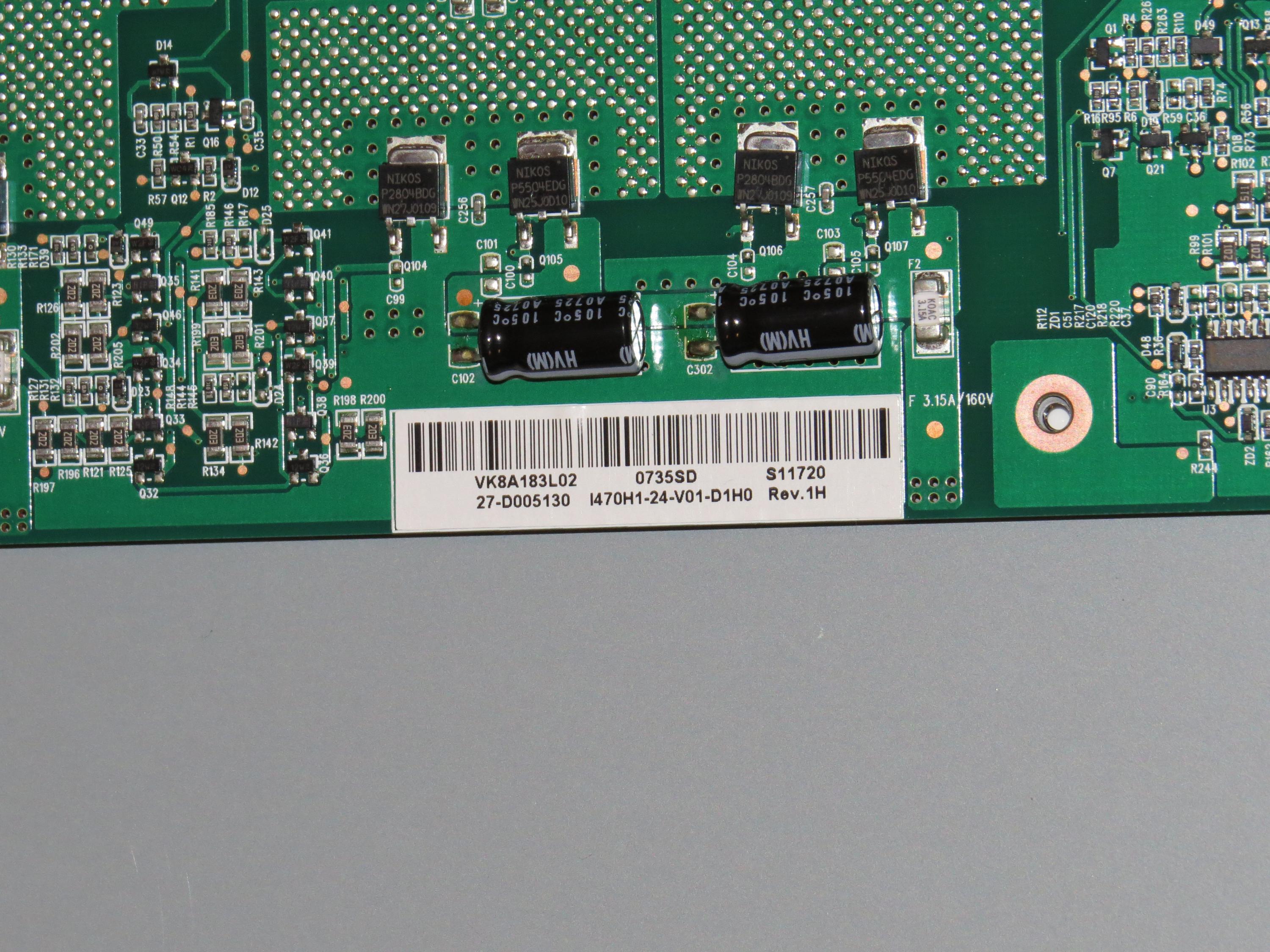

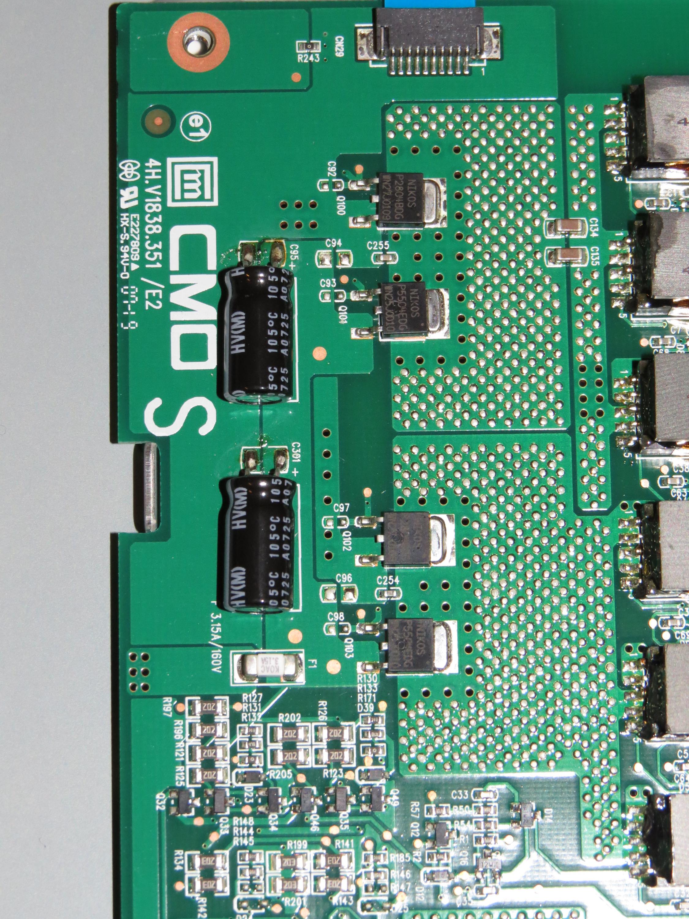

    OK, finally moved the piece and removed the covers from the side boards.
    Photos:
    - right board
    - left board
    - zoom in on right board of one of 4 seemingly identical blocks
    - zoom in on the middle part of right board
    - markings on the right board (I guess the left board is the same)
    I am not seeing anything that looks obviously damaged or burned. What should I check next? Thx

      Re: Olevia 747-b11 power on, screen dark
      Your 4th picture of the power connector going to the inverter has a burn mark.
            OK, put all the screws that you removed back into the board mounting holes so the boards will be properly grounded (shields still remove), also seat all the connectors back in place properly.
            Did you check all the fuses on both boards?
            The master inverter has yellow and blue wire, they are for BL_ON and Dimming control signals. Take the DC voltage readings of those two pins when TV is off and when TV is ON, chassis as the ground ref. point.
            Notes: I cannot read the labels for the Yellow and Blue wire to figure out what the pins names are. Closed up pictures on the connector needed.

              Right board conn labels:
              Red X 5 = VBL
              Black X 5 = GND
              no wire X 2 = NC
              Left board:
              Red X 5 = VBL
              Black X 5 = GND
              Black = VSEL
              No wire = E_PWM
              Yellow = I_PWM
              Blue = BLON
                  Both blue/yellow measurements to be taken when the set is off and on.
                  You may need to clean your meter probes if the reading jumps.

                    Between yellow and blue:
                    TV OFF: 0
                    ON: 11.6 mV
                      #30
                      The measurements should be one between yellow and chassis (red on yellow, black on chassis), and one between blue and chassis. For both ON and OFF states.
                      • ilyaz
                        • Nov 2013
                        • 20
                        #31
                        OFF: Blue 51.4 mV, Yellow 51.3 mV
                        ON: Blue 37.0 mV, Yellow 48.6 mV
                          #32
                          OK, all the boards are connected? If that is the case, the main board is not sending either BLON (Backlights ON), or Dimming signal. The meter is set to DC?
                                  BL_ON > 2V (it can also may be >3V depends on circuit design) = ON, <1V = OFF
                                  I_PWM is the VARIABLE PULSE-WIDTH SIGNAL @around 200Hz.
                                  The main board has many 3-pin voltage regulators ICs that you can start testing the the voltages, see the link below on how to test them and report the readings in easy to read format.

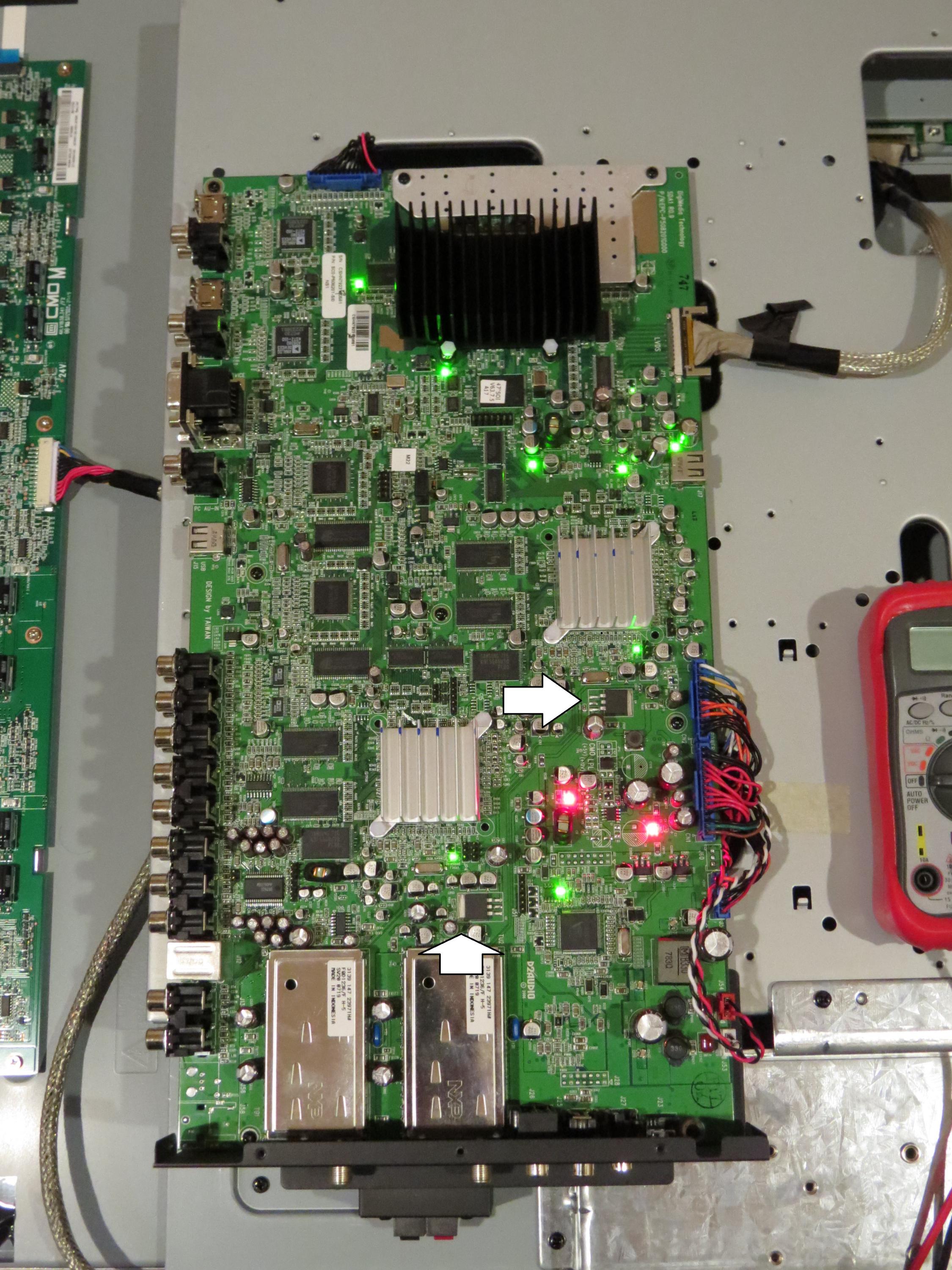

                                        I found only two 3-pin regulators, they are shown with white arrows on one of the attached photos. By the way, when the unit was ON, there were 8 green and 2 red lights on; when OFF, one red light. Does it mean anything in terms of what's working and what's broken?
                                        Both regulators are marked "1084-33 0707HL". I measured voltage between pins of both regulators in both OFF and ON. Here's what I got:
                                        ON:
                                        - top reg
                                        Vin-GND 5v
                                        Vin-Vout 1.69v
                                        Vout-Gnd 3.3v
                                        - bottom reg
                                        Vin-Gnd 4.96v
                                        Vin-Vout 1.67v
                                        Vout-Gnd 3.295v
                                        OFF:
                                        - top reg
                                        Vin-GND 77.6 mV
                                        Vin-Vout 77.3 mV
                                        Vout-Gnd 0
                                        - bottom reg
                                        Vin-Gnd 77.8 mV
                                        Vin-Vout 23.5 mV
                                        Vout-Gnd 54.8 mV
