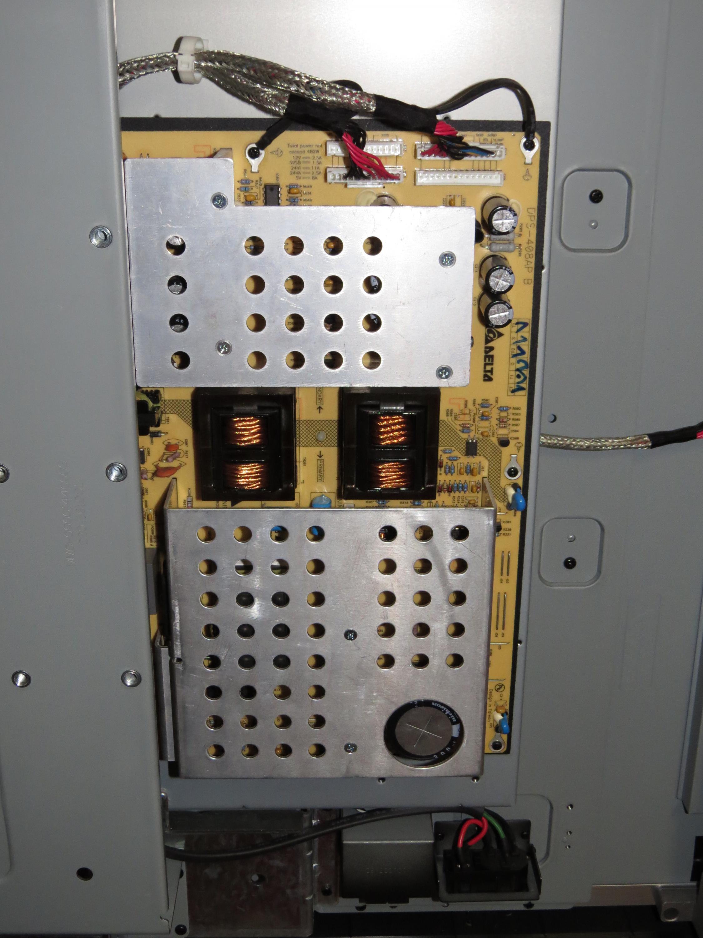

    Post good clear pictures of the boards first so we will know what we are dealing with.

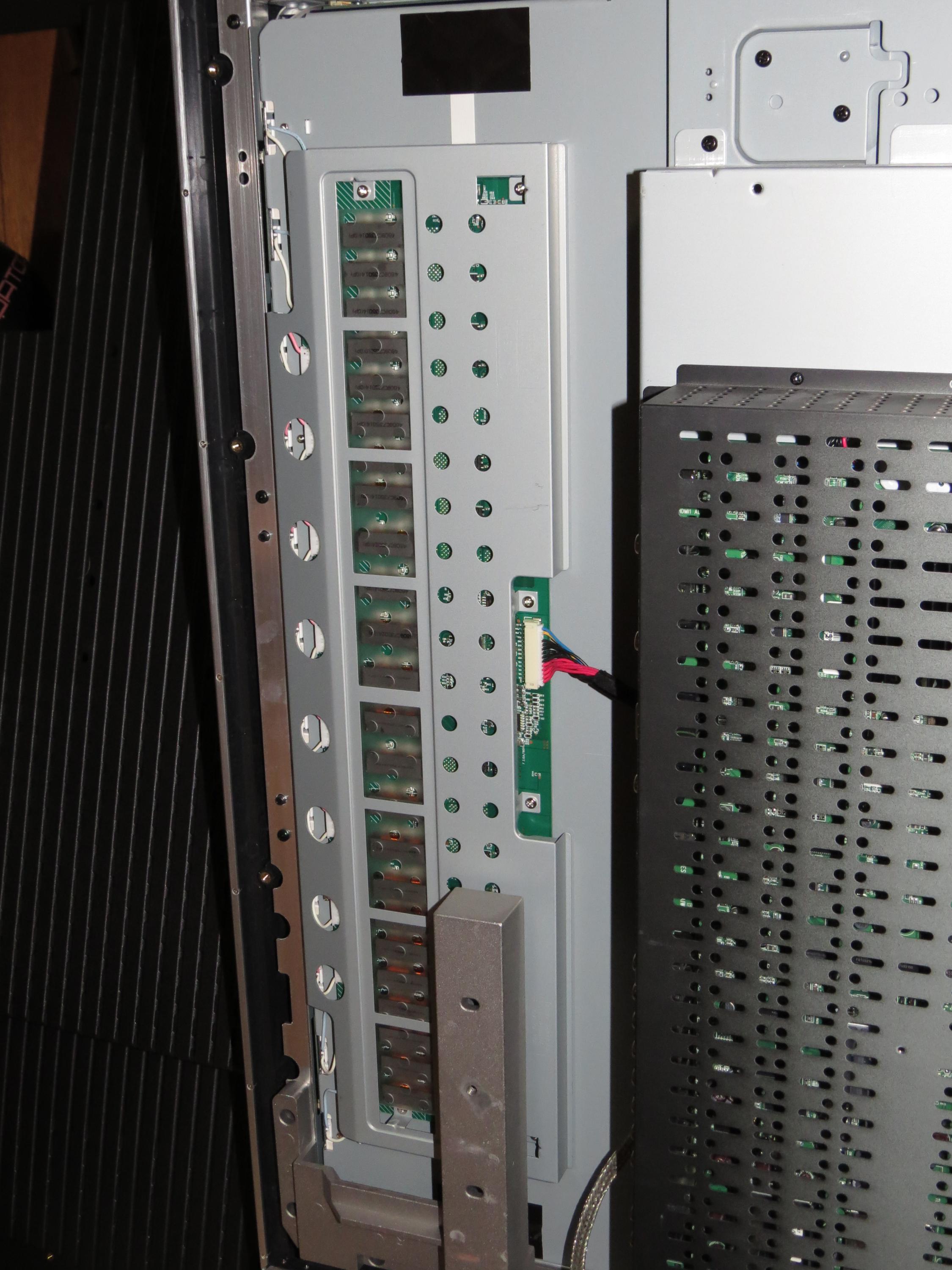

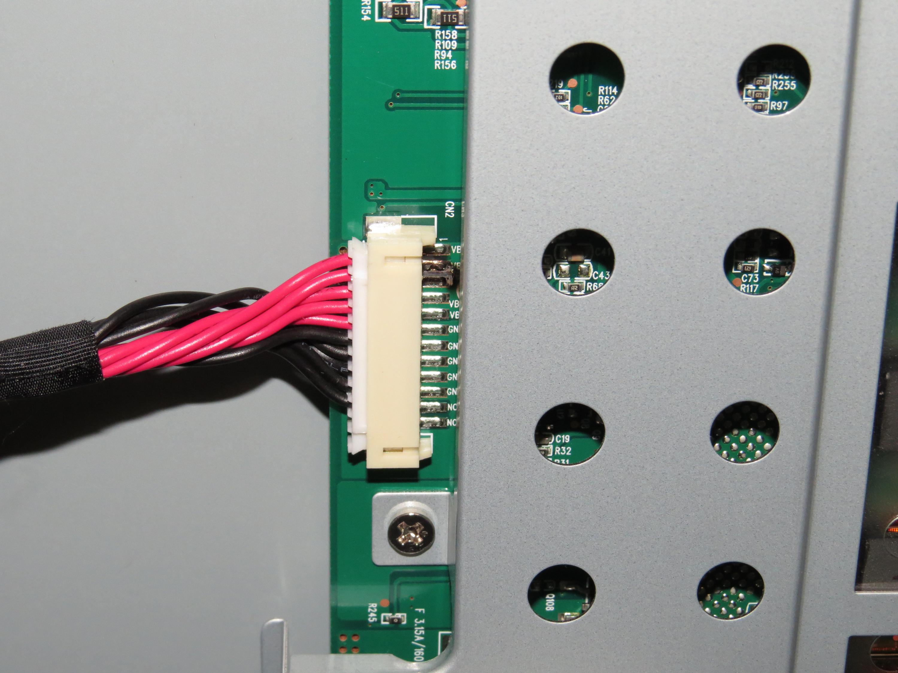

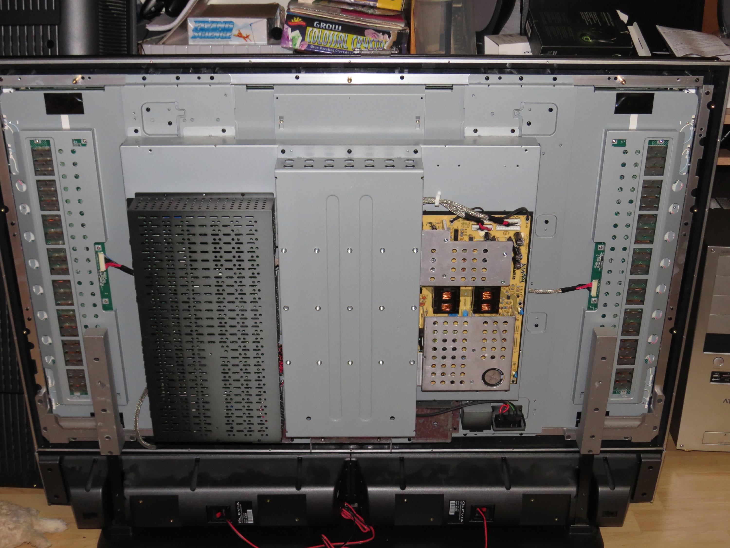

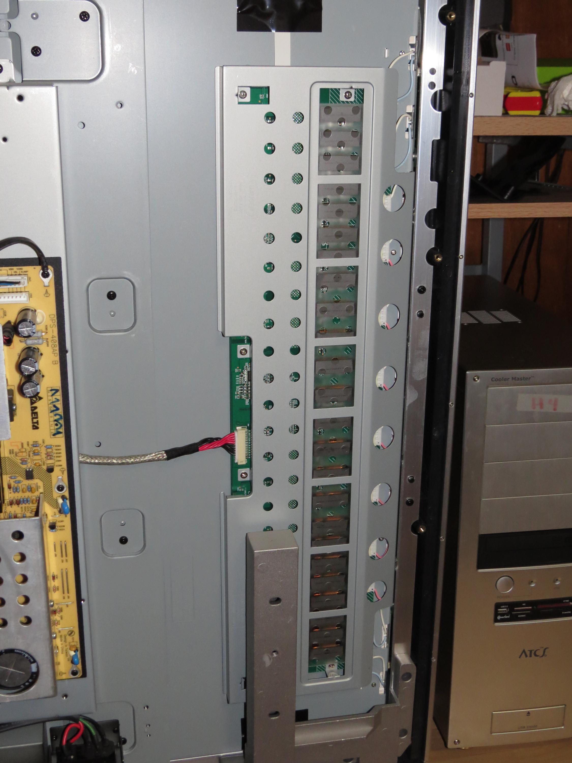

      Re: Olevia 747-b11 power on, screen dark
      OK here's what I have now: a photo of the whole back, then the power board in the middle, showing a couple of caps that seem to be OK, then the left and right boards. I have not removed the covers from those yet since I need to first find someone to help me move the TV somewhere where I can lay it flat. Once I do that I can remove the covers and take more detailed photos. Thx

        OK, 1st check, the red and black wires going to this board
        https://www.badcaps.net/forum/attach...7&d=1385761403
        What voltage do you see on across any pair of the red and black wires? (only need to check one of each colour.)
          It was a bit hard to get the voltmeter probes to touch the contacts, but I think I did it, and I got 0 on both sides.
