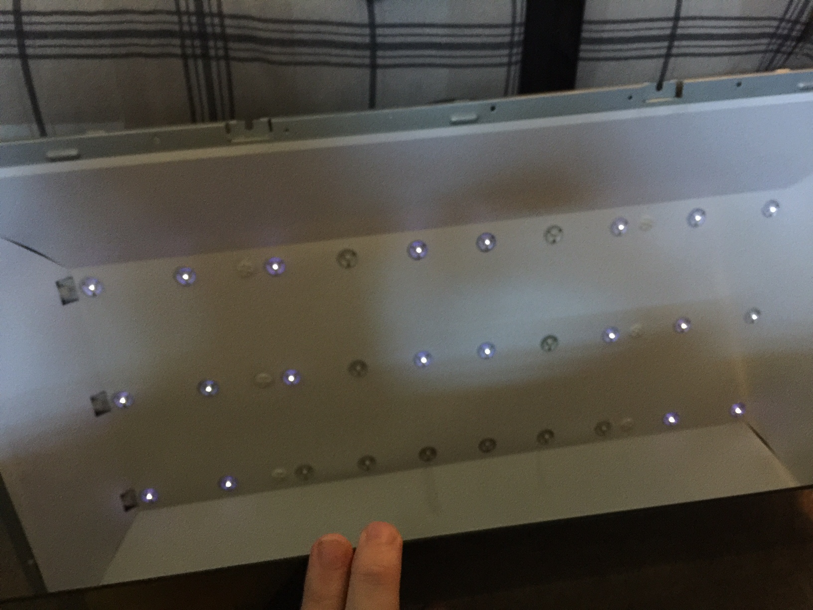

    I saw this 32" TV sitting by the garbage cans so I went to the door and asked permission to take it. The gentleman said, "lost receipt, son plays games on it day and night, only had it about 6 months, has sound but no video, take it. First thing I did was rebuild the power supply. After replacing 14 Capxcon capacitors with Jackcon's I still got sound but no picture. So while waiting for the gobbler to quit pretending to be lamb, I tore the TV down further and found a blown LED. There are three strips, each having 10 LED's. I am having a terrible time finding a replacement part. MBL-32035D310TF0 V1 56.8mm & 67.8mm

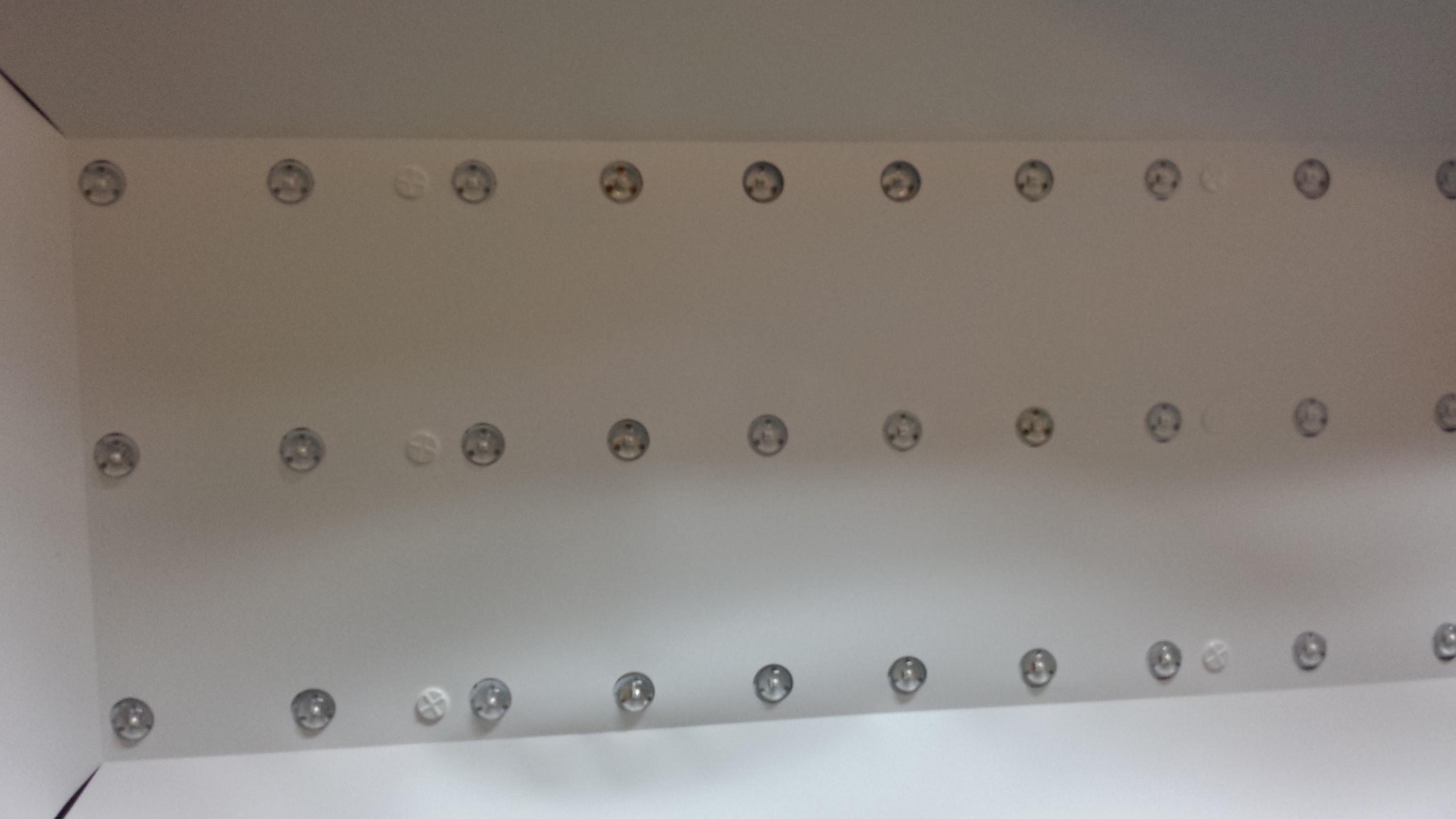

          Pulled the whole panel apart and immediately seen the blown led strips

                    I had the same problem, and am still looking for a replacement LED strip. For now I have "fixed" the problem as best as I can. Since two LED strips were still operational, I put one on the top and one on the bottom. Then I used a small piece of metal (short piece of a bread tie stripped down) to complete the circuit. I stuck one end into one side of the empty plug for the LED strip and stuck the other end into the other side of the plug completing the circuit. The television is working fine now, but I would still like to replace the center LED strip. If anyone has luck finding replacement parts, let me know. Thanks

                      I had the same problem too , by shorted (bridged) the bad LED. The TV works good, hard to notice one LED is not light up..

                        Why not try some of those SMT 1W LED's from fleagay? Not had any bad LED sets--except broken screens--to try 'em out on, but better than nothing....
                        If you pop off the lens, there's a SMT LED underneath....

                          This is what the one I found does:

                                  I just took this set apart again for lack of something to do.
                                  I am going to rebuild my strips with the 1-w smt as Alastair E suggested.
                                  I will repost after I have the strips done and back in the set.
                                  It should work. Thanks Everyone.
