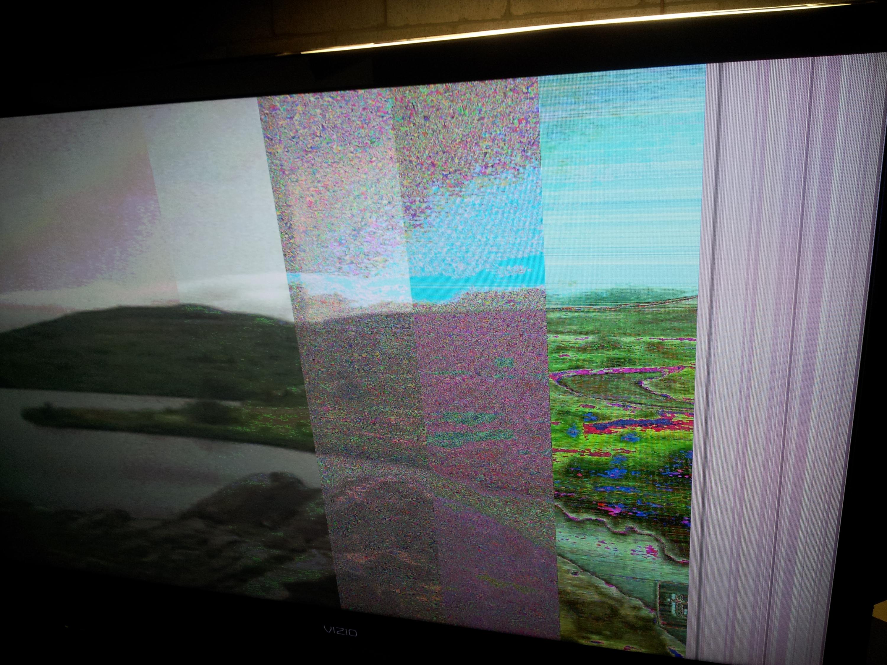

    Hi Guys, This tv started with no picture sound ok, i found the problem to be in power supply/inverter, replaced module with a used one. picture looked normal after that, put the cover back on, tried the tv again and this is what i get! (see picture) any idea what can cause this??
    Re: Vizio vt471xvt
    Check connections to T-CON

      reseated ribbon cables,cleaned all connectors with contact cleaner,still same problem.
      are there any test points that can be checked?
        Re: Vizio vt471xvt
        Since it was fine until you replaced the back cover I'm wondering if you dislodged the ribbons that enter the driver boards across the LCD panel.. Did you check those?
          Re: Vizio vt471xvt
          I can see them by looking at the end of the ribbon cables and they seem to be in contact with the sockets? Can the power supply cause something like this,the voltages are dead on also checked for ripple and its ok.
            Re: Vizio vt471xvt
            Possibly.
            if voltages are OK i wouldn't look that way though.
            Re seat those cables just in case, seems mighty odd that when you put the back on it started doing it, those cables could of easily been dislodged slightly

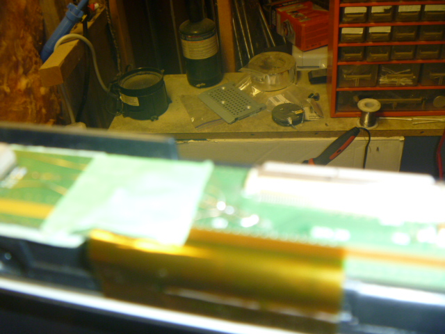

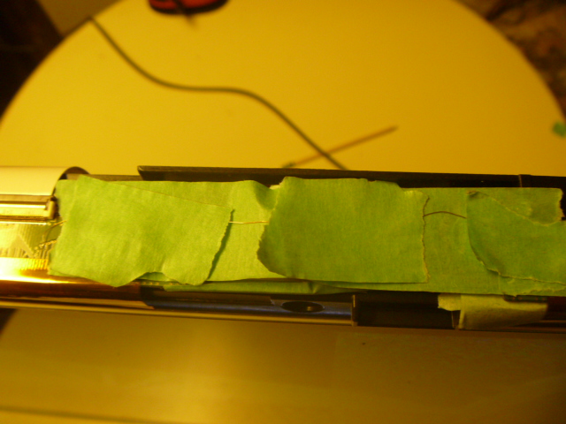

                Ok,Placed wrong screws in wrong holes! That chewed up some of the prints on the panel board. Repaired all prints, Should have been a surgeon! Bu now i believe i have a problem with tcon board. there is a 3a fuse not blown, 11.75v on it there is a regulator not sure probably 3.3v the main ic is running a bit warm,any more input will be greatly appreciated.

                                    Yes the panel board was damaged,had to jumper a total of 8 traces, did a continuity on all traces and test ok. No components were damaged.

                                        The fault now looks totally different.If i can get thttps://www.badcaps.net/forum/images/attach/jpg.gifhese pictures to upload!??/
