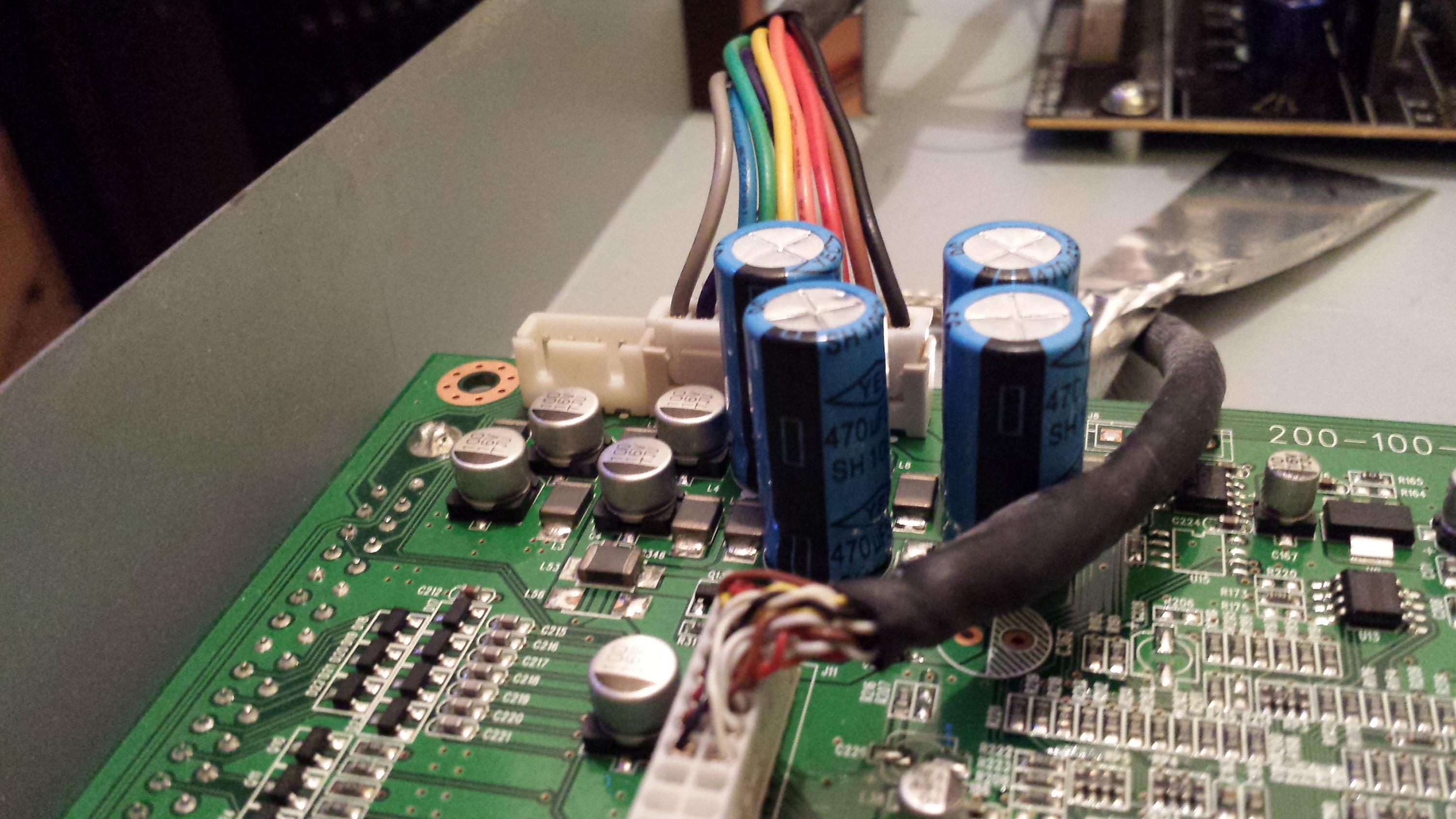

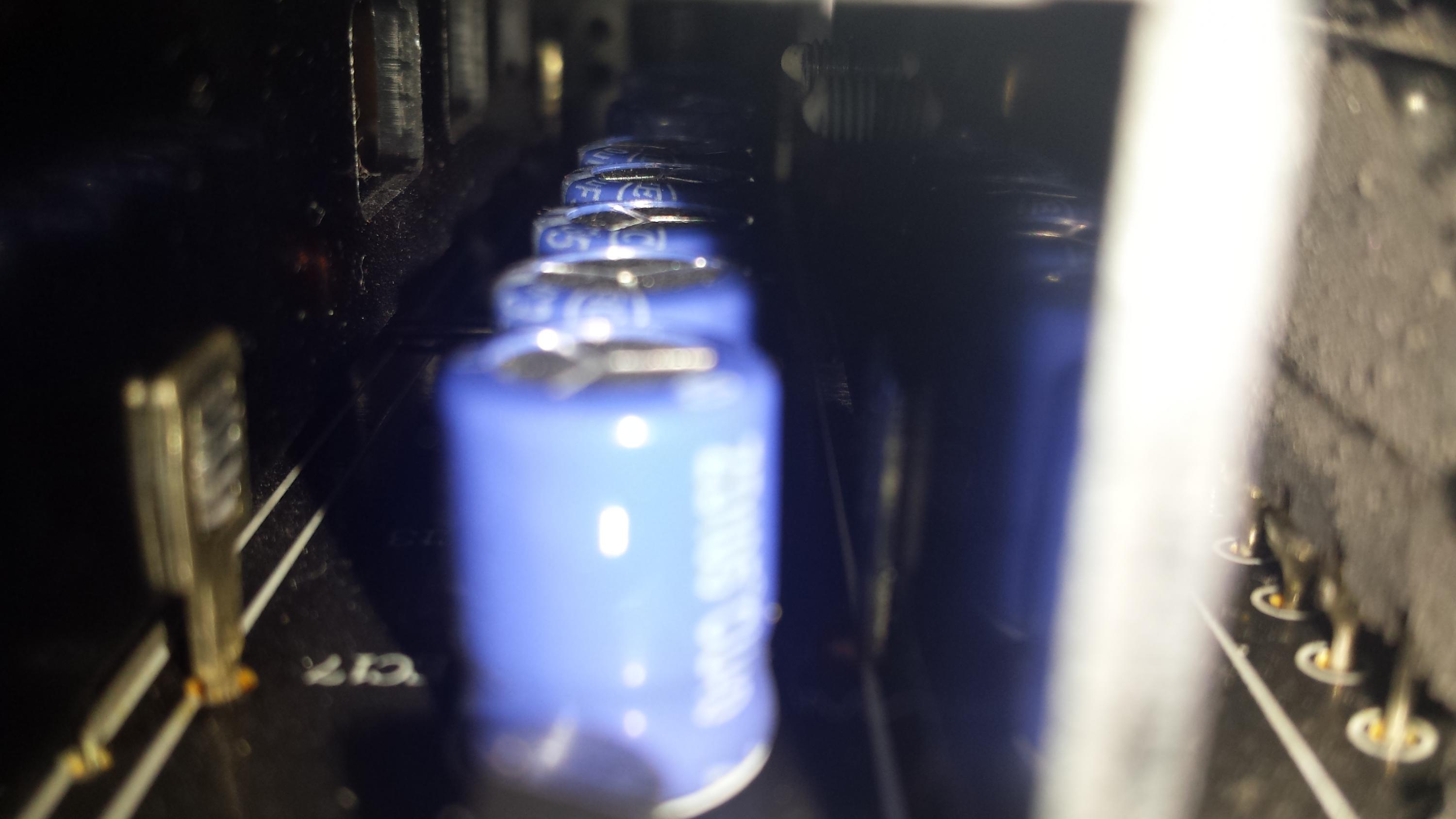

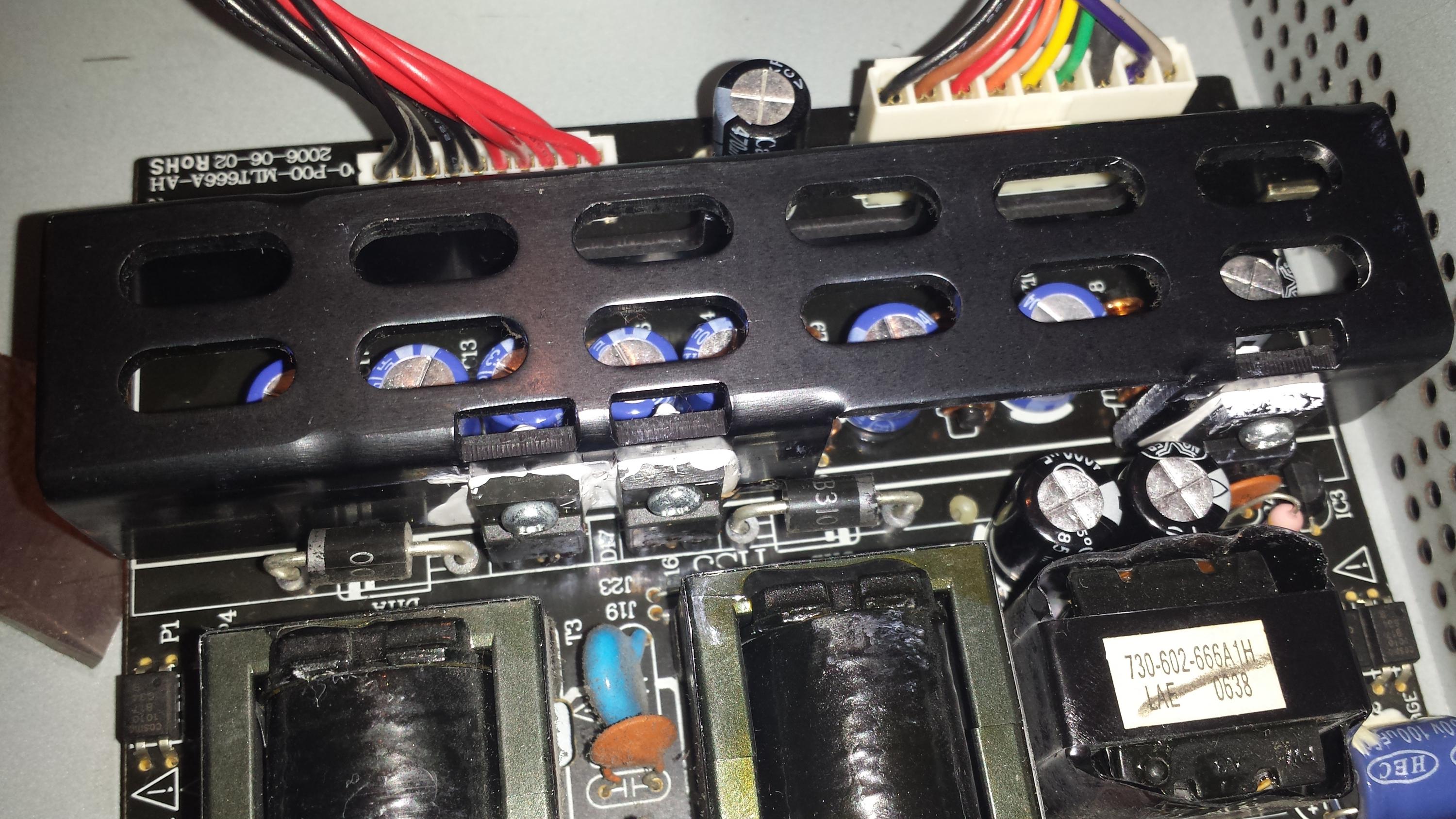

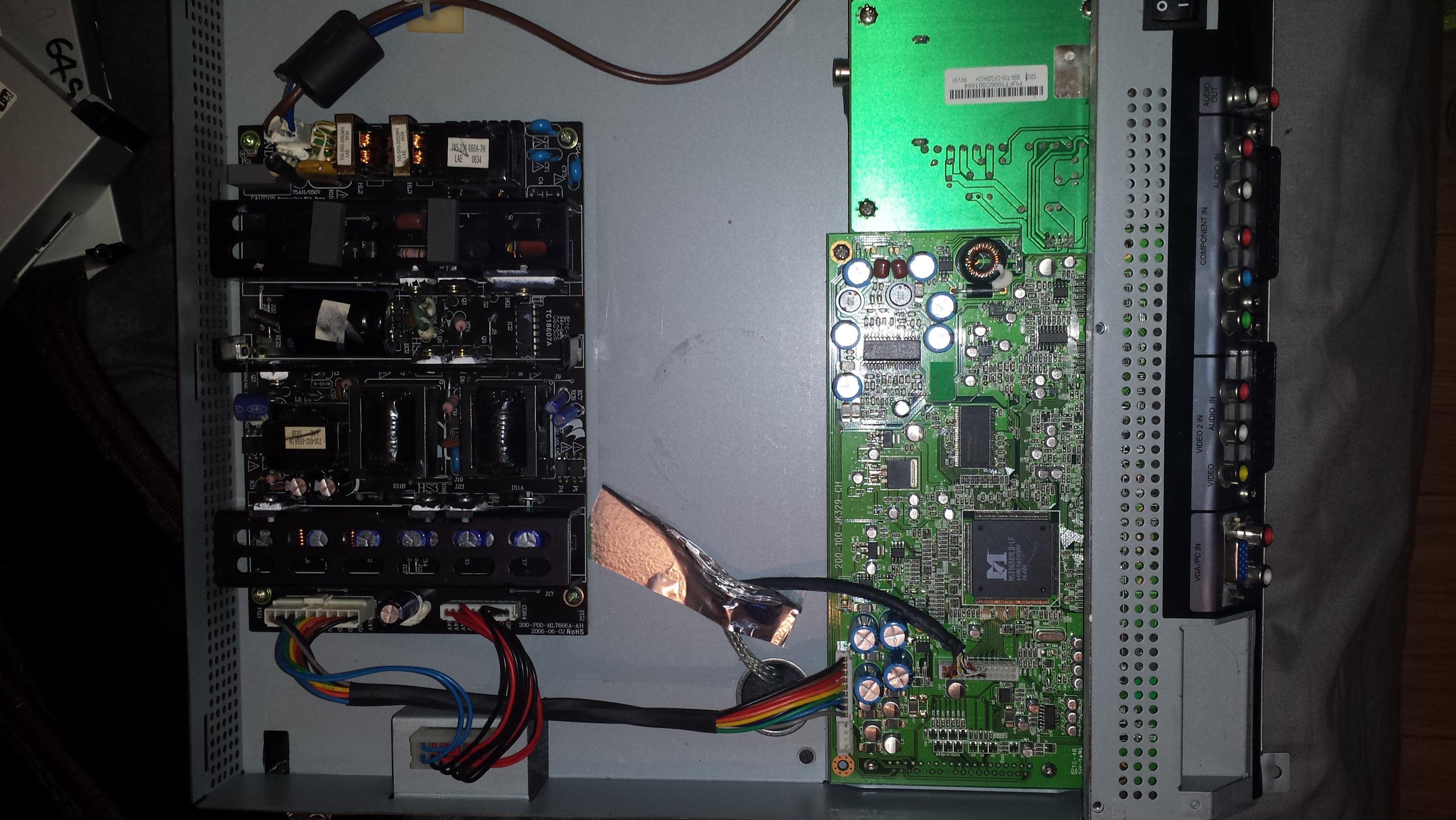

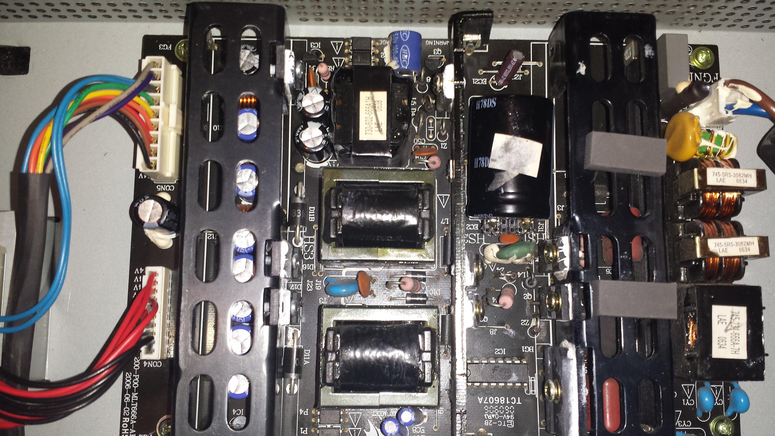

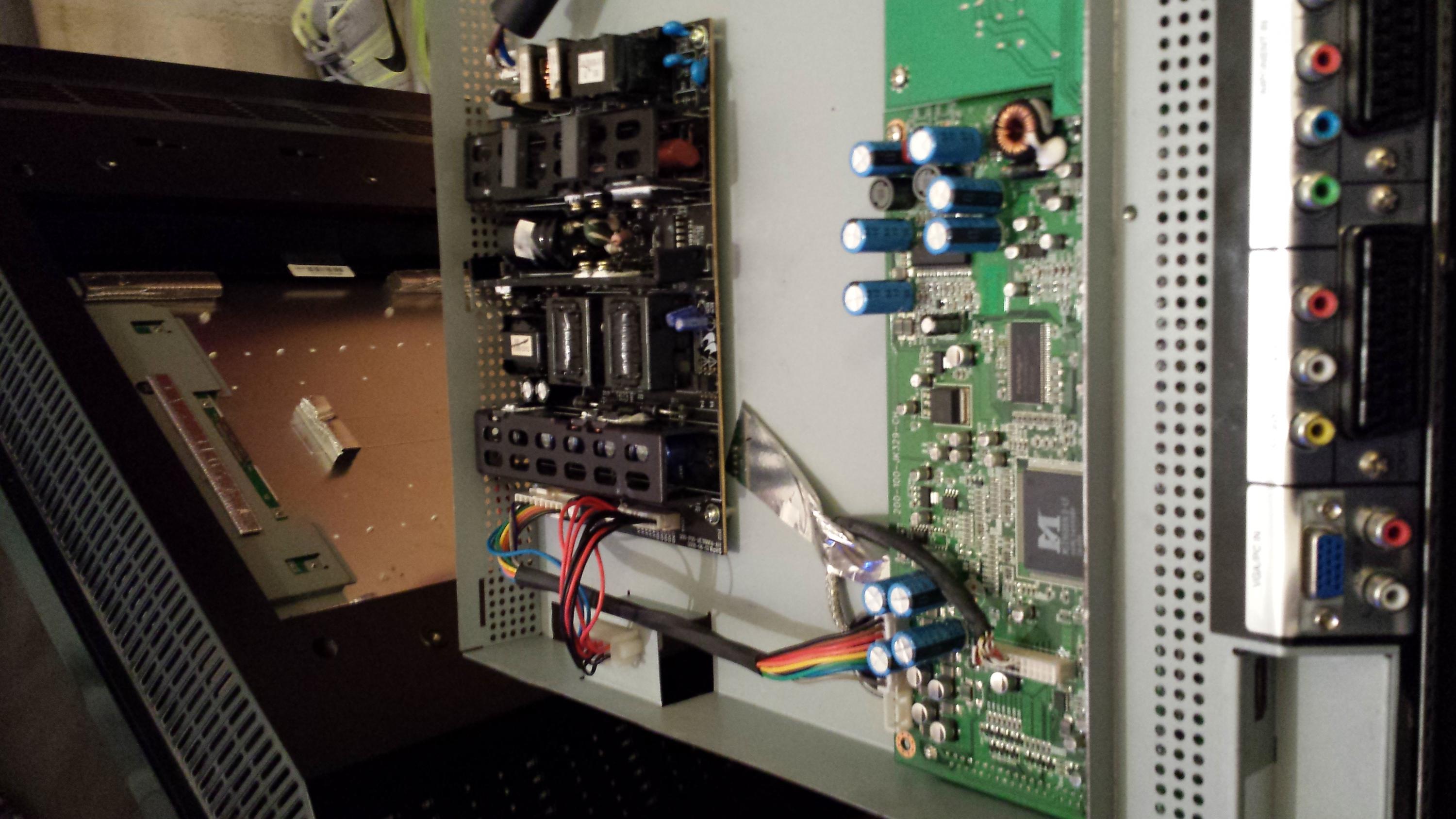

          NO lights on the power board, Here's a few pics, Hope this helps,
            Re: Bush LCD32TV016HD Red Flashing Light
            OK, check the various voltages on the power board. Verify they correspond to the rated voltages as labelled, try to get before and after fault.
