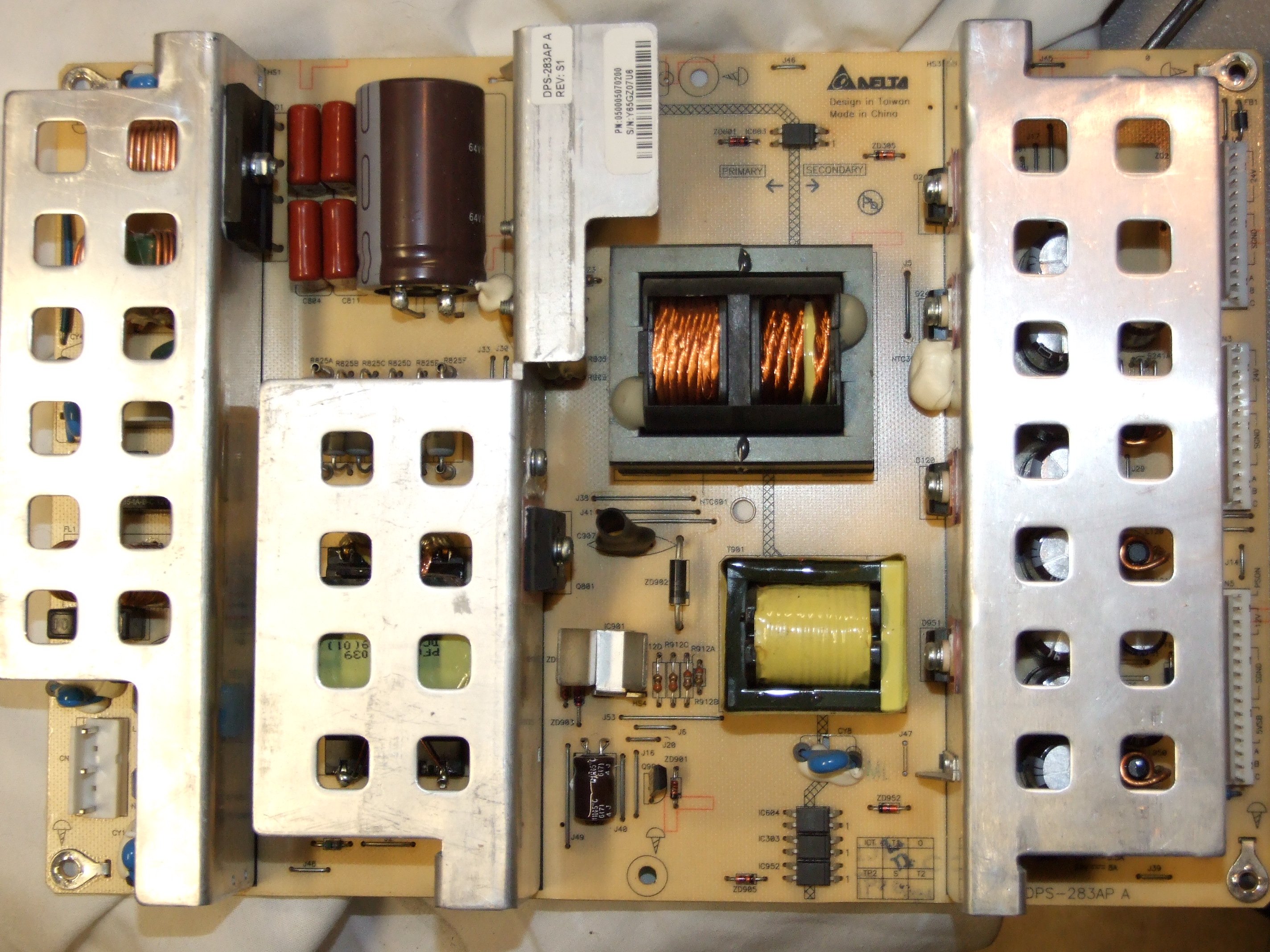

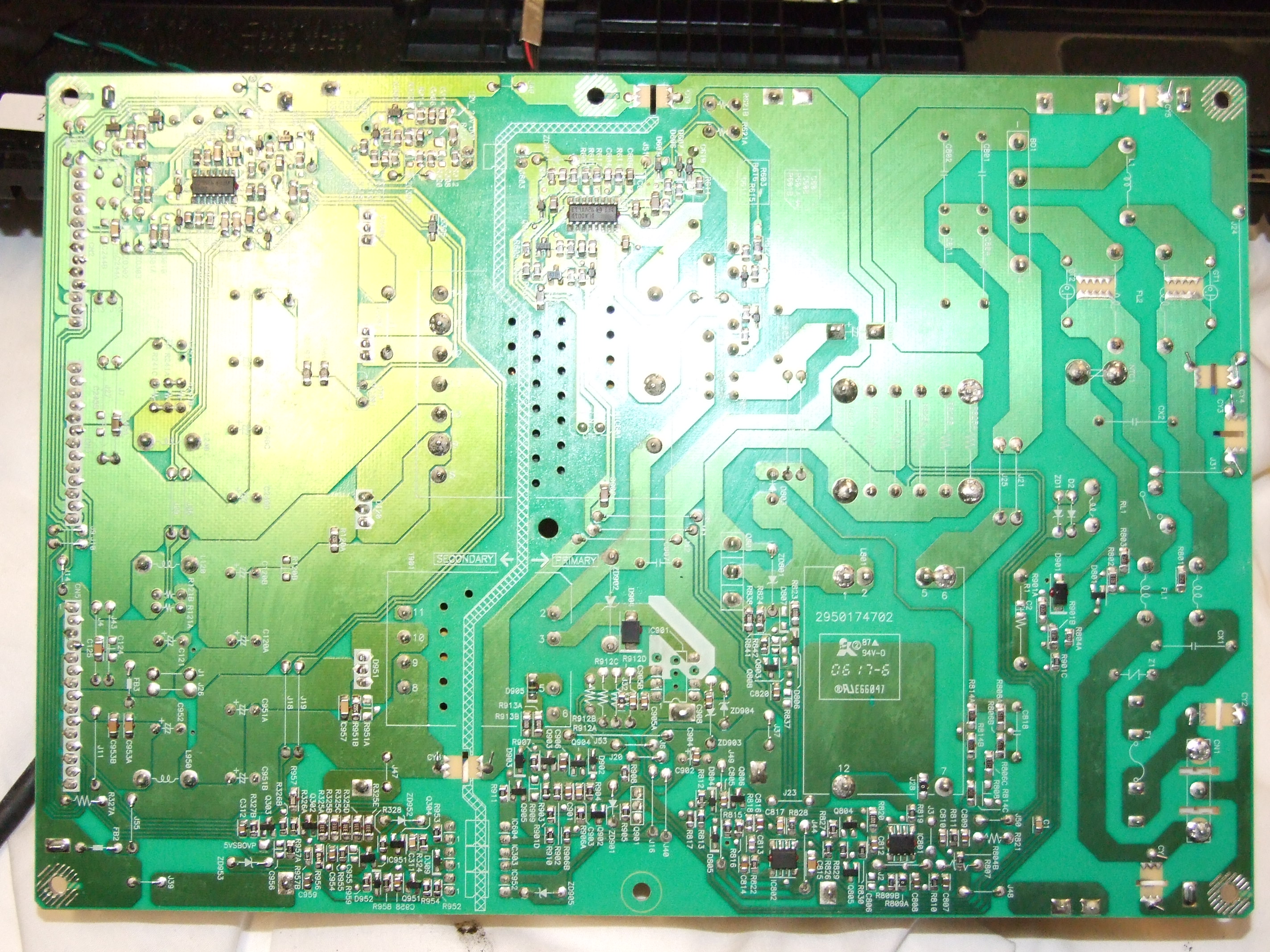

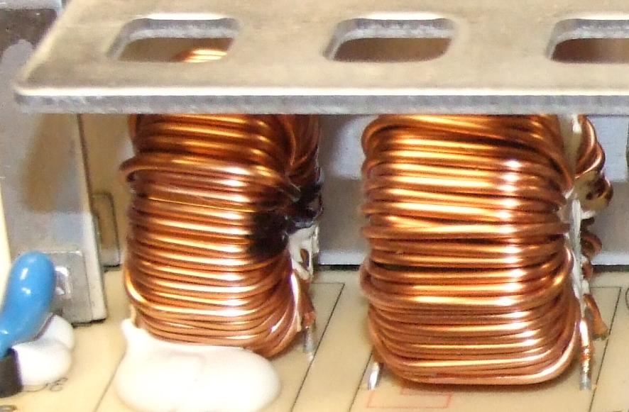

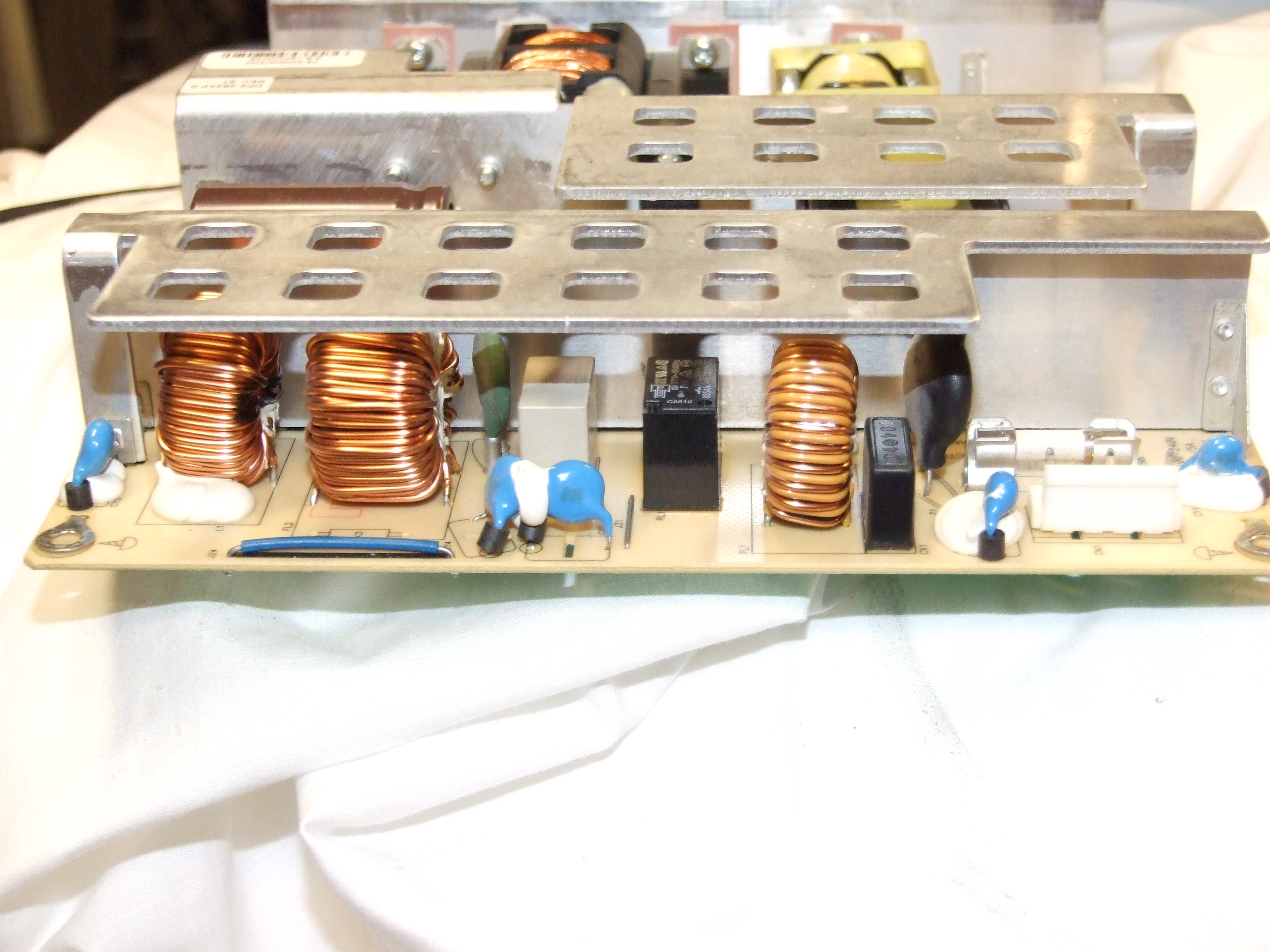

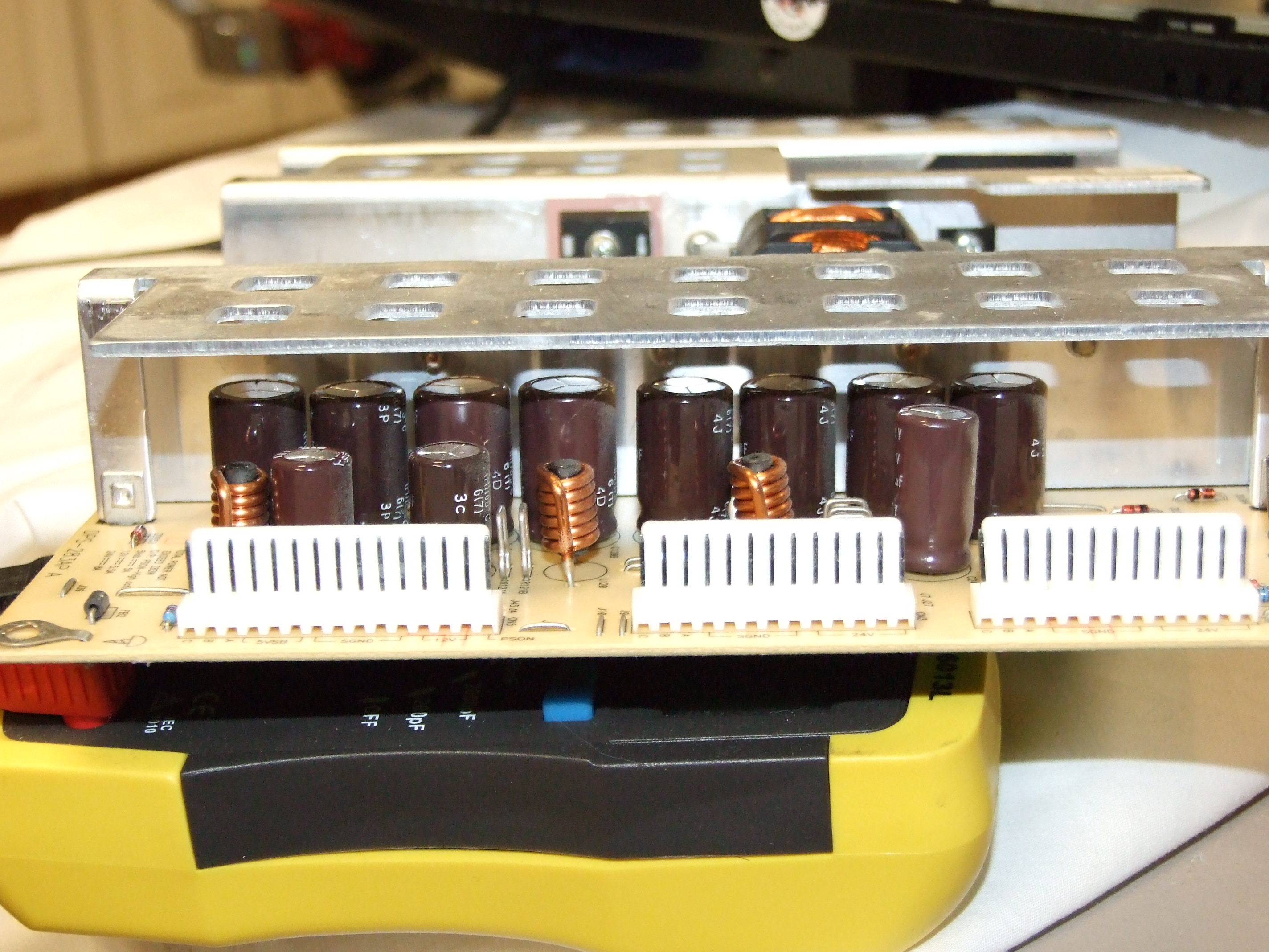

    Neighbor threw away a Vizio L42HDTV10A and it looks like in good condition but it doesn't show any signs of life. When plug in it doesn't do anything, no lights or anything when press power button. I took apart and the power supply at first glance looks good, don't see any bulging caps. I've read so some of the testing procedures but I'm not sure how to test this power supply. How can I check it to make sure it is the culprit. I have a capacity meter but I'm not sure if you can test in-circuit or not because when I do the numbers aren't close at all so I assume that is why. Can someone tell me how to test this. I'm assuming one of the voltage regulators is out. Here are the pics.

    Also in Pic 3 the inductor (copper coil) far left - is it as burnt as it looks?
    or is it just shadow.

      Check the main AC fuse to make sure it is OK first. Put the probes of DC volt meter to the 5VSTBY pin and GND pin of the connector to see if you do have 5V Standby voltage or not.

          The main key is that you have to have at least the 5VSTBY working first.
            Re: Vizio L42HDTV10A Won't Turn On
            Ok, getting 5v out of power supply and it looks like fuse F2 is blown, only getting 5v on one side. I'll order another fuse and I'm going to order a couple of each of the voltage regulators on the motherboard as well while I'm at it. Should I be worried that it it blown? Something I assume caused it but I guess don't know if it from surge or something wrong on motherboard. The TV looks brand new and I don't see any bulging caps or any hot spots on any of the boards. Any advice would be grateful, thanks

              What is the fuse rating?
              Put meter in Ohm mode then take the resistance reading on the end of the fuse that is not showing 5V, we need to know if that side of the fuse has shorted circuit to ground or not.

                Did you get to look at the inductor.

                  Selldoor, sorry, yes I did check it and it is paint/ink

                    Ok, I checked both sides of each fuse and don't seem to be grounded but I did have question. When I had it on ohm's it did show ohm readings on all 4 sides but when on continuity it did not show any short on any sides. How should I be properly checking for this being grounded? Also, if they are not grounded should I just replace and see if it works? What would be my next step? Thanks
                      If show anything less than 50 Ohms or so I would worry about it, if it shows in K ohms range, it may be OK since the circuits that have problem may be after the voltage regulators.
                      You can try a new fuse for now. I fixed some of these Vizio that had blown fuse for reason that I do not know, I checked the current draw and it does not show any thing bad, put new fuse in and it still working.

                        thanks budm I'll order a few extras and see what happens, if it powers on I'll measure the current. I'm also going to check diodes, rectifiers around it also. I'll order today and will get parts tomorrow, mouser isn't far from me so I should know something this weekend.
                          Success, replace the SMD fuse and it turned on. I left it on for over an hour and still good. Hopefully that will fix it for good, one tv saved from garbage and only cost me $1.06 to fix. Thanks for all the help. Next is an hannspree lcd monitor.
