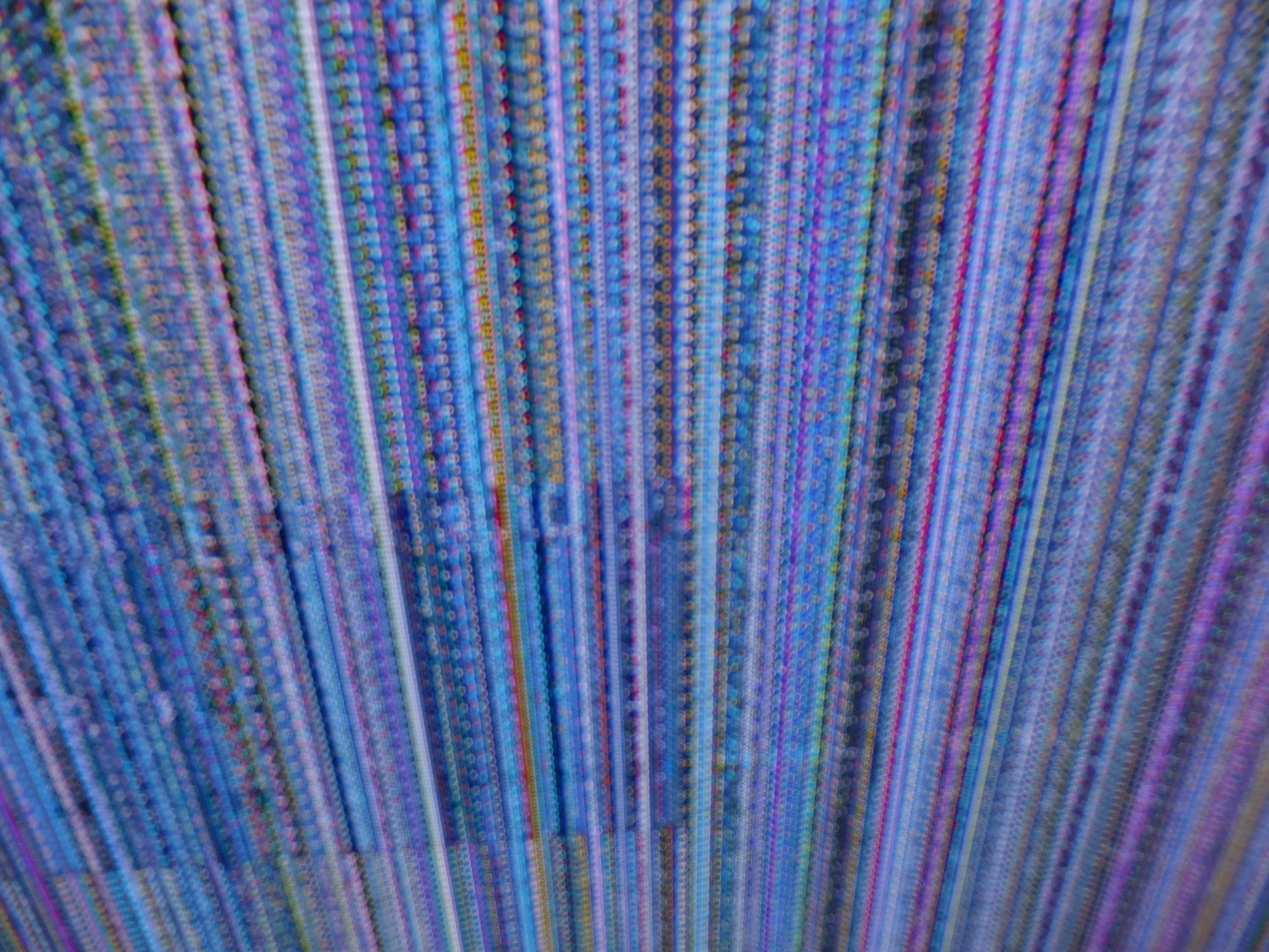

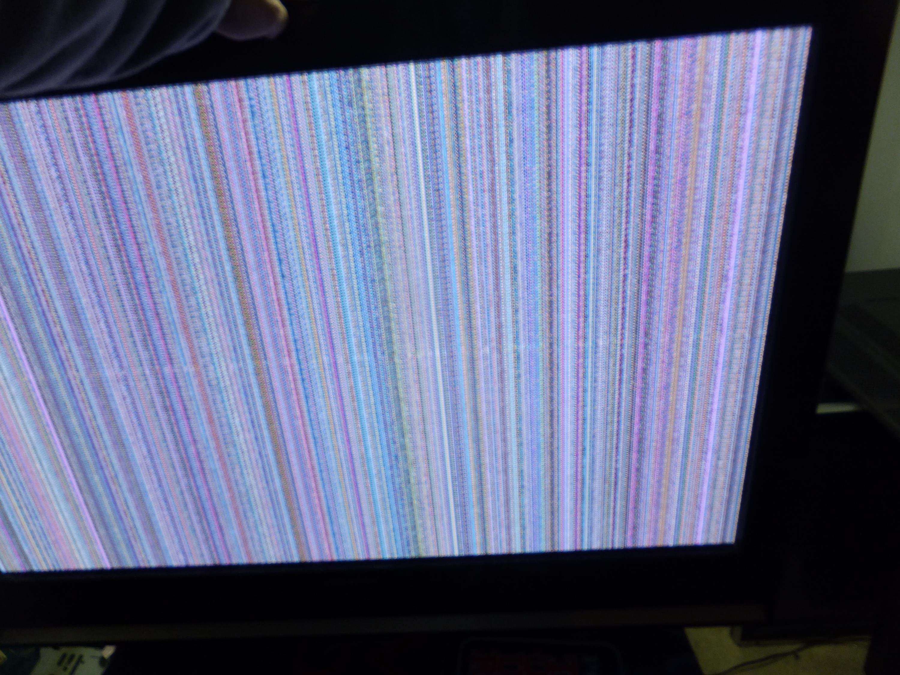

                      I have a Samsung HP-S4253 and the screen has vertical lines. No bad caps anywhere in the TV. No blown fuses. Y-Sus and X-Sus boards seem to be good. All the ICs on the buffer board appear to be good. I am thinking it is the logic board. Does anyone know for sure what is causing this problem. Here are pictures.

                        Re: Samsung HP-S4253 Plasma Screen Problems
                        Logic board would be my guess.
