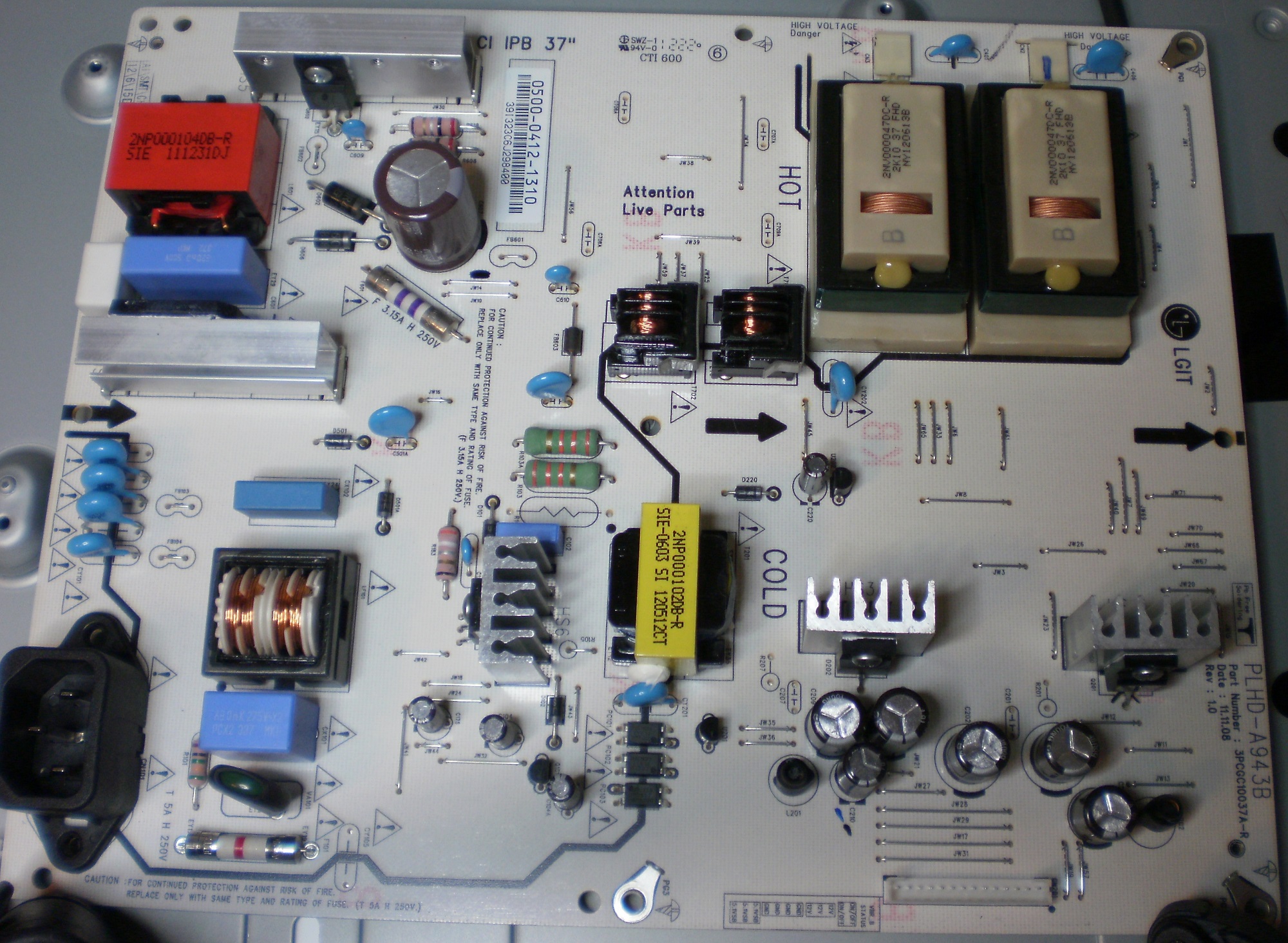

    I have picked up this TV knowing that is an EEPROM issue(first for me).
    It's not the famous u18 one though. It's a different board.
    On this board is us4 the chip.
    I have purchased one on Ebay from shopjimmy, for $28 shipped.
    Replaced it and it goes over the logo to a black screen with sound.
    I have measured the 400V and it's not there, it's only 160V.
    The other voltages are there at the connector. I'm not sure about the Status pin. What that is? It measures 3.03V.
    The PWM IC is OZ9977BGN. I can't find dataheet for this IC.
    It's safe to say that I need to replace it, since I can't check it?
    It's located on the left side of the board at the bottom, it's the biggest there, 20 pin.

      It never rises from 160V?

            No change at start up, it drops 3-4V and then goes back up to 161V-167V.
            I'm wondering if this issue can be from EEPROM also or not?

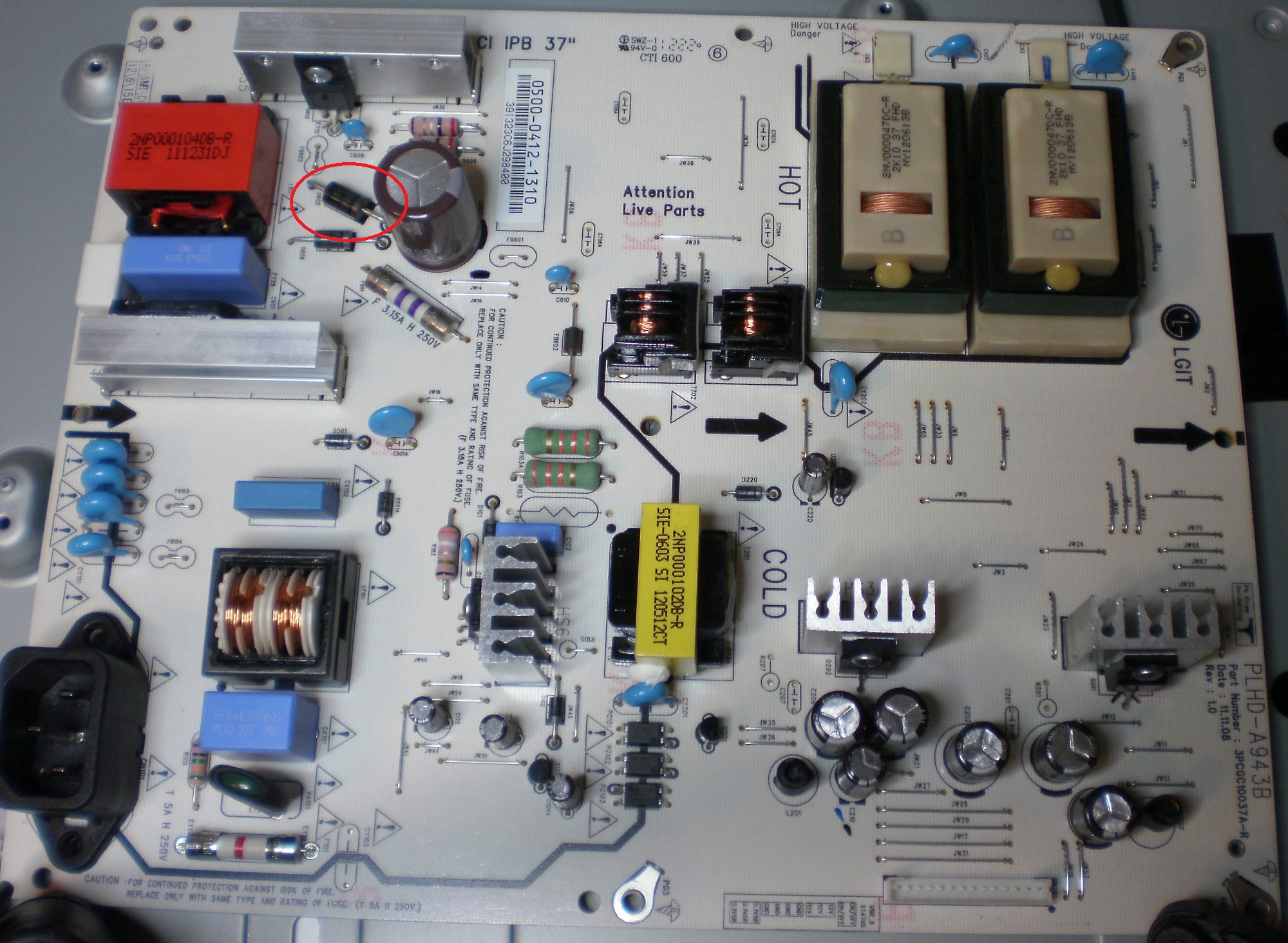

              Found the problem, it was D602-MUR460, circled in the picture.
              It was conducting both ways.
              It's running now! It's a super light LCD TV.
                Re: Vizio E371VL starts to Vizio logo
                That is PFC Diode, so that means the voltage on the main cap never goes up 370~390VDC.
                Great job finding the cause of the problem. I always check the DC voltage on the main cap first to see if the PFC is working or not (if the circuit has PFC).

                  I haven't checked that. I have seen that it's working and I didn't even think about checking that.
                  The main capacitor is a 450V one, so it should go to 390V.
                    Only if it has PFC. TVs without PFC max voltage only ~input AC * 1.41.
