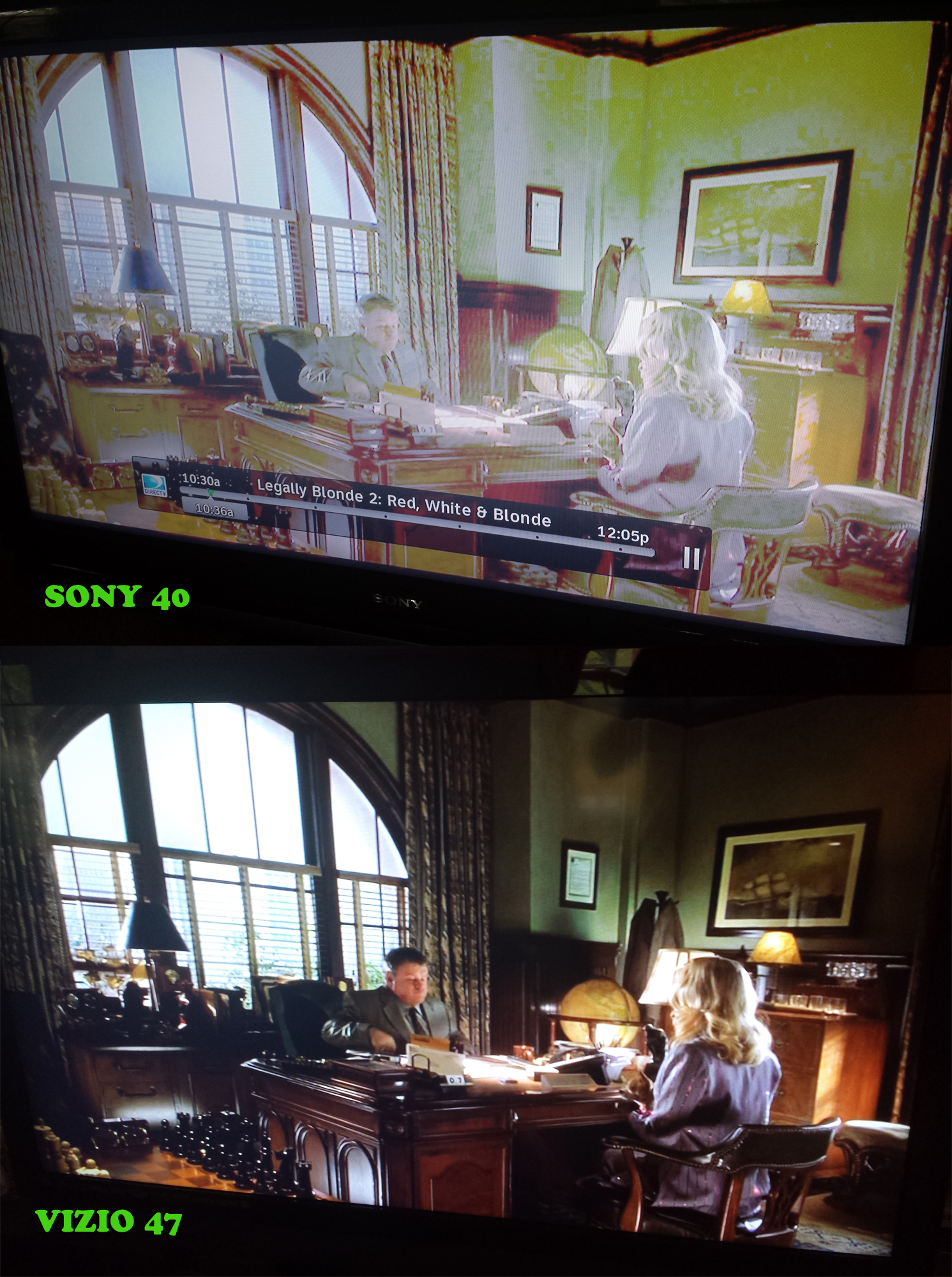

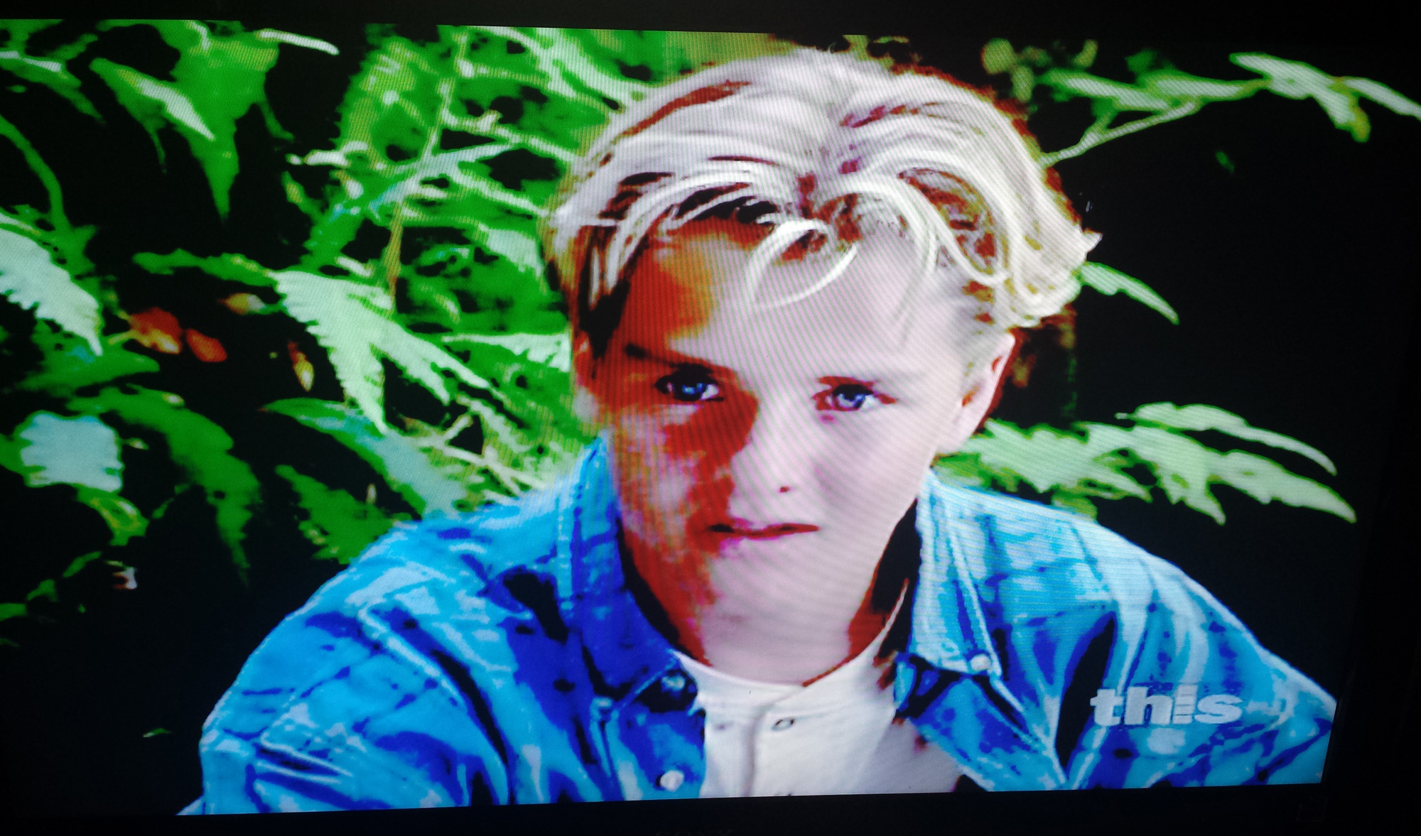

    Sony KDL-40V4100 Blown out color
    Can anyone recommend where to start looking on this one?
    The attached picture is with the brightness turned down quite a bit. Overall the picture looks washed out when I reset the settings to defaults. It's kind of like what you would get by setting a computer monitor to 16 colors.
    Re: Sony KDL-40V4100 Blown out color
    Can you show us what it looks with all controls to factory settings? Could be GAMMA chip fault or LVDS fault, the sudden transitions between colours are throwing me off it being the gamma chip though.
      Here is my Vizio 47 compared to the Sony with the same picture.
      The Sony video settings were reset to default. (From the main menu, not from Service menu.)
      I have cleaned the LVDS Cable, and tcon connectors.
      Doesn't seem to change at all.

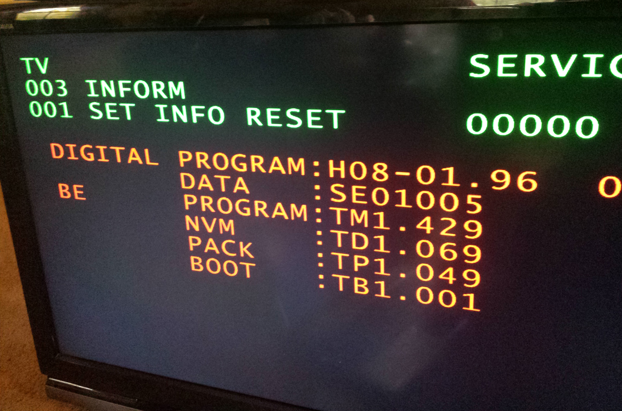

          Manual for 46" which should be close enough
          Try accessing service menu, can you see easily accessible reset option? It could be that the RGB DRV and offset are set wrong due to corrupted memory.
          If that doesn't fix it, can we get a pic of the T-con so the gamma chip can be tested?

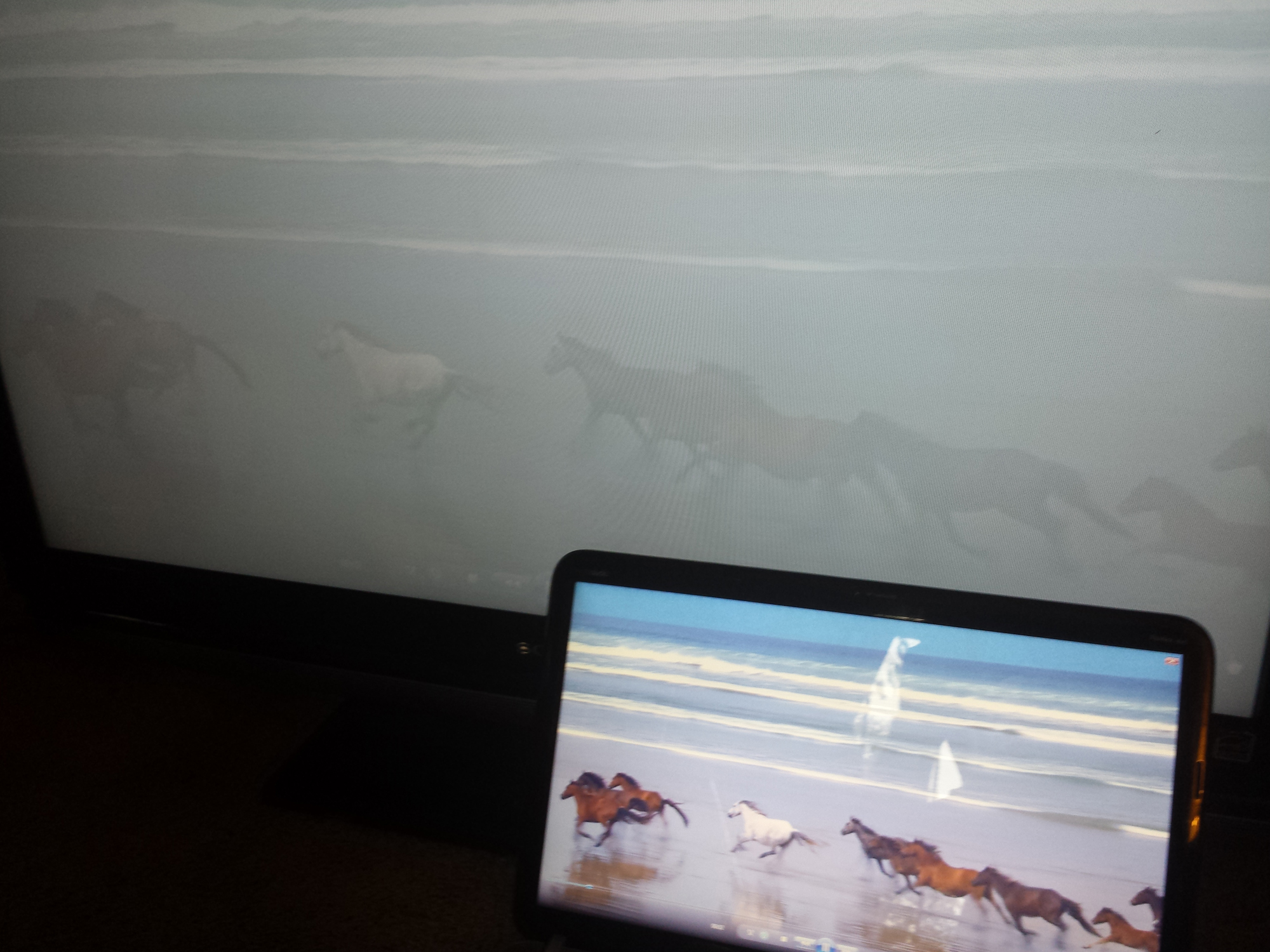

            I can get into service menu. Just have no idea what to do after I get there. Now that I look at it with my hdmi cable from laptop going into it, it looks like the detail is all there, it just kinda looks like i am looking at it through a white milk carton. It's just washed out.
            It's not faint on either side. It looks to be pretty much solid. When I use the NEC Pattern Generator on it, and it looks great. All the colors are crisp and detailed.
                  Here's a pic showing the display with the Laptop in the foreground.
                  Might also mention that I am using the same HDMI port on all these pics.
                    I was asking because some Nvidia chipsets have issues with HDMI and sending RGB vs YPbPr data which some TVs do not correctly decode. Try seeing if there is an option for colourspace. Since you say test pattern generator (NEC?) looked OK?
                      It Looks ok, but I think it is because it has a mostly black background. Also, When I change settings on the tv, it flashes from dark to light. In the second it is dark, the image looks good. It is almost as if It has too much backlight which is washing out the screen?
                        Here is how to get to the service menu:
                        Turn off the set
                        Hit Display, Vol +, 5, then power.
                        Here is the service menu. I can hit 2 and get to this screen which shows reset, but I have no idea what to do now.
                        I'm up for trying a complete reset, if anyone knows how to do this.
