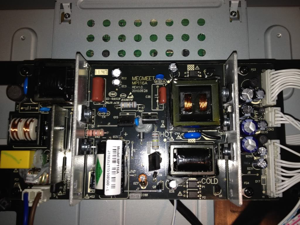

    My tv turns on and displays the brand name momentarily and then fades out and disappears; back lights stay on, on/off indicator light stays on and remains blue (this light is orange on standby). I have checked the voltages on the power supply; All the 24V pins are 23.3V. the 12V pin is 11.9V.
    Connector 2 has some voltages that deviate from expectation. in the second attached picture Con2 is at the far left (all stranded pink). I will list pin voltages left to right: 0, 0, 5, open, 4.5, 5, 5, 5, 0, open, open, open, 11.9. counting from left to right, pin 5 SHOULD be 5V and pin 9 should be 5v.
    Please advise as to what may be the problem.

    looking on the back of the power supply I discovered what I'm calling pin 9 is actually labeled a ground not 5V; so now the only thing that seems to be wrong is pin 5, which is labeled PSON and has a voltage of 4.5. I've read that PSON is either 3.5V or 5V; I wonder if 4.5V is an issue.
      Re: 32" sceptre x322bv w/ psu mp116a
      " All the 24V pins are 23.3V. the 12V pin is 11.9V" PS_ON is fine otherwise you will not have the 24v and the 12v.
      You need to check and see if the voltage to the T-CON board is present.
      Read my basic troubleshooting guide to get basic idea how LCD TV function.
