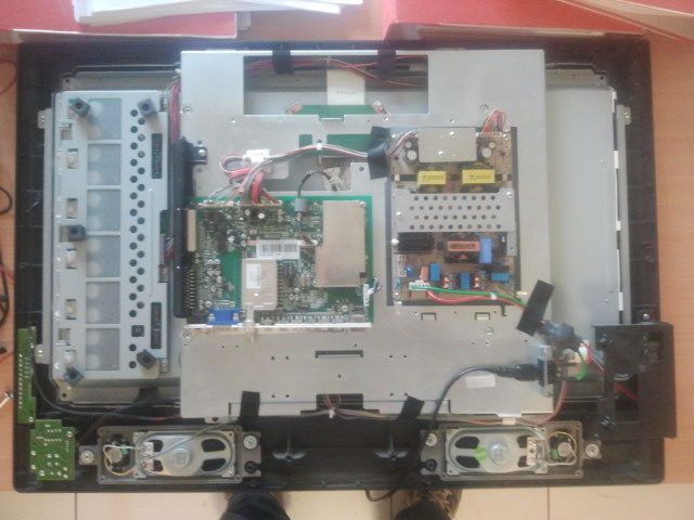

    Hi all, I am Declan, new member who has come here after numerous google searches were throwing up badcaps.net results.
    Back Story: My son has a Goodmans GTVL28W26HD LCD TV. He uses it for xbox mostly but it has not worked in a while. He told me he is considering getting a new tv, so I asked him has he tried to find out what is wrong with this one. Answer was no, of course.
    So I decided to try and solve it with the help of the internet. Now I am by no means of above average technical ability but I saved a faulty dishwasher with google and a solder gun and thought I will give this tv a go.
    Problem: Ok heres the problem(s) with this LCD.
    Firstly the remote control is lost !

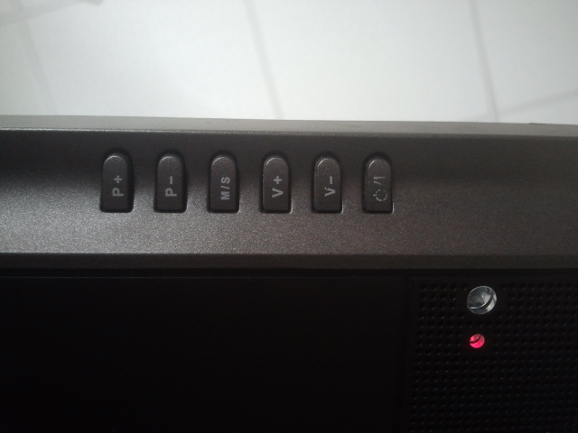

    Secondly, The tv is stuck in standby mode. When it's plugged in the redlight comes on. But pushing the power/volumne/ P+/- buttons on the side of the set does not achieve anything.
    I thought, hey simple maybe we just need anew remote but my son says that the tv did come on and was working after he lost the remote control by using the buttons on the TV.
    So I hit the internet to see what I could learn. Not much but I have got this far.
    Troubleshooting so far: After googling and surfing the internet for a while, I have lfound out a little about failed power supplies, bad caps etc and I took the back of the tv to have a look.
    No bad or bulging caps stood out on visual inspection.

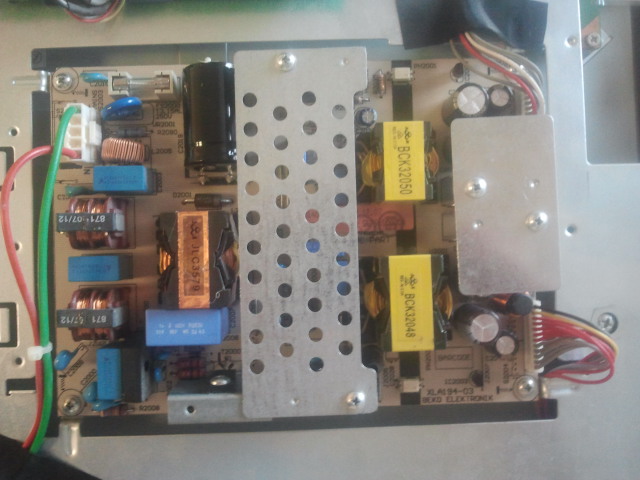

    So I took out a multimeter. The power board is a BEKO XL194-03.
    It has 230v AC coming in confirmed.
    On the DC end of the board there are two outputs.
    First output point (12v to the mainboard) is reading 12v on the correct pins.
    Second output point (24v to panel for screen) has no voltage reading.
    Now I am not sure if this is just because the tv is in standby so that is a question I need answered here please.
    I followed the first output (12v to the mainboard) and from the main board we have wires to the button control panel and the remote senor/standby light panel. There is voltage reading of 3v on some of these wires.
    So that's where I am now. Stuck and hoping for help.

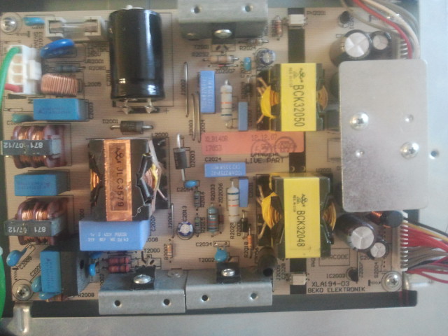

    I cannot find any pictures of BEKO XL194-03 PSU, could you provide one?
    • Declan_Ireland
      • Oct 2013
      • 25
      • Ireland
      Re: Goodmans GTVL28W26HD - TV stuck in standby
      Hi Tom, Hope these pics are to forum rules/sizes etc.

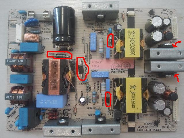

        I would check the diodes on output side. Do you know how to do this?
        • Declan_Ireland
          • Oct 2013
          • 25
          • Ireland
          Yes I can do that. Do I test them in circuit or out?
            In circuit is fine -- if you find one to be suspicious test out of circuit.
              Hi Tom,
              On the board is D for diode?
              There are 4 regular looking diodes which all read ok
              D2001
              D2003
              D2008
              D2009
              and then two three pin part diodes that are referenced D2010 and D2011 .
              If these are to be check I am not sure what I to do.
              Declan
                For three pin diodes check diode mode between 1-2, 2-3 and 3-1 both ways. "D" means diode yes.

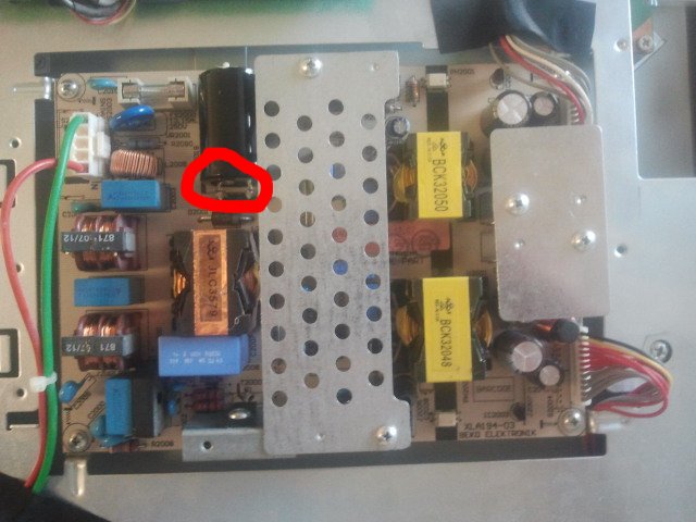

                      OK, it looks like the diodes are all OK. Next check: there is a large, 400/450V rated capacitor (highlighted.) VERY CAREFULLY check the voltage -across- it, red one end black the other. You are working on the primary side which carries an electrocution risk, so I advise you have someone watch you while you work. Do not touch any part of power supply on primary side.
                      I expect: 320V~350V before pressing power button (standby), rising to approx 380~400V after pressing power button.
                        Hmmm I have read it a couple of times and getting readings around 718V~ in standby mode.
                        Pressing the power button there is no change (tv isstuck in standby).
                        Voltage from red/green wires @ power input to board is reading 230V~

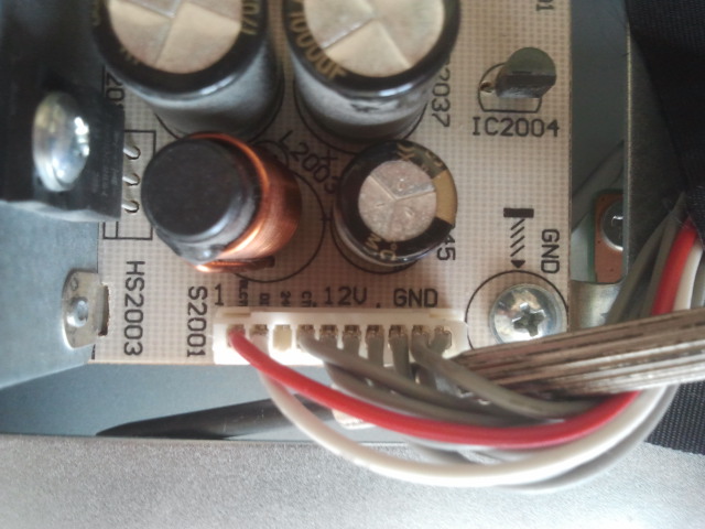

                                  OK, along connector on power board going to main board, there should be a pin marked PSON, or STBY...? Can you see this? If you can, check what it reads when in standby and when you press the button to turn the set on.
                                  • Declan_Ireland
                                    • Oct 2013
                                    • 25
                                    • Ireland
                                    I have the following pins with readings:
                                    (The labels on the board for these pins are slighty covered. I will post a picture)
                                    GND .........0
                                    GND .........0
                                    GND .........0
                                    12v .........12.56
                                    12v .........12.56
                                    12v..........12.56
                                    CT ..........0.3
                                    24 .......... empty pin
                                    DI .......... 0.05
                                    BLCT ....... 0.06
                                    The readings do not change when pressing Power Button
                                      Pic
                                        Possibly the CT pin, when you first plug in the set does this rise at all? Or is it steady ~0V?
