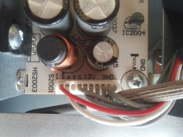

                      Re: Goodmans GTVL28W26HD - TV stuck in standby
                      CT pin then measures 12.3v
                        Does 24V etc come on?
                          Yes Tom, the 24v pins are showing readings of 24.1
                            OK this definitively indicates a main board problem.
                            You can try checking voltage regulators https://www.badcaps.net/forum/showthread.php?t=22231
                            Other than that, the only option may be to replace the main board, unless detailed schematics of it are available.

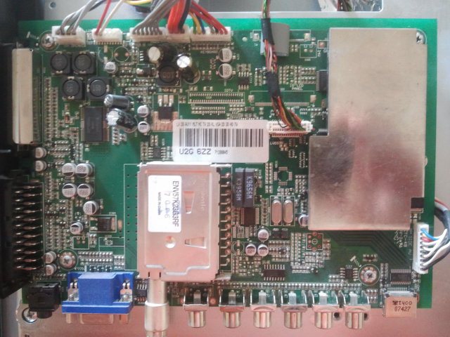

                                #35
                                Main Board is BEKO XLA190r-5
                                (pic attched)
                                I can see three voltage regulators:
                                IC302
                                17-33G
                                RB738
                                Pin 1 ___ 0.00
                                Pin 2 ___ 3.29
                                Pin 3 ___ 5.23
                                IC304
                                78M05
                                RF739
                                Pin 1 ___ 0.12
                                Pin 2 ___ 0.00
                                Pin 3 ___ 0.44
                                IC305
                                1587M
                                RB738
                                Pin 1 ___ 0.58
                                Pin 2 ___ 1.83
                                Pin 3 ___ 5.15

                                  All regulators look in tolerance. Reg #2 is not powered. Can you get a picture of the main board so I can see what DC-DC devices there are?
                                    I just put attachment on previous post.
                                    Do you want close-up of any particular area ?

                                        I see only one DC-DC there, small black device bottom middle of board marked "100". What voltage do you see on each end?
                                          5.23v
                                          5.32v
