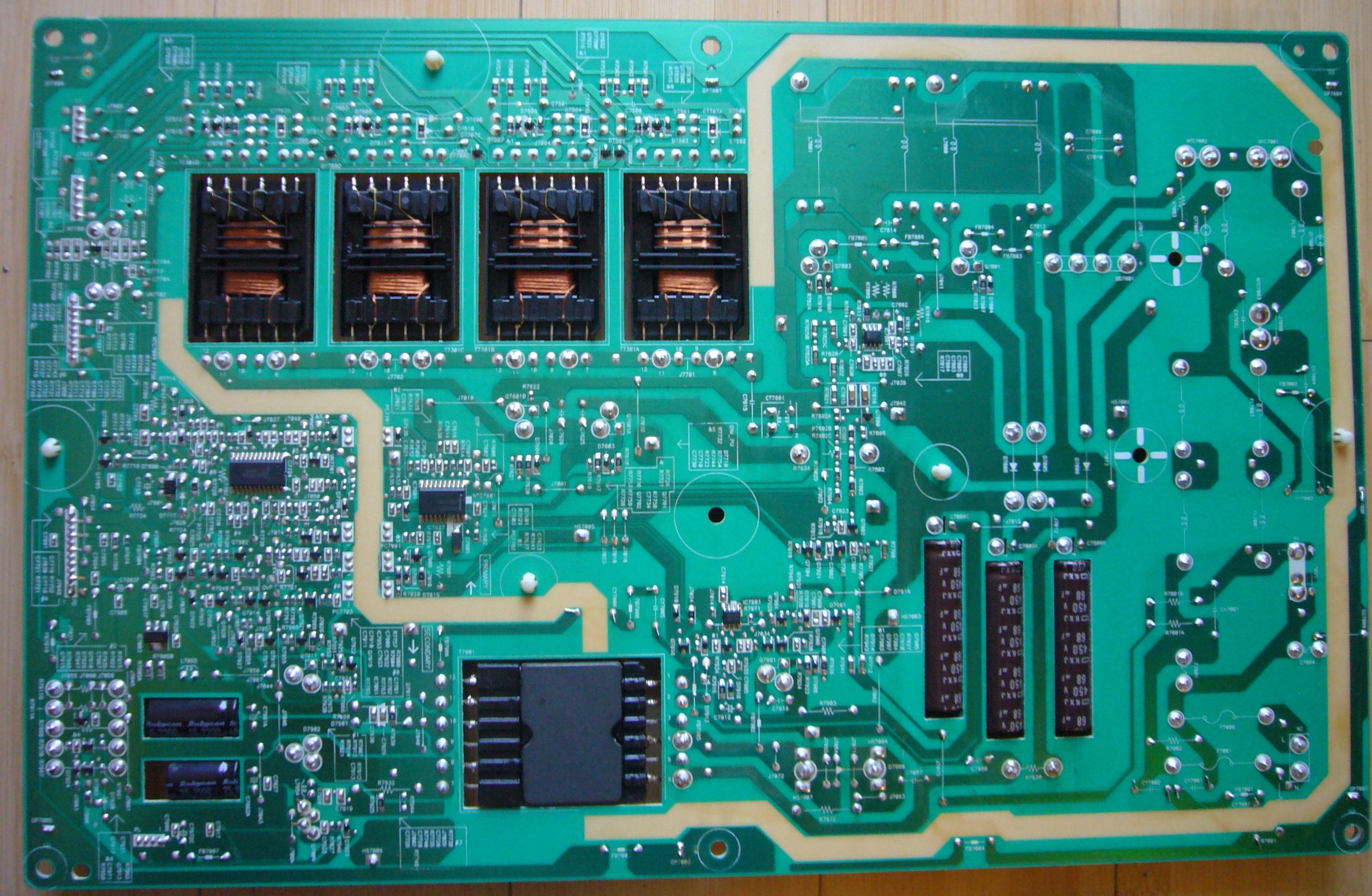

    I have a Sharp Aquos LC-60LE810UN with a blank screen, 1 -1 error code(Lamp error) flashing when plugging in the TV. Not possible to get to the service menu or resetting the error via CH- and VOL+ when plugging in the TV. I've tried to replace all three boards to no avail(I am a novice). From this forum I learned it is either a LCD panel or backlight problem. So I took the panel apart, tested the LED strips, found 2 open LEDs which I replaced with diodes(1N4148). The panel's LED strip configuration is: 2 x 50-LED strips on top/bottom and 2 x 30-LED strips on each side.
    I successfully tested the 30-LED strips with a battery pack of 10 x 9V batteries. For the 50-LED strips, I tested each LED individually(phew!).
    So now I am assuming the backlight is ok, but I want to test it before assembling the panel. My test setup includes the chassis with LED strips installed, PSU/inverter combo board with BU5V(standby) jumped to PS_ON and PNL_POW via a 1K resistor. However, the backlights do not light up. When I measure the LED driver voltages(between LED_DRV1+ and LED_DRV1- and so on), I get ~27VDC - 25VDC for each LED driver. Each LED driver powers 80 LEDs, so I would expect over 240VDC. Any pointers as to how to proceed from here?

      Thanks for replying tom. Now, while testing with or without the LED strips connected I only see 25-28 mV on the outputs which leads me to doubt my previous reading of 27-25VDC on the outputs.
      I confirmed that once PS_ON and PNL_POW is jumped to BU5V, I see "reasonable" values on the other pins:
      BU5V - 4.98
      PS_ON - 4.55
      PNL_POW - 4.55
      AC_DET - 3.2
      S13.2V - 12.95
      UR13.2V - 12.95
      Perhaps the inverter part of this board is bad?

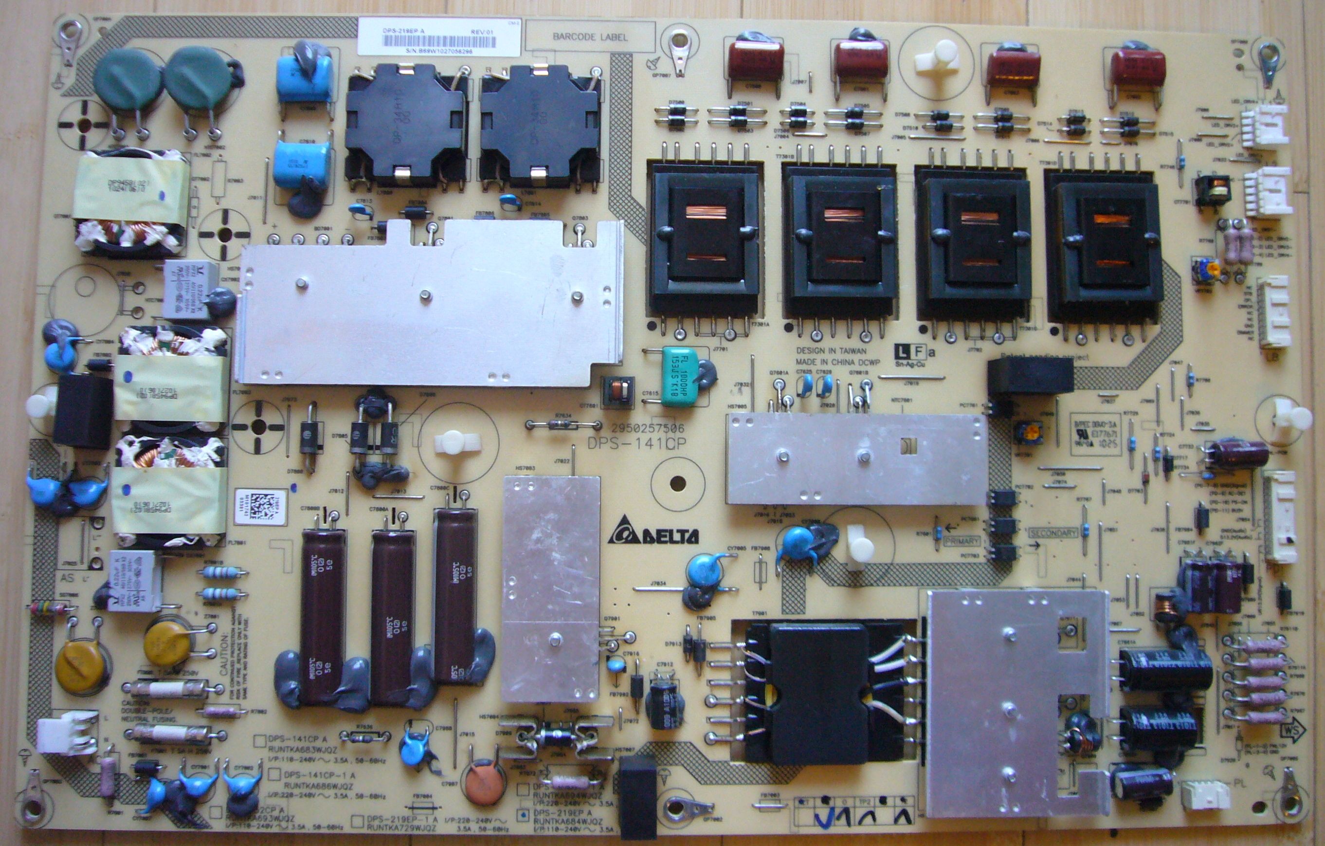

        I have one of the same sets sitting at home. Aquired it stripped of all boards. Only the panel and casing in which the panel is not cracked. . Im assuming this was the same problem considering what I have seen happen in sharp led TVs lately.

              just like I said in my last post your inverters are connected to a logic IC on the power supply that monitors reference between all LED strips for current differences if there's any different if there is a light what you need to do is download the service manual properly figure out how to reset the stage for the error.
              mine still not fixed properly yet but I can get it to come up by holding the volume down channel up button at the same time or try a vol up channel down button at the same time while plugging it in. If that doesn't work try holding the channel up volume down button and then plug it in hold down and keep holding down until you see the LED's try to light momentarily. put a voltmeter on the LED output and see if you get any rising voltage at all. There is a way but its tricky. I had my panel completely apart as well.

                  I appreciate your feedback. To make sure you understand what I am trying to do, my test setup is as follows.
                  The chassis(which includes the LED strips) with only the PSU installed, no main, no TCON, no LCD panel, no front panel with buttons to push.
                  My thought was to attempt validating the backlight(by jumping PS_ON and PNL_PWR) before I assemble everything else because it was a pain to take it apart(probably more pain putting back together). With this setup I see no LED driver voltage with or without the actual LED_DRV connectors attached.
                  I am a novice, so I don't know if this setup is sufficient to fool the PSU to turn on the inverters.
                  There are OFL and STB pins(I don't know what these are for) on the LB connector, but I assume these signals normally come from the main board, right? Do I need to jump any of these pins too?
