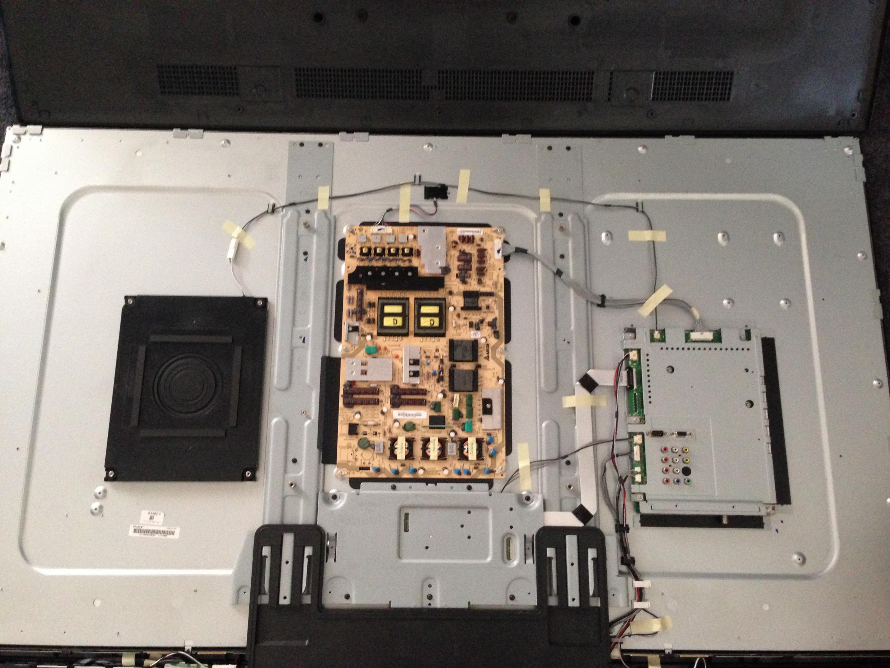

                                Hey guys,
                                I've been reading threw this thread hoping I could find some nuggets. I've got a 60le830U that just coded 1-1. I'm a complete novice when it comes to this stuff. I'm not afraid to take things apart, but my hope was it would be a simple unplug some ribbons, buy a new board, plug it in, and put the housing back on. I called the local service shop and they are quoting me $110 just to look at it and could go all the way up to $500 for parts and labor.
                                When I did Vol down, Iput, Power button it would come out of error, the TV would turn on and then 5 seconds later it would shut down again go back to 1-1 error. I tried holding down the channel and vol button is various sequences during those 5 seconds, even while plugging in and nothing happened. In those five seconds the TV would show what input is connected in the top right corner and the screen seemed fine, but it was fast. I've taken the back panel off and right now it's just sitting in my living room. I don't have any experience testing electrical stuff, but am willing to learn. Anyone willing to walk me through some options?
                                I did see that it looks like I'm better off buying a power supply board directly from Sharp rather than off ebay because of bad inverters. I'm open to anything at this point. My dad is an electrician so he's got some gear and if I can tell him what to test he'd help me out.

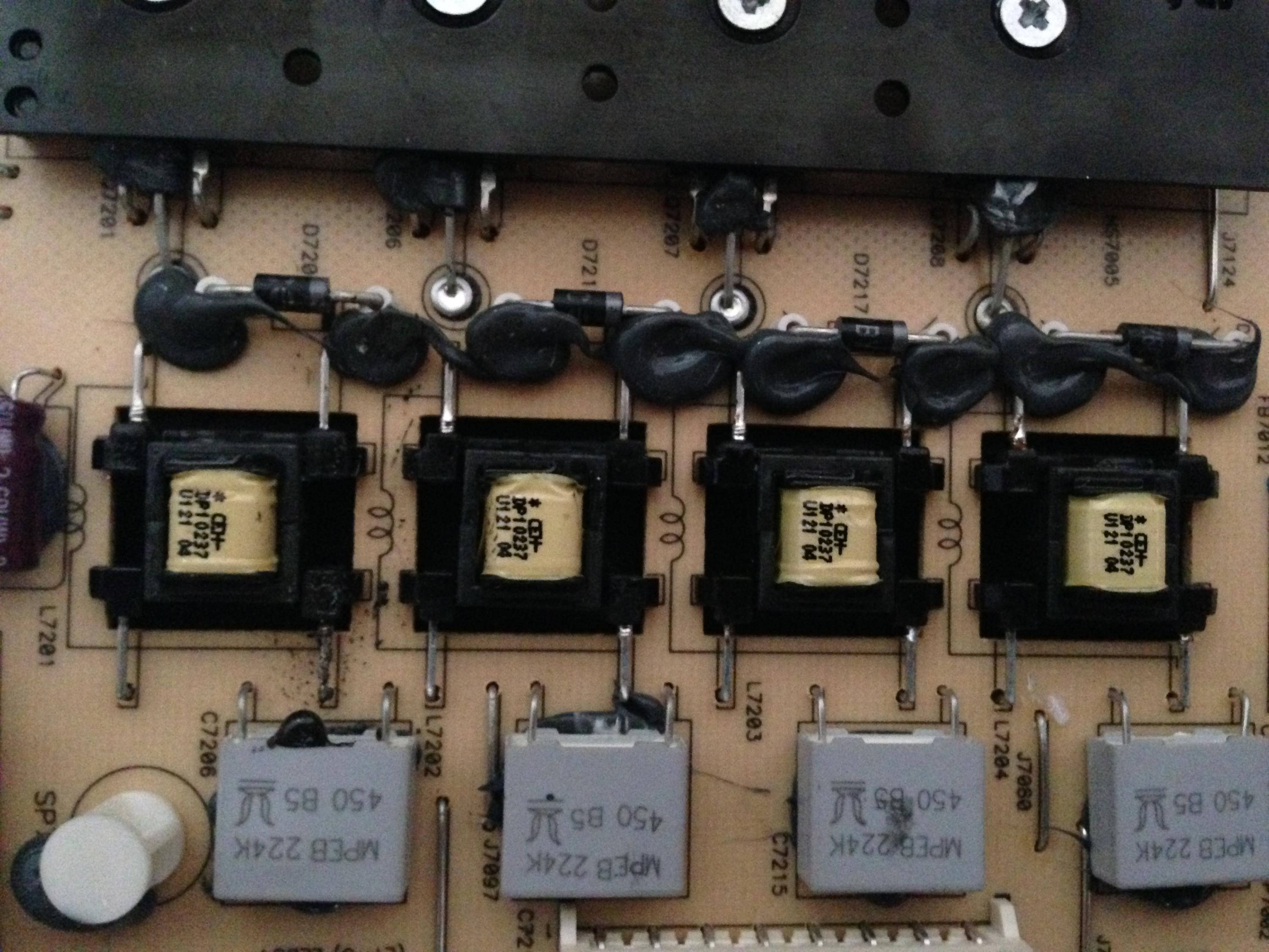

                                      I've now got a fluke multimeter in my possession. This is what I'm staring at right now. what should my next step be? I tried to do a little research and i think my particular set 60LE830U is a full array, is that right? I couldn't find any tutorial on how to actually get to the LEDs

                                          Hi Micahg, I'm a novice but since it's a slow night I'll give it a shot.
                                          That yellow thing looks like an inverter coil it's job is part of the system that provides power to the LEDs. The damage you see is the result of an 'overload' too much current going through too small a wire!
                                          As I understand from this forum the LEDs are wired in series like old school Christmas lights one dies they all go down. But because of this relatively high voltage is required( wiki kirchoffs law& ohms law)
                                          Good engineering and design tries anticipate contingencies especially where safety is concerned, so system have protection circuits to indentify faults and protect the system. You overrode that system.
                                          I'm really don't want to sound preachy it's a good idea to start your own thread that is specific to your problem and do as much self study as you can.
                                          That said do you still have indicator lights or blinking codes?
