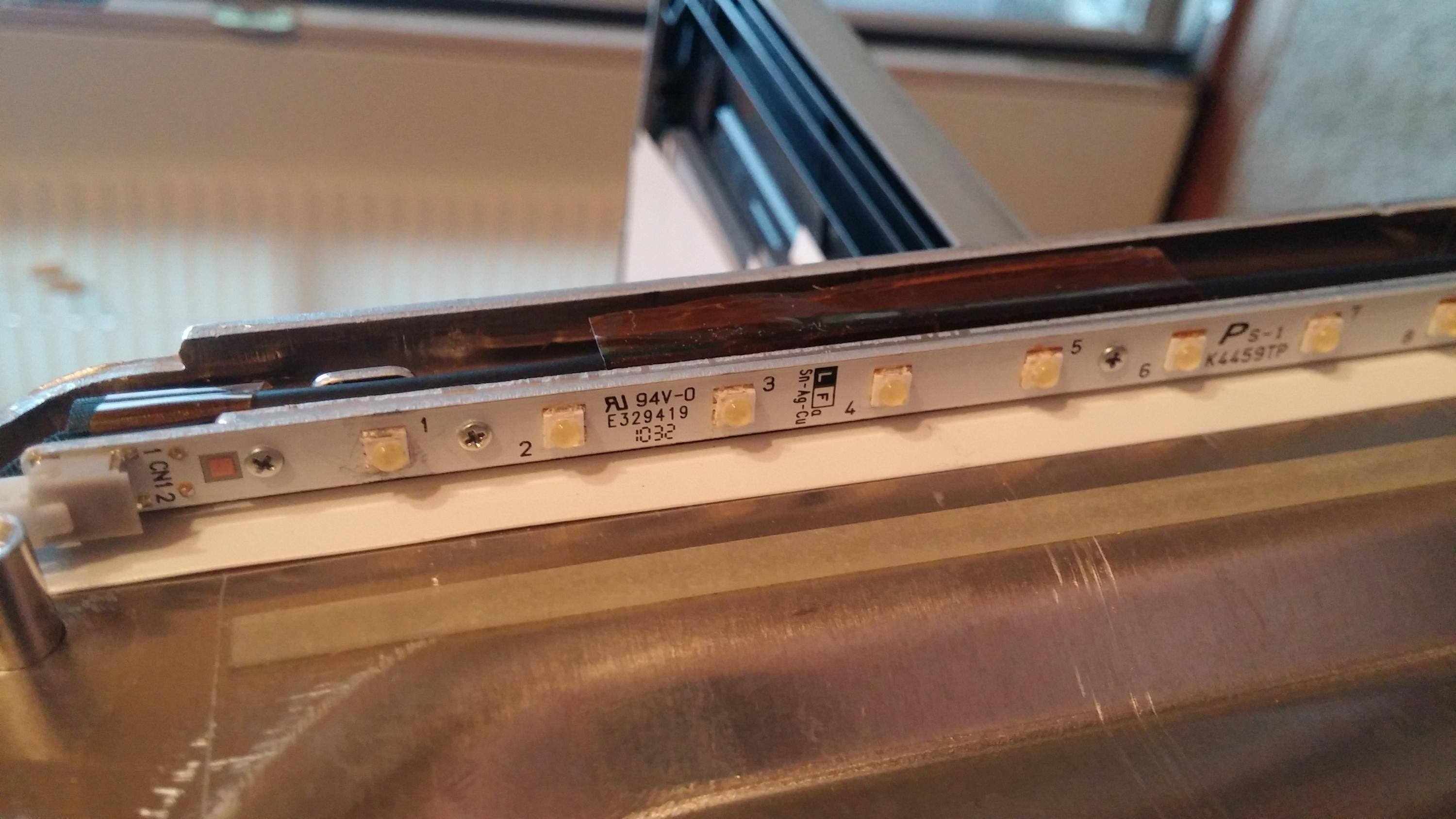

              Hi, my Sharp LC-60LE810UN TV bit the dust Friday night. Lost pic & sound with inverted V flashing 1 fast & 1 long. I came across your web site, followed some advice and by holding down -vol., +channel, & pwr buttons simultaneously now have sound, very dark picture, and steady lite inverted V. I can turn the TV on & off with the remote, however, the picture cannot be seen. It's there, however, there is not enough illumination to make it visible. Reading different comments regarding this particular TV makes me think that a LED may have gone bad affecting a whole strip. Does that sound plausible? My electronics background is limited to having worked in the telco field in construction. I enjoy the forums and have become a member. TIA, Carl.
              • freakaftr8
                • Oct 2012
                • 3743
                #67
                Re: Sharp Aquos LC-60LE810UN troubleshooting
                Yes Carl. You most likely have a burned out led in one of the strips. Check the first led in the upper right hand corner for some reason this one likes to go bad first. Use a dmm in diode check mode to get each led to lo ight up.

                    I have a sharp LC-60LE810UN and i am getting the one short one long. Took the tv apart and tested the 316 bulbs and found the bad one on the one of the strips that has 30. I have been unsuccessful of finding an affordable replacement strip. Does anyone know where to get one or how to cheaply fix the existing strip(not sure if i can replace the bulb with a resistor or another bulb).
