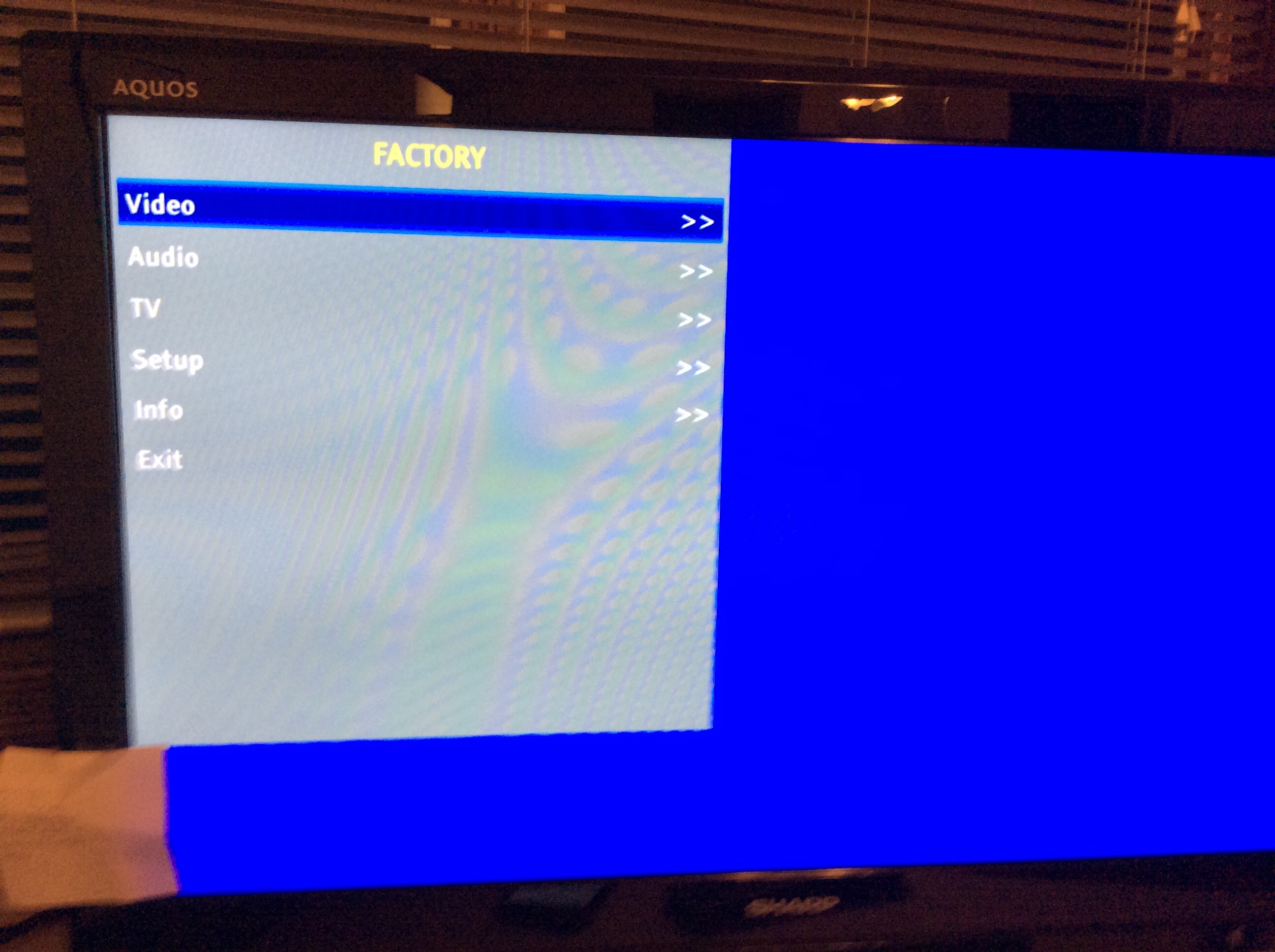

                      LC32LE440U Similar model/problem. Can't access service mode to reset lamp error. Manual says hold menu plus key in 3481. Presumably on remote (how else?) but TV doesn't see remote. No blinking LEDs on front. All back lights seem fine. On cold mornings TV can start and work 100% fine. But if turned off won't restart as (presumably) warmed up a little by then. Tried all listed optioned for entering service mode via side buttons and remote with no luck. Maybe next time it works I can enter service mode then? Would love to know how to get into service mode to reset on this model or find correct resistor to jump.

                          Hi. Was that for my 32" Sharp? I did try it as it's yet another suggestion as to how to get into service mode. Alas it did not work. The red LED on the front is unmoved and TV appears to not recognize any remote command. The led will turn green if I use the power button on the TV. Remote batteries are fine. When, on the rare cold occasion the TV works it recognizes the remote and all inputs and instructions. Vexing issue really. Just need to reset those lamp error codes or jump the component on the led board if you happen to know which it is. Thanks.

                            Hmmm... A small sign of life. The service manual says to enter service mode you hold menu and key in 3481. I assumed all on the remote. But menu button on the TV and numbers on the remote turned the red led to green so I think maybe it did enter service mode. But without an image on the screen there's not a lot I can do with it. Hopefully a cold start will work to light up the screen in the morning and then I'll enter service mode. Again hopefully.

                                  Hi. So, the TV finally came on and I was able to access the factory menu. Service model. By keying menu 3481 on the remote one after another. Not holding menu while keying the numbers as the manual seems to suggest. Problem is, there is no lamp error reset option anywhere in the factory menus. Should I just restore back to Factory a Reset?
