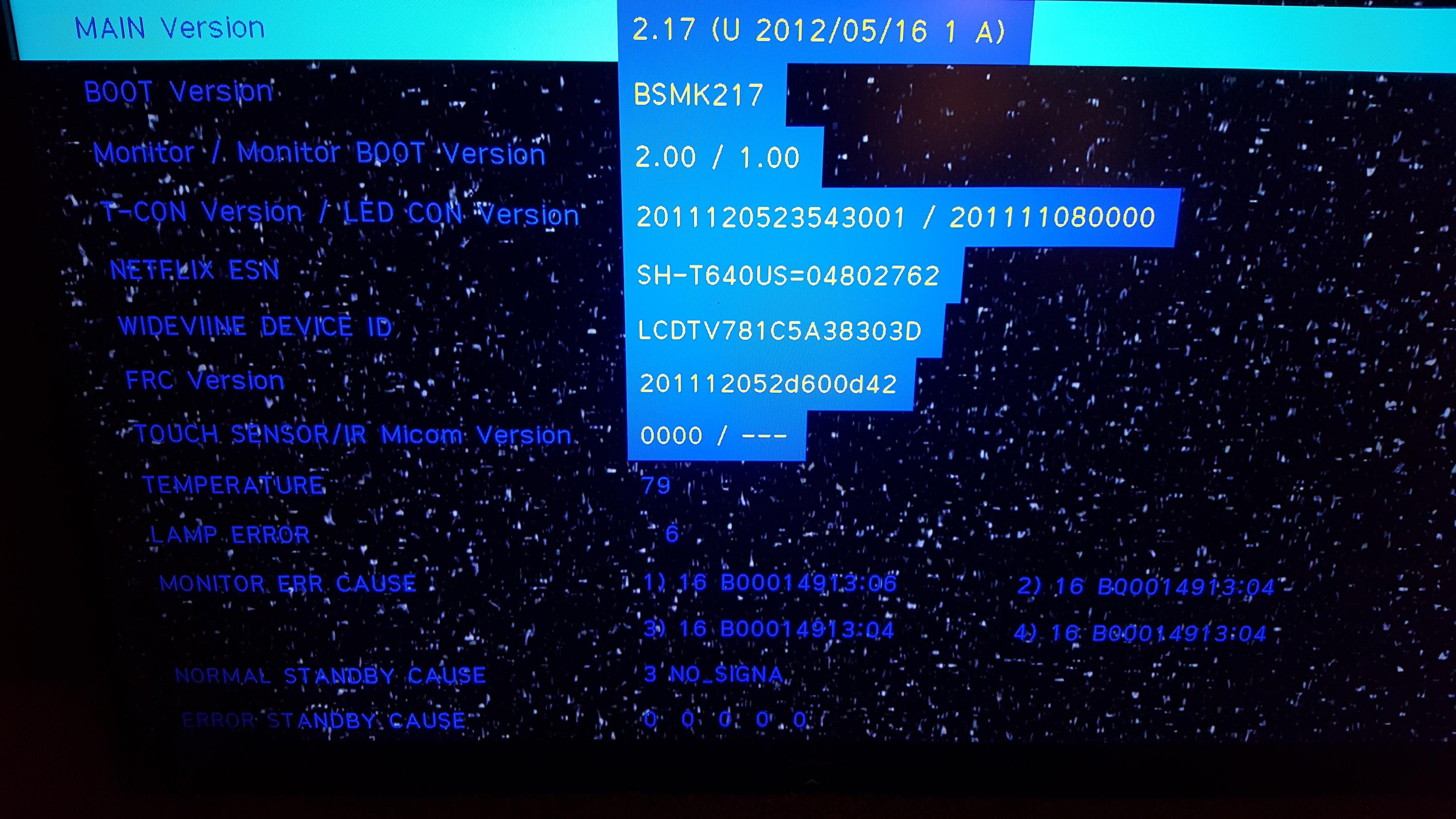

      Hi and thanks that testing of codes on power-up got my tv on with leds lasting only 2 sec as usual but the rest works got sound and picture just no backlight and a constant inverted v light thanks aggain

        The mainboard must generate only one signal the power supply gives it if backlight is in error. All other errors are generated from mainboard. Off the error pin if it goes high it generates a power supply fault codetwo quick flashes 5 slow flashes. The error pin stays low all tje time. Without or with the backlights working I believe the mainboard monitors this by the balancing of the data and clock signals generated by the backlight driver. The pins are called adl and acl
        I have sharp LC-80LE632U tv I have no picture at all. was watching and the screen went blank. I tried a factory reset and flash light to see if the screen was on but it wasn't. I not sure if the back light is bad. The service manuel they show the componet positions and interconnections. The light is white and steady flashing when you turn the power on with the remote it goes out like power came on but the screen is still blank. Is there anything else I can do before I open this beast up. I would much appreciate any type of input.
        Thank You.

                        service manual shows input vol- at the same time in plug in TV but when I try to do that I get the one flash two flash sequence I can't get it into service mode. the only way to get this set to turn on is to hold down the volume down channel up button at the same time but that wont allow going to the service menu
                        What was the fix for this? I am having this exact issue and the fix was never posted. I am having these EXACT same issues with a Sharp LC-70LE374U. If I hold the vol+ and channel- when I start the tv, the tv works great.
