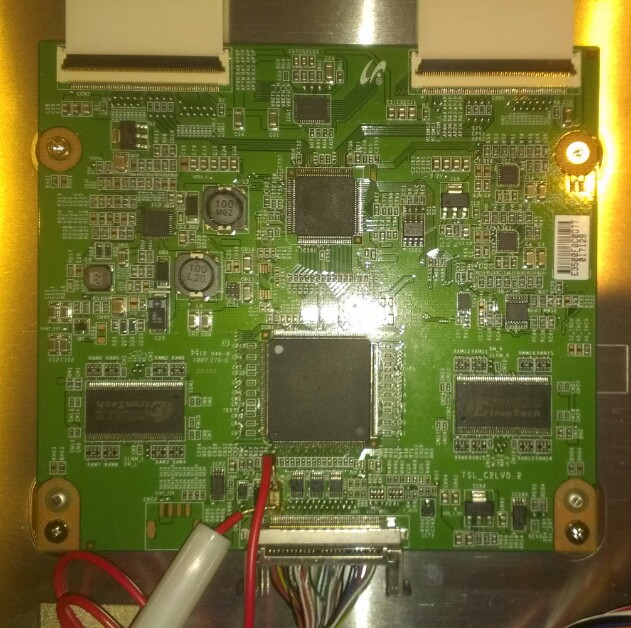

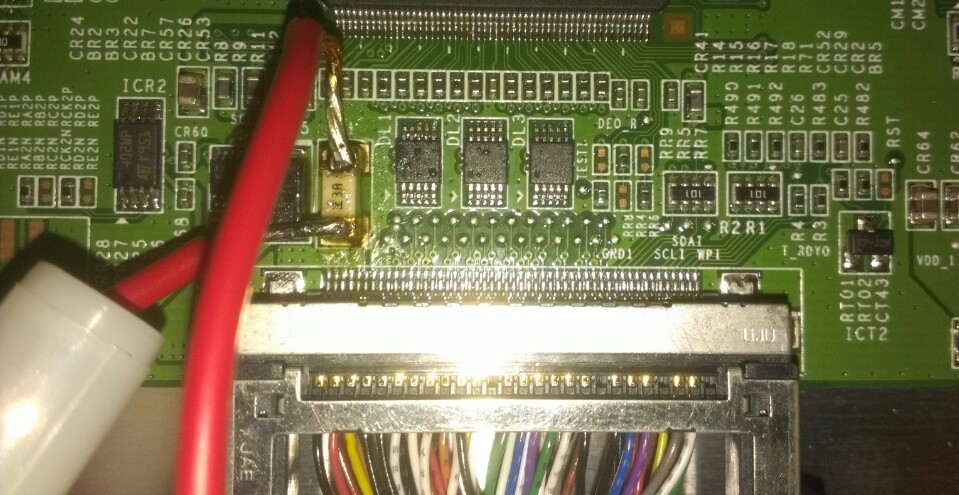

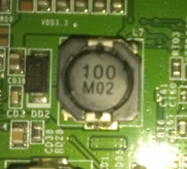

      Re: Sony KDL-46ex600 T Con fuse blows
      Thanks budm. Pictures posted. I took a closeup of the inductor coil that seems to be a little discolored though I cannot tell for sure. Is there a way to test these? If I measure across them on the exposed terminals, both show 0 ohms. Is this worth repairing or should I be looking for a replacement board?
        I would disconnect those two white ribbon cables that go the panel, then put in the new fuse and see if the fuse will still blow (you can set the meter to DC AMP mode (put the probes in place of the fuse) so you can read the current draw), if not, it may have bad TFT drive ICs. I can see that it has 3 switching power supplies.

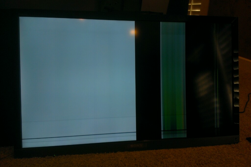

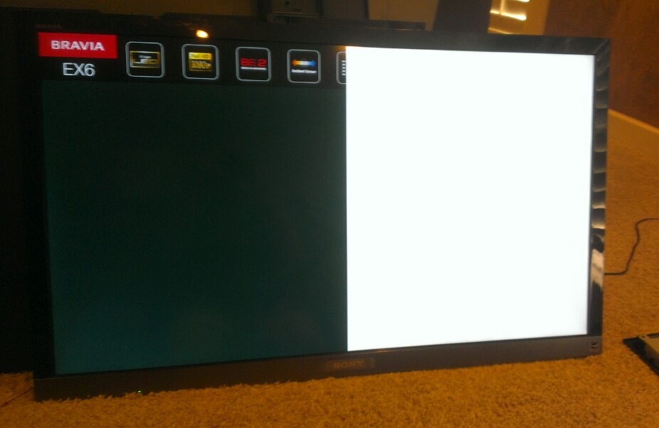

              Thanks tom and budm. Making progress! I have attached pictures. With left hand ribbon connected and right hand disconnected I get perfect picture on left half of screen. With left disconnected and right connected I get as shown in the picture. Definitely something wrong with the right hand side of panel / drivers / tcon. Hope this helps you guide me to next steps.
              Thanks.
              DK
                That is bad panel TFT drives, I had the same problem in LG 47", see post 10
                  I think you have a defective tab driver #6 from the left. Probably not repairable unfortunately. You can try checking for obvious shorts but the IC is probably bad.
