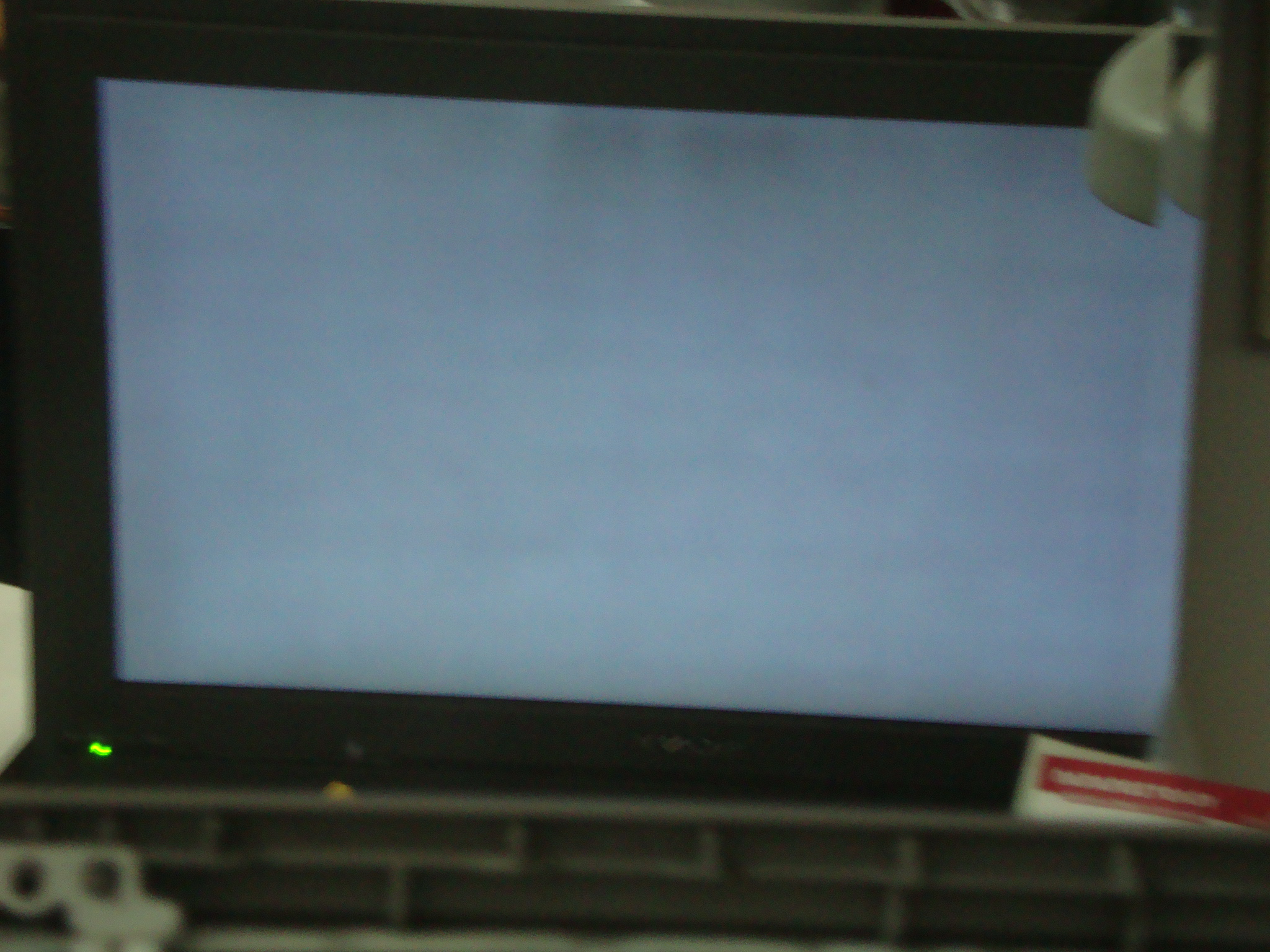

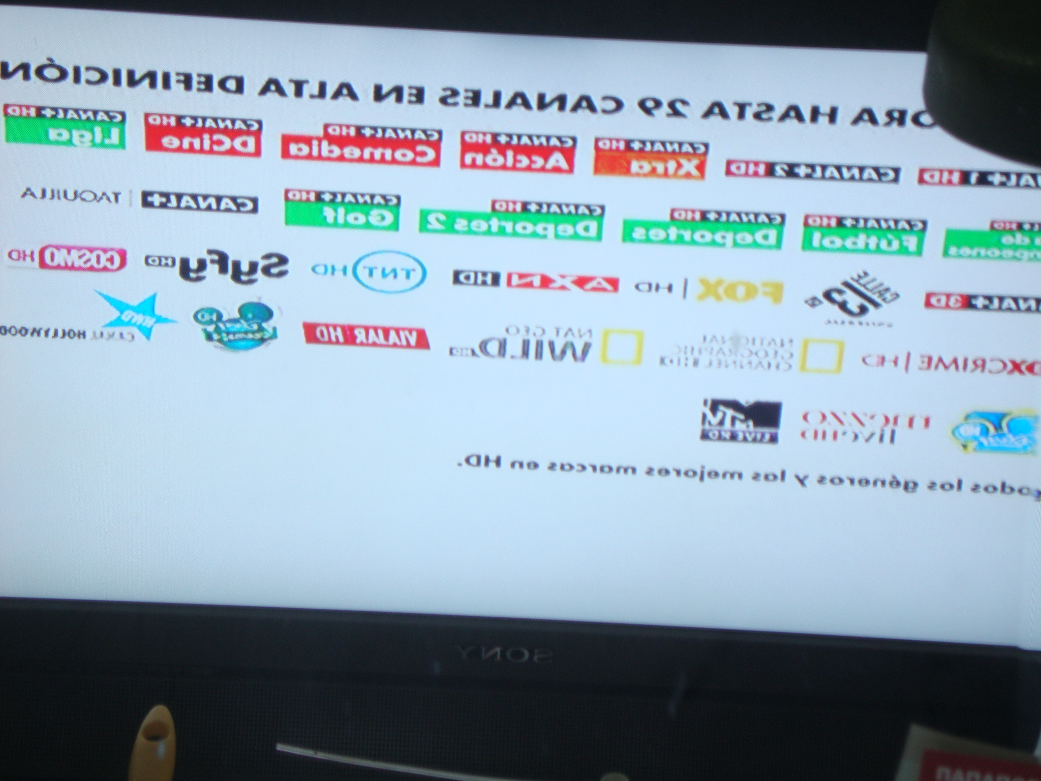

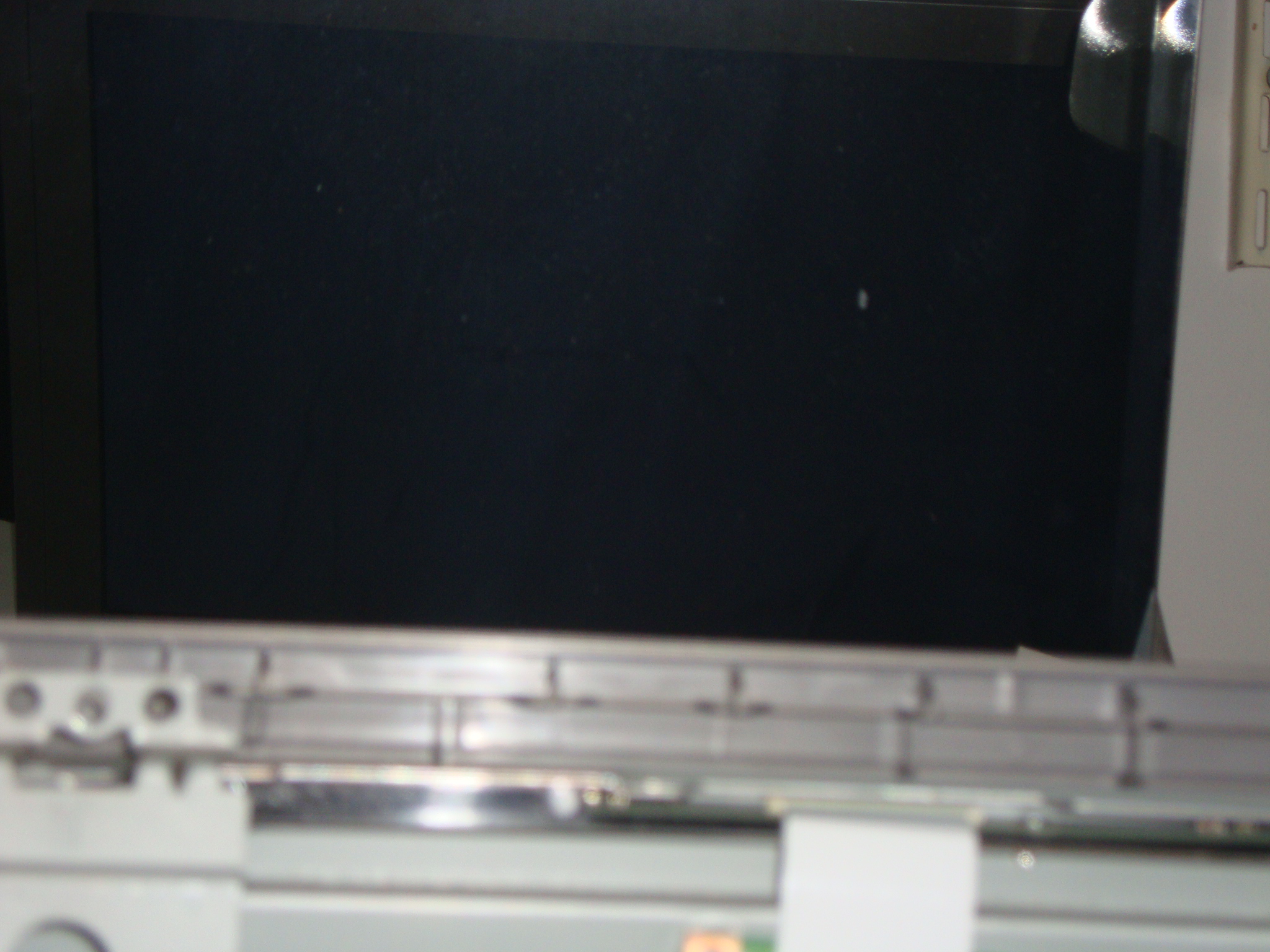

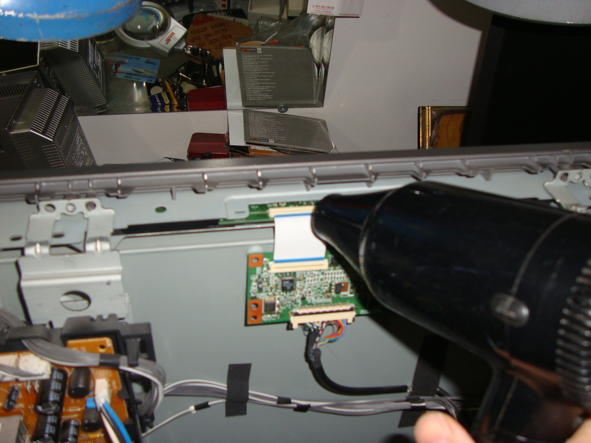

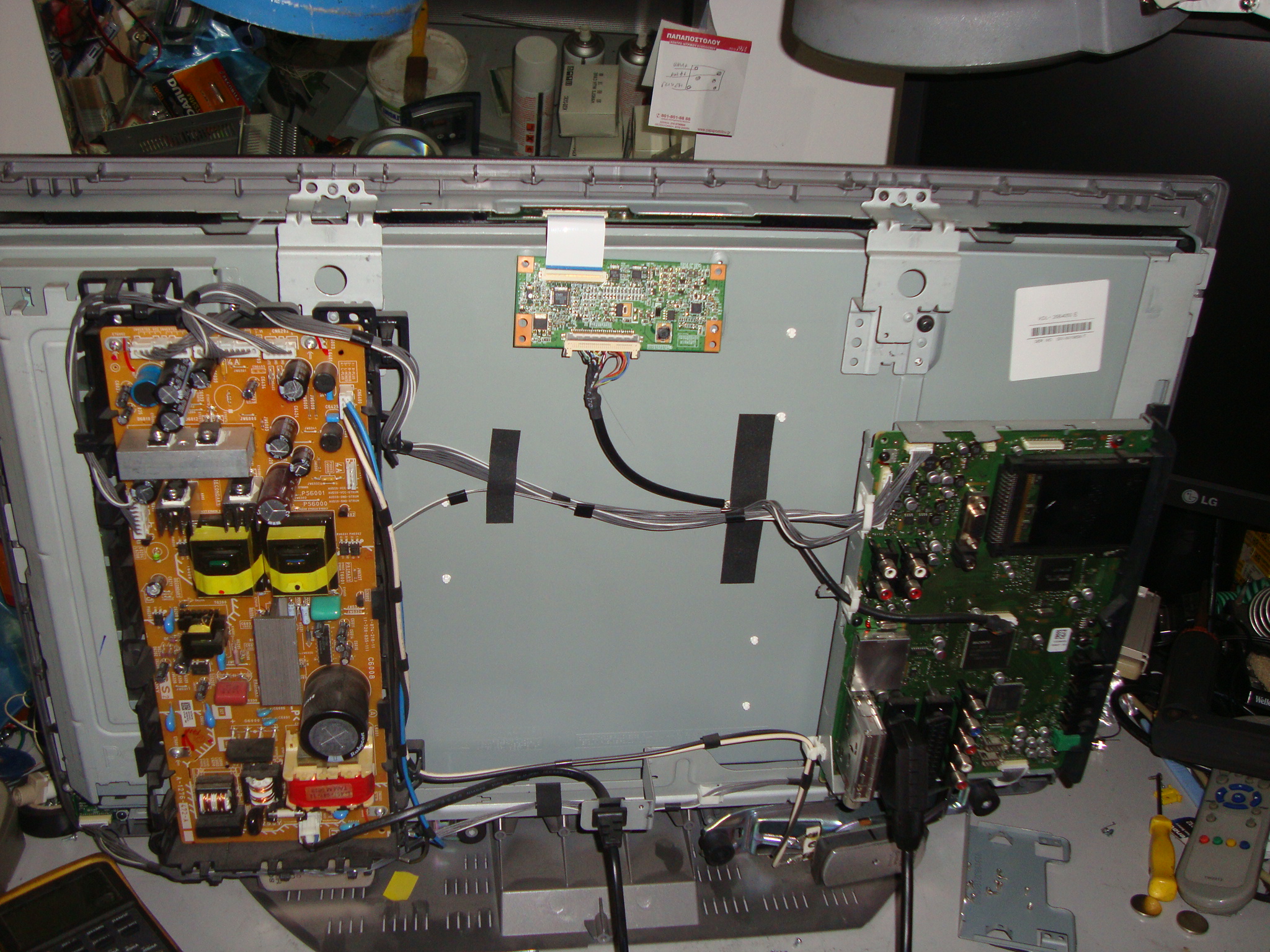

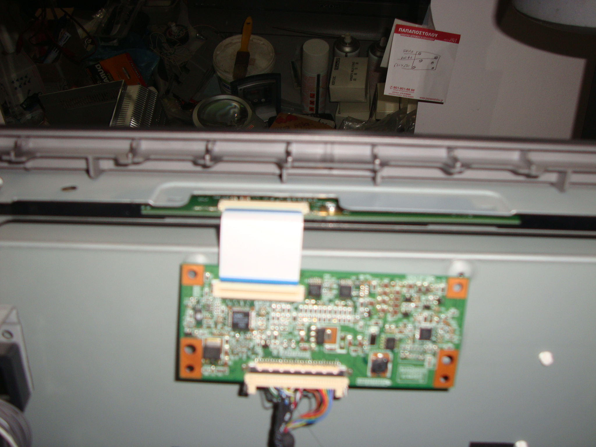

      Hi, i have the same problem.When i warm the board located above the TCON V260B1-C01 , image comes.First i replace TCON V260B1-C01 whith another one and i had the same problem...Have i problem whith panel????

        pictures of boards and one of all boards in one shot

            Bad tab bond fault. Common fault, not too bad to fix:
            http://www.youtube.com/watch?v=mMo3NBGLwH0
