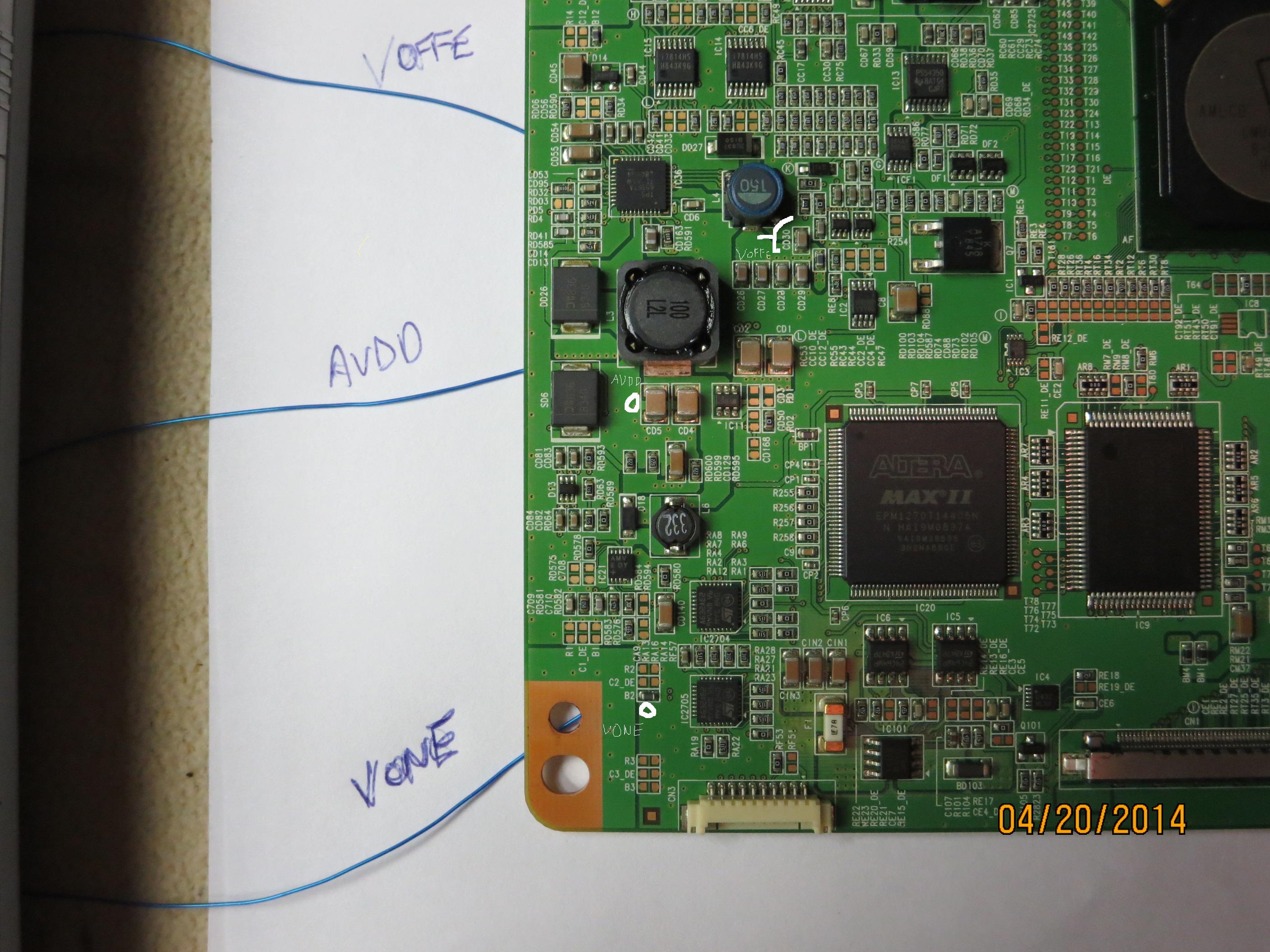

                    #89
                    Re: 2008/9 Samsung LN55A950 Displaying Horizontal Lines
                    OK, so there is a good chance the panel is OK.
                    I cannot guarantee it! but it seems good.
                    Typically VONE and VOFFE are generated by same circuit using a "charge pump".
                    Confirm my suspicion in this photo is the bottom left hand corner where VONE is (on the other side of course) and middle left is where VOFFE is?
                    https://www.badcaps.net/forum/attach...6&d=1397956532
                    If so can you get clear photos of each area.

                      #90
                      take a look at post #80 - white screen pic. I'm wondering if this set is worth the $100 FOR THE TCON board. The bottom left corner has a dark spot all though the LED lighting is in grid format on these sets. Maybe that dark spot is related to the TCON board ??
                      I'm gettting the pics for u now.

                          #92
                          had a little fun ! pic show where signals are roughly.
                          I have seen one of these working - pretty impressive pic. Have a couple SONY BRAVIAs - also impressive pic
                            #93
                            TPS65167 is the IC which controls the VGH, VGL and AVDD generation.
                            Check D14 is not shorted/open, it's just above the IC.
                            If that's OK, then replace the IC... That would be my guess as what to replace, if you feel confident in replacing it, it's available:

                                #95
                                diode D14 (KJH v9) is open. trying to cross it over to an obtainable part

                                      #98
                                      You can buy BAV99W from Digikey, but it reminds me of when I did this, I also had bad VGL circuit and used 1N4148s to repair it:
                                      https://www.badcaps.net/forum/showthread.php?t=33134

                                        #99
                                        have plenty of room - I'm going to try 4148s

                                          #100
                                          no change in voffe - same symptoms. ordered a TCON board - this one is toast.
                                          might have something to do with black heatsink ice cold.
