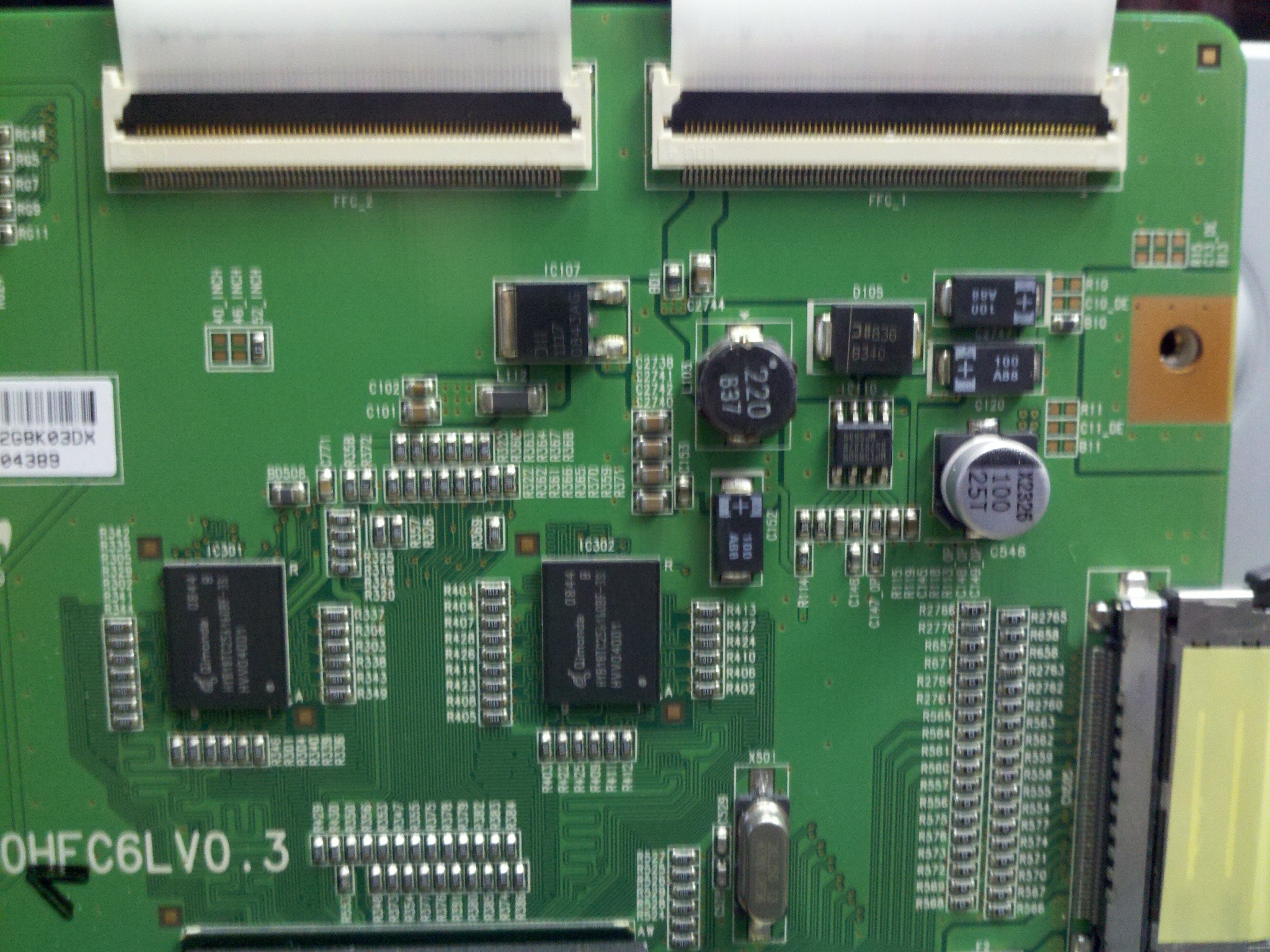

                          #72
                          Re: 2008/9 Samsung LN55A950 Displaying Horizontal Lines
                          When I first turn the set on - white screen. push menu button - have some faint vertical lines on left side. doesn't display anything legible. looks like the tcon board isn't doing anything. black heatsink is cold. chip with rubber heatsink is warm (metal can container is heatsink - not shown on pic).
                            #73
                            I need to be able to see the very fine print on that board, can you get a picture in focus? If not possible at a further distance, break it into quarters and take a photo of each, with a little overlap. Sunlight is a great diffuse light source, avoid flash if possible.
                            • ajshoe
                              ajshoe
                              • Dec 2012
                              • 477
                              • usa
                              #74
                              When tv first turned on - (takes about 20 secs) totally white screen. press menu, screen has color vertical bars. phone pics of TCON board close up (4 quarters).
                              apologize for pics - camera battery is dead and can't find charger ! noticed that TCON board is not readily available
                                #75
                                Can you see any labels VONE, VOFFE, AVDD as I can't...
                                • ajshoe
                                  ajshoe
                                  • Dec 2012
                                  • 477
                                  • usa

                                      #78
                                      OK - signals are label on back of board - see pics (found camera charger - real camera pics !)
                                      AVDD is pic 1 top left, voffe is middle left, Vone is very top left
                                        #79
                                        It's a bit awkward but can you solder wires to each of those points, label them or colour code them, and test with board in place? Note, be very careful not to short them you could damage the panel or t-con.
                                        • ajshoe
                                          ajshoe
                                          • Dec 2012
                                          • 477
                                          • usa
                                          #80
                                          can do - VONE, VOFFE, and AVDD (there also a AVDDb). what am I looking for ?
                                          turn power on - 30 seconds later - have totally white screen. see pic
