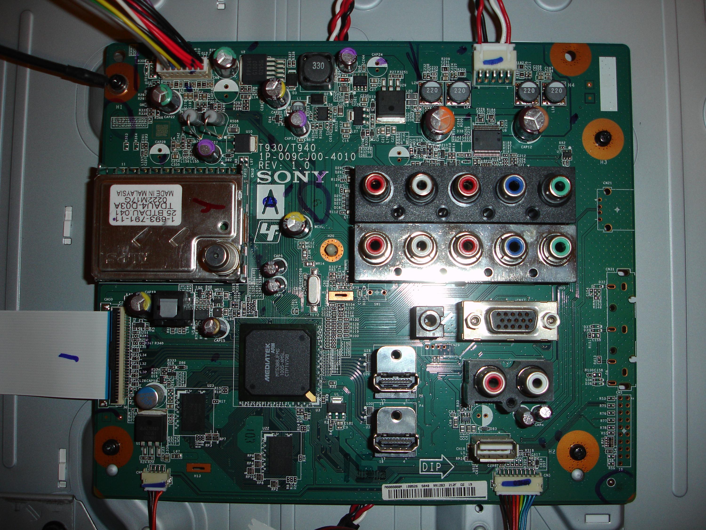

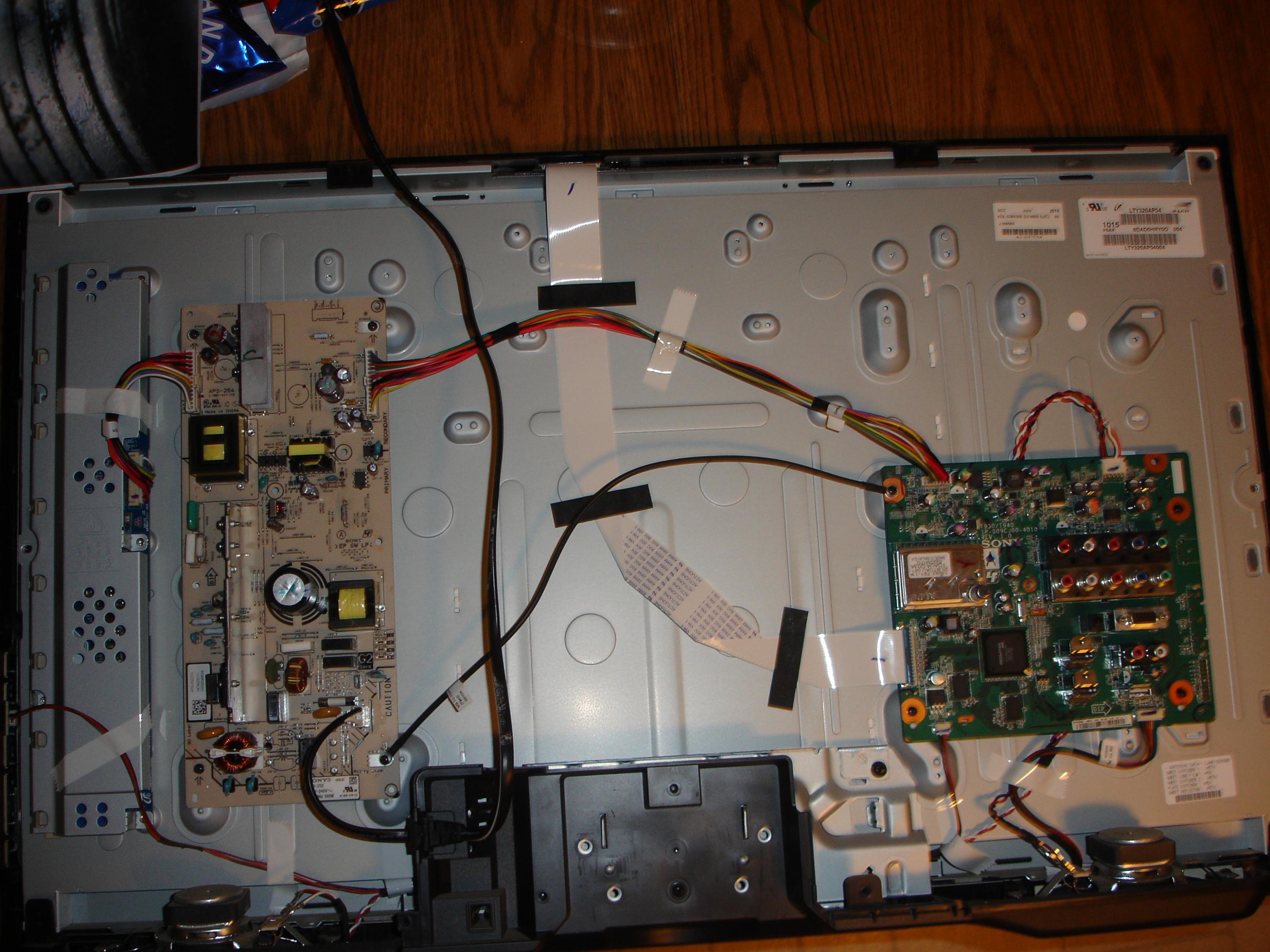

    Sony Bravia KDL-32BX300 No Standby Light
    I received this TV from a co-worker in order to fix. He claims that the TV got hit by lightning. The unit has no standby light turned on but the power supply does have standby voltage of 3.3v. I am thinking that the main board has a problem. Any ideas?

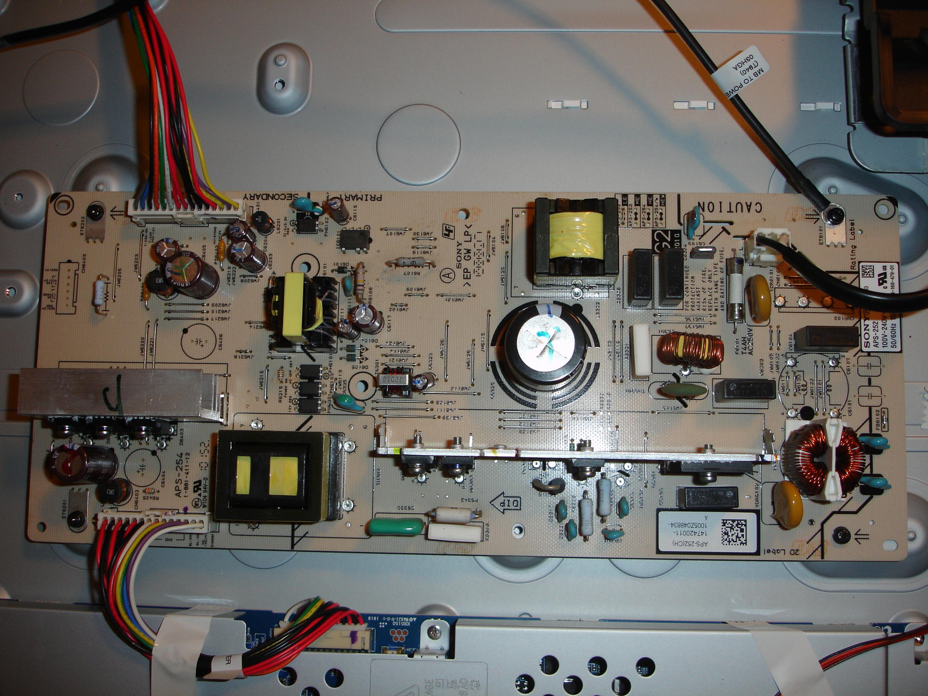

      Re: Sony Bravia KDL-32BX300 No Standby Light
      There are two yellow fuses on the power supply board by the white connector that goes to the main board, are they OK?
      You should download the service manual:
            Hey guys, any other ideas?
                      Okay, here's what I tested.
                      CN6401
                      1 STBY3_3V = 3.3V
                      2 AC OFF DET = 2.0V
                      3 POWER ON = 3.28V
                      4 AUDIO_12V = 0V
                      5 AUDIO_12V_GND = 0V
                      6 REG12V_GND = 0V
                      7 REG12V_GND = 0V
                      8 REG12V = 0V
                      9 REG12V = 0V
                      10 BL_ERR = 0.05V
                      11 BL_ON = 0.04V
                      12 DIMMER = 0V
                      13 NC = 0V
                      14 T-CON_VCC_12V= 0V
                      15 T-CON_ON = 0V
                      CN6402
                      1 UNREG24V = 0V
                      2 UNREG24V = 0V
                      3 UNREG24V = 0V
                      4 UNREG24V = 0V
                      5 UNREG24V = 0V
                      6 GND = 0V
                      7 GND = 0V
                      8 GND = 0V
                      9 GND = 0V
                      10 GND = 0V
                      11 BL_ERR = 0.05V
                      12 BL_ON = 0.04V
                      13 NC(ADIM) = 0V
                      14 DIMMER = 0V
                      CN6403
                      CONNECTOR NOT USED
                      When I attempt to turn the unit on, the readings are still the same. Even though it does have a standby led and power led, both remain off at all times. The power button does work and is connected to the main board. The led indicators are connected to the main board via a separate connector from the buttons. Thanks guys and hope this helps.
                        OK, you have power supply board problem, it is getting the PS_ON (Power ON) but the 12V, 24V are not coming on. BUT, one voltage should change state, POWER ON = 3.28V, it should be below 1V when TV is powered OFF and 3.28V when Power switch is activated, if it does not change state, that mean the main board is also stuck on, so you may also have main board problem.

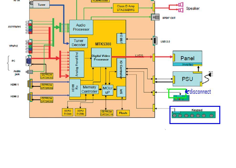

                          • anmol
                            • Mar 2012
                            • 73
                            • India
                            disconnect socket from remot control board and check power on with keypad.

                                • anmol
                                  • Mar 2012
                                  • 73
                                  • India
                                  @ dcapper,
                                  you have try as post #14 ?
                                  wbr
