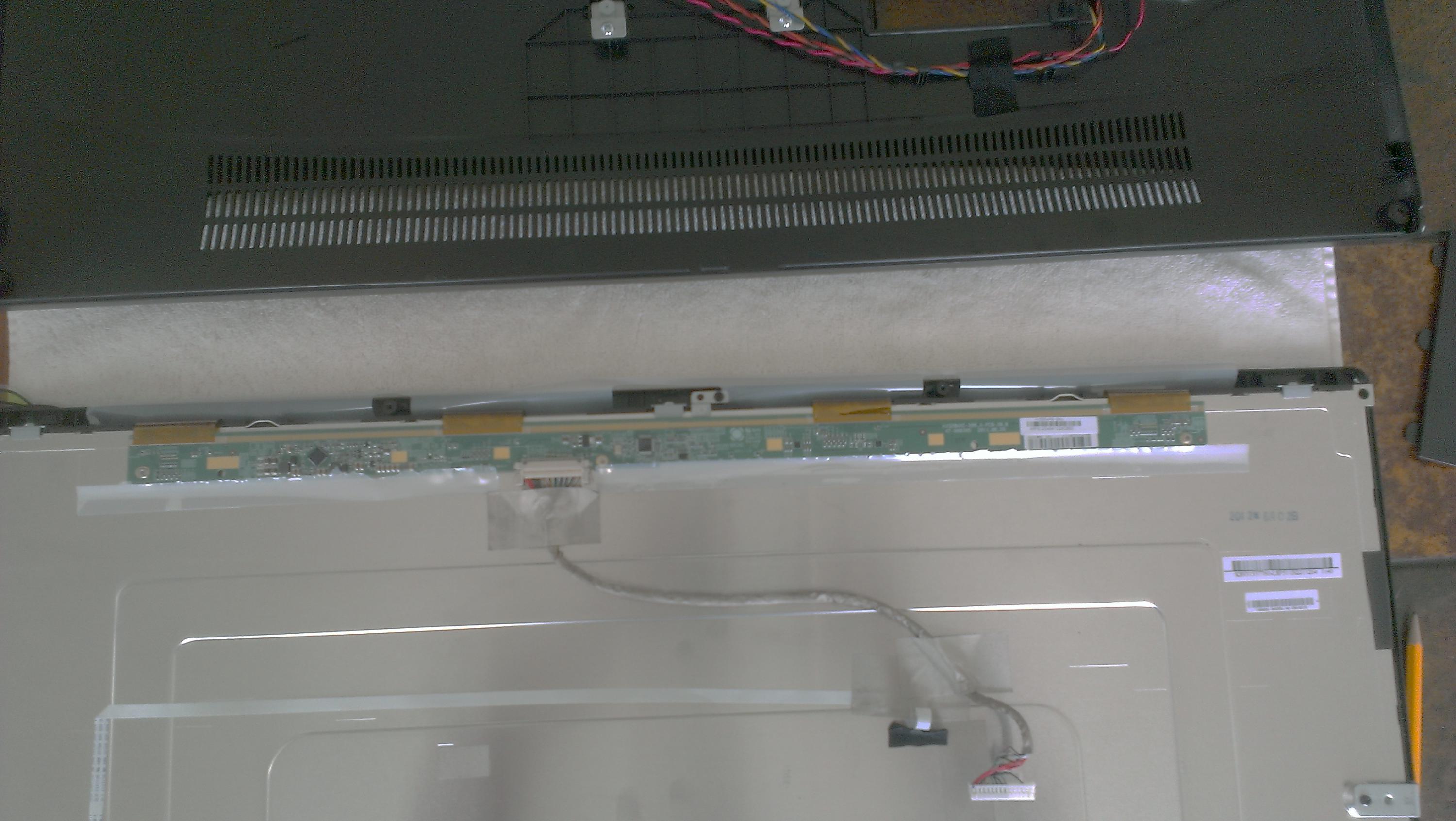

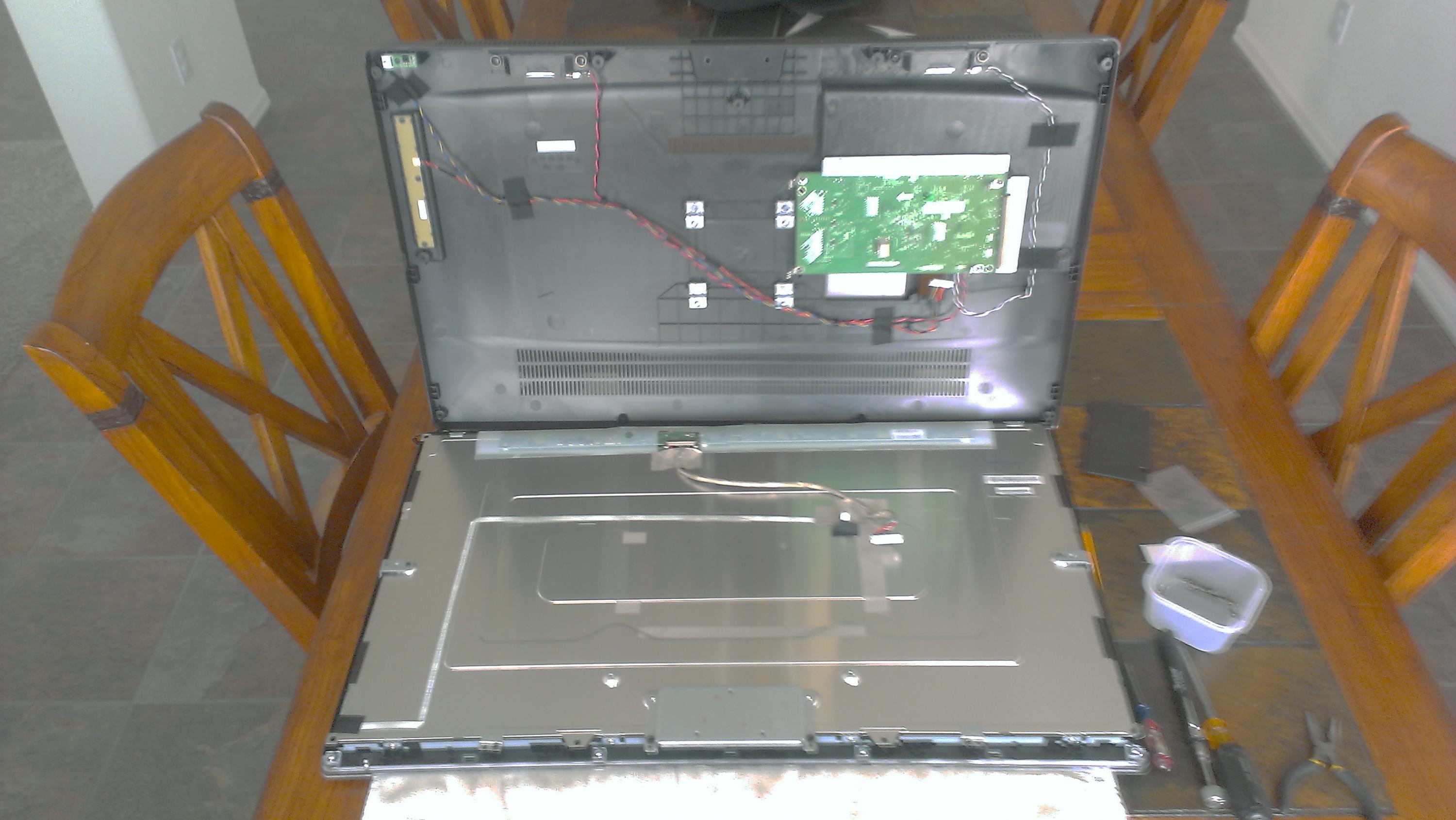

        Re: WESTINGHOUSE EW32S5UW - blank screen

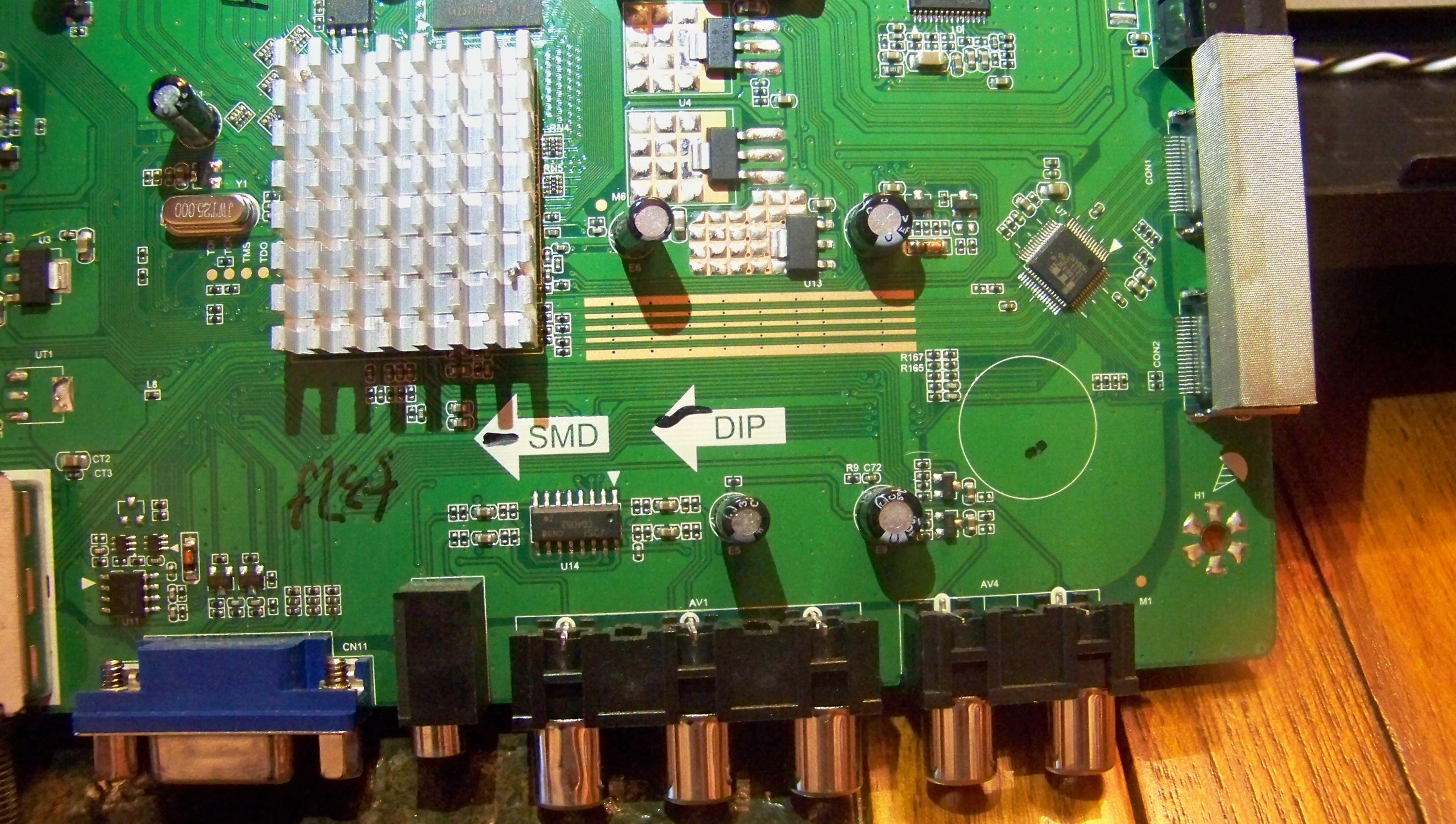

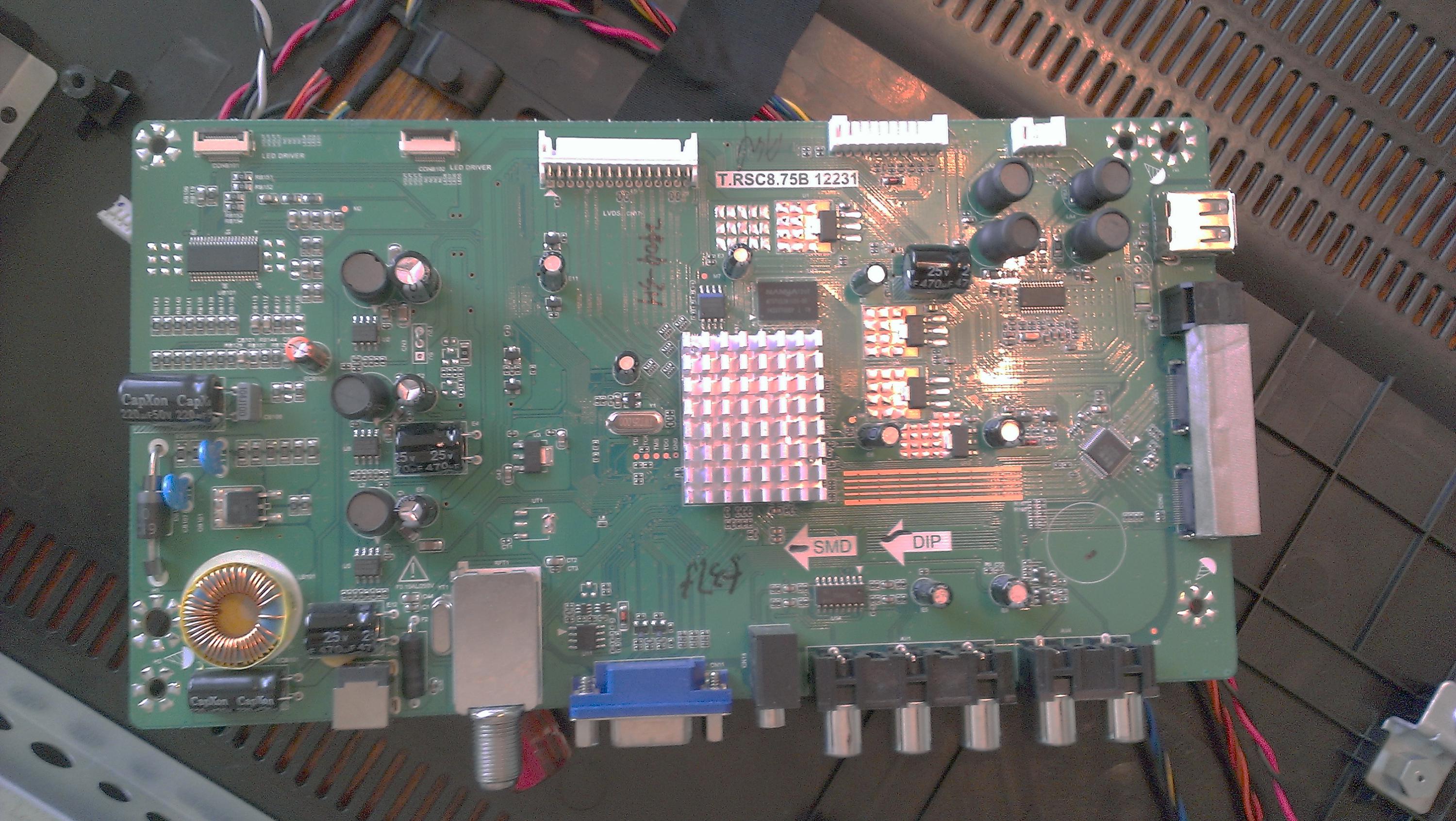

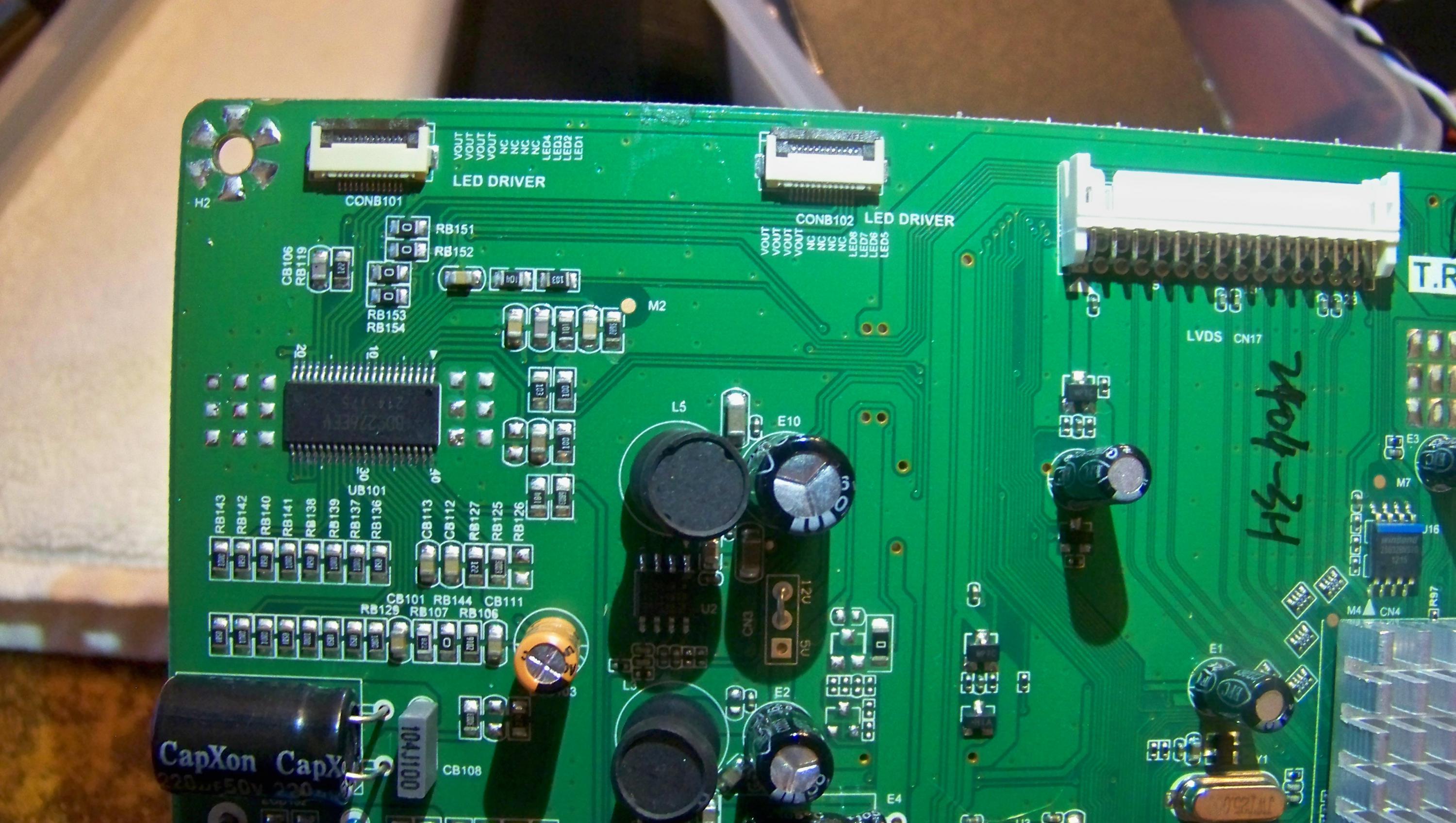

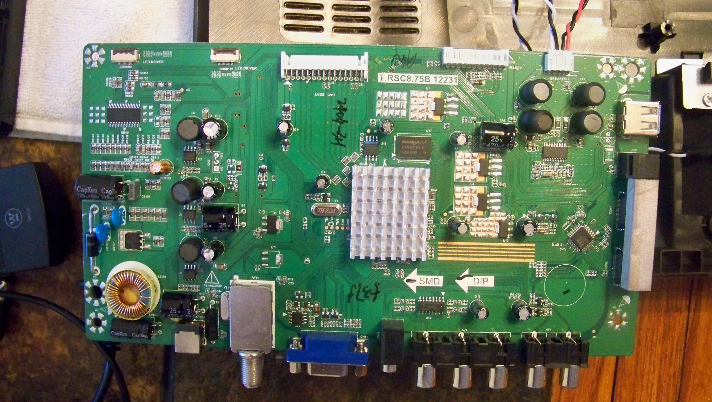

        Here are the photos if I have uploaded them correctly.
        The second one shows what it looks like just when you remove the back. This TV has an external inline power supply power cord just like a computer.
        The photo of the boards show the board numbers in case anyone is familiar with them.
        The first circuit board is the control and jack board. And the only other board that I can see at this level of dissassembly is a long thin board at the bottom of the screen. This may or may not be the problem. I just dont know. That board is shown in the photos too. Do I need to go deeper in the dissassembly?
        Anyway, if you wouldnt mind taking a look and let me know what you think....about the TV repair, not what you think about me.
        Thank you
          This is an LCD TV with LED backlights, it also uses external power supply. The pictures are not sharp so I cannot tell where the wires and the connectors are for the LEDs.

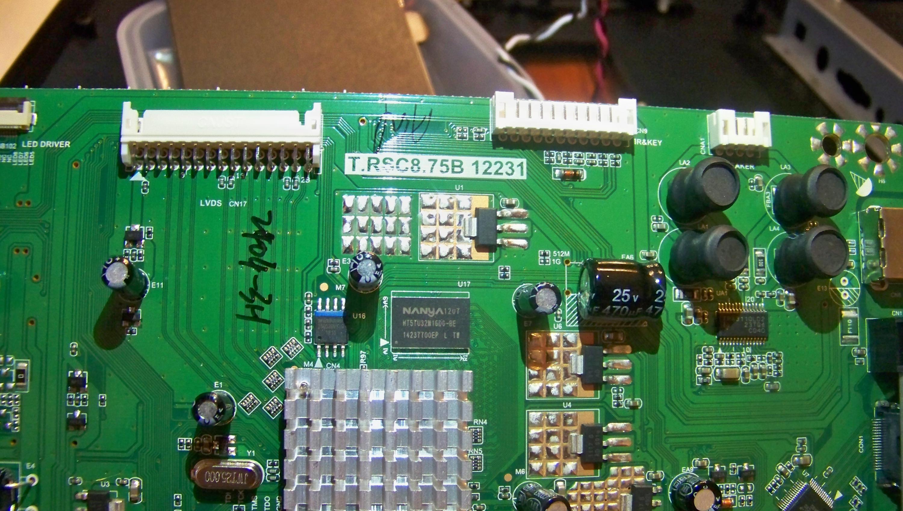

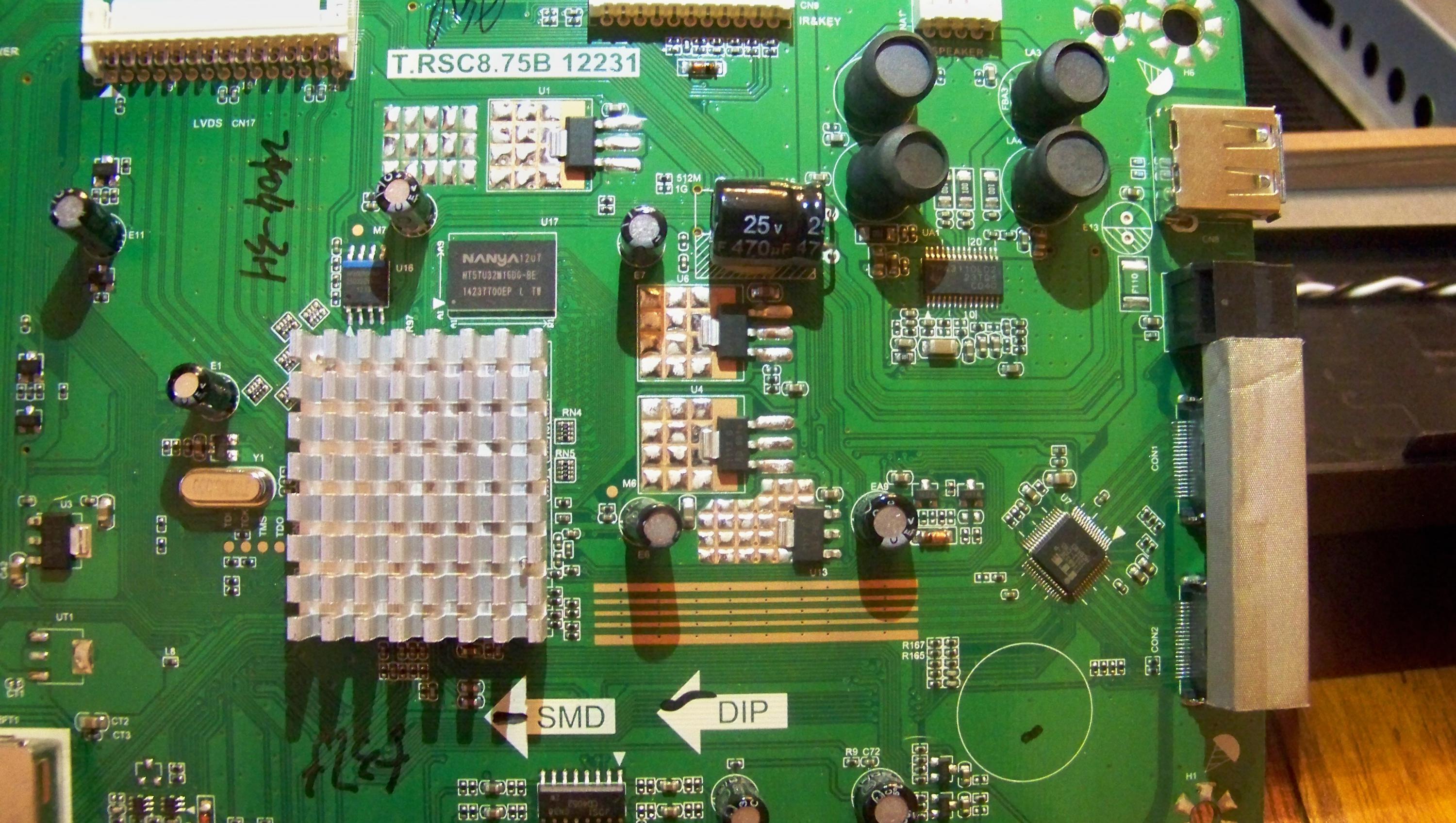

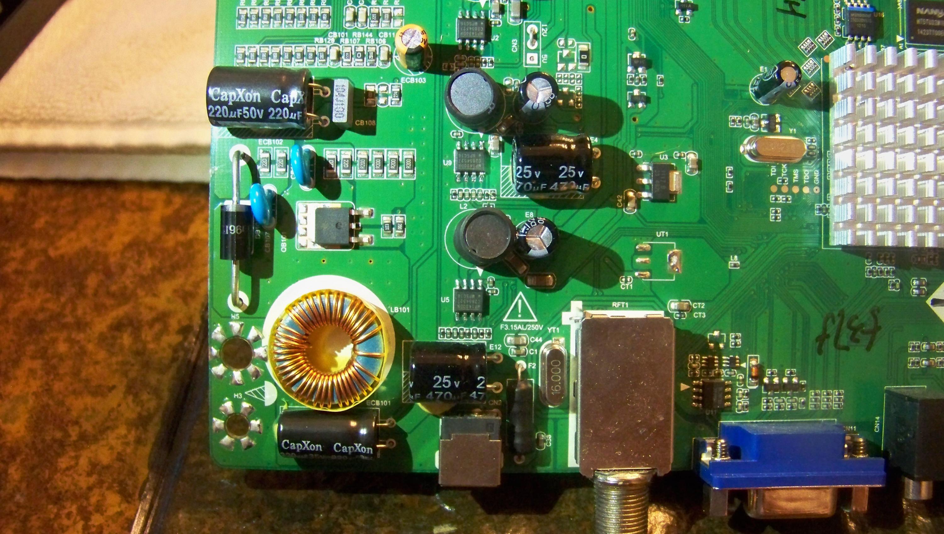

              ok, here ya go. I hope these help.
              When you look at photo 2 the two LED Driver connectors this TV only uses the one on the right (CONB102). in tracing the conductor paths they go to the black horizontal CAP (CAPXON 220uf 50v).
              Im thinking two things. They are probably both wrong.
              1. insert the LED ribbon cable into the LED driver connector on the left (CONB101) and see if that circuit works
              2. Change out the capacitor
              I dunno, what do you think?

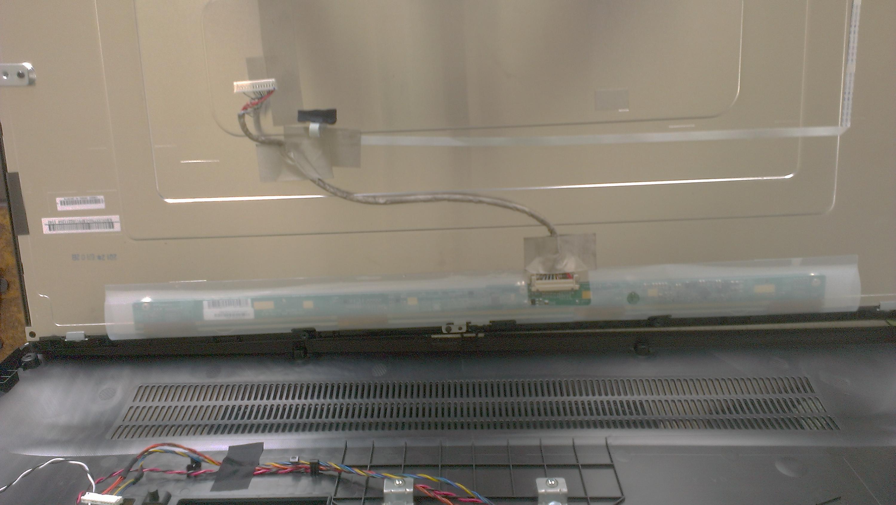

                        I know this is an old thread, but I just had the same issue on the same model. So for future searchers I found the problem to be the ribbon cable that goes into the panel was grounding out.
                        My problem was W logo flash and then nothing, back light out but with flashlight screen could be seen. All my voltages checked out correctly.
                        My solution was to place electrical tape on the aluminum frame where the cable plugs into the LEDs. I also placed 1/8" or so (couple layers of thick rubber tape) to keep the cable even for about an inch (90 degree bend). I then taped this all down and problem solved.
                        All that is required is removal of the back and unplugging the LED cable. (If broken there are fixes for this on the forum). Then just tape up the aluminum frame, cutting the tape so it goes as far into the frame as possible to prevent a short.
