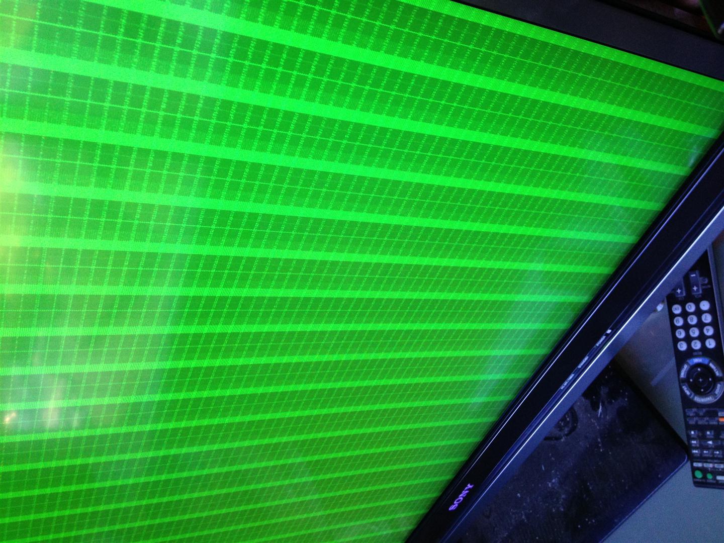

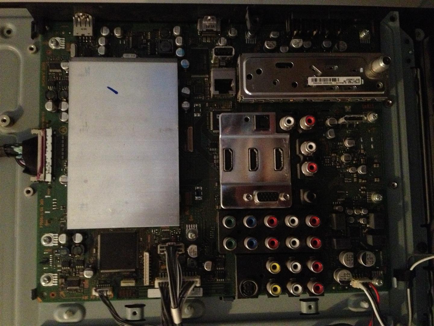

    Hello experts..
    Picked up this sony tv for free...

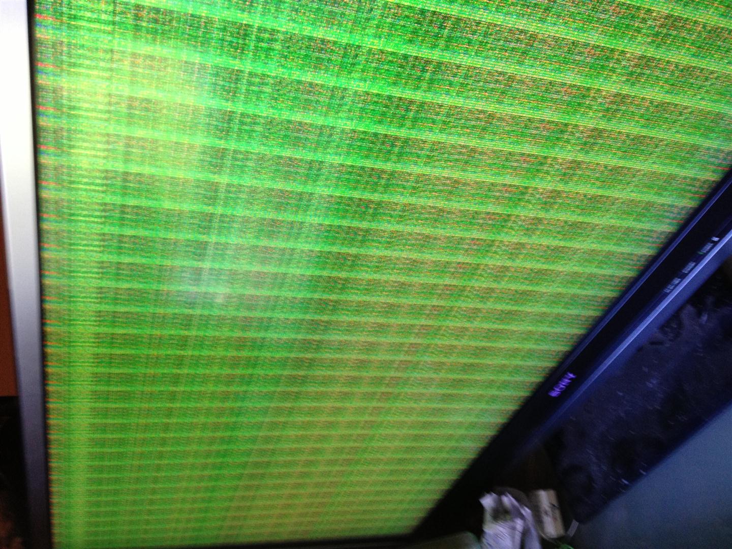

    It powers up fine,but shows this green raster on the screen(see pic)it flickers around a bit between green and yellowish.
    When I change the channel it stops flickering and goes to a more solid green raster(pic2)..
    Any idea where I should start looking?

    Re: Sony KDL-46Z4100
    Could be as simple as reseating the LCD video cable. Otherwise it looks like a mainboard or TCON issue.
      That's the cable from the main board to the T-con board,correct?? I tried unplugging both ends end re seat and also wiggle the connectors when it was on,didn't make a difference...

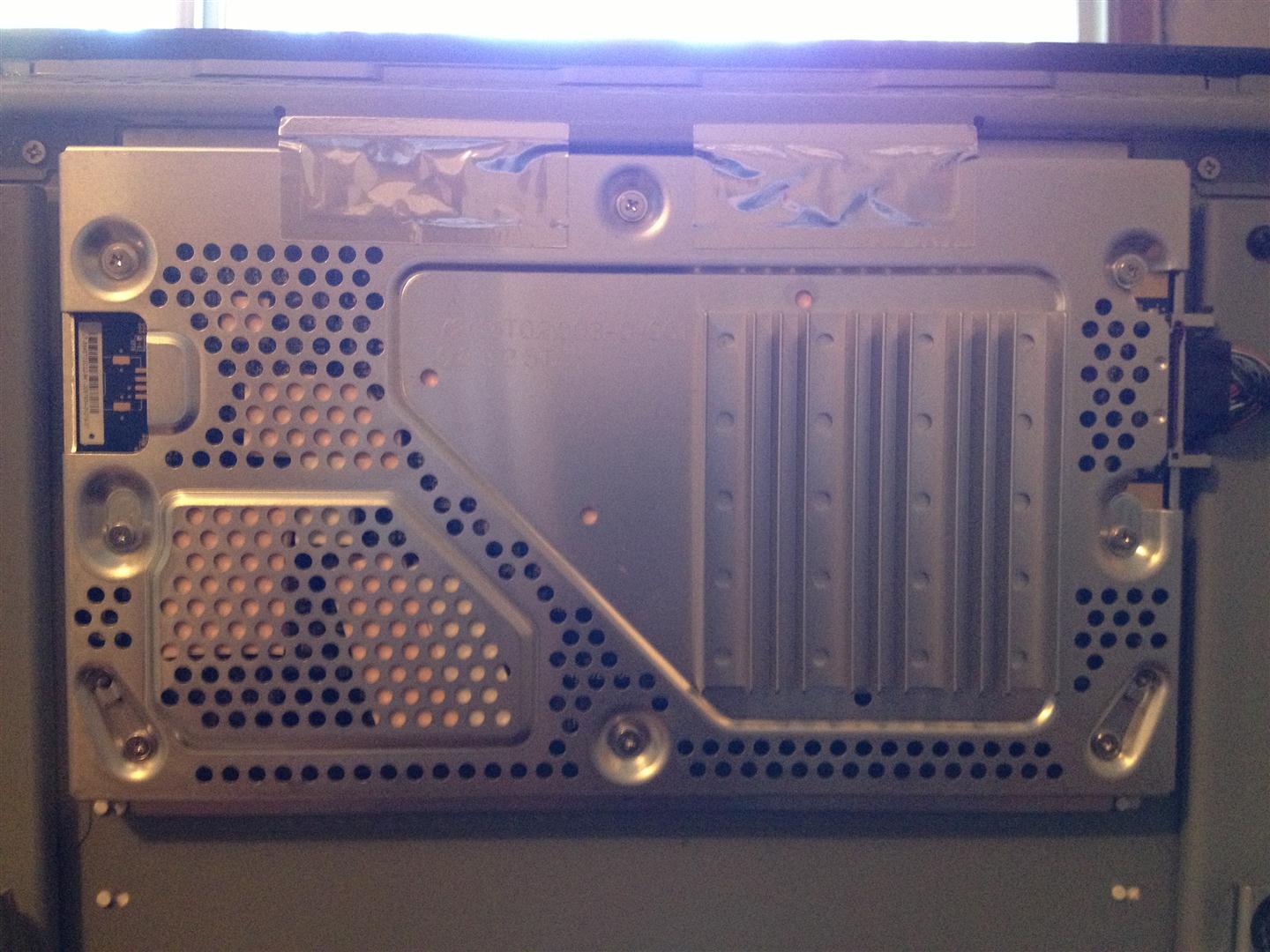

          Did you try reseating the ribbon cables from the tcon board to the panel?
          You have to remove the silver tape and metal box to get to it
          The 5th picture that you posted
              It looks like your t-con is faulty. This is similar to logic board faults in plasmas, where there's an evenly spaced pattern onscreen.
                  I'm going for main over t-con, unless the t-con has an FRC (120/240Hz converter) in which case I'd say 50-50 t-con or main.

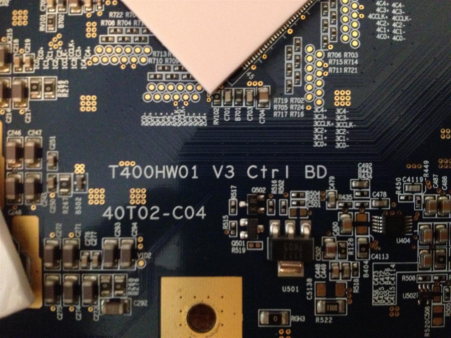

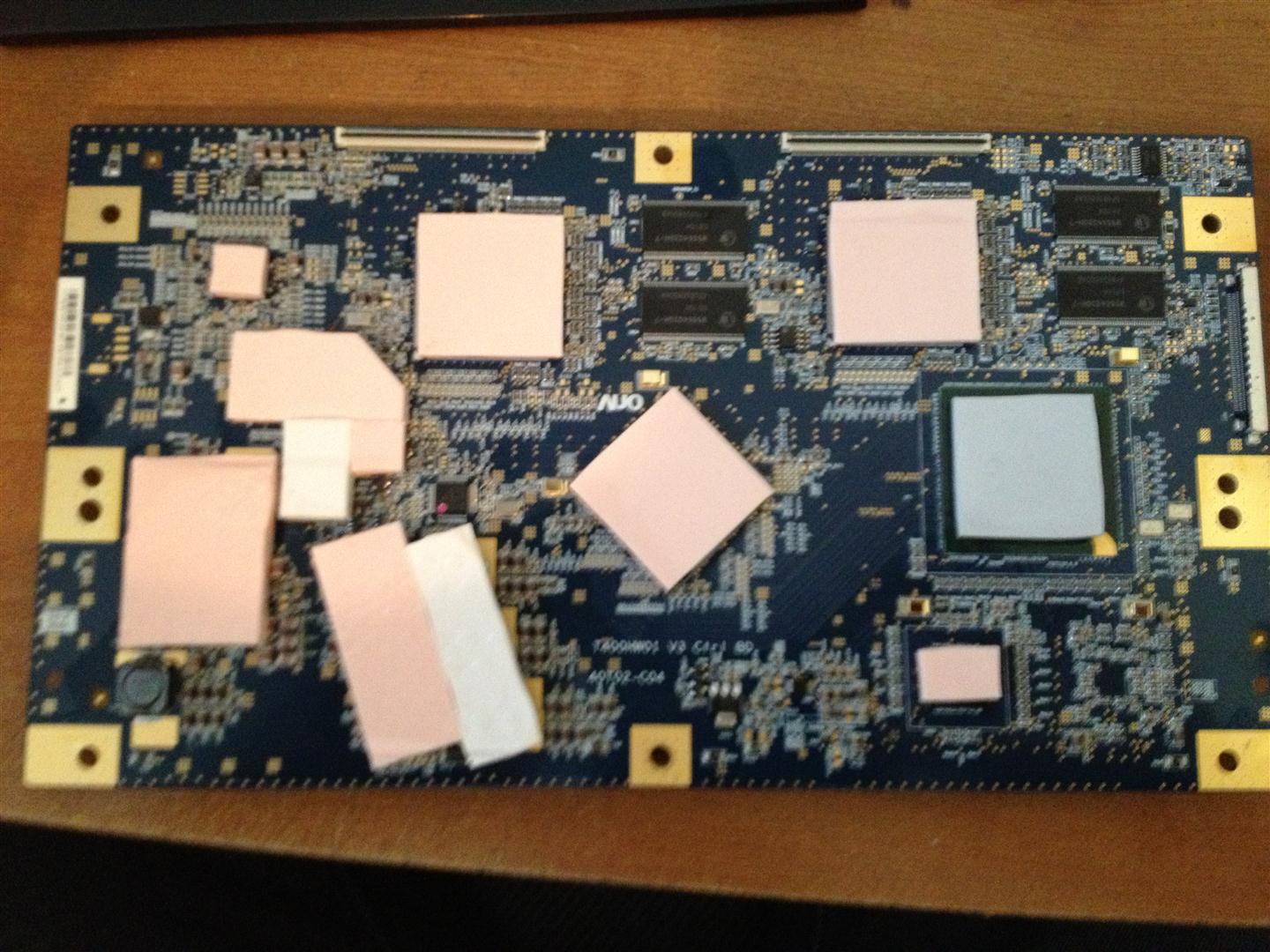

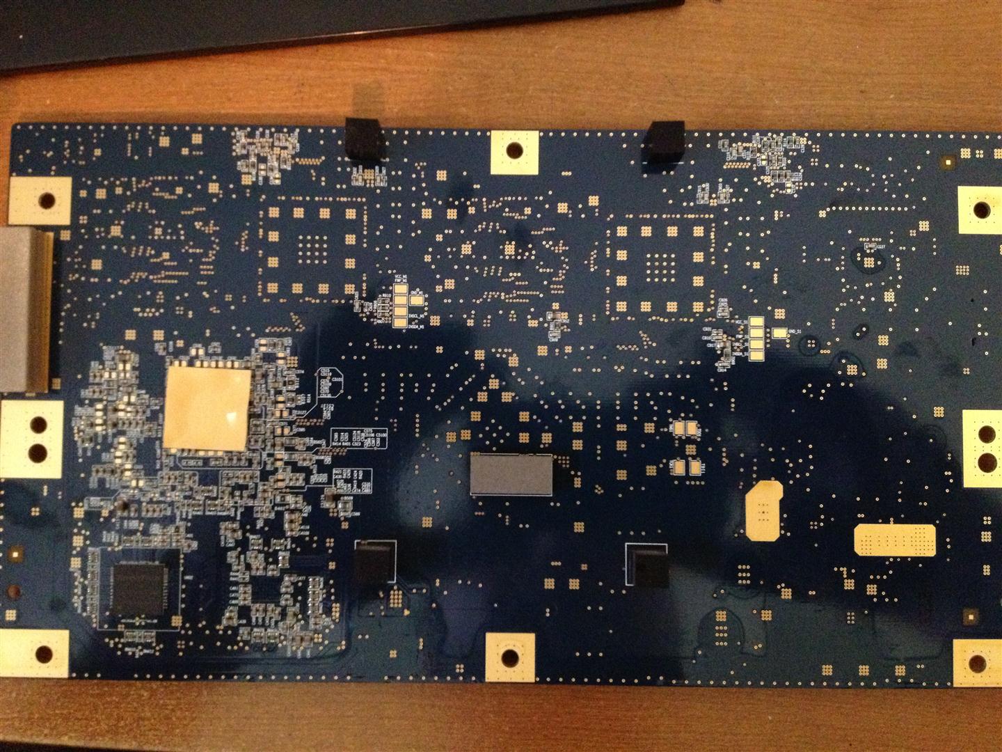

                      Can we have a picture of the tcon?
                      • martino
                        Not so "senior"
                        • Aug 2013
                        • 997
                        • canada
                        There ya go sir,front,back and part number ....
                        Proud owner of dozens of broken TV's and many,many,many boards.
                        Our website and passion:http://hollenhundshepherds.com/
                          Looks like it does have an FRC, so it's either main board or t-con unfortunately.
