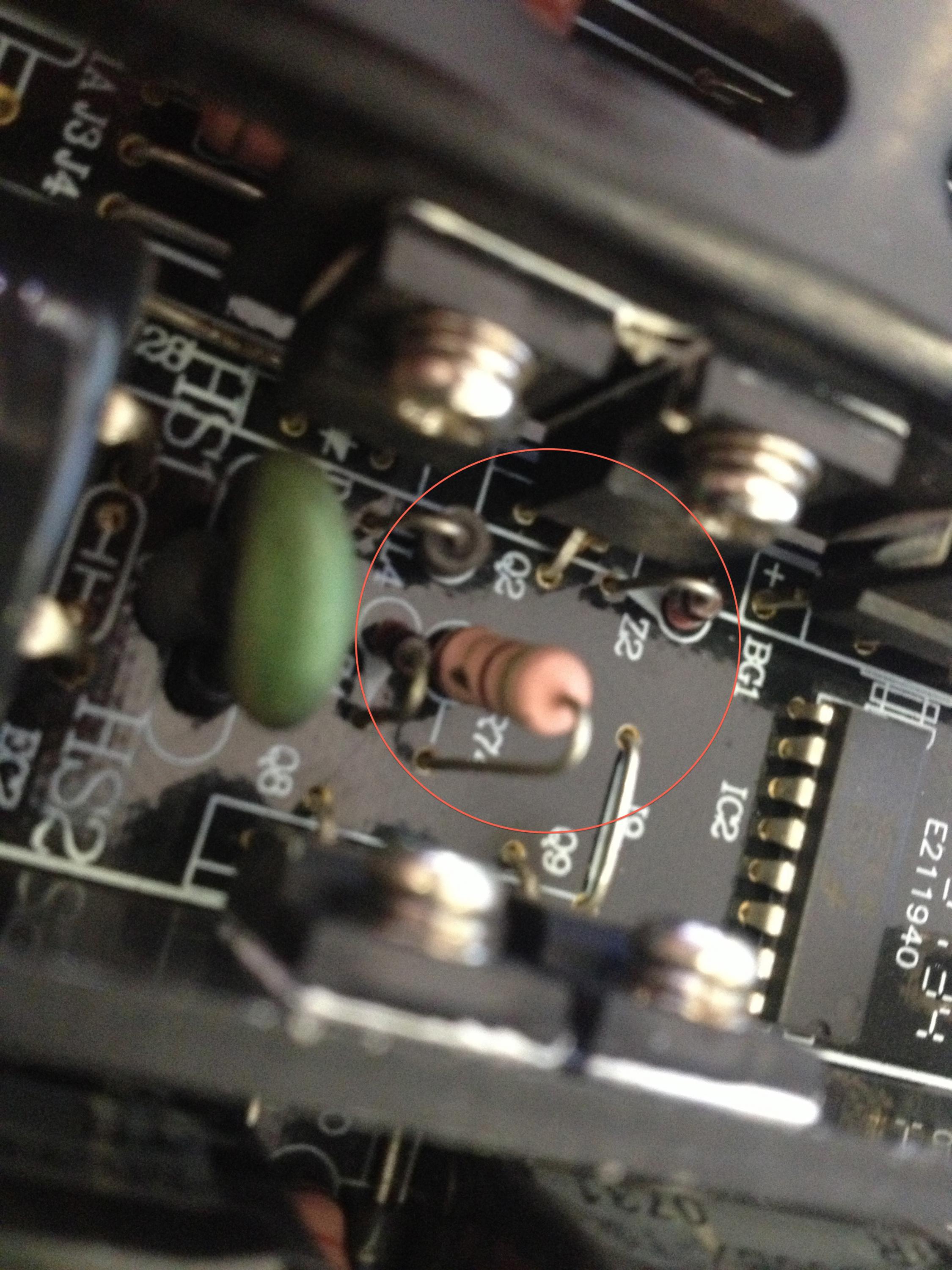

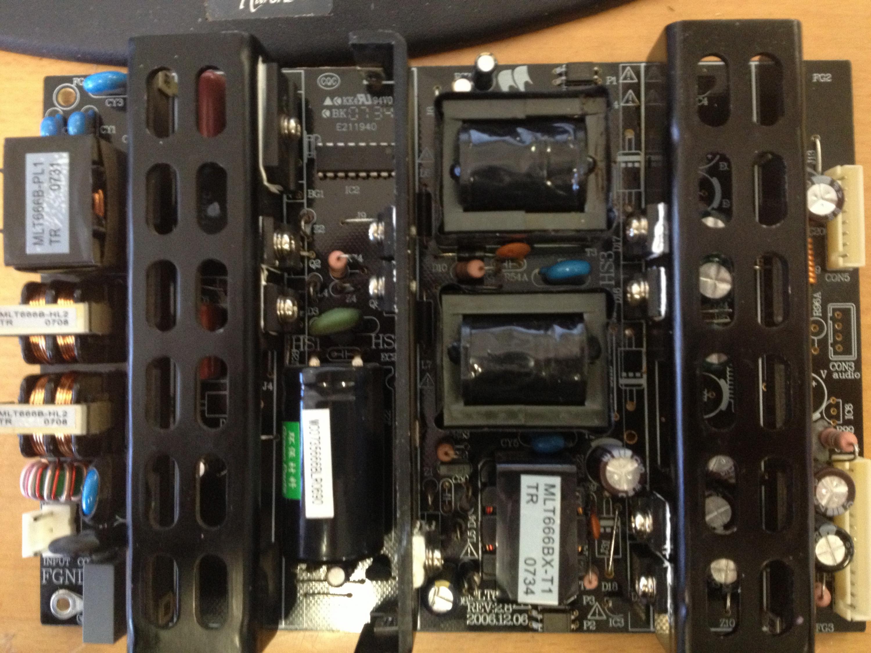

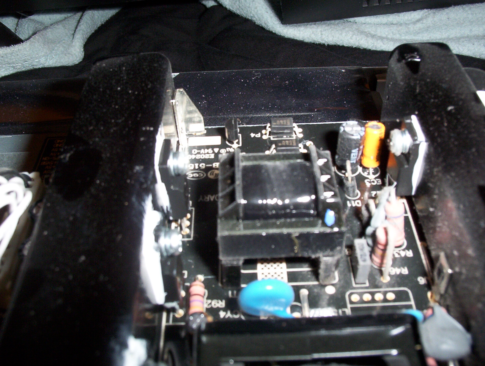

    I'm seeking some advice as where to start with this horrendous psu.

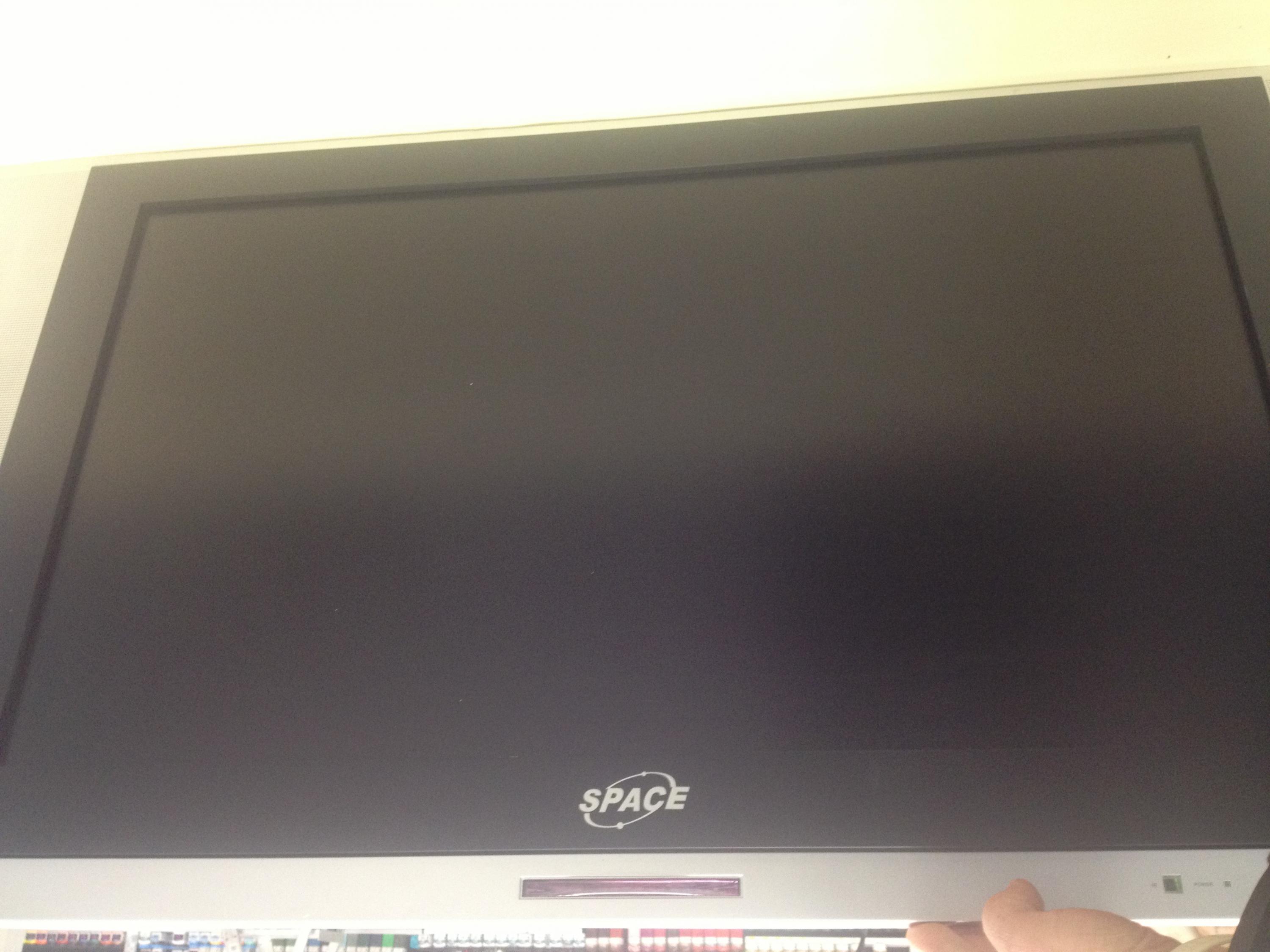

    Grabbed this 32" "Space" LCD for free from a council cleanup and would like to give it a chance.
    DEAD. no lights nothing! Opened it up to find an infestation of biblical proportions. After blowing it all out with the compressor I pulled this psu and found a roach charcoaled to the board at the position circled below.
    Cleaned the area up with alcohol and found a few burnt smd resistors.
    The fuse f1 was blown also so I swapped in a new one for visuals and bang, blew straight away
    So far I have changed all the caps except for the big filter with new mixed panasonics for startups, Yageo and Jackson for secondaries.

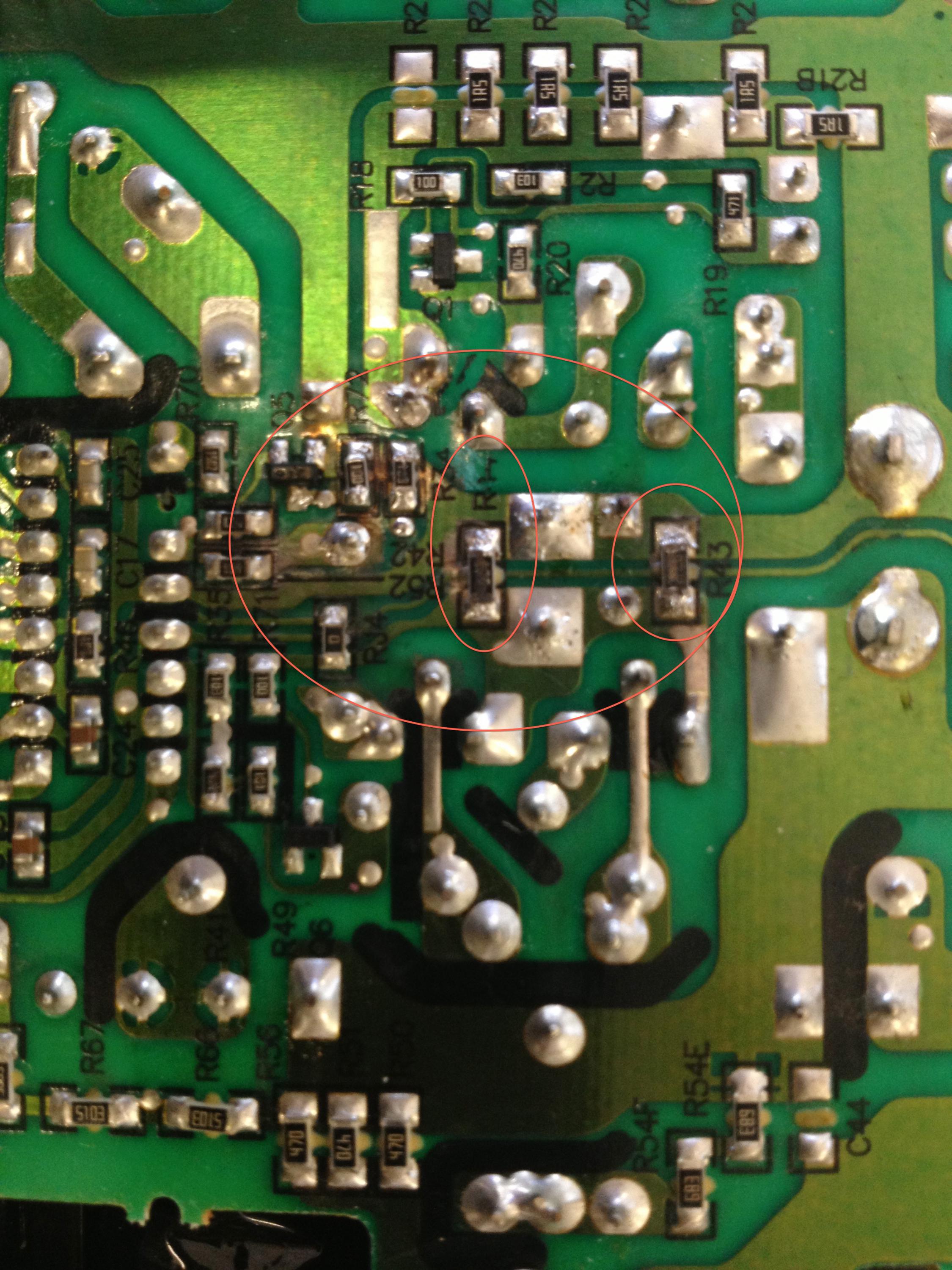

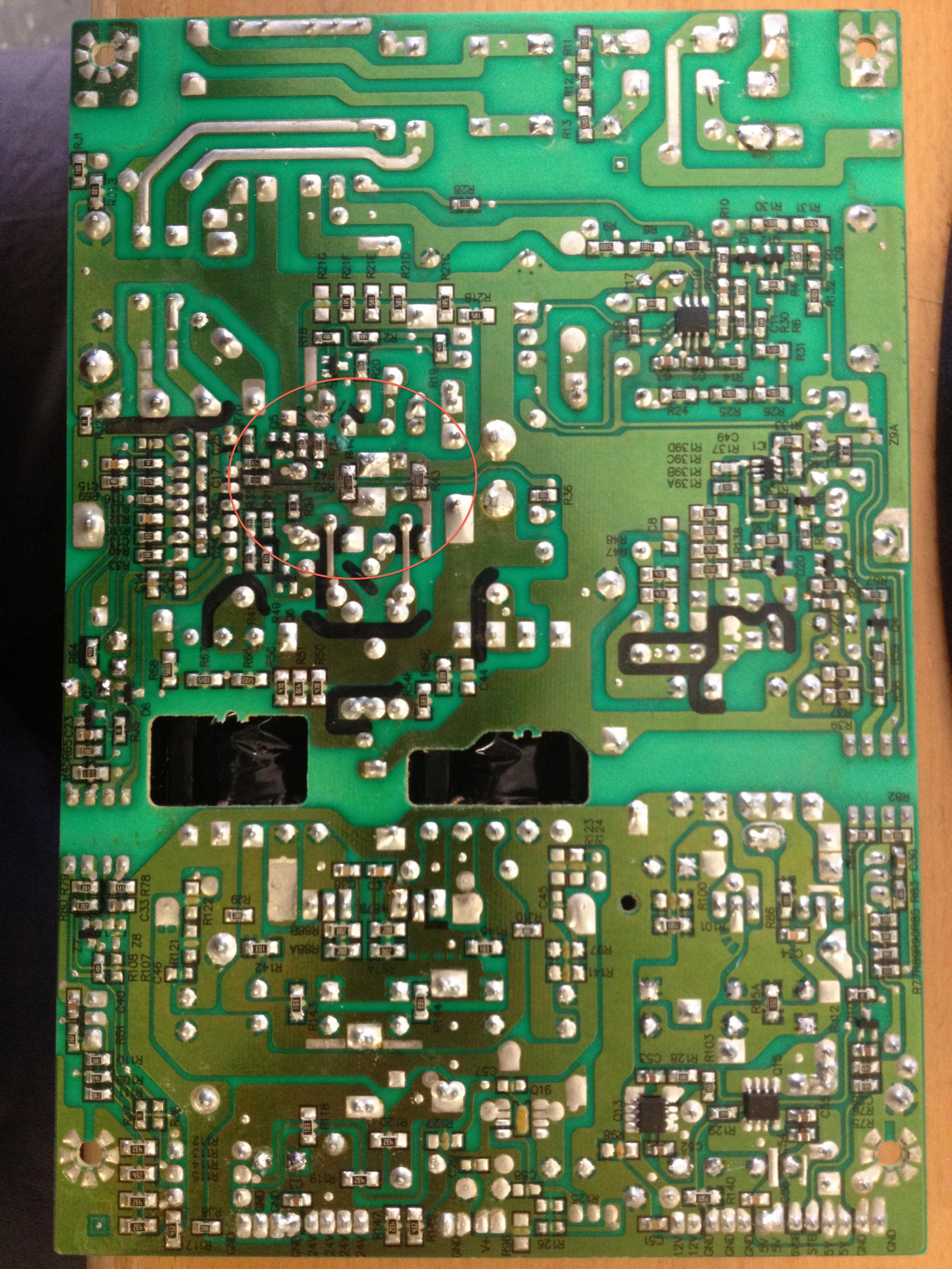

    There are a few resisters burnt (R43 & R14) on the solder side that I cannot read values of, and I have circled them in the picture below just incase someone has this same board.
    Z2 reads open both ways (should I be taking this out of circuit?), and R74 (0.5 Ohm 1%) seems to have a chunk of pink missing.
    If somebody has the time to help me with fault finding I would be incredibly grateful.

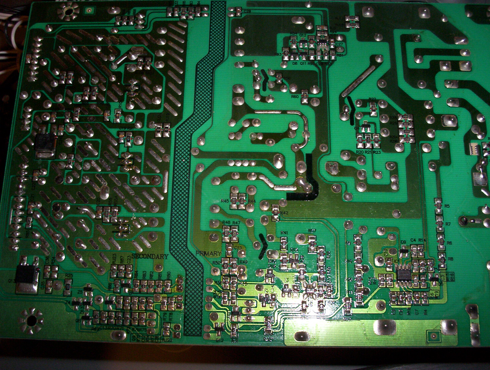

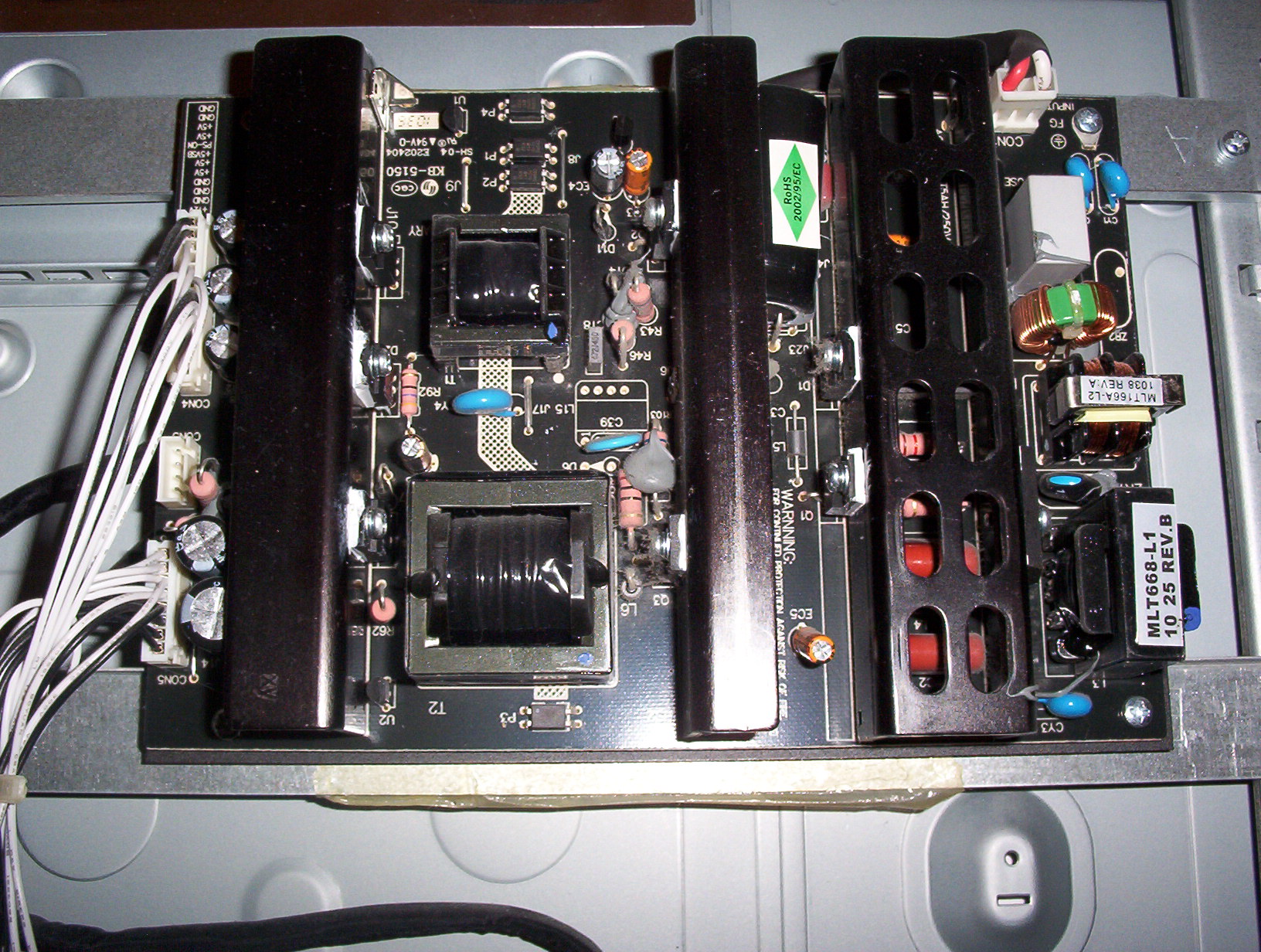

            Re: Megmeet MLT666 R2.8 cockroach short
            Okay, the power supplies aren't exactly the same. Still maybe these pics can help?
            I tried to get closer ones, but the camera flash just whited everything out.

                Thank you kindly, it is quite a different layout huh? But from looking at yours it appears what I thought was R14 is in fact R44 and yours is a 470 so 47 Ohms . Mine looks almost as if that is what it had written on it but I get a reading of 558 in circuit so I may take it out. R43 I cant find on yours though and looks to have a 4 digit code?

                      Since the main fuse is blown some common things to check would be the bridge rectifier, mosets, and diodes on the primary side.
                        Likely 2.2R 0.125W 1206 size.
