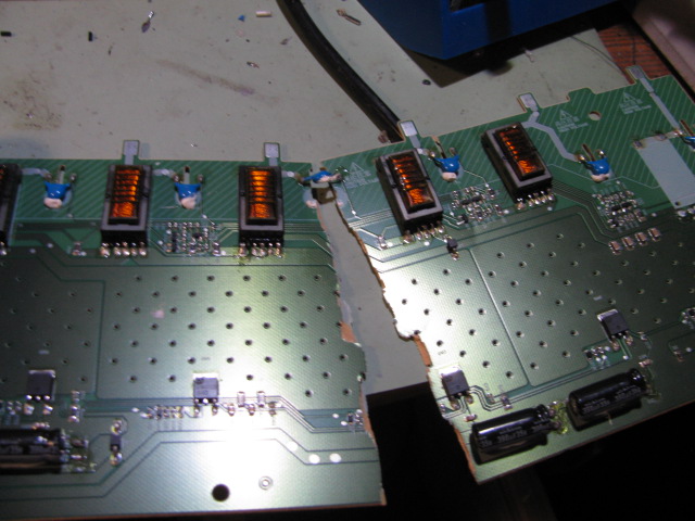

                    Okay, i actually ordered another inverter board, but unfortunately, it arrived cracked. Initially, I thought I could use the transformer from the cracked board on my board, but it turns out that the board versions are difference (I assume they are still compatible), so the transformers are actually different as well (see pic). I am wondering if anyone know whether I can still swap the transformers, making sure that the 'proper' connections are made to the board.
                    I also tried jumping the timer pin to ground, but it didn't work. The tv would still lose the backlight after a few minutes. Lastly, i took out the transformer altogether, but in this case, the light would come on for a few seconds and then turn off.
                    As I already had the transformer off, I took out another transformer from the same board and swap them, to see if the dark lcd location would change - it didn't. So, i assume that the lcd bulb is faulty. As such, is there anything I can do to bypass the backlight turning off (I tried the jumping pin but didn't work).
                    any ideas before I dump this tv?

                        Maybe there is something else going on. As soon as I take out one transformer, the tv turns on for a second and then the backlight goes out. Whereas, when all the transformers are on the board, i get about 2-5 minutes.
                        It doesn't matter which of the 12 transformers I take out, the backlight will go off in 1 sec (i've tried 3 of them already).
                        Do i need to jump some wires so as to bypass the transformer i took out?

                              well, i decided to take a chance and solder in a 120ohm resistor (as per the video). It worked! The screen stays on now (even though there is a darker line where the bulb is burnt). It is not very noticeable when watching tv, only noticeable on a blank screen.
                              For the price of the resistor, this is great to keep my tv alive!
                              Hopefully, this helps someone else.

                                I look at that video (per jackal68), the resistor look to be 12 Ohm (Brown/Red/ Black), it can be just jumper wire, and he said pin 3, it is actually pin 14 (you can see the Dot on the IC for pin 1 is located), so what he did was to bypass protection circuit. I would keep an eye on that TV and will not leave it on if you are not around to monitor it since protection circuit is no longer in place..That high Voltage for the bad bad lamp is still present and it can arc over.
                                Basically it is not a fix, it is bypassing the protection circuit, it is like using tin foil in place of the fuse.
                                There are many video out there about bypassing, but they do not tell you what the bypassing actually done to the circuit and no warning either.
