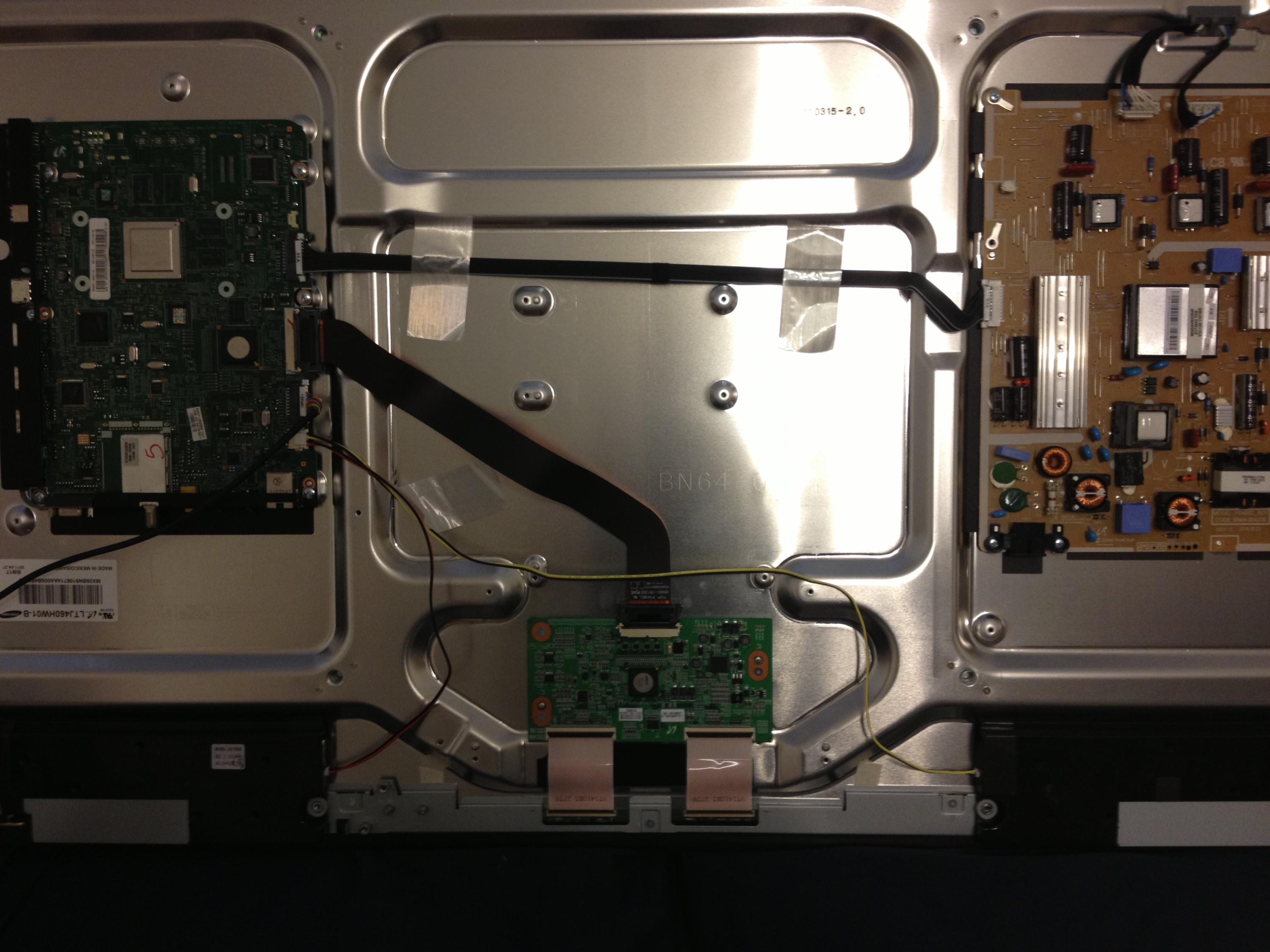

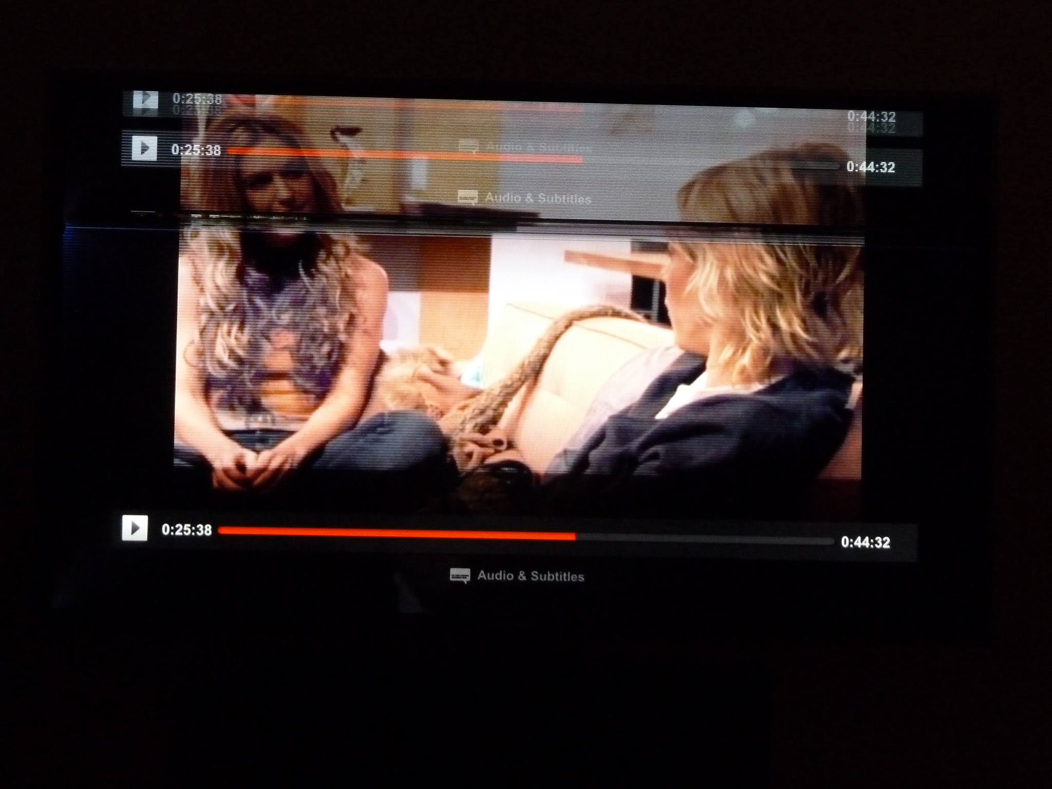

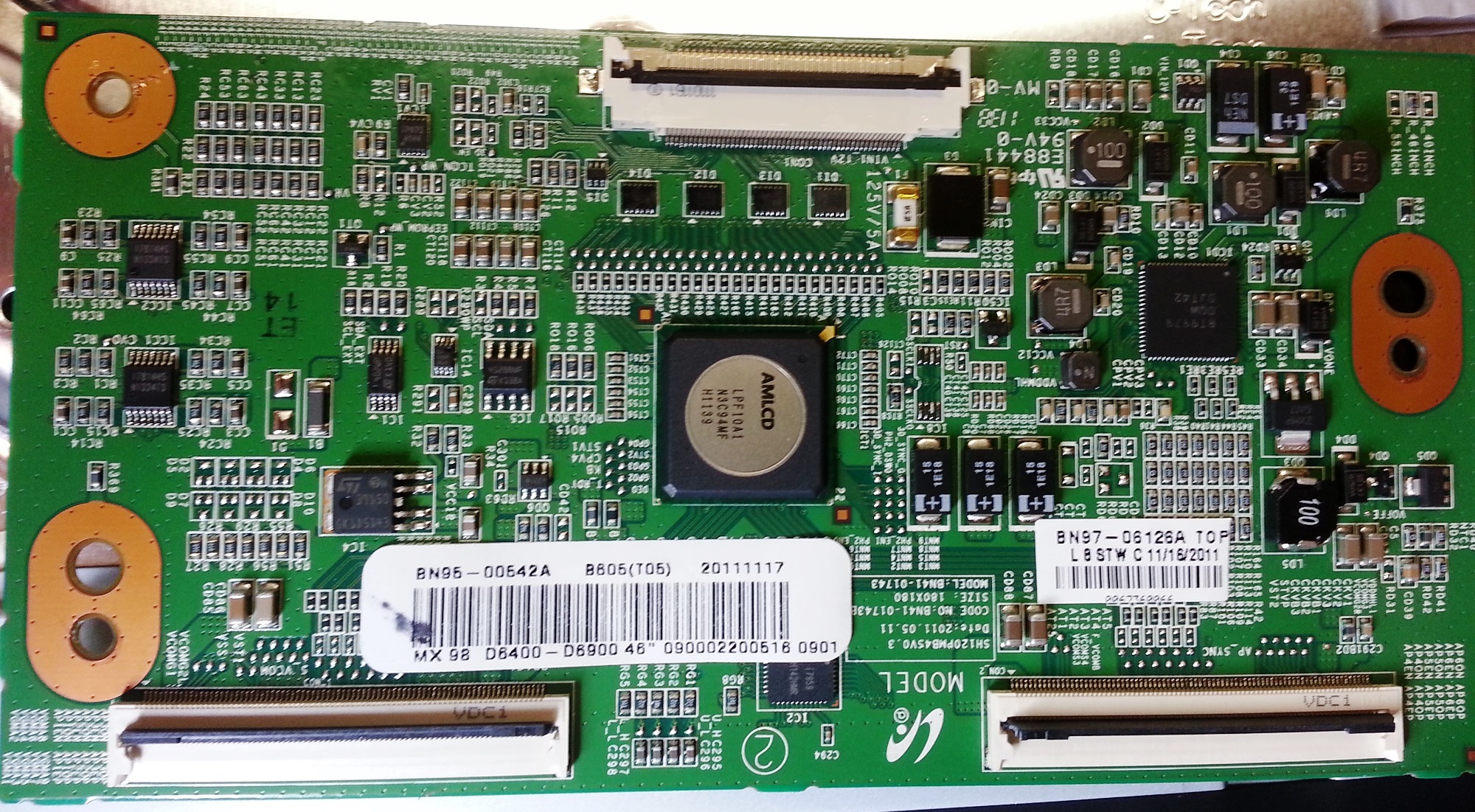

    Hi everyone,
    My TV develop some horizontal lines in the top 1/3 which appear for 3 days before the image just went completely out. I still have sound and black light just no picture.
    No visible damage on any of the components, will have to wait until Wednesday for a multimeter.
    Thinking it might be a bad T-con did some basic troubleshooting. I manage to get half of the image on TV if I unplug the left ribbon (right on pic) on the T-con.
    Suggestions are welcome.
    Thanks,
    CG

      Re: Samsung UN46D6420 Horizontal lines, now No Picture
      Looks like a bad panel
        Double image like that I would check the tab bondings.

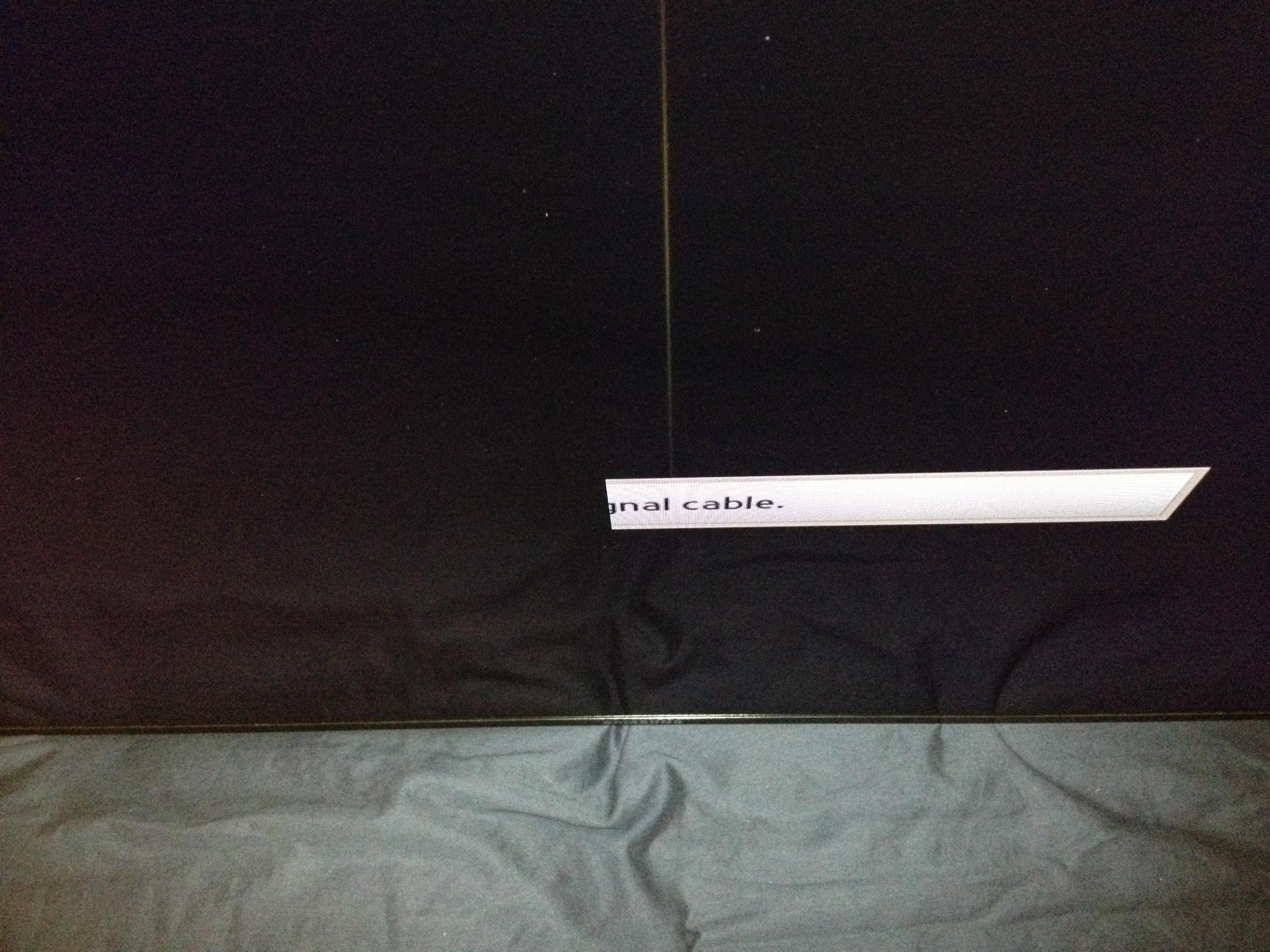

            Mine shows only baclight. If I remove one of the ribbon cables going to the panel, half the screen will show image. The other side shows some wide white and wide black vertical bands and in some area thinner lines which seems to change the color with signal.
            In my opinion the panel is bad. T-con boards are around $100.
            I have checked the tabs and they seem solid, no change on the screen, if I touch them.
            I'm expecting a confirmation from the more experienced technicians too.

                  • Agueybana
                    • Aug 2013
                    • 9
                    So in my case it was the panel itself and not the T-con I was hopping to be. If looked from an angle the panel has a huge spot where the lines originate and the burn in comes out. I gets extremely hot, I tried the bonding and T-con and this didn't affect the image. Looking into buying a Panasonic Plasma soon have it narrow down now.

                        • Agueybana
                          • Aug 2013
                          • 9

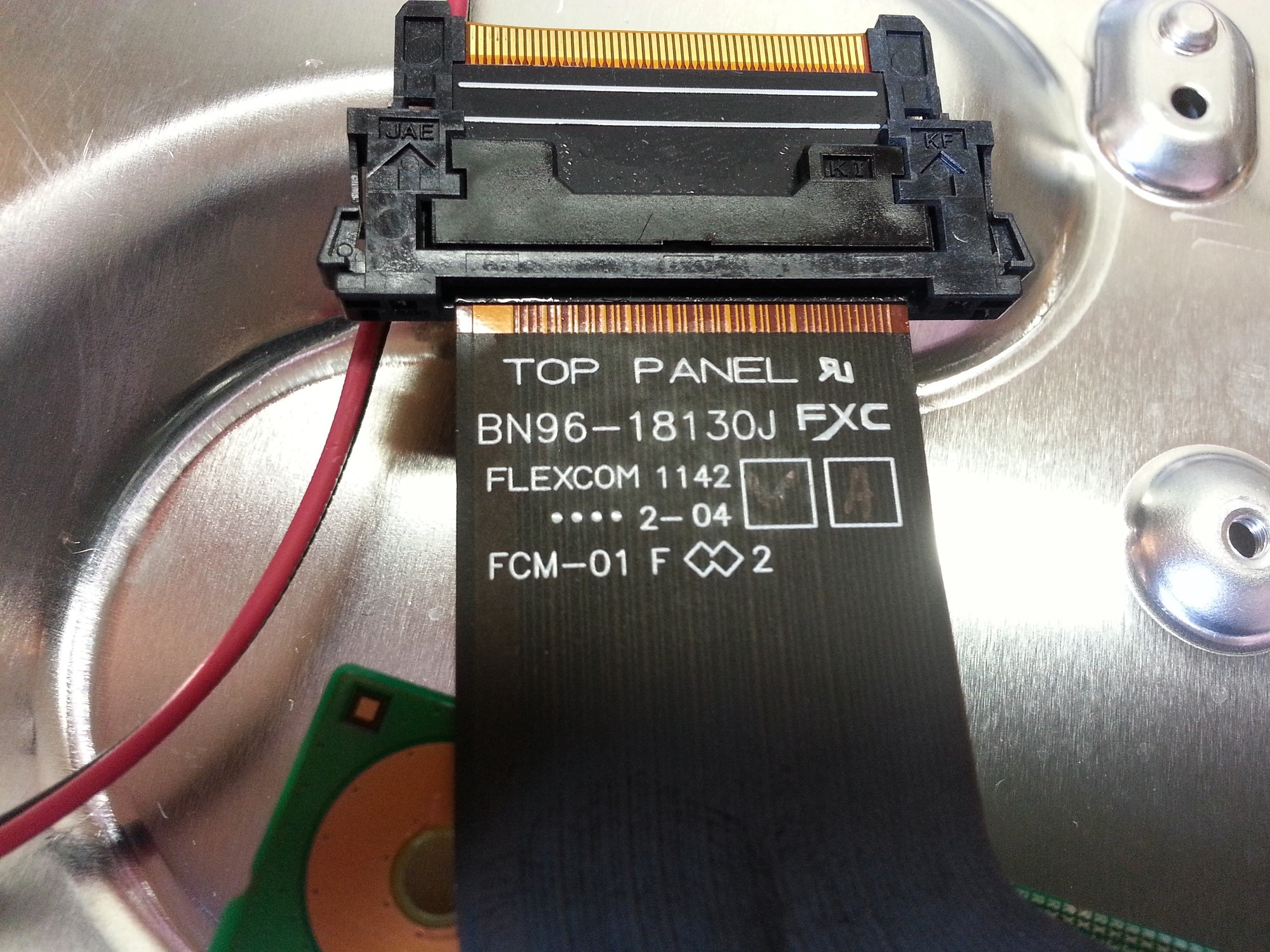

                          I did an elimination process and check T-con for conductivity. From researching when it goes bad there is a particular resistor that goes bad on them.
                          Can't verify the panel but with the burn marks on mine I can confident said that was the problem after checking other components.
                          From freakaftr8 response I would imagine that those IC ribbon are behind the black tape around the screen which I was going to removed but decided not to. After all they are probably bonded and not solder so is something you can't fix. Thinking of removing it now with this info just to take a look but don't feel confident it can be fix.
                          I might take pics and added them if there is physical burn damage on the IC ribbons as I suspect. I boxed yesterday oh well.

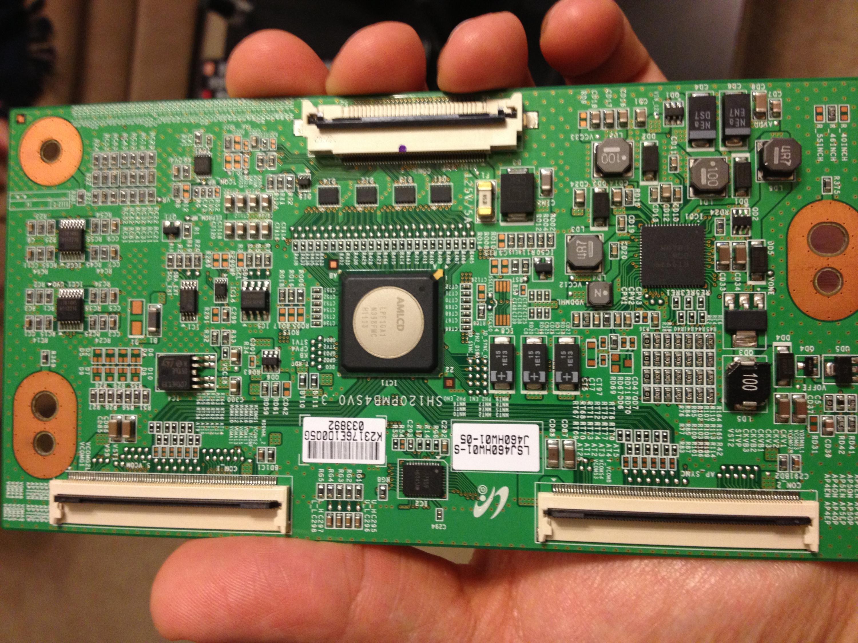

                            Which resistor should I check on the T-con board?
                            Any input, Tom, Bud?
                            • Agueybana
                              • Aug 2013
                              • 9
                              It's actually a 5amp fuse on the T-con above where the main ribbon connects.
                              Reference Post #7 in that thread
                              http://www.avsforum.com/t/1252060/ca...th-this-lcd-tv
                              Read about it in other forums as well.

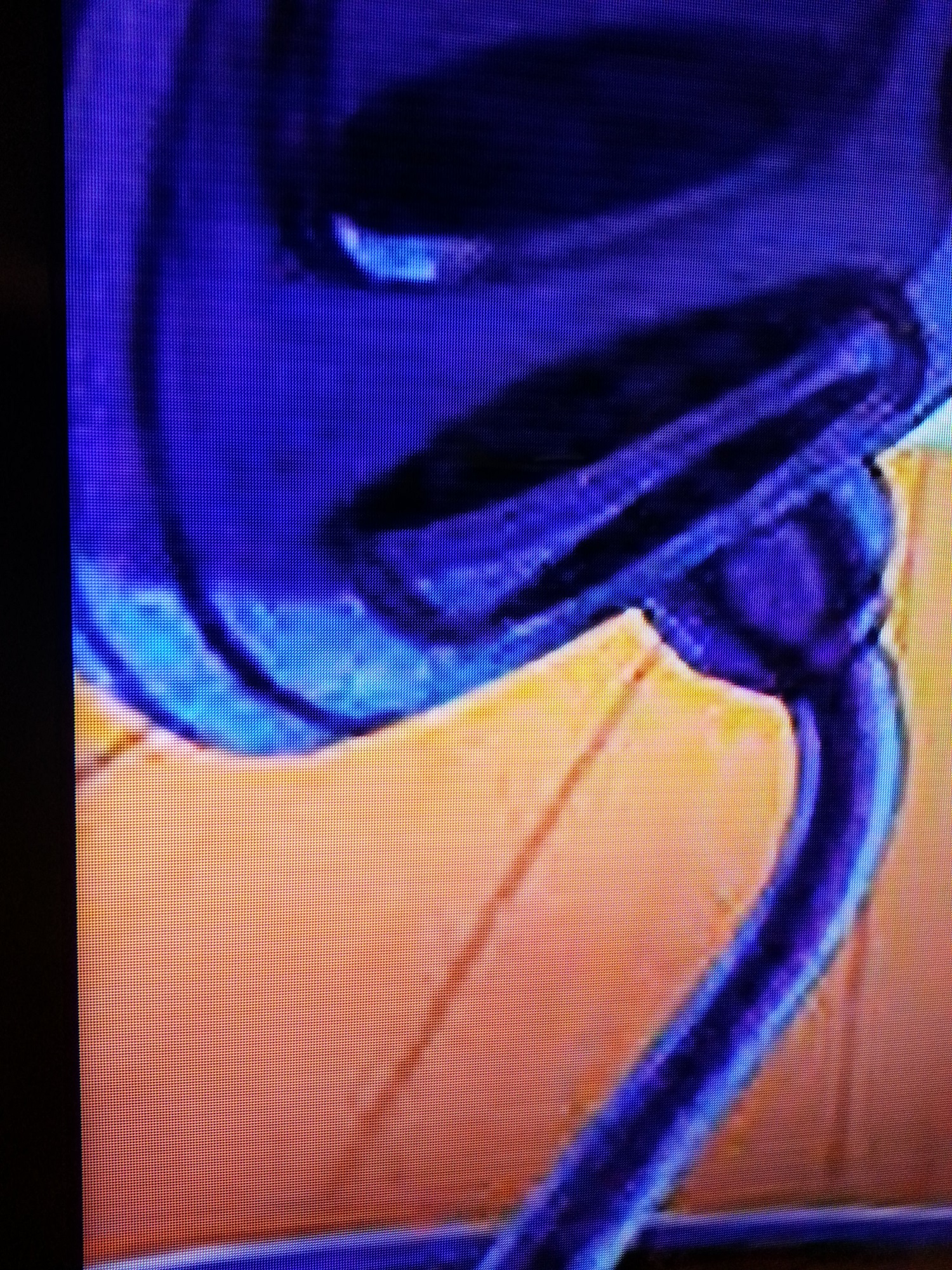

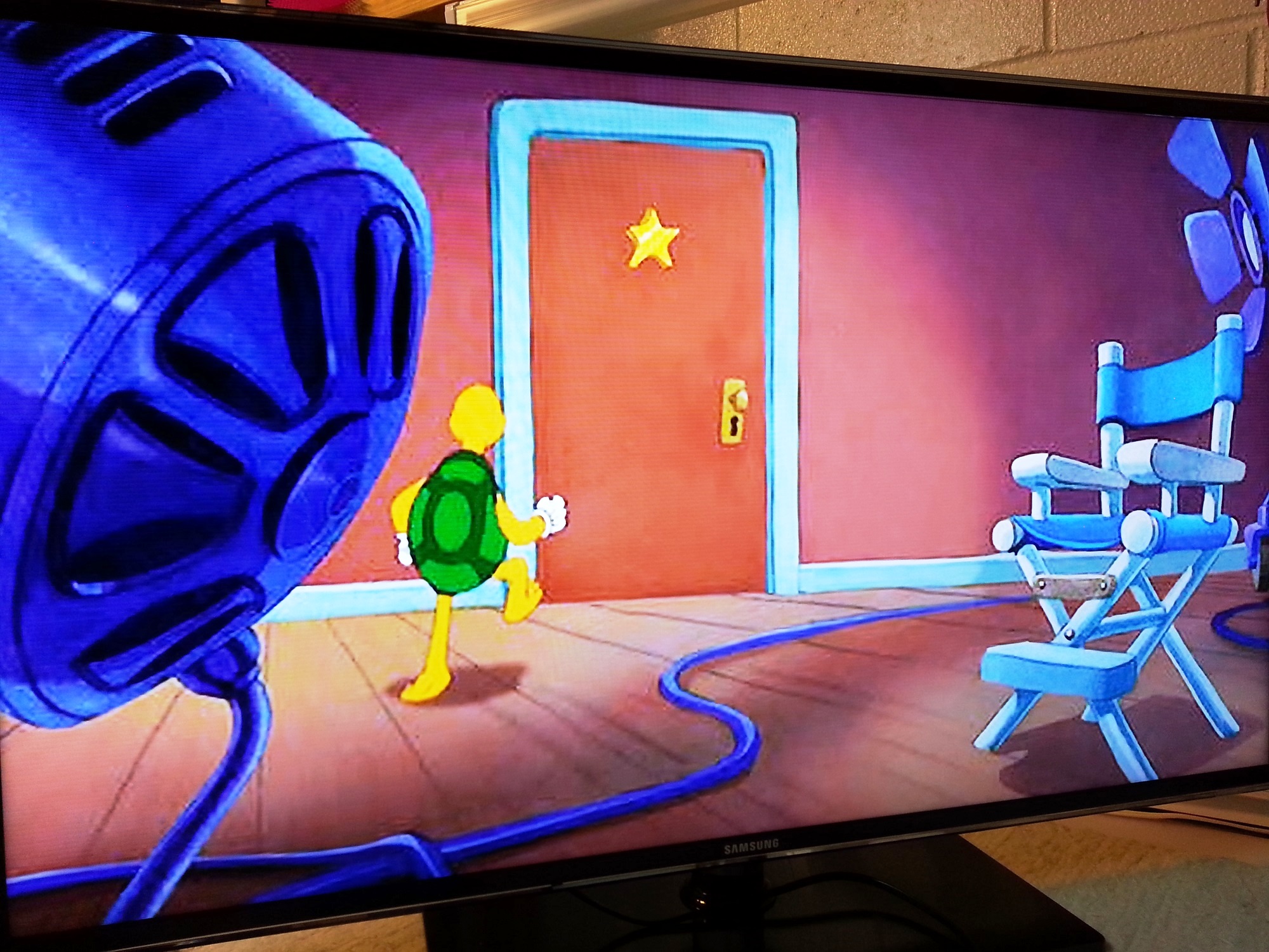

                                  I have played around with this TV today and I have managed to get a nice clean picture out of it, but there are horizontal thin line across the whole screen.
                                  They are more visible at the top then at the bottom, so gradually decreases the intensity of these line toward the bottom.
                                  The way that I have managed to get a picture, I have played with the T-con connector ribbon cable. In a slight angle the picture shoed up and then I have flipped over the retaining tab(same as the panel ribbon connectors).
                                  TV works great, even the 3D feature, but those lines are visible.
                                  What could this be?
                                    I have tried the tabs last time and they didn't change the picture.
                                    I had a while ago, a Sony TV with horizontal thin lines and by replacing the T_Con board, it fixed the lines. Could it be the same problem here too?
                                    Here are some pictures:
                                    • tibimakai
                                      • Jan 2012
                                      • 3680
                                      Any ideas?
                                        Uniform patterns like that usually aren't caused by the panel but you can't be sure if it is main or t-con.
