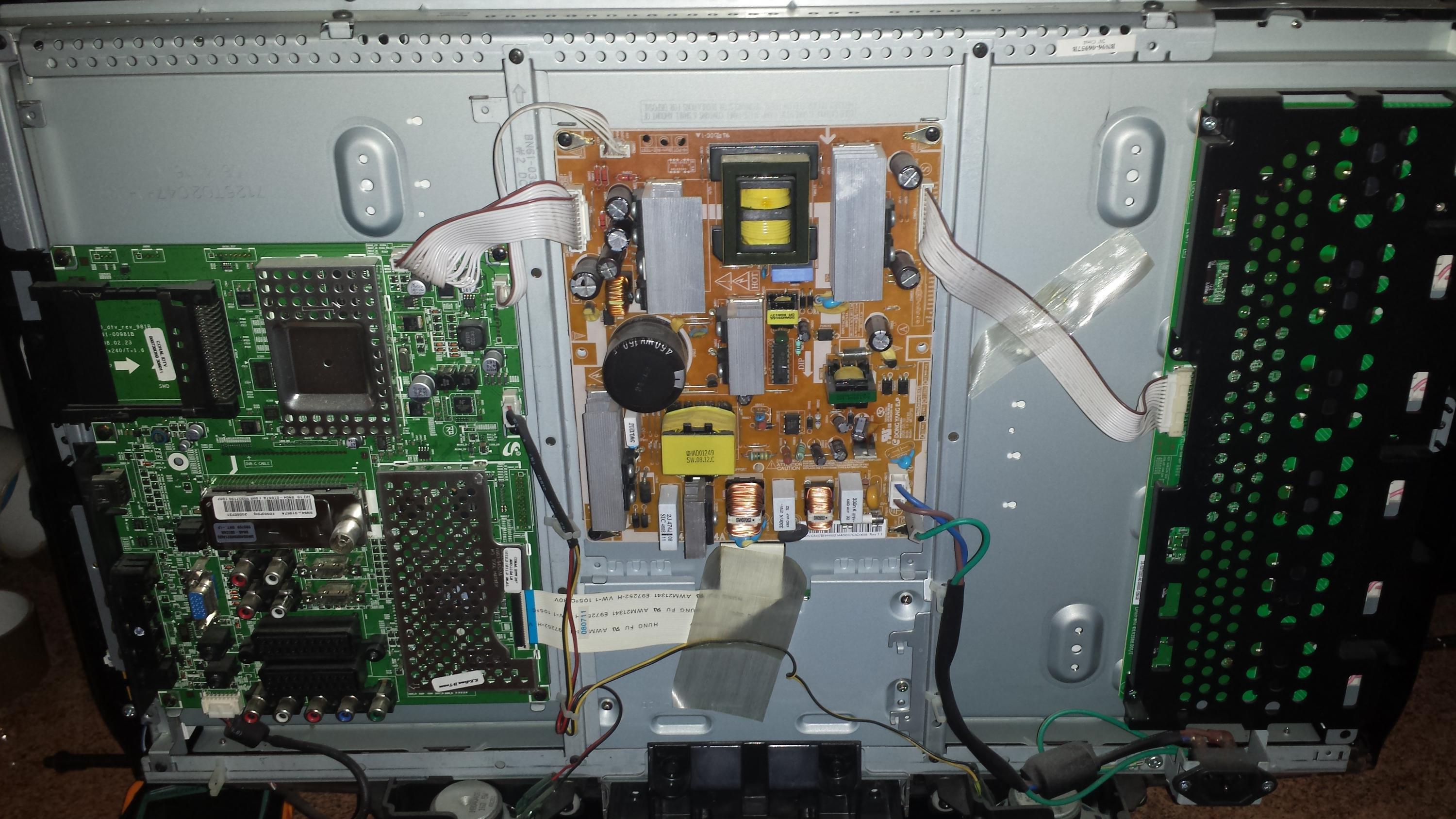

      Any chance you can get some photos up of both sides of the PS board and the T-Con(LVDS).
      Also do you have a multi meter to take some readings?

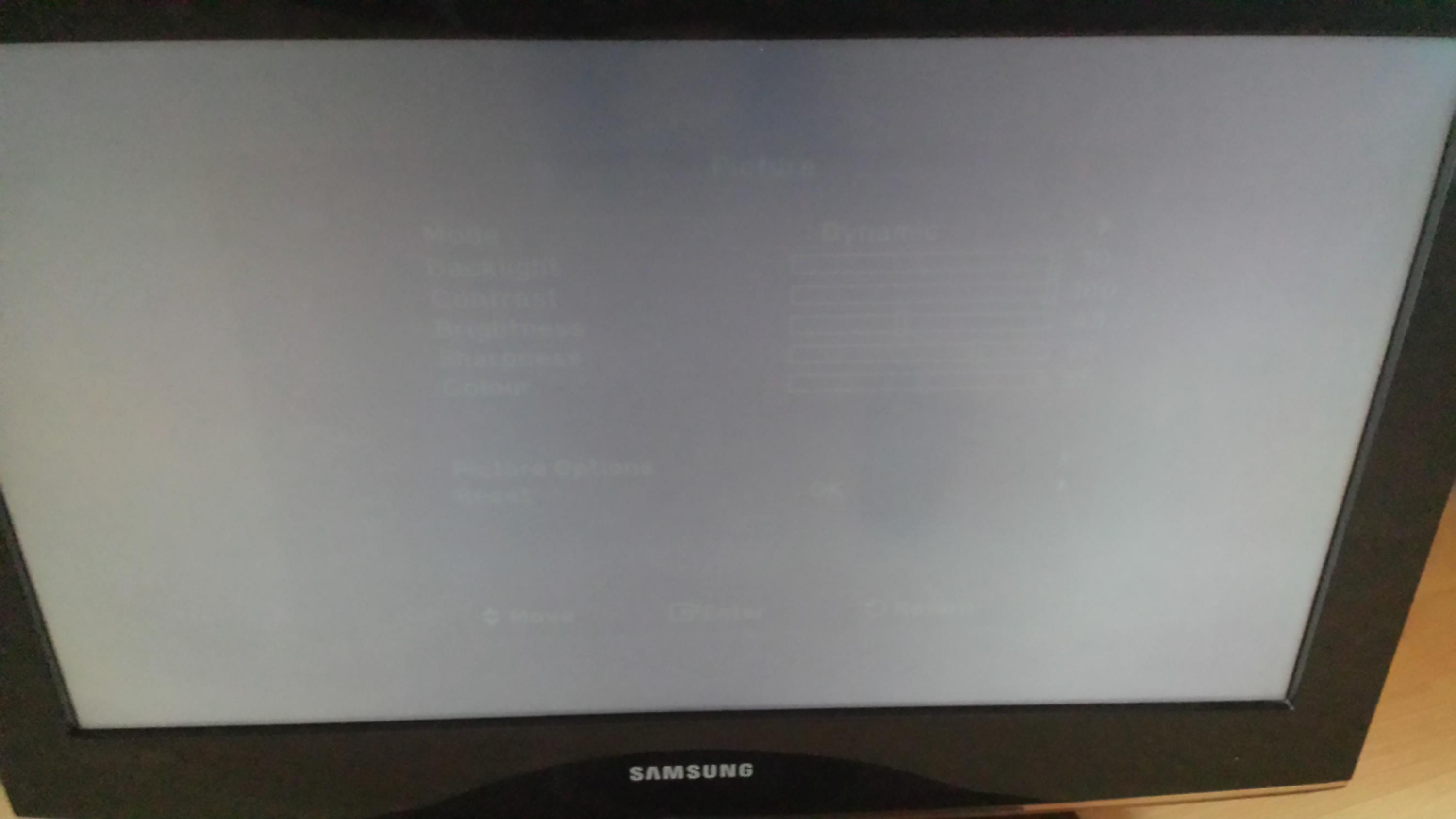

          ok got this tv today its got sound but no picture the backlight comes on but i can just see a image,checked voltages to invertor seem fine so...
          any ideas
          • sordids999
            • May 2013
            • 2158
            • uk
            Re: Samsung LE26A457 Lcon Board.
            i can just about see a image but very faint
              Check panel manufacturer.
              I reckon tab bonds - I've had a few like this - they're pretty easy to fix. (Done four so far.)

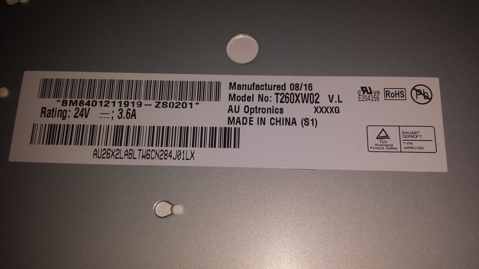

                photo added
                  Hmm, usually ChiMei V260B1 with this fault. You can try the tabs, but no experience myself with this AUO panel. Could also be GAMMA fault, that is common with AUO. Can you post a pic of T-con?

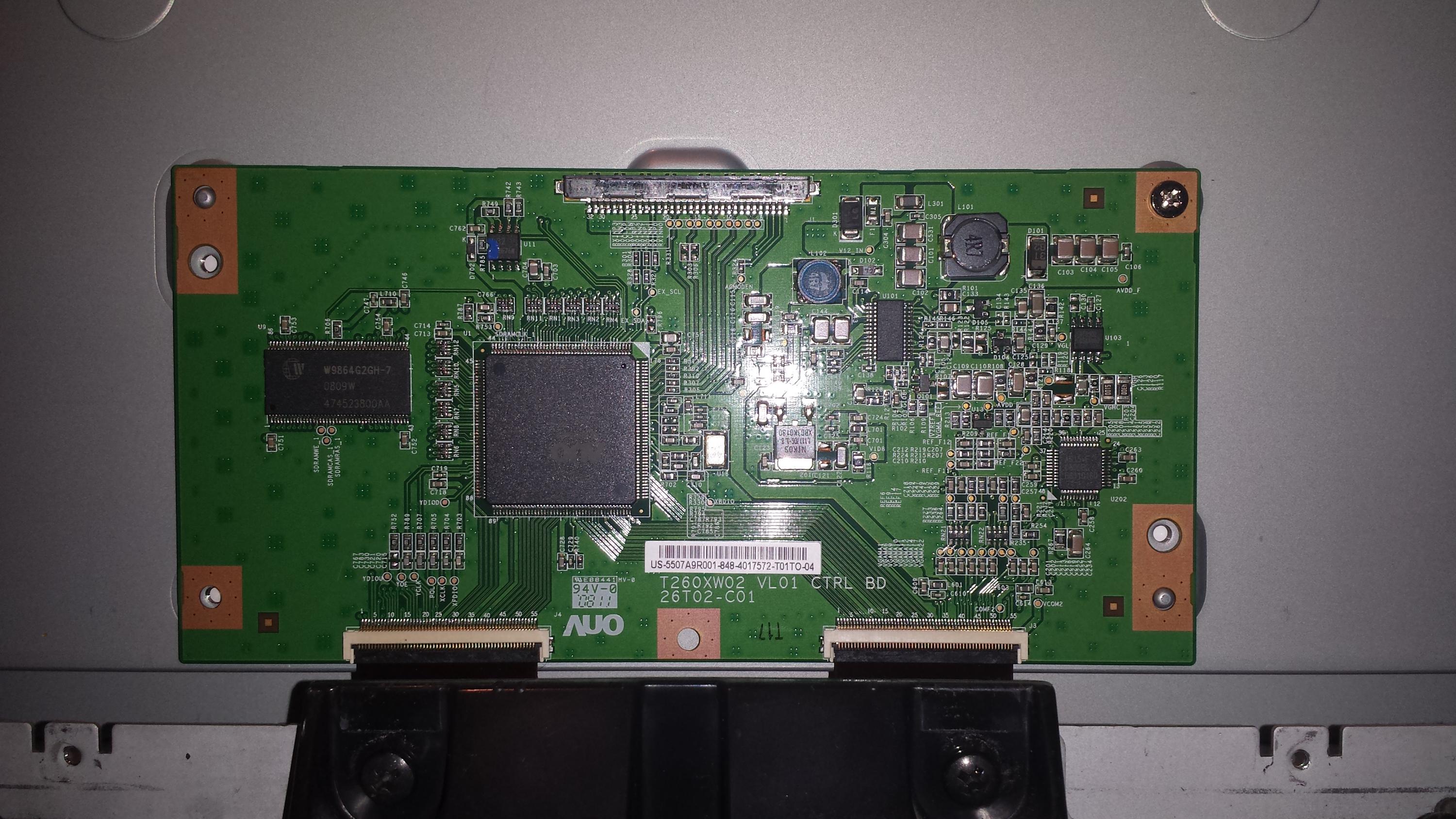

                    done
                      Another one with AS15G Gamma voltage ref. IC in AUOPTO T-CON.
                      http://www.shopjimmy.com/auo-55-07a9...-con-board.htm
                        Was going to say check gamma voltages but can't see all of them there. Check what you can from VGAMA1 thru VGAMA12. Odd(?)
