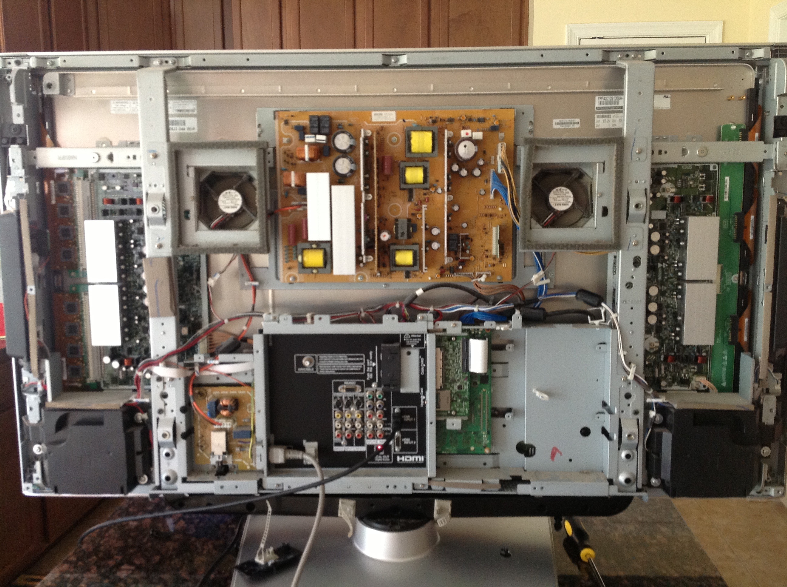

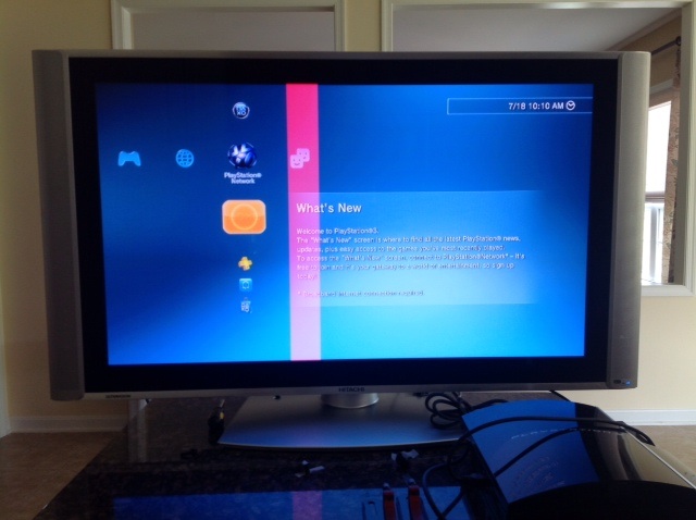

    Hello, I have a Hitachi 42 inch plasmas, model number: HD42S69. I have a 3 inch thick vertical red line, left of center (if your facing the tv) that sporadically appears, but often. I took it to a repair shop. The guy told me that its not the control board and it isn't the display panel, it's a buffer board. He wanted $200 and he said the part is like $60. I figured I can just do it myself, but I don't know where the buffer board he was talking about is? Can you help me locate it? How do I even know what board is causing the issue?
  • Sross002
    • Jul 2013
    • 30
    Re: Vertical Red Line appears on Hitachi Plasma HD42S69

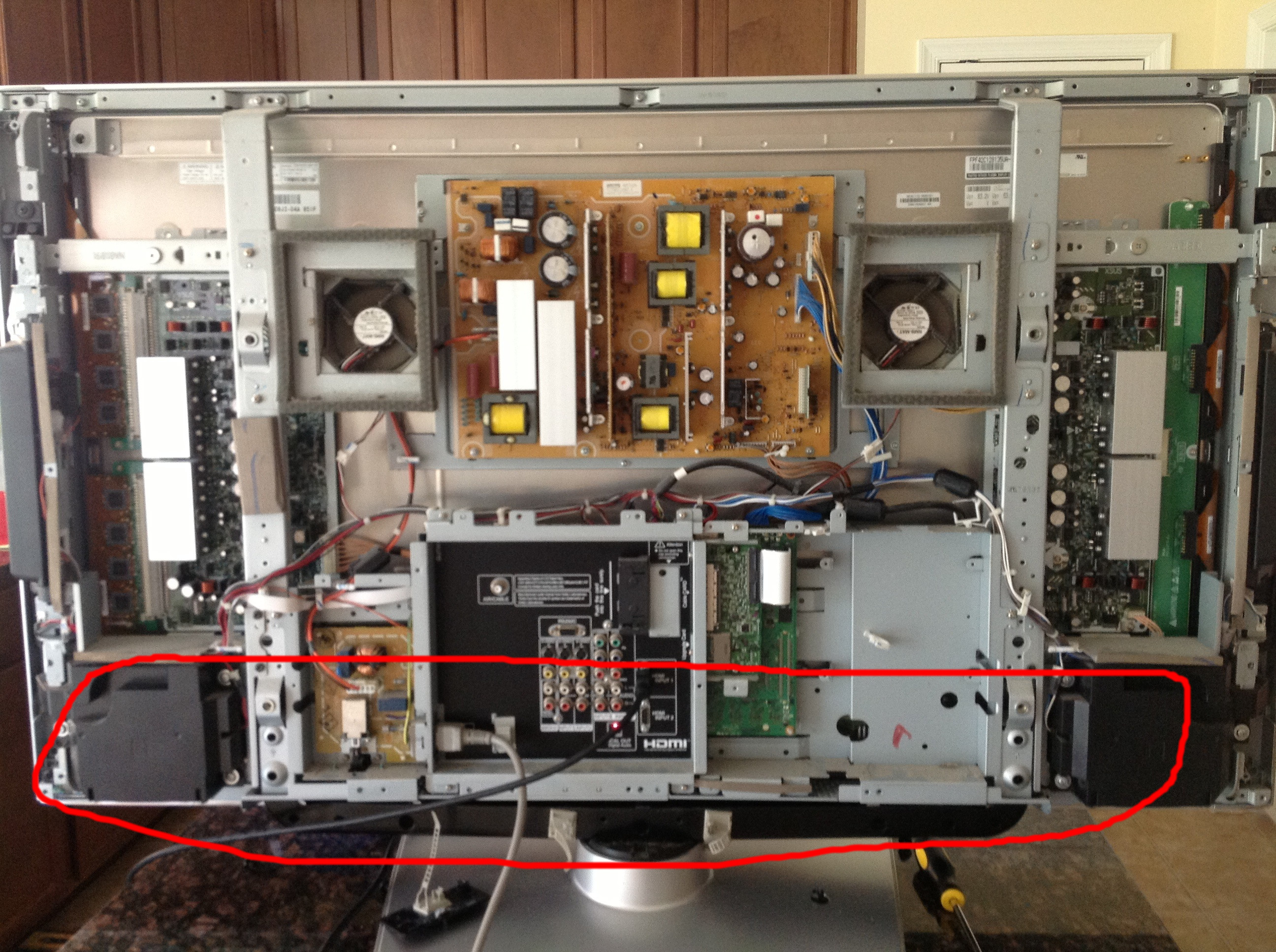

    Here is a picture of the back:
      Your X-buffer is located under here. Looks like you'll have to take a lot of stuff off to get to it.

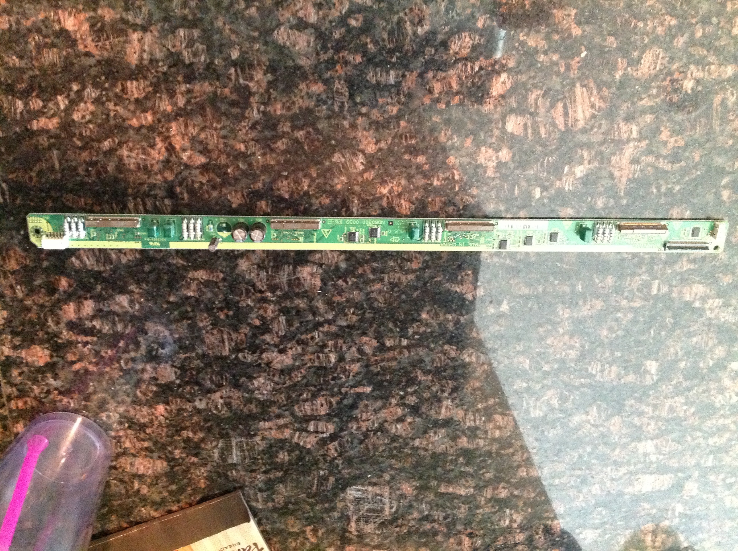

          I was able to locate the part. I can poke it and the red line goes away or flickers. I got the part number as well. But shop jimmy.com is calling it a a-bus r board, not a x buffer board.
            A-BUS = X-buffer (Address buffer)
            The problem is simply the connector. Just unplug it and plug it back in. You -may- want to use a little contact cleaner.
            Do not make any change with power on!! The power must be off, or you could damage the plasma panel! Damage to the plasma panel is not repairable.

                          Okay, got it!
                          Here's a picture of it. Can you tell me what connector(s) is causing the issue?
                            The four ones on the bottom -- whichever corresponds to the line on the screen.
                                  Though I did not clean the connectors, your advice worked! No more red line!
                                  Thank you for all your help.
                                  • Sross002
                                    • Jul 2013
                                    • 30
                                    Hello. My red line friend has reappeared but in a different location. Should I perform the same steps or buy a new board?
                                      Same steps - reseat all connectors. Consider using contact cleaner.
