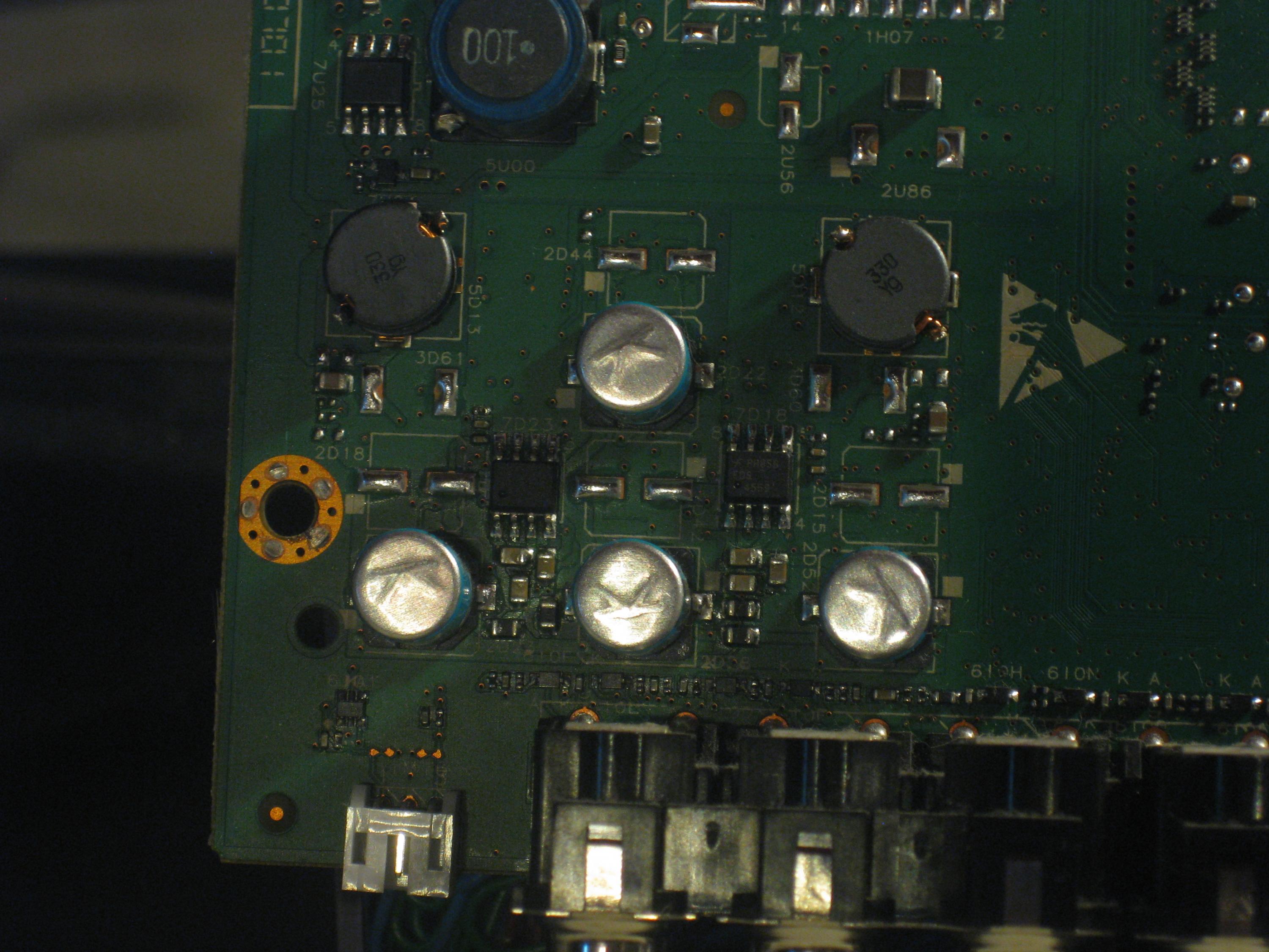

          Re: Philips Plasma 50PFP5332D/37
          So after doing a little testing of pulling different cords, I decided to pull off the main board completely. The picture below shows a few caps on the main board. I don't think they are actually popped, but I thought I'd ask and see if anyone had a different opinion.
            Those look fine to me -- that's pretty normal for surface mount rubycons (which those are.)

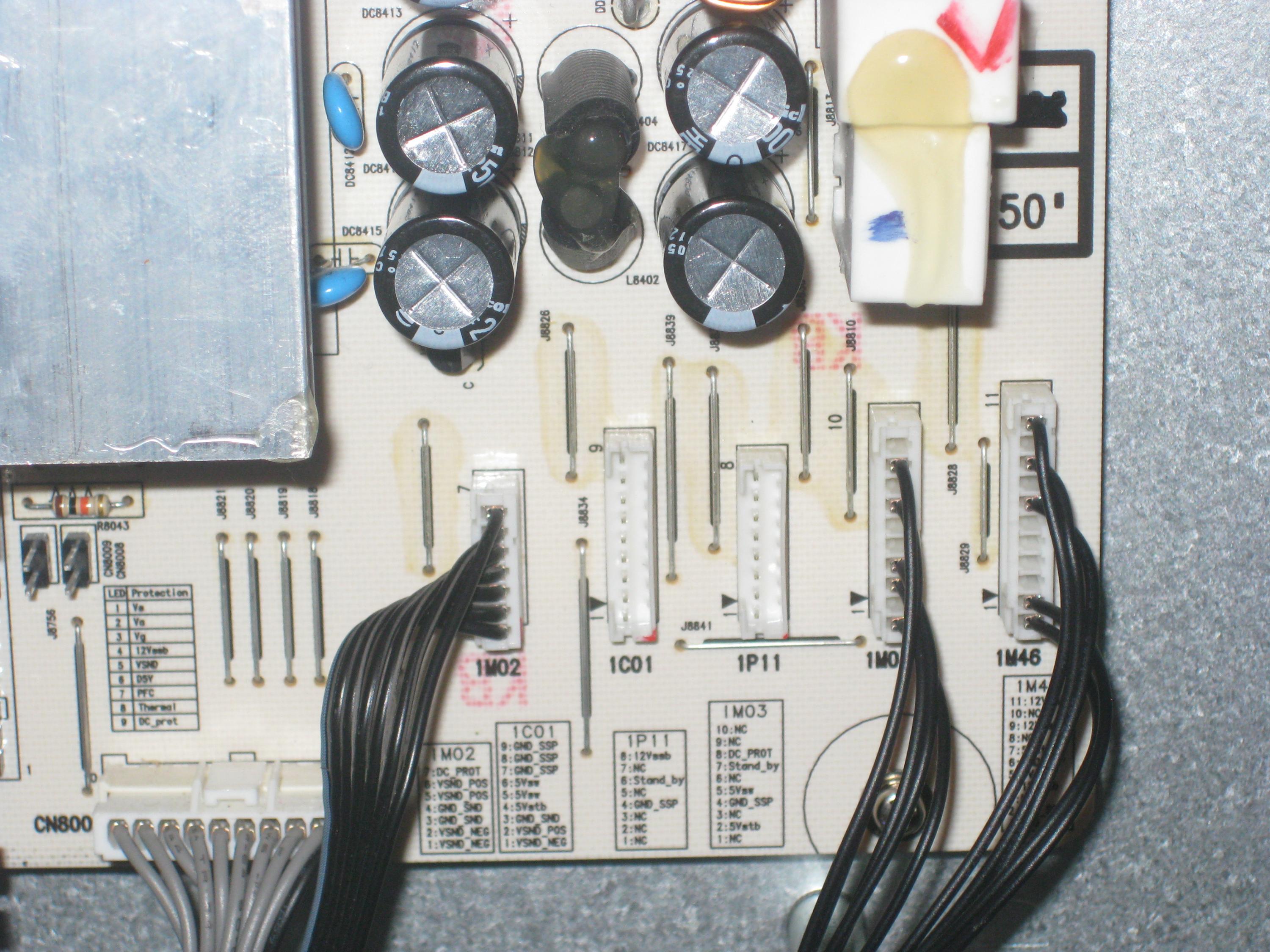

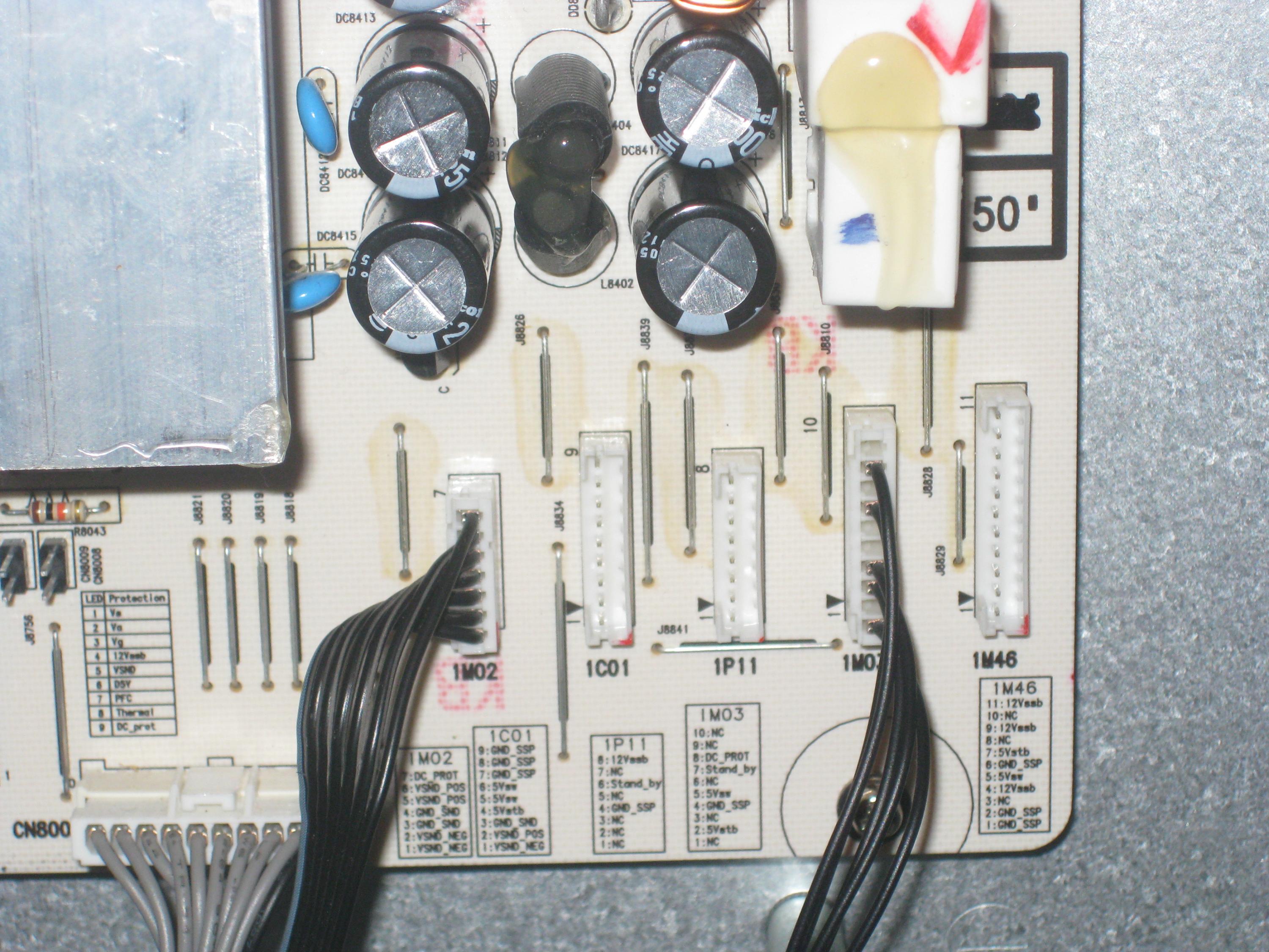

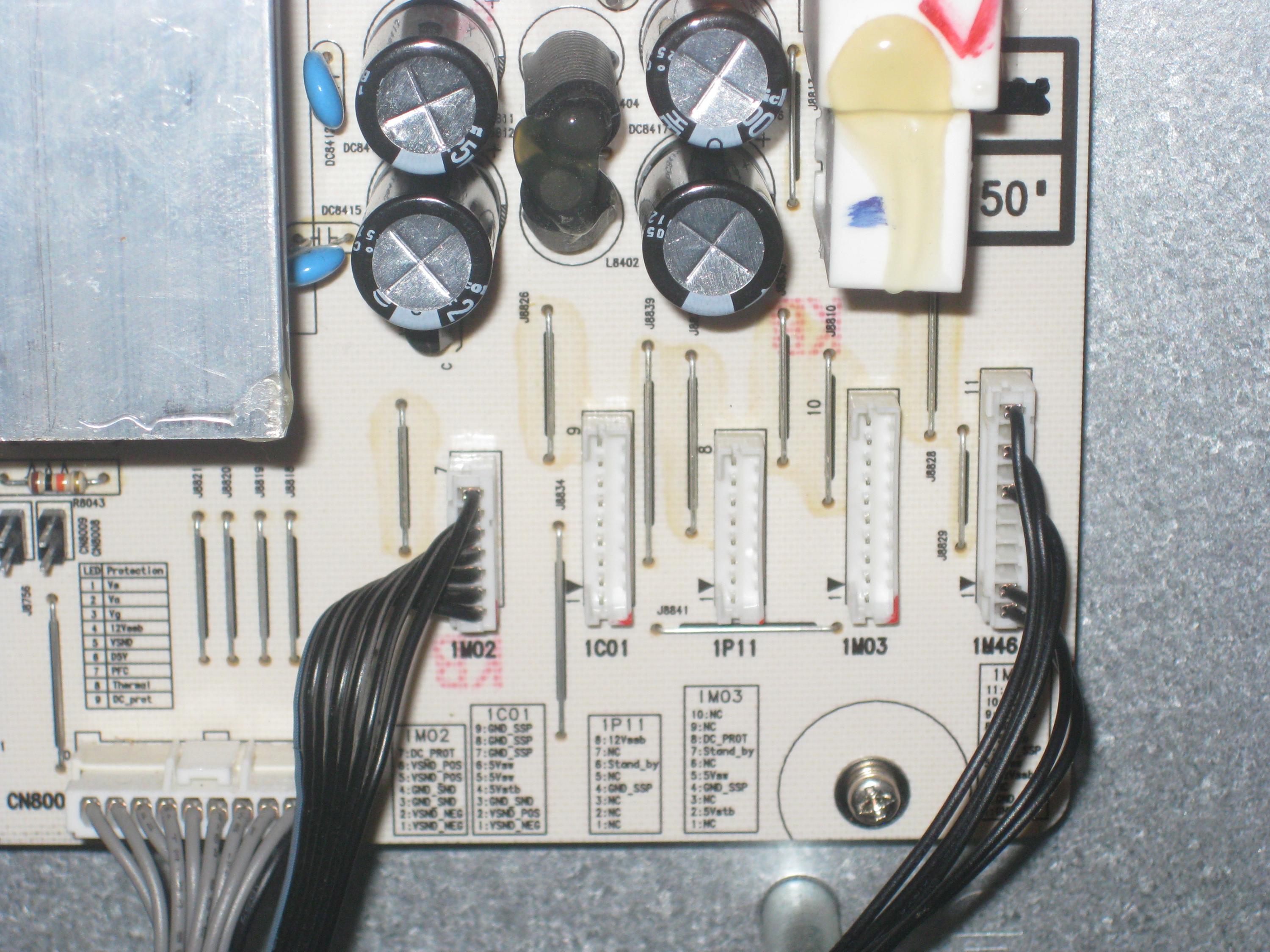

              I figured. After taking the main off, I put it back on and connected everything, screws and all. I started messing with the plugs and I have made some good progress:
              - In picture 006 it shows the far right connector plugged in. This allows all the boards to power on, including the main board. However when I plugged in inputs, nothing came on the screen. I don't have any HDMI connectors so I can't check those inputs. However the menu button, channel buttons, volume buttons, and power button do nothing when pressed.
              - In picture 007 it shows the next connector in plugged in and the far right connector unplugged. This allows all the board except the main board to power on.
              - In picture 008 both connectors are plugged in. If this is done before the TV is plugged in, the relays just click ad nauseum. If this is done while the TV is on, it just shuts everything off.
              Another note is that to get the status that I mention in the first bullet (picture 006) the TV must be on and the connectors have to be unplugged first. Then when you connect the far right one by itself, it clicks once and the main board powers on with everything else.
                Connector 008 may connect to a short, try tracing the wires labelled on it e.g. for 12V or 5V and see if the resistance is low.
