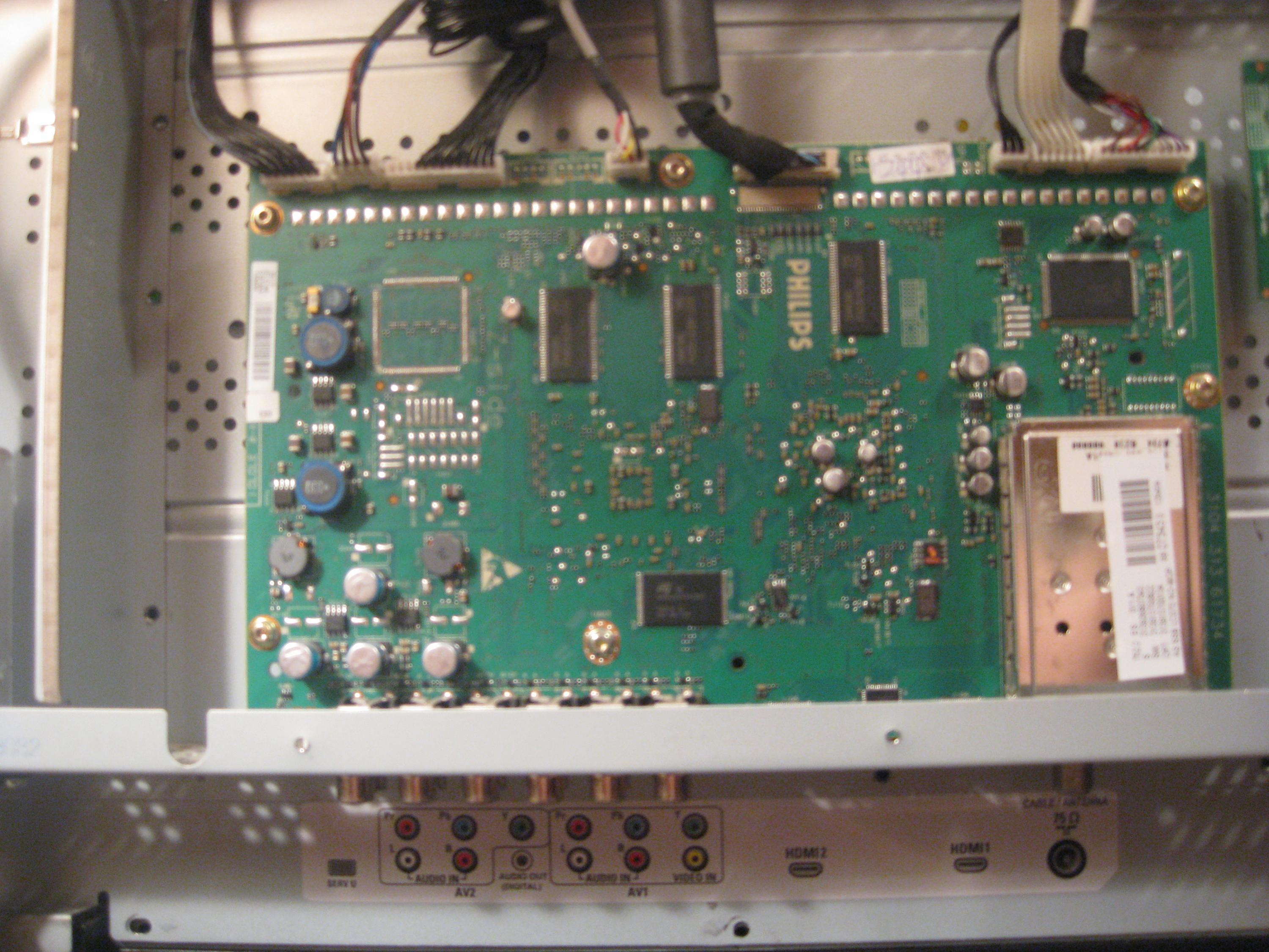

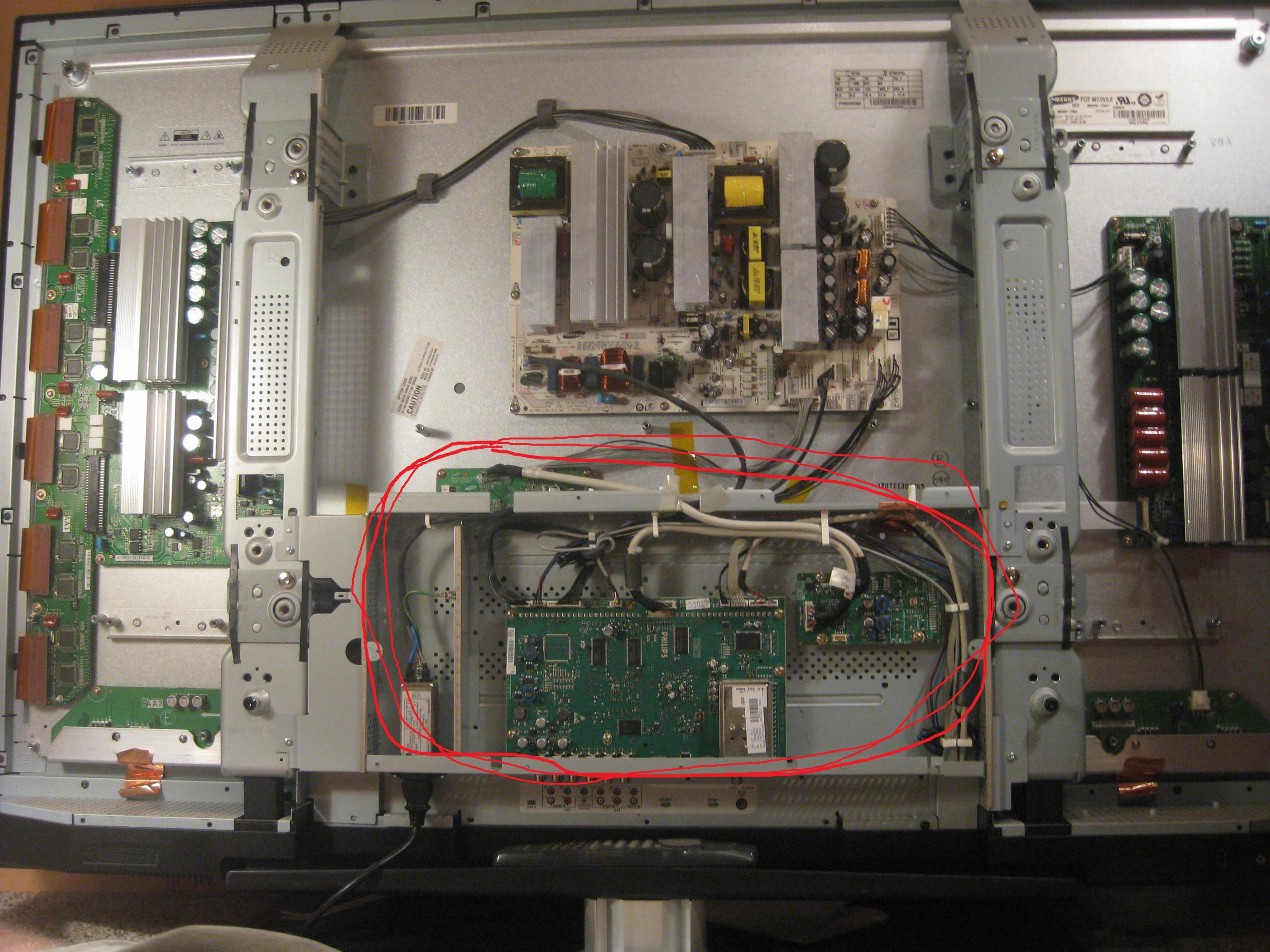

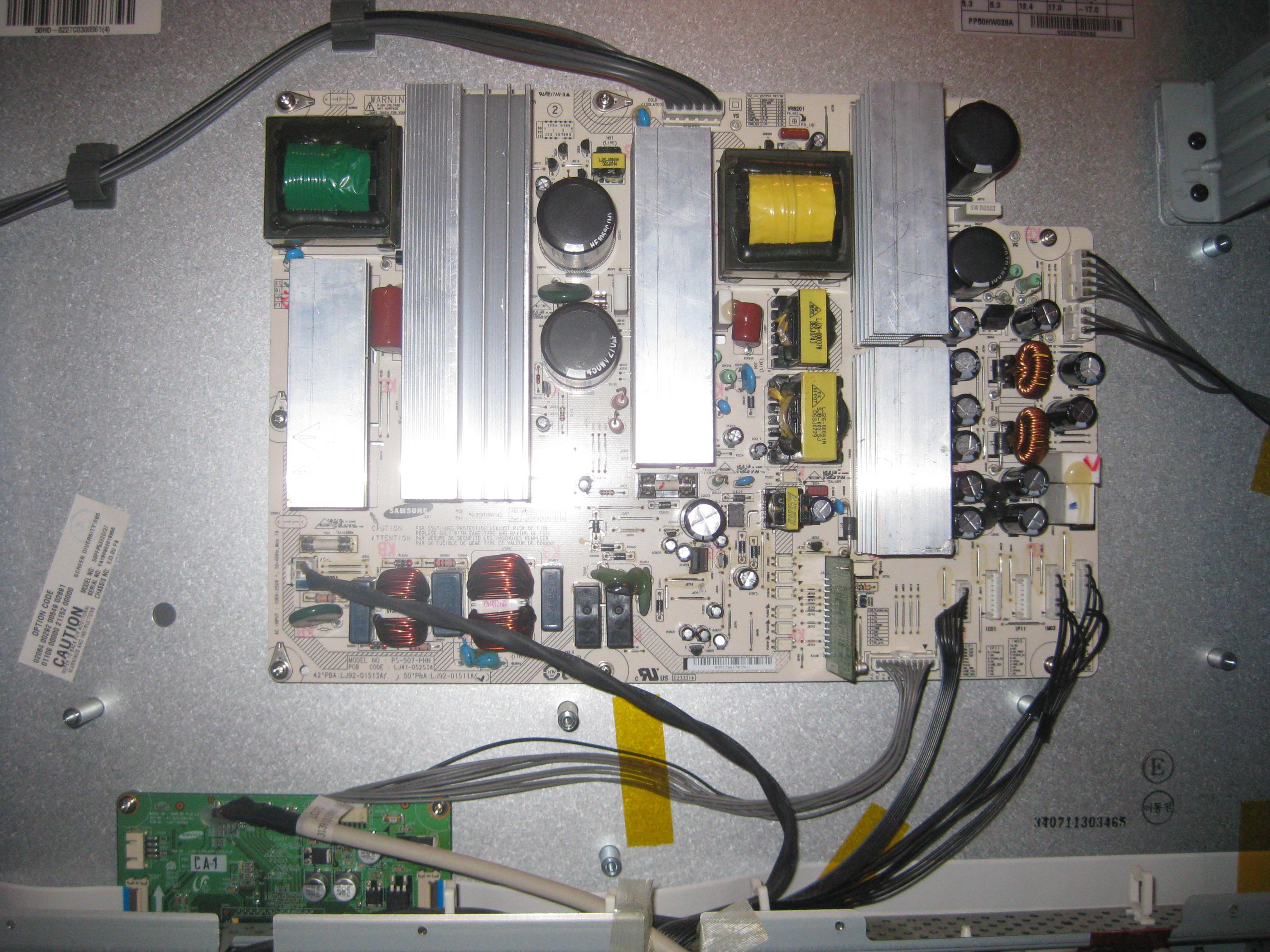

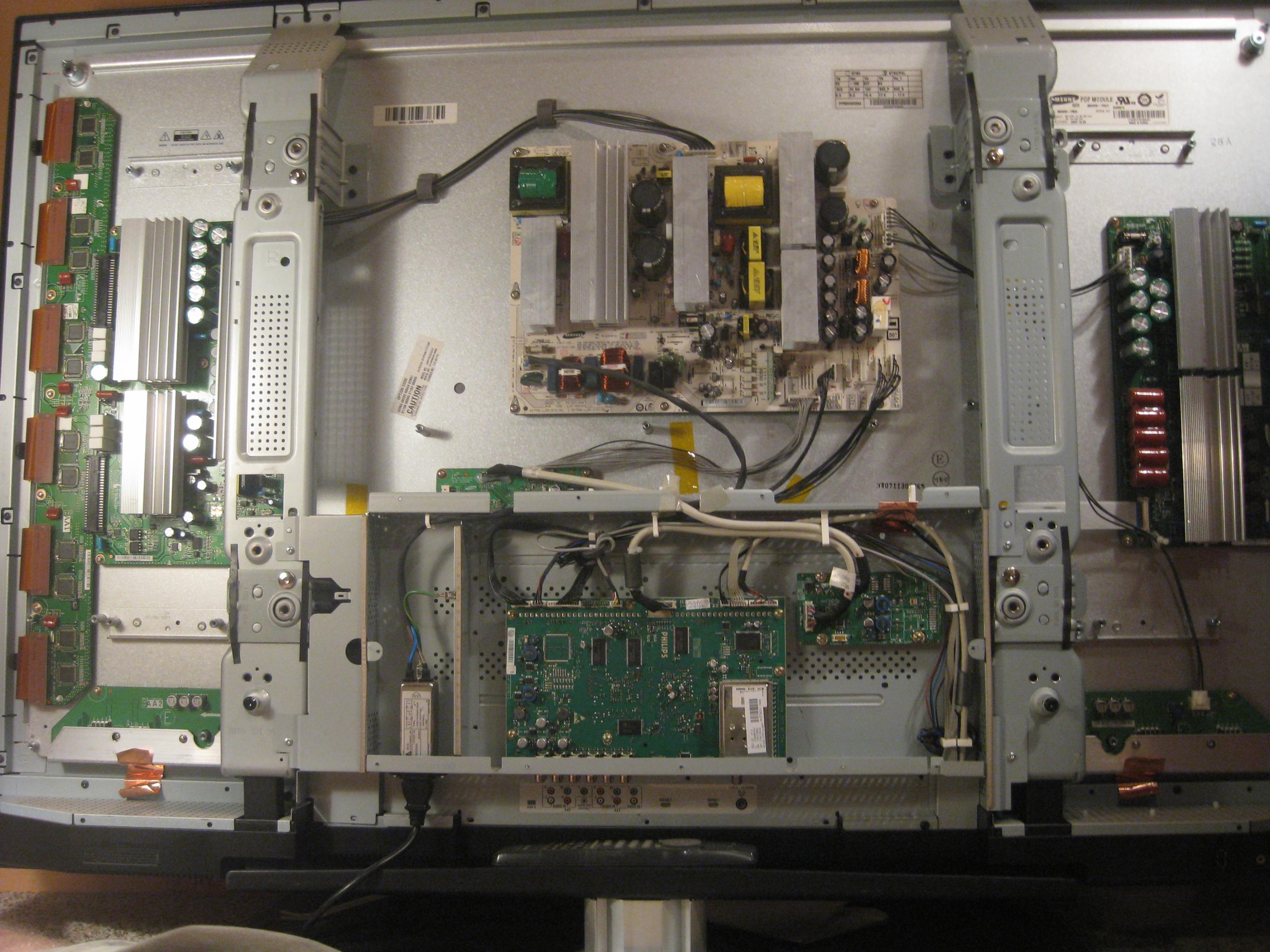

    Can you please post pictures of the chassis and of each large board in the set.
      Re: Philips Plasma 50PFP5332D/37
      Here are the pictures of the boards and full back. I was unfortunately working with limited light sources, so if they're too dark or just not good enough in general I can bring in a couple more lamps and try again.

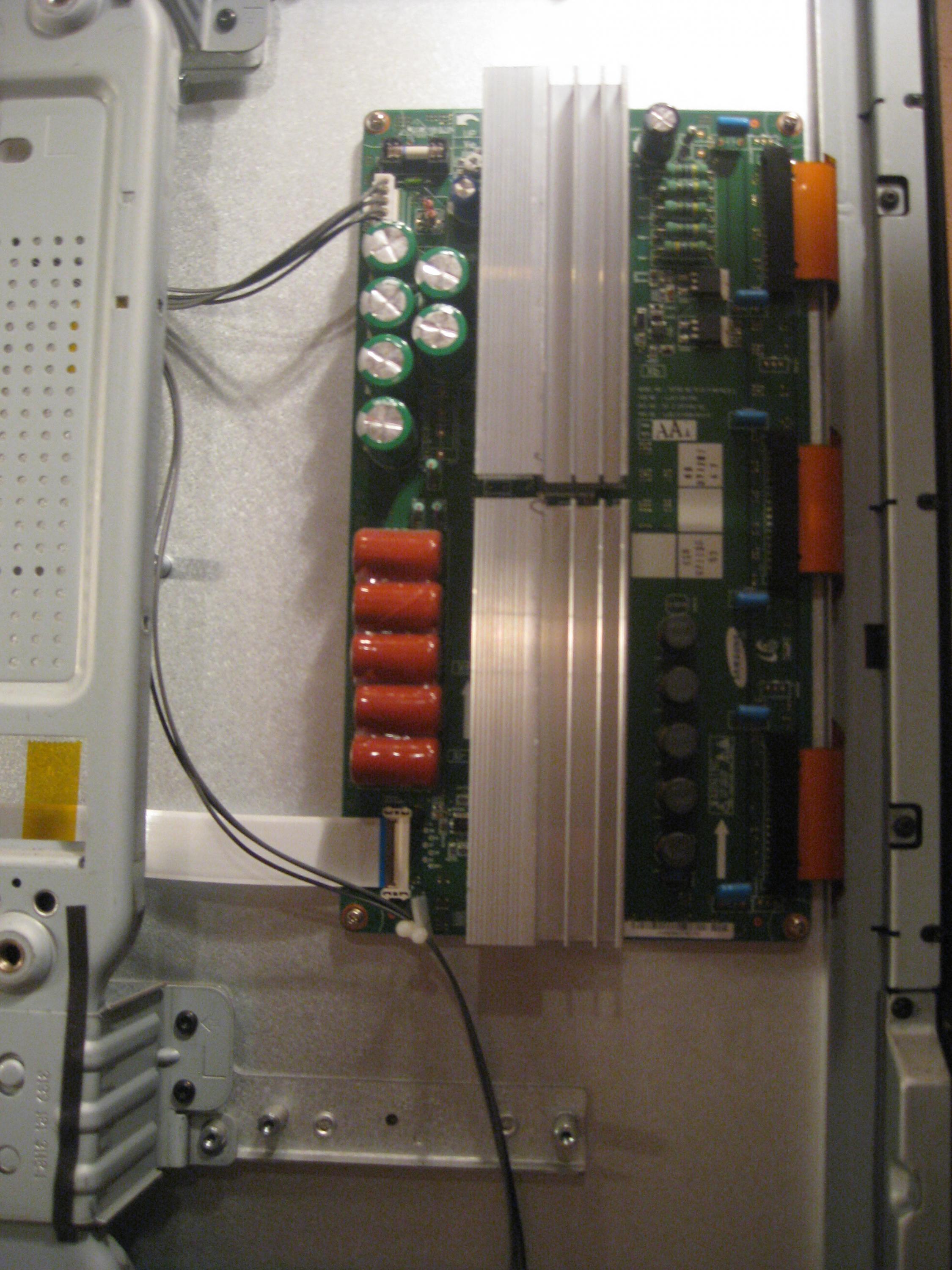

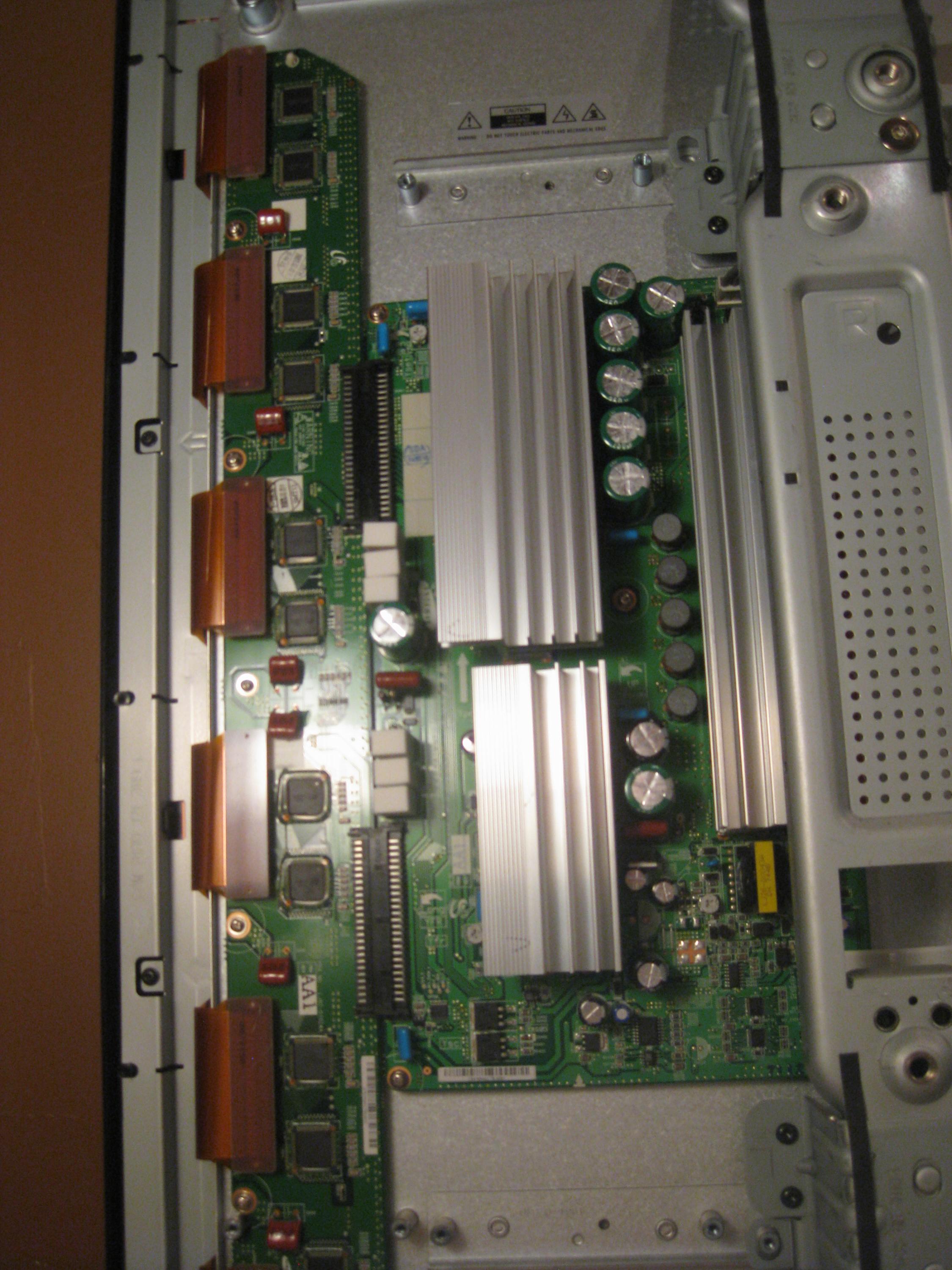

        Please try powering on set with these unplugged
        https://www.badcaps.net/forum/attach...9&d=1372211941
        https://www.badcaps.net/forum/attach...8&d=1372211941
          Both side boards are unplugged but the TV does not turn on. It just keeps clicking. With every click an LED on the main board, control board, and the little board right next the the main board, flash:
          https://www.badcaps.net/forum/images/attach/jpg.gif

            OK, can you measure the voltages on the connectors going from the power supply to the main board? Maybe some of the rails are not coming up.

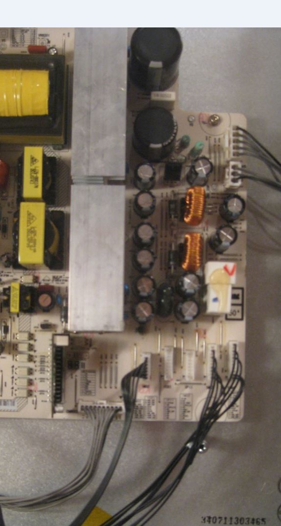

                  So I've had the DMM for a few days now and I just sat down to test the pins from the power to the main, but I can't see a good place to touch both sides from?
                    Black probe on chassis, red pin on each pin.

                        Update: After a little more looking, I realized that the large board on the left (https://www.badcaps.net/forum/attach...8&d=1372211941) was not plugged in and after plugging it in, I unplugged the third connector and the screen comes on. That board on the left does make a loud hum though.

                            Starting with all of the boards connected, I unplugged the third connector (1M46) from the Power to the Main. This allows the control board and the far left boards (Ysus?) to power on, and the screen glows. However this means that the Main board is not on as none of the relays or in-board LED's on the Main board are lit.
                              Sounds like a main board problem, then.

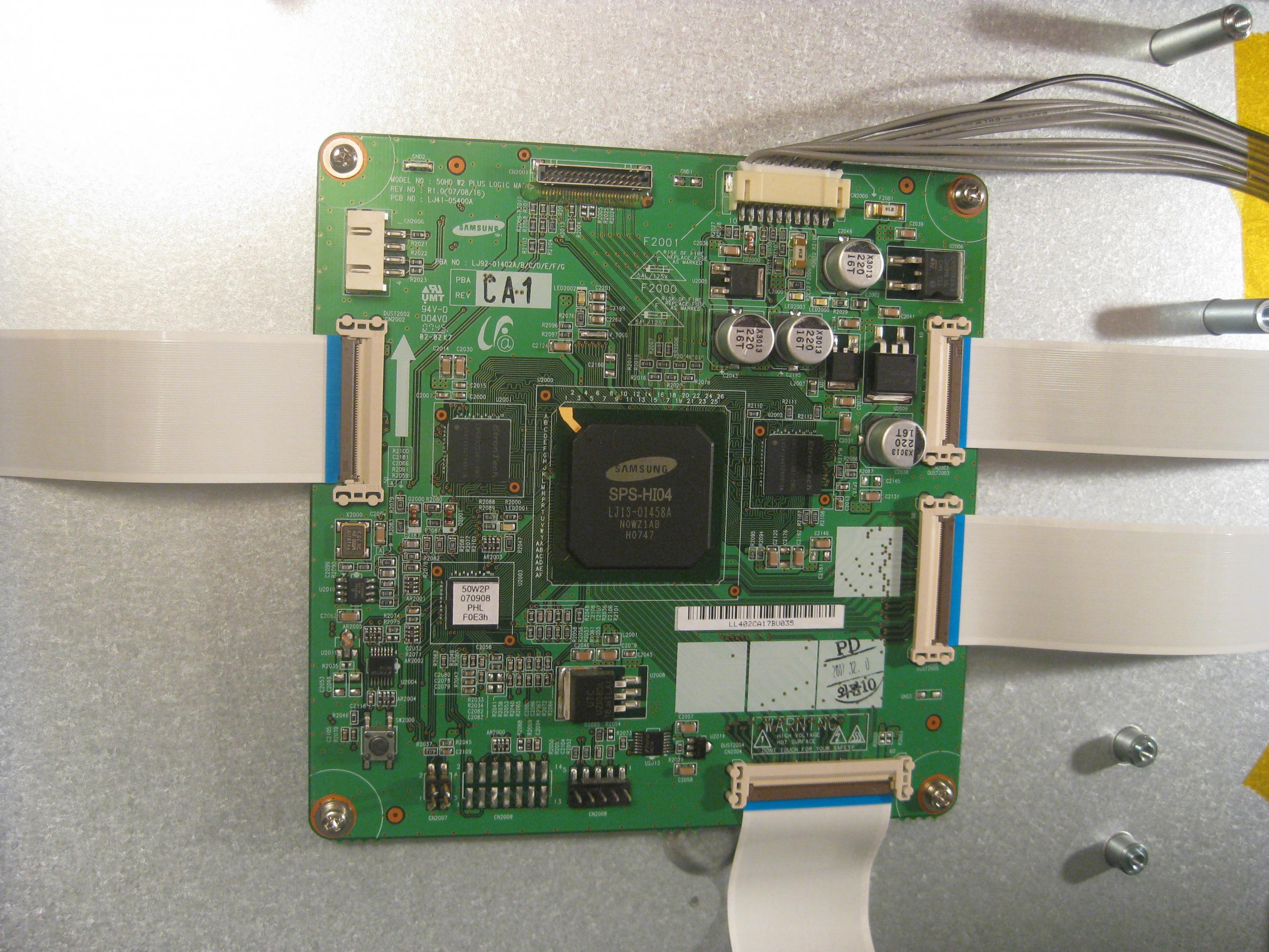

                                Since this is using a Samsung panel, you can place a jumper across a test point on the control board to enable test patterns. Post a picture of your control board, this connects via LVDS to the main board.
                                  Here is the control board.
                                    OK, CN2007 is your jumper block. See here:
                                    https://www.badcaps.net/forum/showpo...61&postcount=2
                                      I soldered a wire between pins 3 and 4, plugged everything in, and turned it on. The relays clicked repeatedly until I unplugged the third connector (1M46) from the power board. At that point the relays clicked once, the control board turned on, there was no power to the main board, the Ysus came on and then the screen started to go through several colors: white, green, red, blue, back to white with a scrolling black horizontally, then black scrolling vertically, and then a weird ripple effect coming from the bottom right hand corner. After all this it repeated. It seems the main board or the real small board right next to the main board is not working properly, creating the repeated clicking, and not allowing anything to turn on. Any thoughts?
                                        That would seem about right; the test pattern rules out the power supply, Y-main, Y-buffers, panel, control board and X-main.
