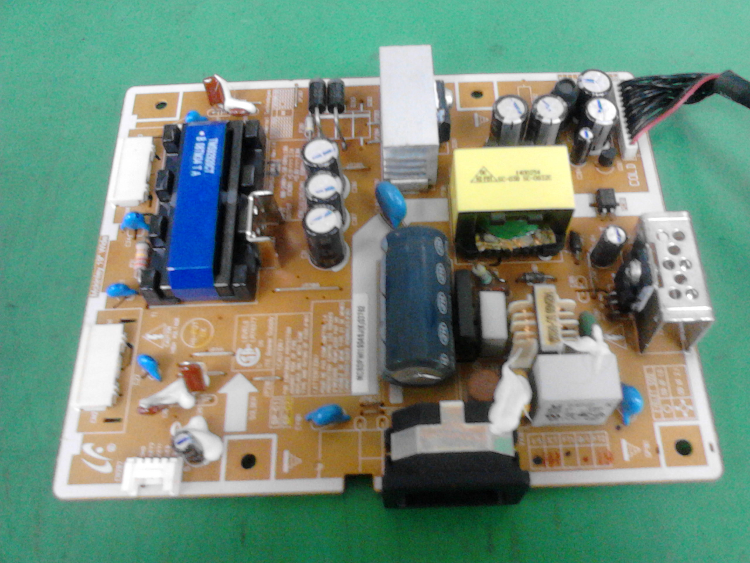

                    Could you please upload some photos of the board(s)?

                      Re: please help me on how to open samsung syncmaster T190
                      here is the photo
                        It has one of those commonly fail high voltage inverter transformer. Check the secondary winding resistances.
                          budm i already replace the transformer but there is another problem occur it blinks every 5seconds the caps are ok...
                          what are the other problem of this monitor?
