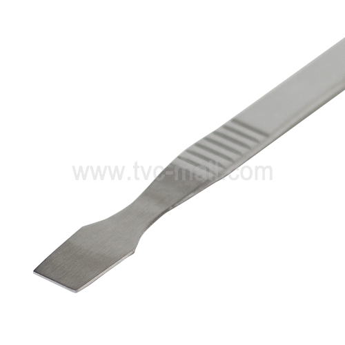

        I wonder how you managed to open this monitor?
        Samsung T190?
        Thank you.
          Re: please help me on how to open samsung syncmaster T190
          See the service manual here : (there's a section called dissasembly)
          You may need to use a metal spudger :
          You can find them on eBay, just search for "spudger" and you'll find them. Alternatively, you can use an old credit card.
          If you can't open it simply by removing screws like the service manual says ( i think they forgot a step), the monitor is made out of two plastic shells and there's some plastic clips keeping them together.
          You insert the spudger between the two plastic pieces and slide it left and right until you find one of those clips. Then, you use the spudger as a lever to make the plastic clip get out its position and release the other plastic shell.
