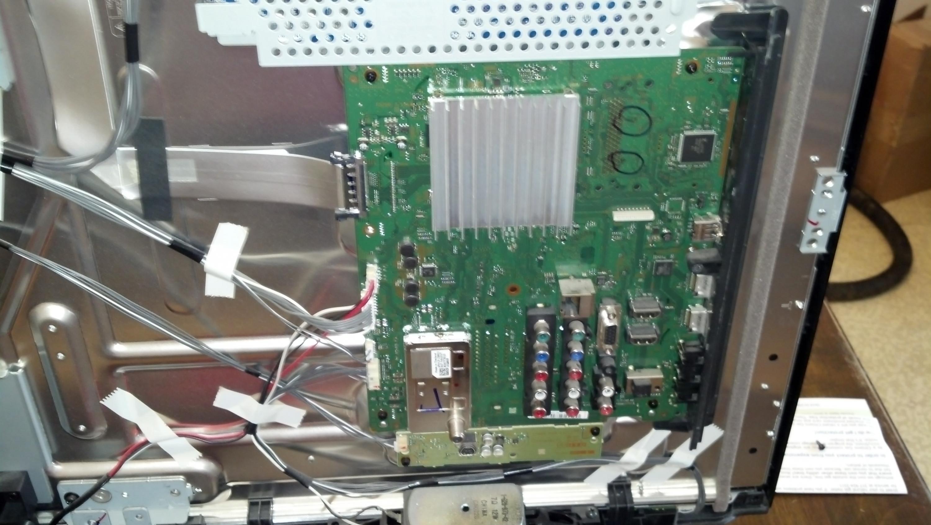

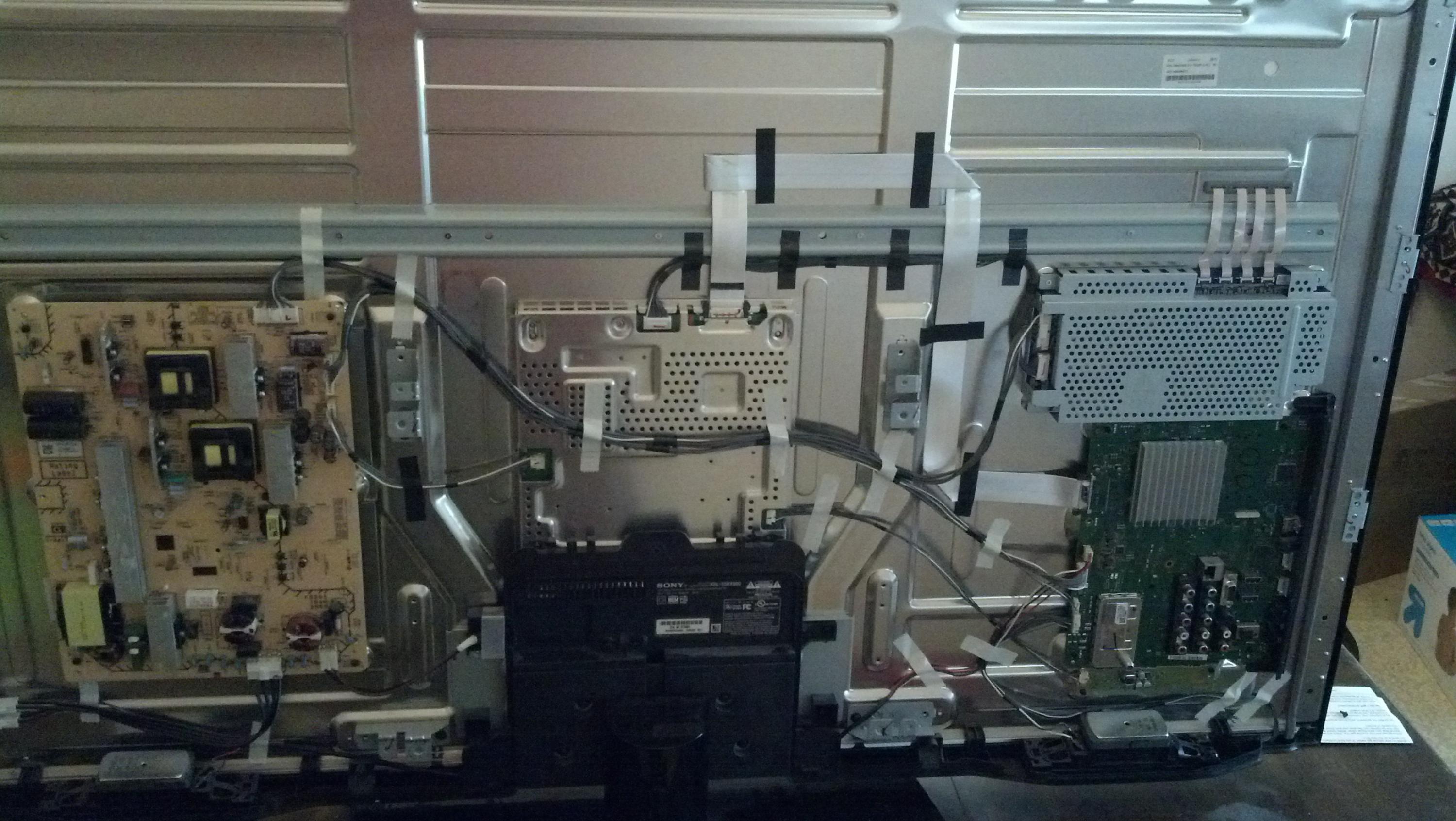

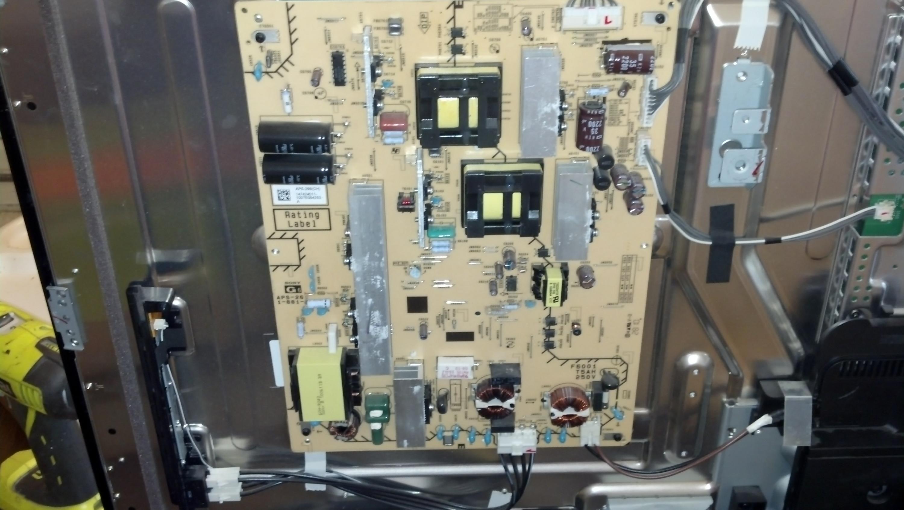

    So I picked up a 55 inch Sony Bravia 1080p 240hz 3d LED tv. The previous owner stated they tripped over the cord and it stopped working.
    When I pulled it apart I saw that the power connector was bent and one pin pulled out. I straightened it out and it and reconnected it and it fired right up.

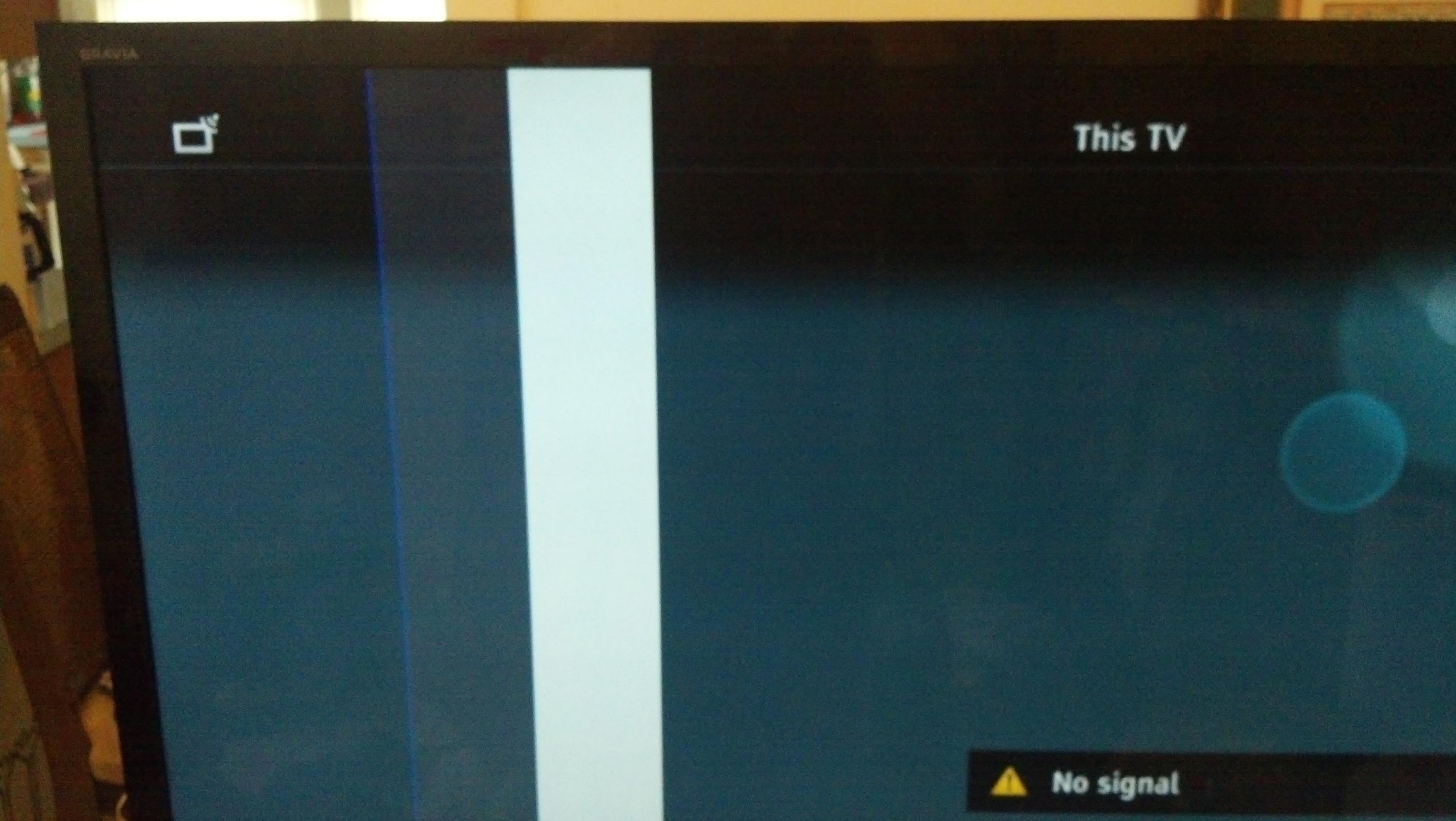

    After it powered up I noticed a white bar and faded bar next to it. Screen shots attached.
    Re: KDL55hx800 Sony white vertical bar on left side of screen

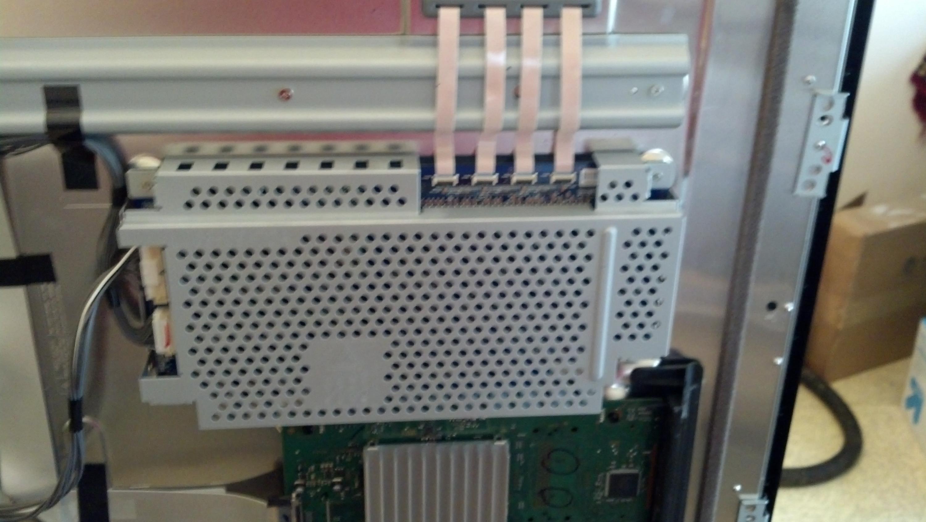

    The previous owner probably lied. This TV has been water damaged and the panel is probably bad. If it is not water damage there may be a minute crack on the panel causing the problem.
    • crbn79
      • Feb 2011
      • 64
      You're right Tom, checked bottom ribbon cables and one cable has about 5 pins corroded away. Man, I wonder if I could fix them with a trace repair pencil and just tape off the run to keep it from flowing elsewhere.
      I guess all in all it's not a bad deal, a really nice TV for my kids room, for just some of my time and a little gas. I'm sure my kids will be able to deal with the white stripe.
