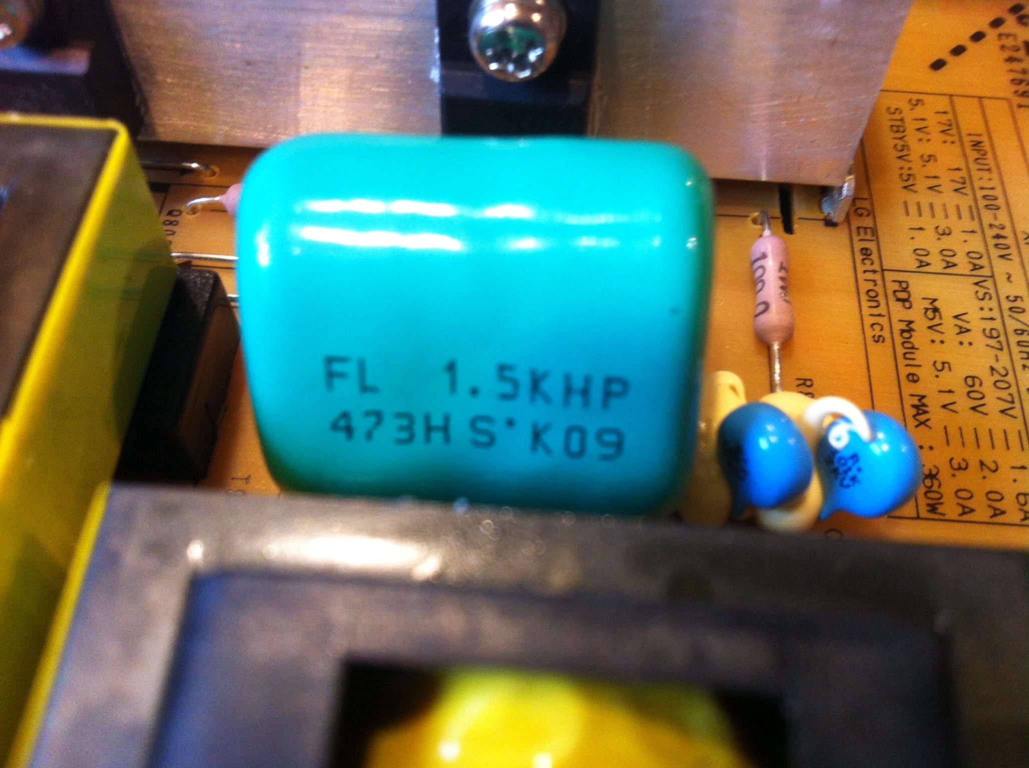

                        Same problem, TV turns on then immediately turns off. Fixed it with an 89 cent capacitor. TV is an LG 50PA5500, two and a half years old. Suddenly stopped working...would switch it on and it would immediately turn off. Sometimes if I left it unplugged for a while and plugged it back in, then it would click at intervals of 1 & 5 seconds repeatedly.
                        Inspection of the main power board showed C802, a rectangular film capacitor at the top of the board between the transformer and heatsksink was bulging at the sides. Found the part, 0.022uF 1.25KVDC, on DigiKey at $0.89 + ~$3 shipping (more expensive on eBay!). Replaced, TV working like new again.
                        Just posting as a possible quick-fix for others...on first inspection I was looking only at the usual suspects, the electrolytic caps. Took another very close look before I saw the problem.

                                Re: Need Help!! LG Plasma TV Wont Turn On!! Model 50PA5500
                                Same problem as above
                                I will try replacing the c-802 as mentioned
                                Looking at it it appears fine, however it is different in appearance from the other " barrel " shaped capacitors
                                I notice that all the capacitors have a band indicating negative lead both on the board and a stripe on the capacitor
                                This one does not have this indication - it in fact does not have the appearance of a capacitor
                                The C-802 on my board is green in color with the following markings: FL 1.5 kHP 473HS K09
                                I was unable to get a PHE850EB5220MB06R17 however was told that
                                399-5925-ND was the equivalent
                                Does it have to be installed in a specific way
                                Thanks for your help
                                  These types of capacitor are non polar, i.e. they work either way around.
                                    Just received my capacitor 399-595-ND and it looks nothing like the original
                                    My LG 50" plasma has a power supply board p/n EAY6096871
                                    I am attaching a photo of the capacitor c-802 that I require
                                    The one I received is black in colour
                                    and is oblong in shape.
                                    Also the leg spacing does not match the holes in the circuit board - spacing on board are farther apart
                                    Can anyone give me the correct part number or can I modify the one I received
                                      This part has been suggested before:
                                      http://www.digikey.com/product-detai...583-ND/1647864
                                      I don't know who suggested that other cap but it would never work, maybe the number is typoed.
                                        Hi Tom
                                        Looked up that capacitor on Digikeys web site
                                        The lead spacing is still .591 inches
                                        The spacing on the board is .854 inches
                                        Also the one you mentioned appears to be fairly flat whereas the existing one is about 1 inch long and .6 inches wide - sort of oval
                                        Not having a lot of luck
                                        The capacitors are cheap but the shipping is over 8 times the cost- so I don't want to keep ordering more until I am sure it will work
                                        Any suggestions appreciated
