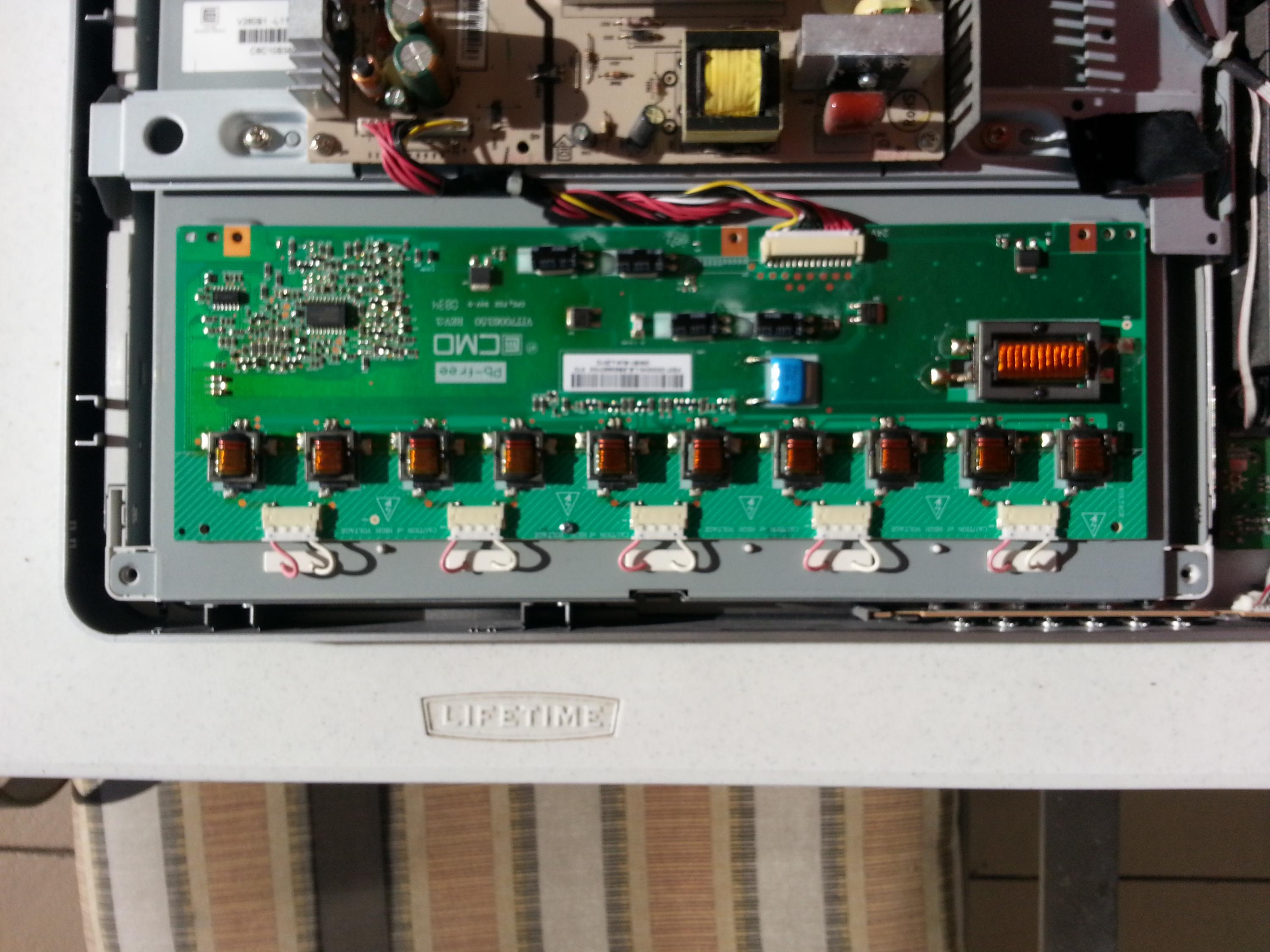

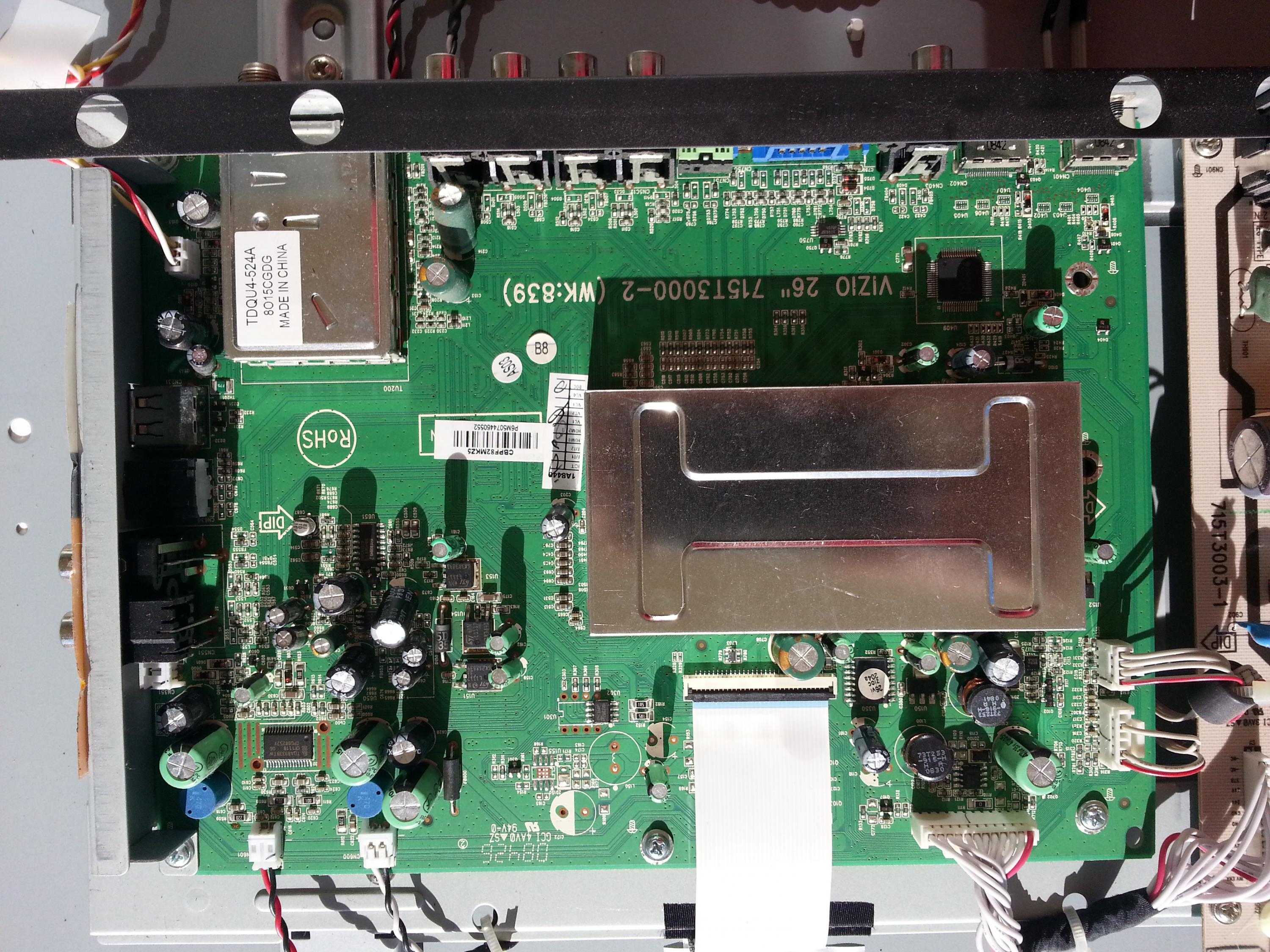

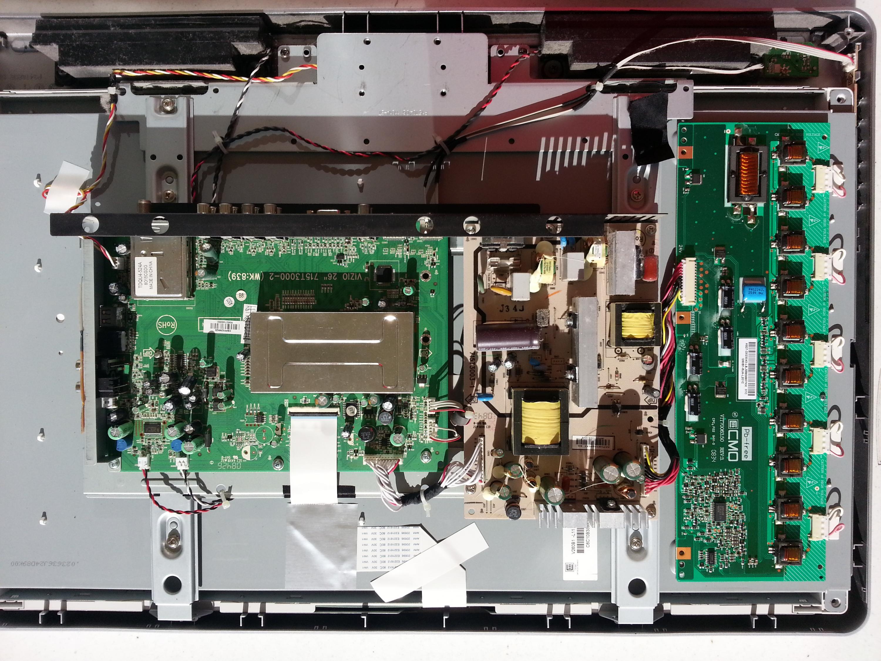

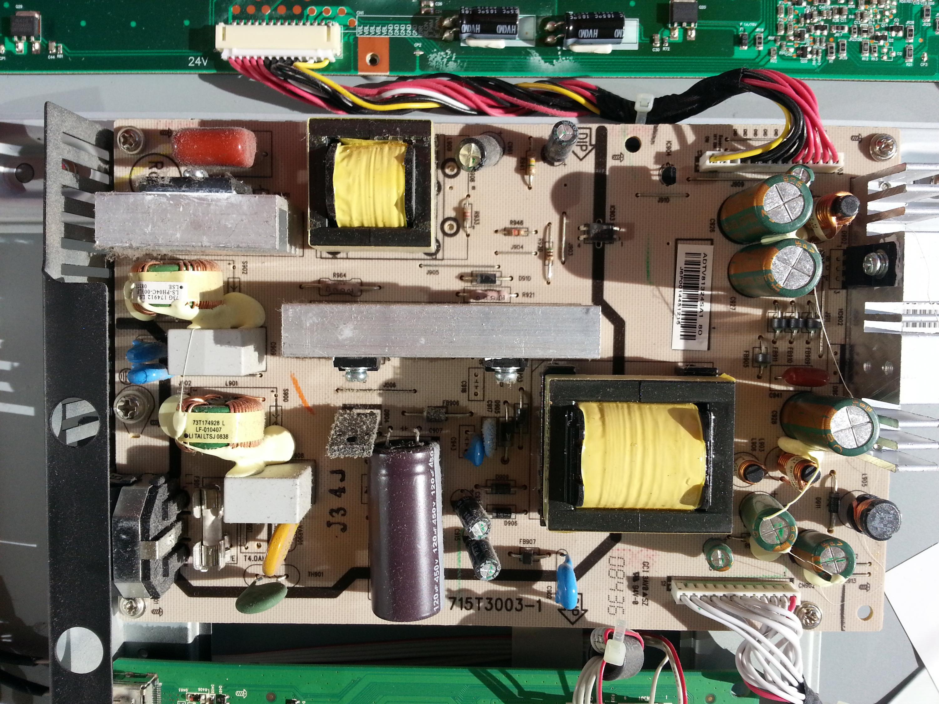

          Here are the pictures.
          Please advice if any need to be retaken.

            In this scenario can you see anything on the screen at all? If the inverter board is working you should see backlight, if the inverter board is not working you may be able to see the unlit picture on the screen if you look closely with a torch...
            Either way you need to focus on the PSU, it is most likely that at least one of the voltage supplies is not functioning properly. And this is most likely to be due to capacitor fatigue.
            I've marked the secondary side electrolytic capacitors. Normally the first step would be to check these.. What tools do you have to test with, if any?
            Given that it does power up after a few minutes, might be worth getting a hairdryer and putting it over these capacitors one by one (when the TV is slow to start up), to see if a bit of heat kicks one of the caps in to action. PLEASE MAKE SURE TO SET IT UP SAFELY IF YOU PLAN ON TRYING THIS.

                              Do you mean capacitors on the main board? Personally I would be focusing on the larger processors -- the "chips" -- as they are more likely to cause this issue.

                                  Re: Vizio VA26LHDTV10T -INTERMITTENT PICTURE
                                  Ah, bummer -- Just noticed most stuff is under this shielding can.
                                  https://www.badcaps.net/forum/attach...6&d=1368569640
                                  Perhaps any way to easily remove that (does it have press-down tabs that you could pull up?)
