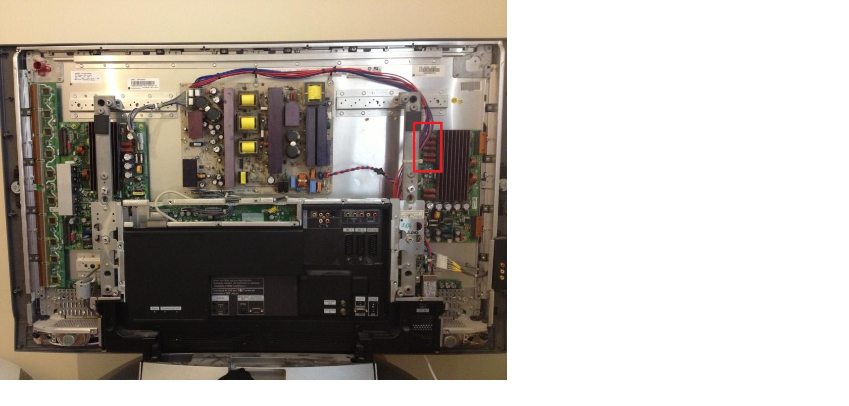

      K, on the Z-sustain you have five red capacitors. What voltage do you get across any one of these capacitors? (They are all in parallel, you need to test only one.)
        Re: Lg 42pc1d
        160v
          Re: Lg 42pc1d
          OK, seems quite high... there is a similar bank of 5 caps on the Y-SUS, it is underneath the large heatsink on it. Test the voltages there.
            Re: Lg 42pc1d
            97V next :P
              Re: Lg 42pc1d
              There's a fault on one board then. The voltage should be nearly the same between boards. I'm leaning towards the Z-sustain because I have not heard of an ERC voltage that high.
                Re: Lg 42pc1d
                what does ERC voltage mean and how could I further diagnose this/ rectify the problem? replace the board? :/
                  Re: Lg 42pc1d
                  ERC = Energy recovery, used to recover energy which would otherwise be lost in the plasma panel, to improve the panel efficiency.
                  Problem is, it's very hard to diagnose without an oscilloscope. Plasmas always are.
                  Now, if the Z-sus was bad, I would expect you would still get an image, but it would be dim. Too dim to be usable but still visible. But it is possible you have two faults.

                    well the original fault was the color was distorted until the TV warmed up (couple of minutes) the picture was like a yellow/orange color. if that's any help?
                      #30
                      Re: Lg 42pc1d
                      That points more to the Y-sustain, so it does help. I just wish I could be more precise.

                            Hi Kazzy if you look though to the top of the Av board do you see any red LED's when the set is on you should have 4
                              #34
                              Re: Lg 42pc1d
                              yea i think there is all 4
                                #35
                                Re: Lg 42pc1d
                                ok if you lift the Av board up out the way you will see on the control board the ribbon that go's to the ysus check that is home on both ends and the clips are ok.
