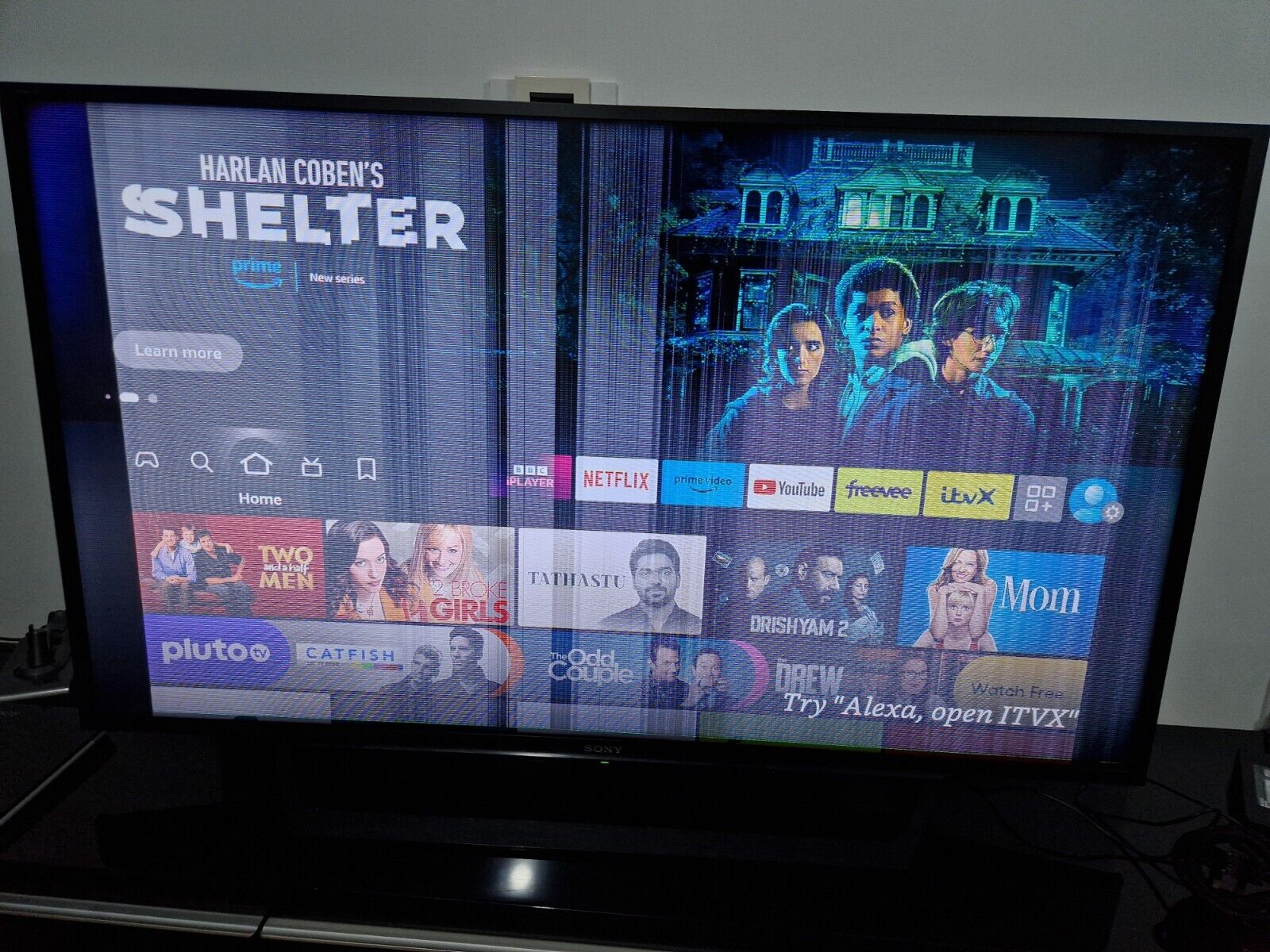

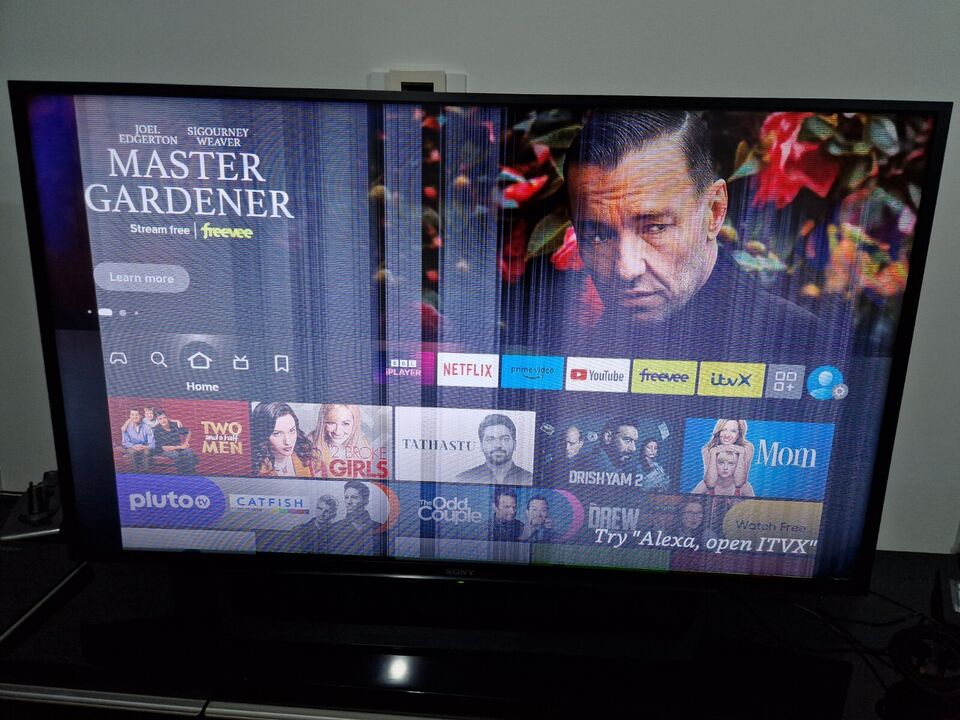

    SONY KDL-48WD653 - Distorted Picture, Can you help by photos?
    Can you help me please what can be wrong with this distorted picture?
    Thank you.

    Re: SONY KDL-48WD653 - Distorted Picture, Can you help by photos?
    can be panel or tcon but if you get spare tcon get one declared working from cracked screen
      Try the usual test, start tv with one ribbon cable at a time unhooked from tcon to panel on tcon side, make note of display.
