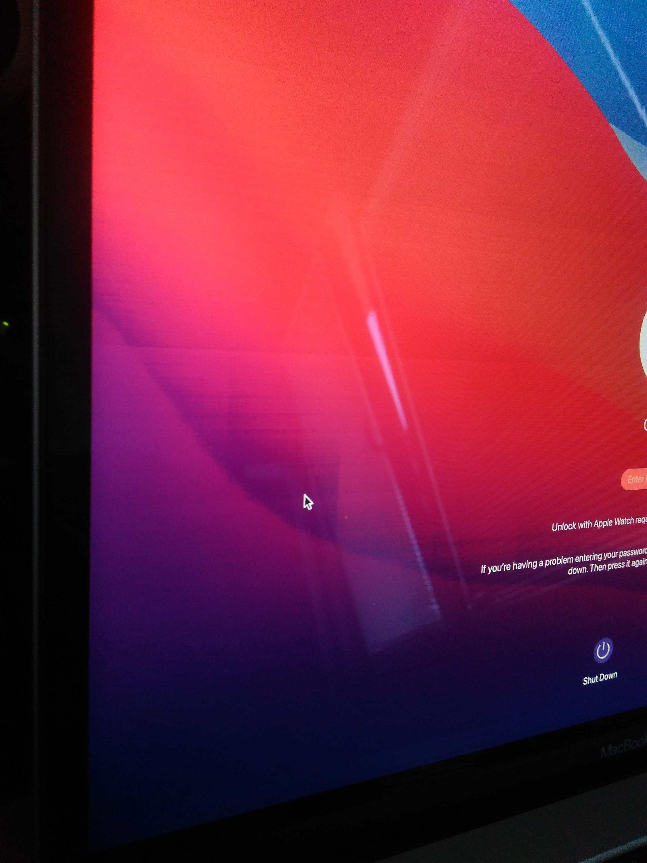

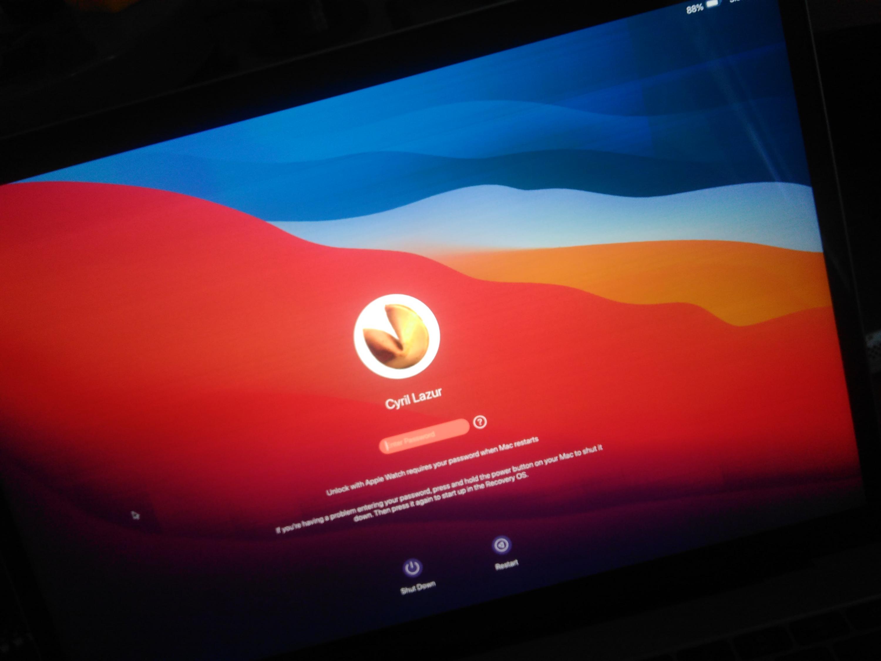

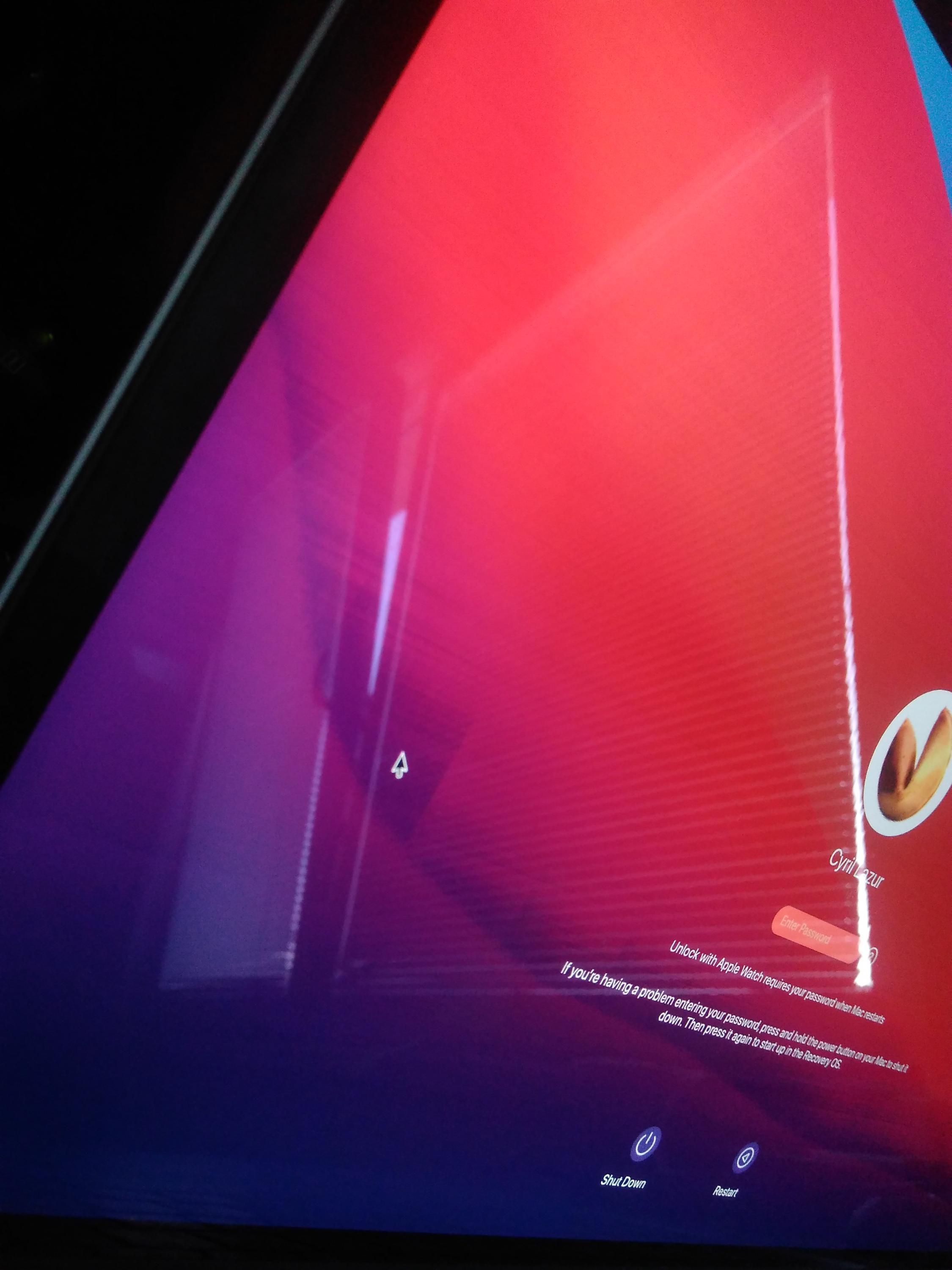

    hello.
    Have this Apple a 1708 - 820-00840 that have distorted picture for few seconds, than come to normal or few seconds and than again distorted picture. flexing hinges have no effect. distortion is like thin horizontal stripes and bad picture

    In my experience this is a problem with the display itself. I had a screen on an A1466 that would start shimmering on highlights, then go away. Replacing the display resolved the problem. Do you have access to another display? Do you have the ability to check it on an external display?

      External is ok. I try another lcd
