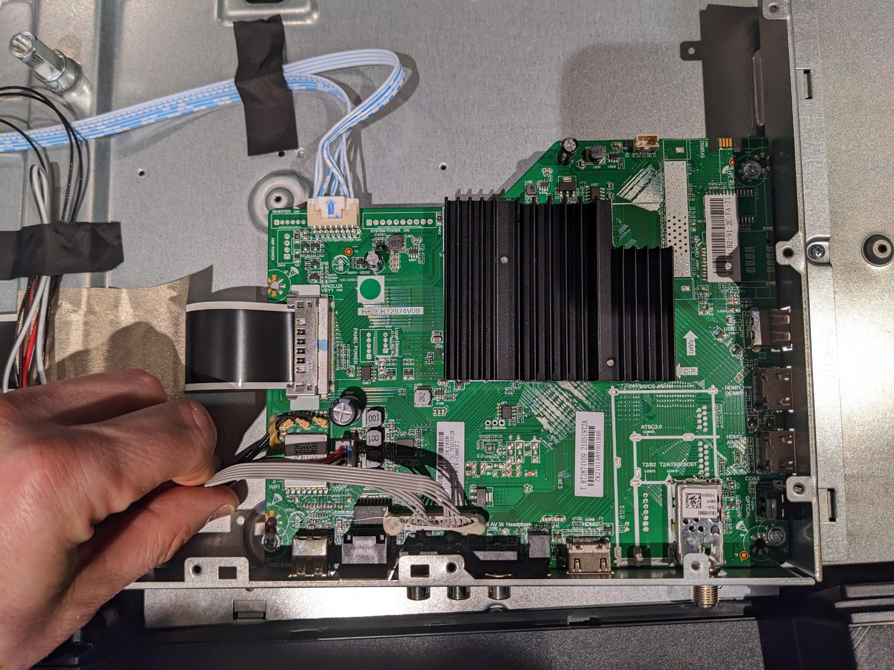

    RCA RWOSU7047 Distorted picture

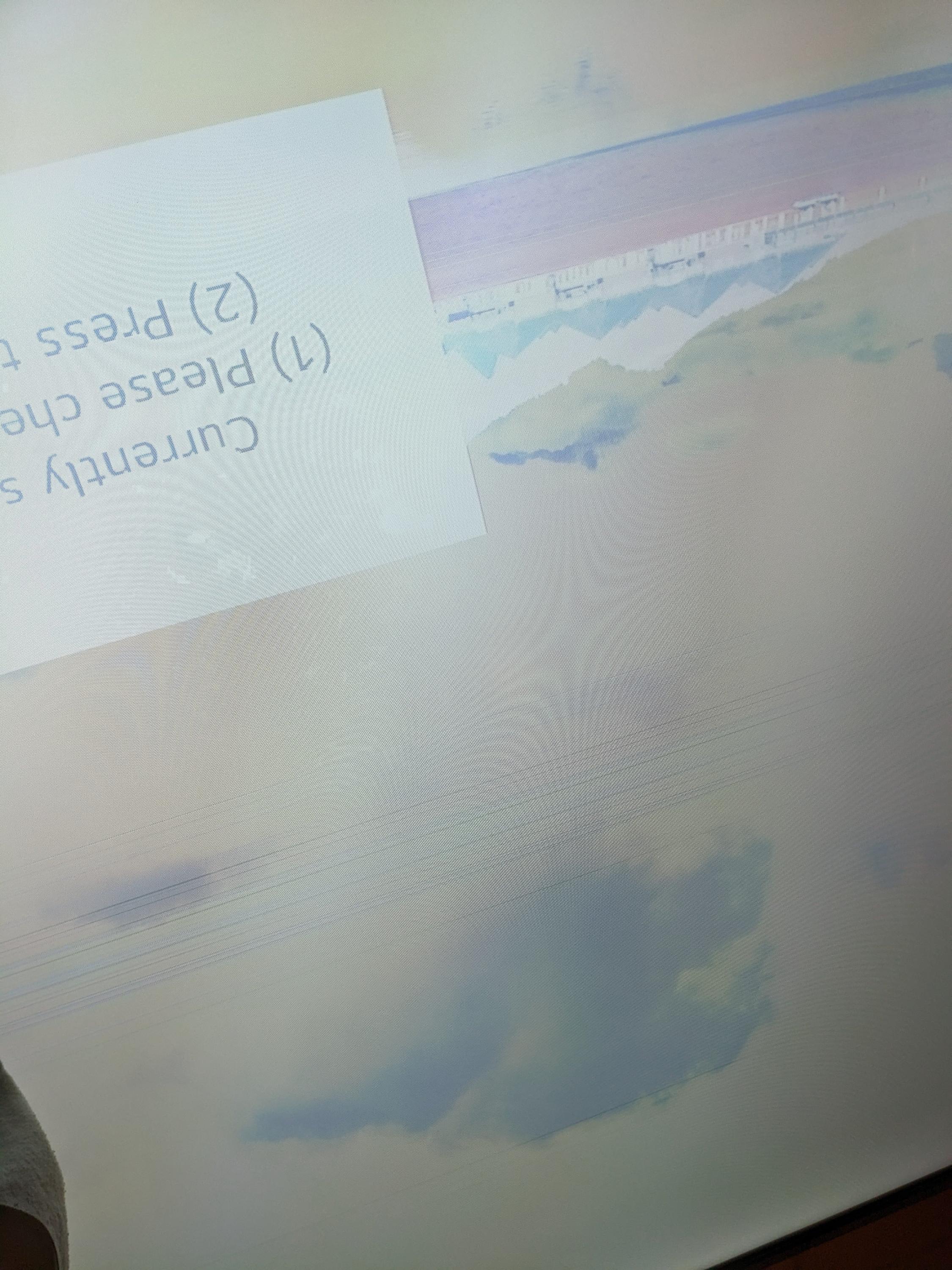

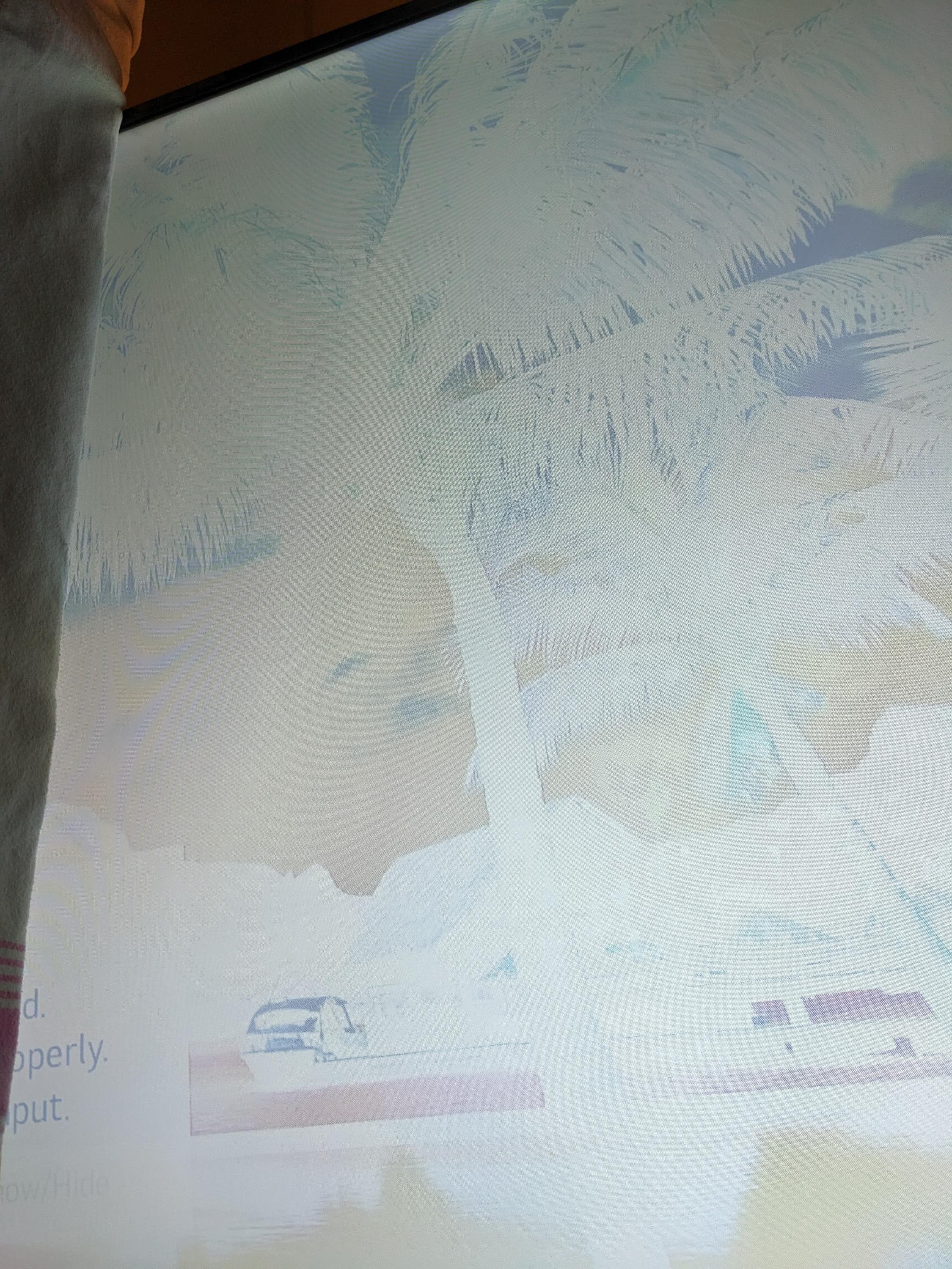

    Hey, please the attached pics. This TV will turn on (Backlights on) but no picture provided. I tried disconnecting the right side LVDS cable between the tcon and buffer board (pic 1) and then the left side LVDS cable between the tcon and buffer board (pic 2). I get an image each time, but as you can see, there's a discoloration issue happening. But with both LVDS cables connected i get a black screen (BL ON though).
    Just curious if anybody has seen this before? I will provide pictures of the boards shortly, I'm just in a rush and wanted to get this posted and see what the experts think!

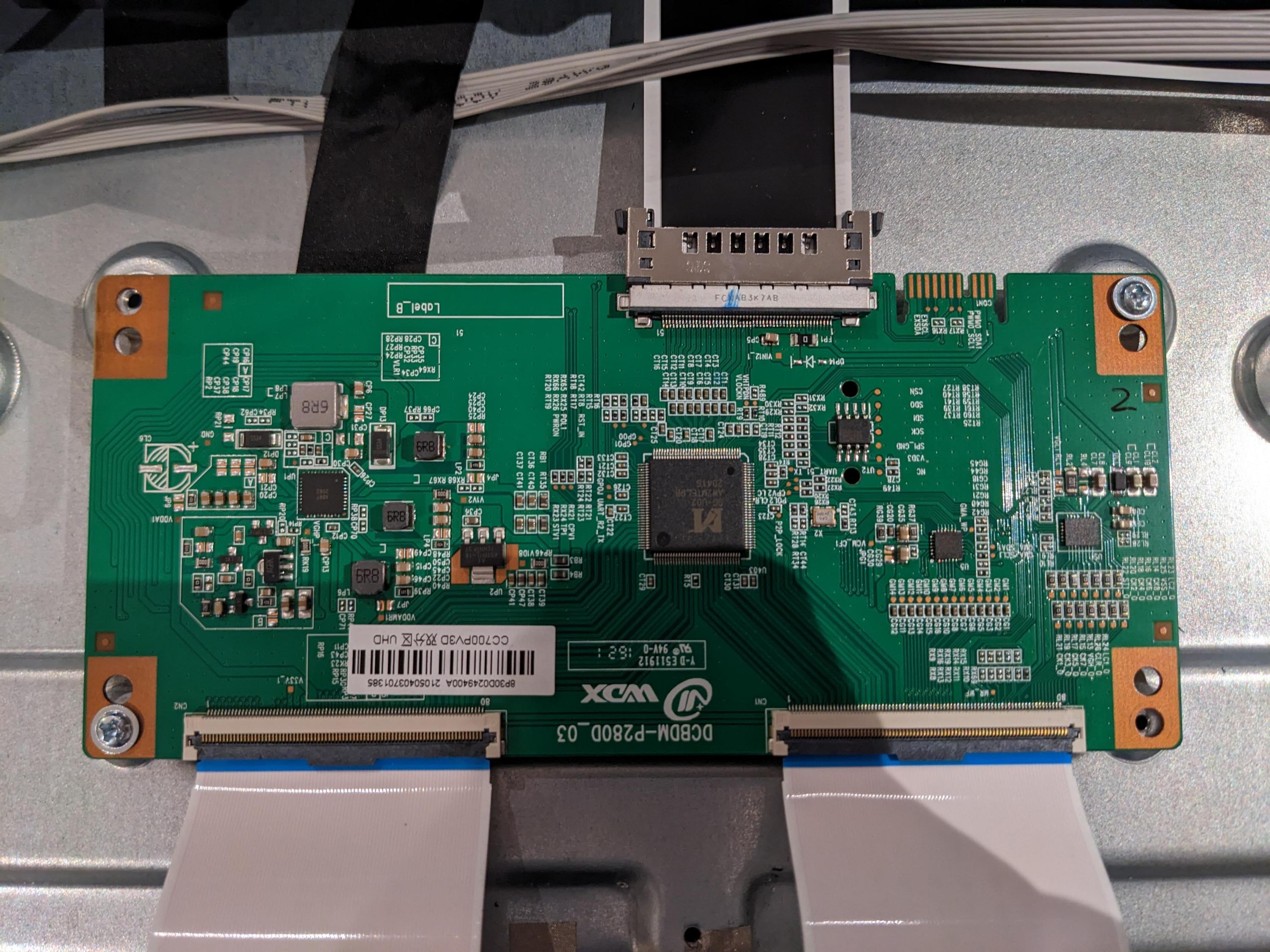

    Re: RCA RWOSU7047 Distorted picture
    Sorry for the delay, I got the pictures uploaded.
    I also took some measurements on the T-Con:
    All GM V - 0
    VGH - 0
    VGL - 0
    VDDA - 0
    BUT! IF I DISCONNECT THE LEFT OR RIGHT RIBBON CABLE TO THE PANEL BOARD (or both at sametime), I GET THE FOLLOWING MEASUREMENTS:

    I've changed the T-Con without success. Am I to assume its the panel??
    • Biruslapio
      • Nov 2013
      • 552
      • Brasil
      I see some horizontal lines, probably panel failure since t-con replacement did nothing, inspect the panel boards for shorts and/or overheating components.

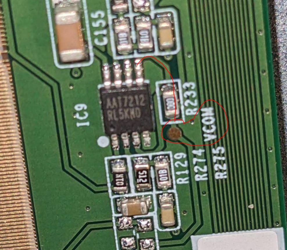

            When I power on with only one ribbon cable connected (L or R), this IC goes to over 140F until the washed out/negative looking image appears (the ones that I shared in Post #1). Once the image comes up, it starts to cool down to around 86F. I can't find any information on the IC though.
            Does anybody know what it does and if it's normal to get crazy hot?

                    I did at the end of Post #2, but that's ok! Moving on, so what can I do if both T-Cons have the same result? The 2nd one is new from Shop Jimmy. Is the Gamma IC possibly dead on both? Maybe the panel caused it?
                    • Diah
                      • Feb 2013
                      • 6558
                      sorry just i read at the end of post#2 ..
                      you replaced T-CON. but its far to call it new. the pictures show GAMMA fault. the IC you linked at post #6 are SPI NOR Flash Dual I/O . but its label look out as local manufactured by panel. so i dont know under which Taktfrequency this work, you may find from TV Spec picture Freq.
                      in general the SPI receive the Data direct from T-CON. so if the DATA Freq ( GAMMA ) fault it will effect it this why it become warm to hot and then cooling down after the image cleared.

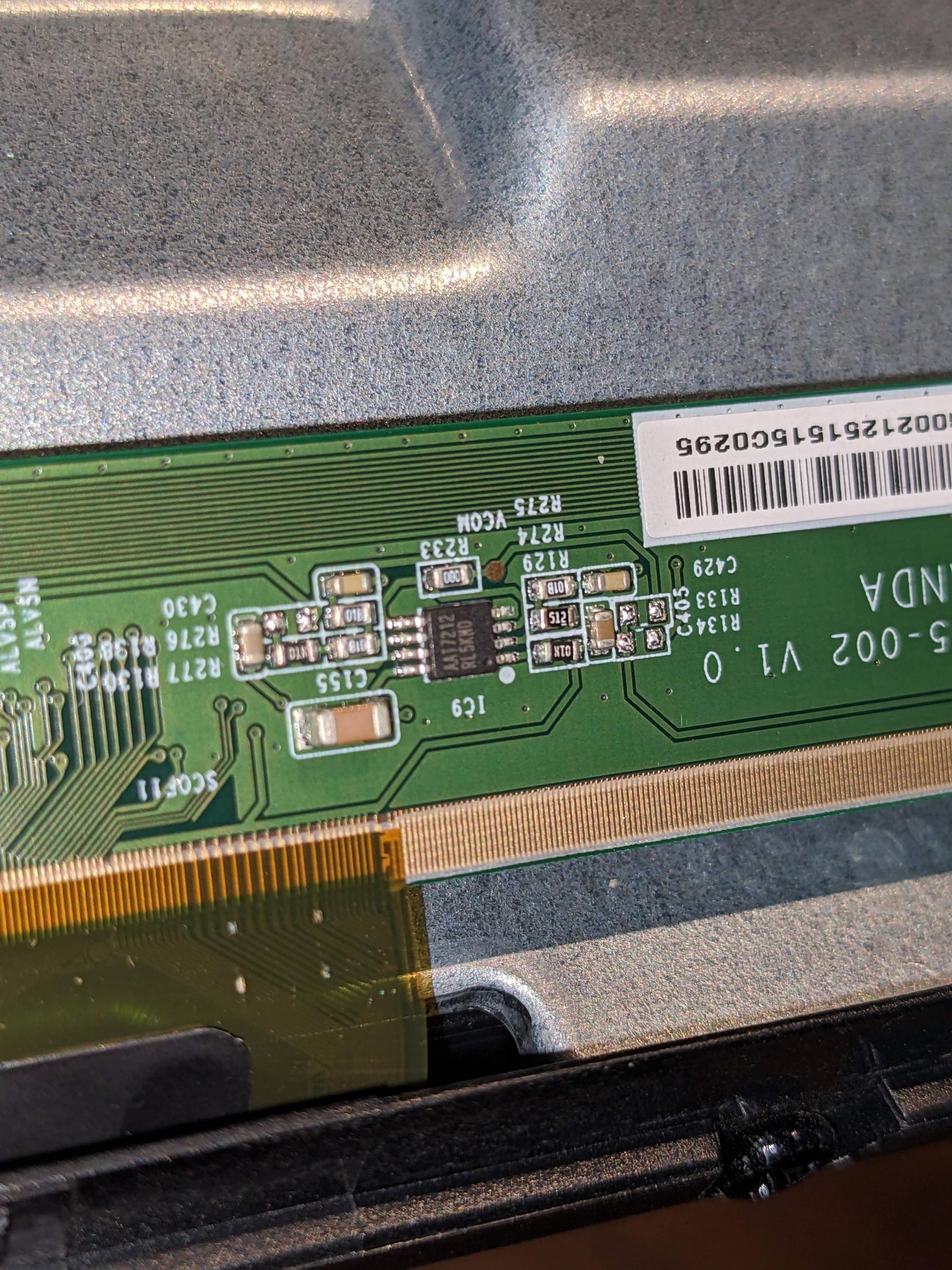

                        • Nicktronic
                          • Mar 2023
                          • 247
                          Originally posted by lotas
                          What is this SPI NOR Flash Dual I / O, this is a VCOM signal converter.
                          I think I agree with @lotas, after reading a little bit about VCOM, it can cause the white picture that I'm seeing. Possibly the supply voltage is too low. Does anybody have a datasheet for this IC? I haven't been able to find one.
                          • Nicktronic
                            • Mar 2023
                            • 247
                            I took the following measurements of the VCOM signal converter;
                            left side ribbon cable connected, displaying like the picture in post #1, after the high temp run up as mentioned in post #6
                            pin 1 - 244mV
                            pin 2 - 244mV
                            pin 3 - 6.69V
                            pin 4 - gnd
                            pin 5 - 6.69V
                            pin 6 - 3.5V
                            pin 7 - 3.5V
                            pin 8 - 15.84V
                            right side ribbon cable connected, displaying like the picture in post #1, after the high temp run up as mentioned in post #6
                            pin 1 - 268mV
                            pin 2 - 268mV
                            pin 3 - 6.69V
                            pin 4 - gnd
                            pin 5 - 6.69V
                            pin 6 - 3.4V
                            pin 7 - 3.4V
                            pin 8 - 15.8V
                            Both ribbon cables connected
                            0V all pins
                            I can't find any information on this IC, see picture (same as post #6)
