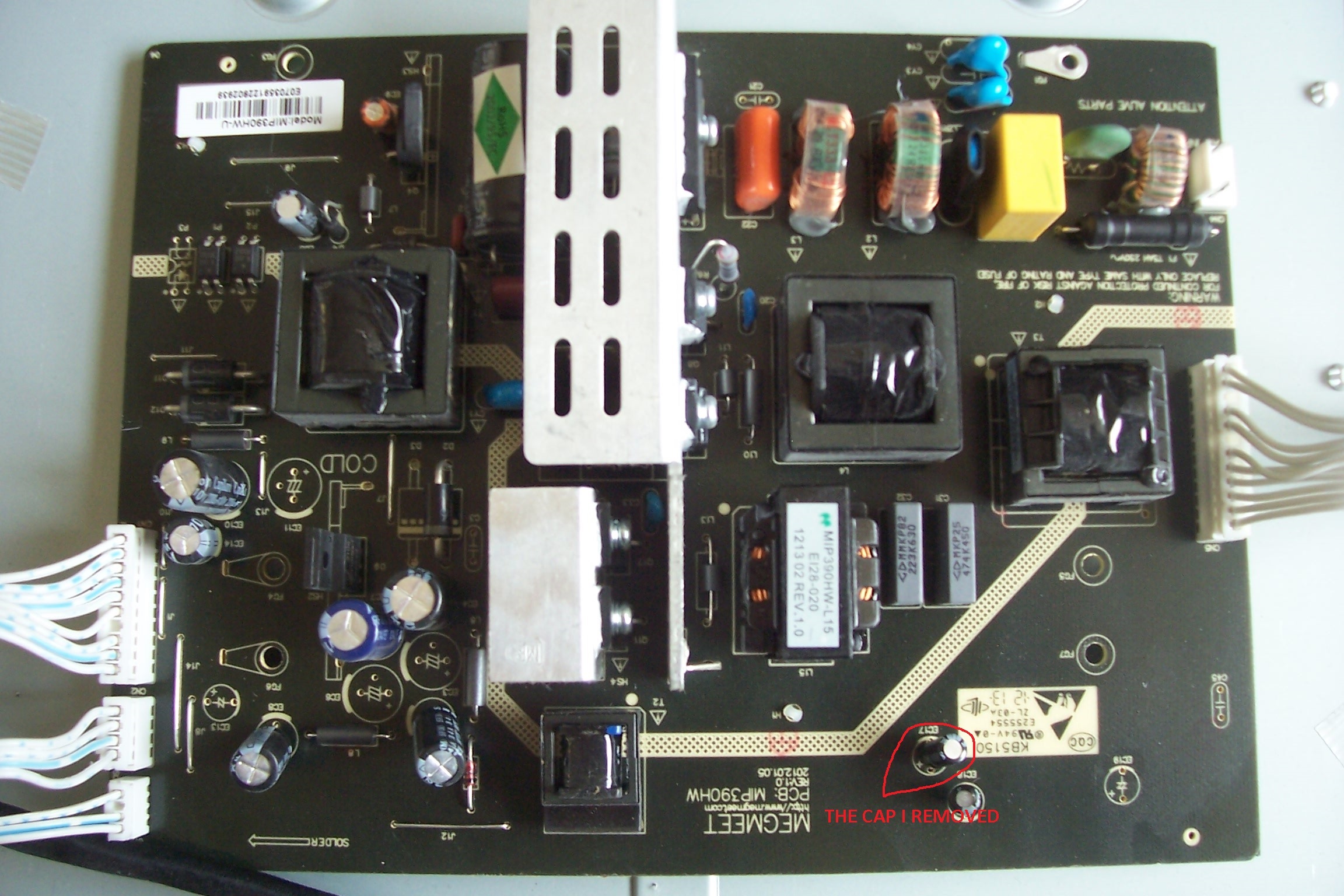

              I tested the cap about 10 times over 3 days and always got 3.7uf maximum, but now ive removed the cap its reading a healthy 10uf as it should, it seems strange i should get a bad reading so many times, is that normal or is it possible the heat from the solder and pulling it out has somehow fixed it?

                I think it's better to test them out of circuit it gives the most accurate reading, it's rare that a cap with such low capacitance goes bad, only 10uF cap I've seen go bad was CapXon and Fuhjyyu. Have you tried soldering it back in to see if it works now?

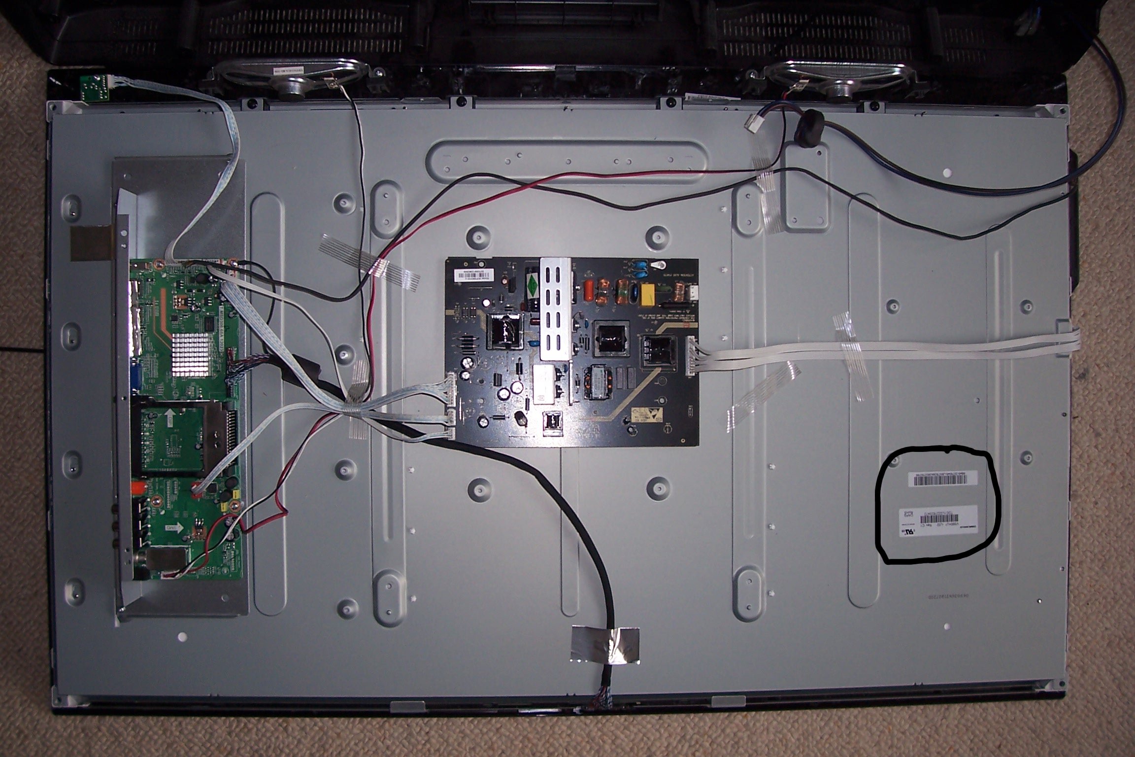

                          Yes the backlight works ok, never had problems with it, but the actual picture would flicker to a darker picture but then eventually fade away, then i press the brighter menu button and the text tries to appear but fades out again very slowly. Now i get no picture at all just a backlight, and i can hear the channel so i still get sound ok.
                          I dont know how to check the power supply outputs no, maybe i should upload a photo so you can see the boards and wires?
                            Re: Replacing a bad cap on TV
                            That sounds more like an LCD tab bonding problem. You can attempt to verify if the PSU is at fault by measuring the supply rails. If they're dropping, it's likely at fault, but if they're more or less steady, then it's unlikely.

                                  Some photos to show you the cap I suspected.

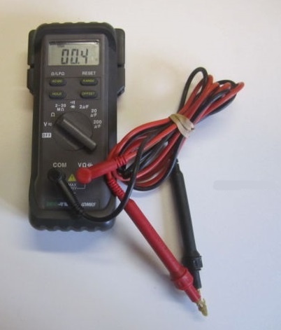

                                    This is the meter, my bro gave it me when he gave up his car audio repair business but i dont think its good enough for the job after coming here and learning about ESR meters.
                                    So is this a digital multimeter? obviously if not then i dont want to risk doing what you just said yet.
                                      Nothing wrong with that, perfectly adequate for most repairs. TBH most caps bulge when they fail. 95% of them do. However, there's no point shotgunning caps if you don't even know if the PSU is at fault.
                                      For measurements, set the range switch one step left, to the "V=" position.

                                        Can we get a close up of this sticker too? We can perhaps look up the panel datasheet from it.
