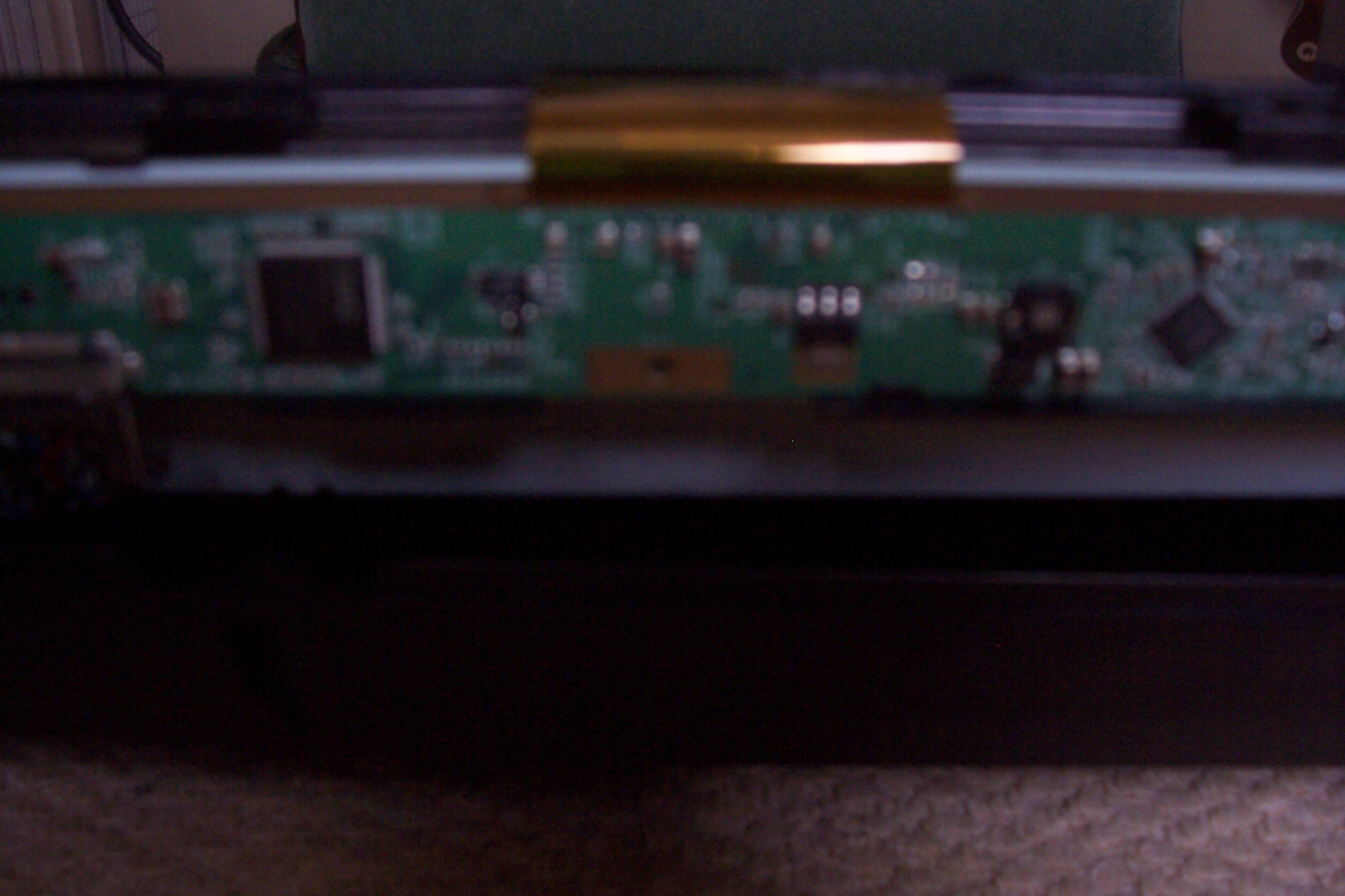

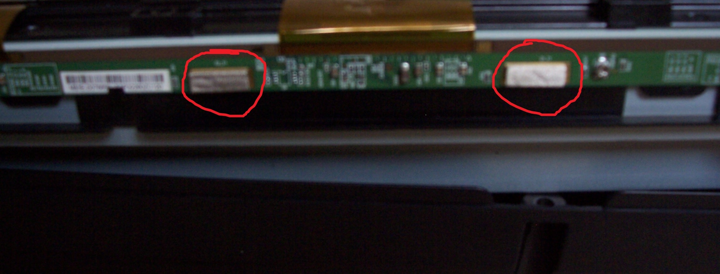

        just noticed that this screen panel board seem to be missing some of those spongy pressure pads, the pic shows where 1 is missing, and each end of the board has no pressure pads but has similar gold paint as if they should have some.
        These pads have not fallen off and been lost by me, i just know that they are either missing from the factory or its designed this way so i could try making my own pad for it.

          Looks like there's a screw hole there, so there wouldn't be a pad there anyway.
          The pads aren't for pressing on the tabs or holding the board in place. They are there simply to reduce the interference that driving the panel produces by completing the shield around the panel.

            you're right i see the metal surround has bulges where the pads go now.
            ive just managed to get a video recording of the problem, i will update this post with it soon.

                                  Well hopefully this is my last post on this, it seems like playing around with the ribbon you spoke about has fixed it, im getting a slight screen flash though, its like when you videotape a computer monitor and on playback you get those dark bands flashing because the frame rates are different, well its like that but very slight, but it only does it when the TV has been screwed back together, so theres clearly some kind of ill fitting part, even though everything is exactly the same, screws all the same torque, no bent plastic or metal anywhere, no trapped wires etc, lcd flats seem to be so temperamental.
                                  I hope this thread might help others because ive learned a lot of important stuff from you guys, thanks for your time and patience.

                                    I'd only put four screws in it (four corners) for now, it may go wrong again and you may need to apply a more permanent shim.

                                      Yea thats what ive done but im going to be playing with it more yet to cure this new dark band problem, the fact i got rid of it shows both problems ive had is down to bad connection/contact. Gonna brainstorm it and see if I can spot a design flaw or something, but im happy to fix the main problem.

                                        It uses a crappy cheap Chimei Opto (Innolux) panel, they have lots of tab bond problems.

                                          Well since I took those pics of the tabs its been working again, but the pressure on that panel doesn't seem to make any difference to the picture on mine, i cant reproduce the fade out and cant get rid of this flickering, its not usable cos its too distracting even though its very slight.
