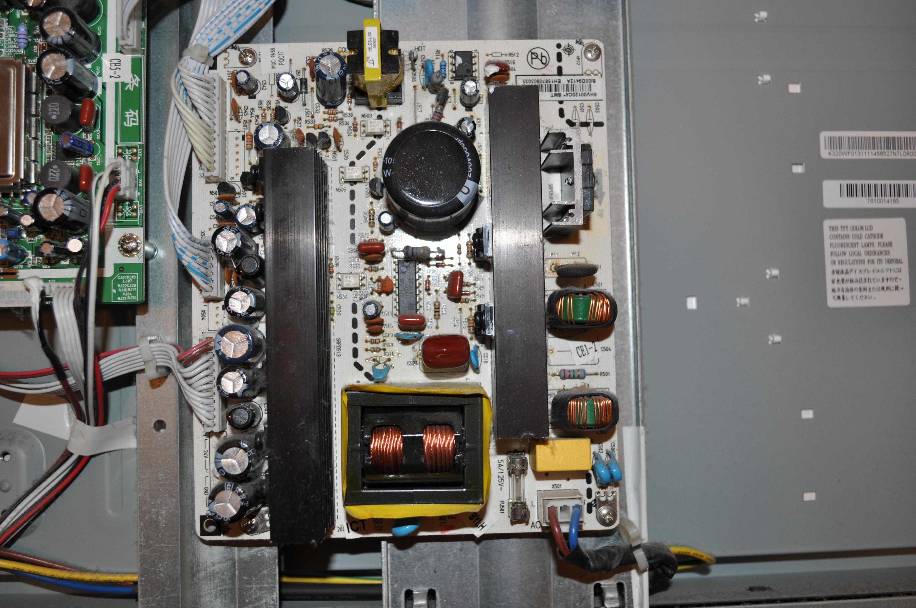

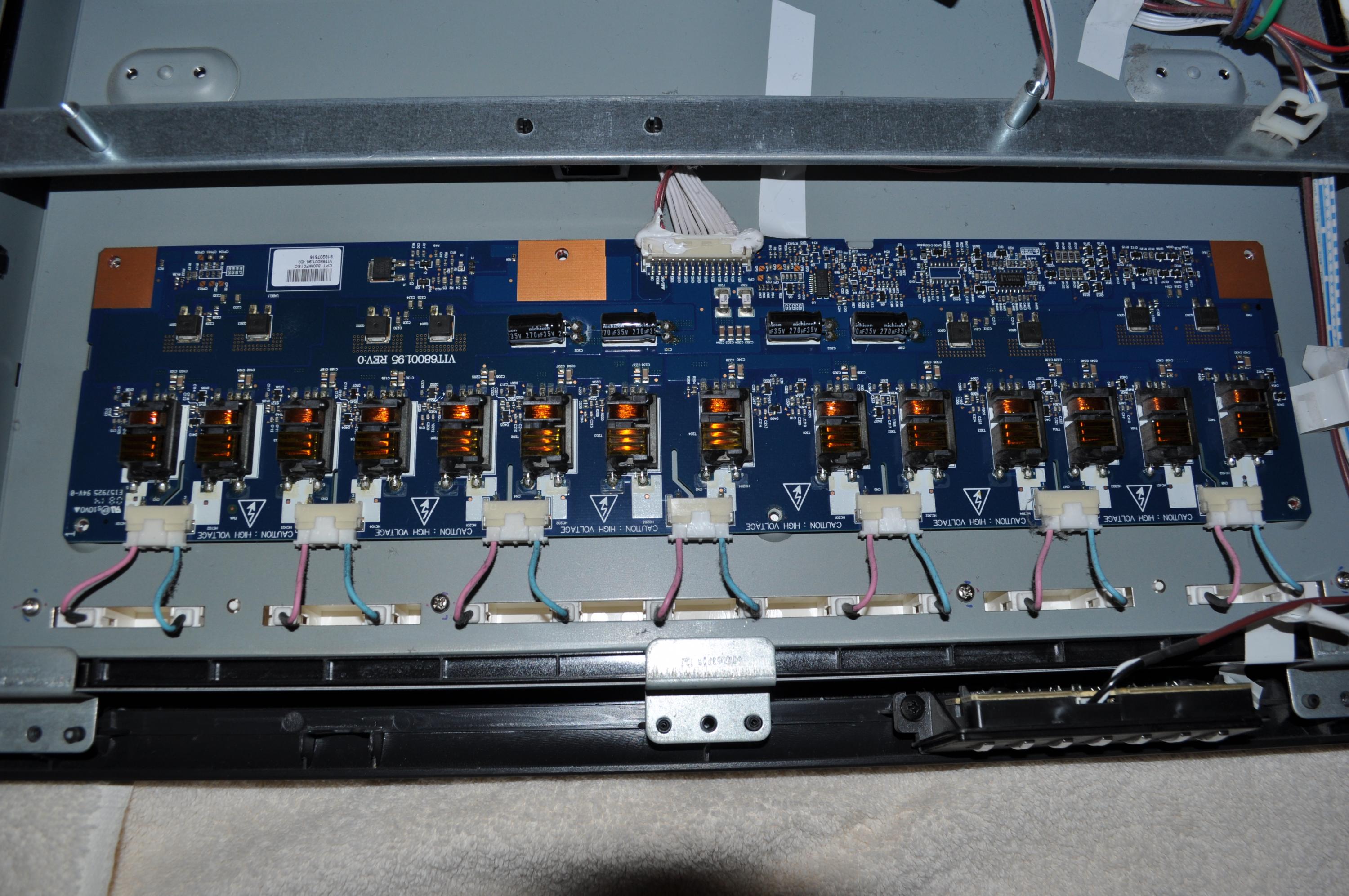

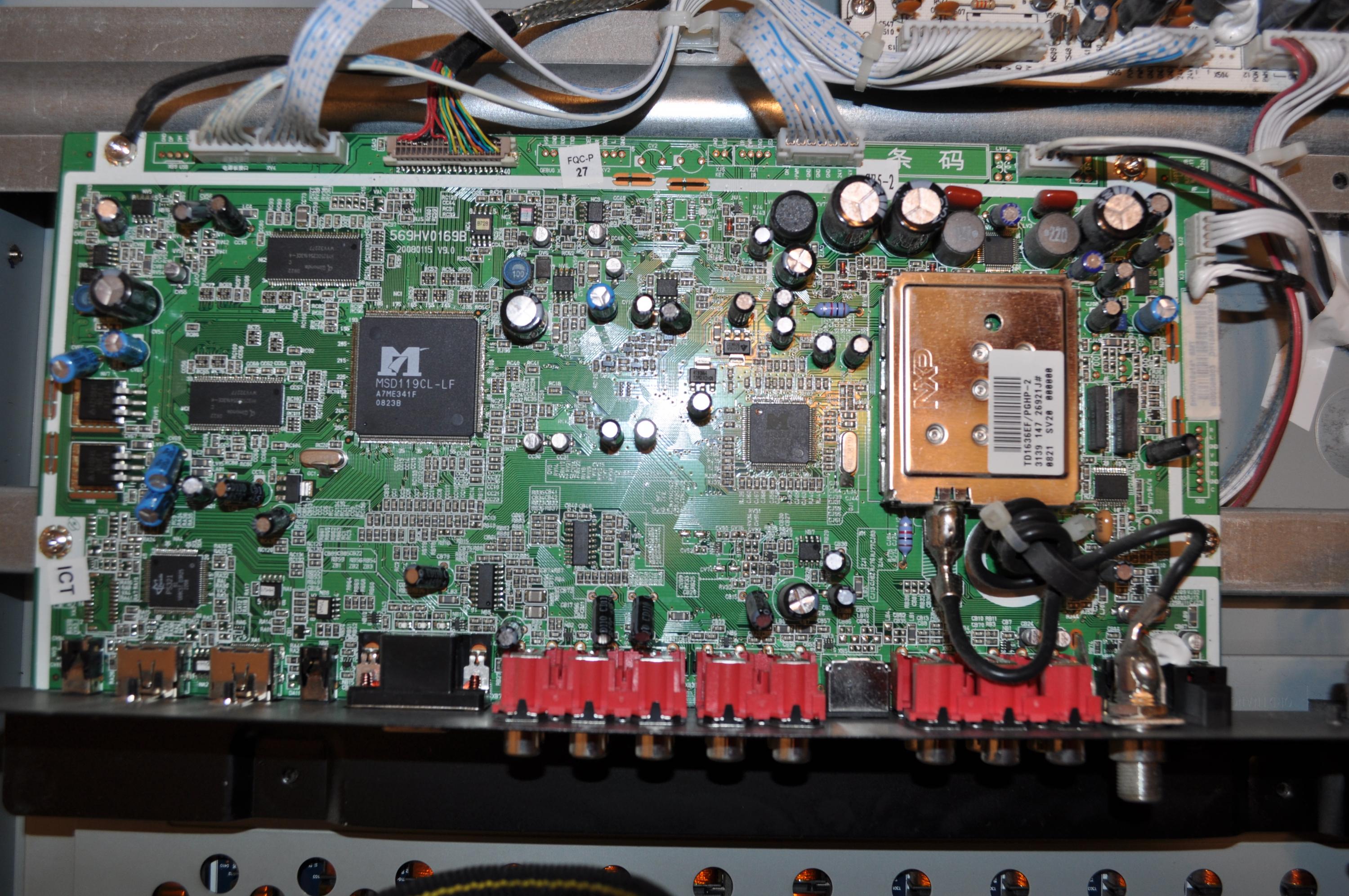

    I picked a freebie on this one. Tested Power Board and all appropriate voltages are present. There is no picture, the person I got it off of said it had sound but I am not really sure of that as I can not hook up a source to it. Any thoughts? Tcon? The power light on the front is Red and when I push the power button it turns green.
    Re: Dynex DX-LCD32-09 No Picture
    I went ahead and tested the test point on the tcon and here is what I get
    VDDA 8.20k 3.350v
    VDDD 7.03K 15.20v
    VGL 20.1k -6.2v
    VGH OL 20.94

      Holding a flashlight against the panel in a dark room, is there an image? If so, then you need to look at the backlight inverter. If there isn't, then you should check the other boards.
        There does not appear to be a picture
          So the backlights are not on?
          Pictures of the backlights Inverter board?

            I don't believe so, I can see no lights. I turned the set on green indicator light hit menu button since I do not have a source and can not see anything in a dark room with a flashlight.
              So we need to get the backlights to come on. Cannot do much until we see the pictures of the boards and all the voltage labellings on the connectors.

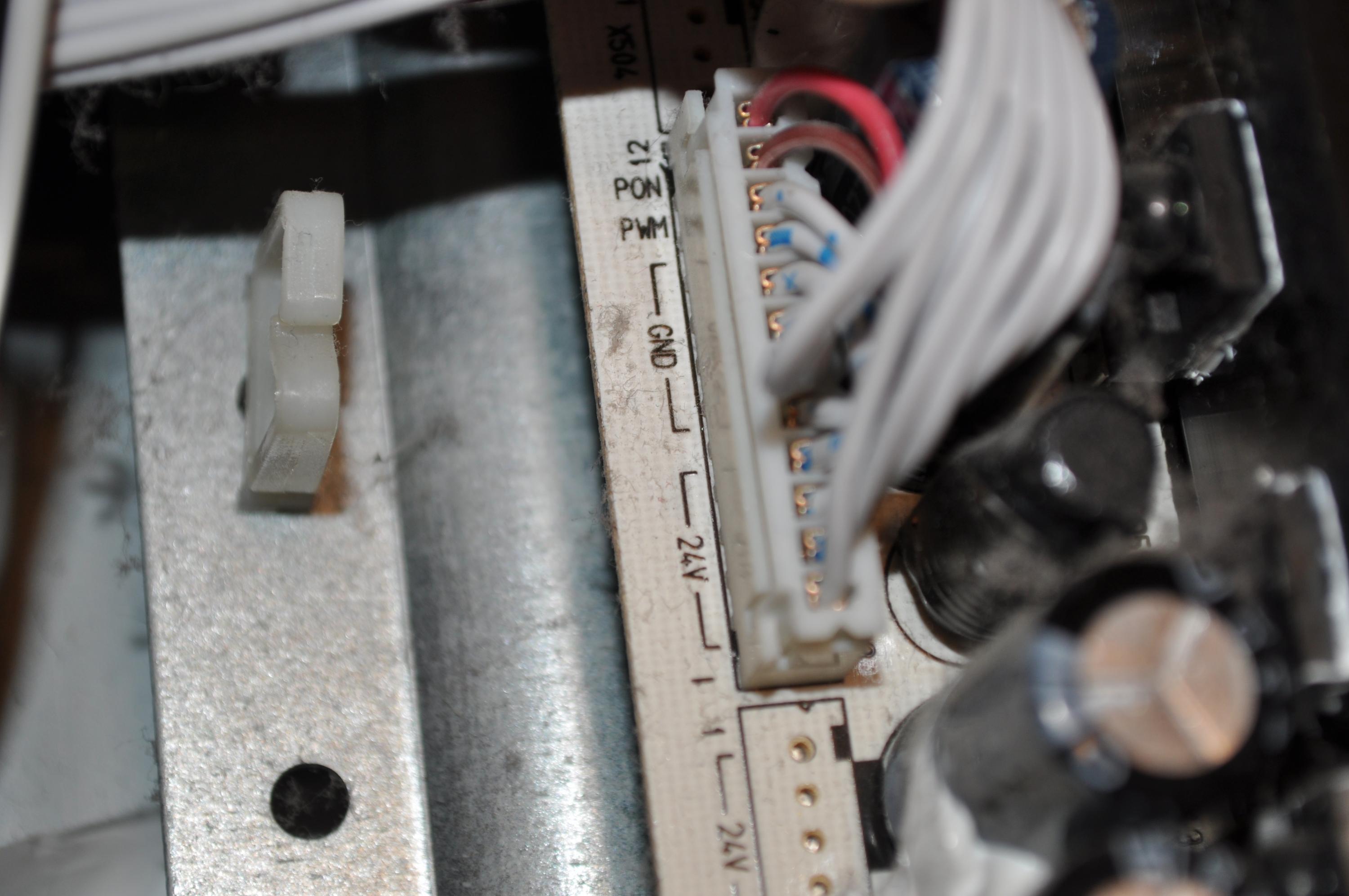

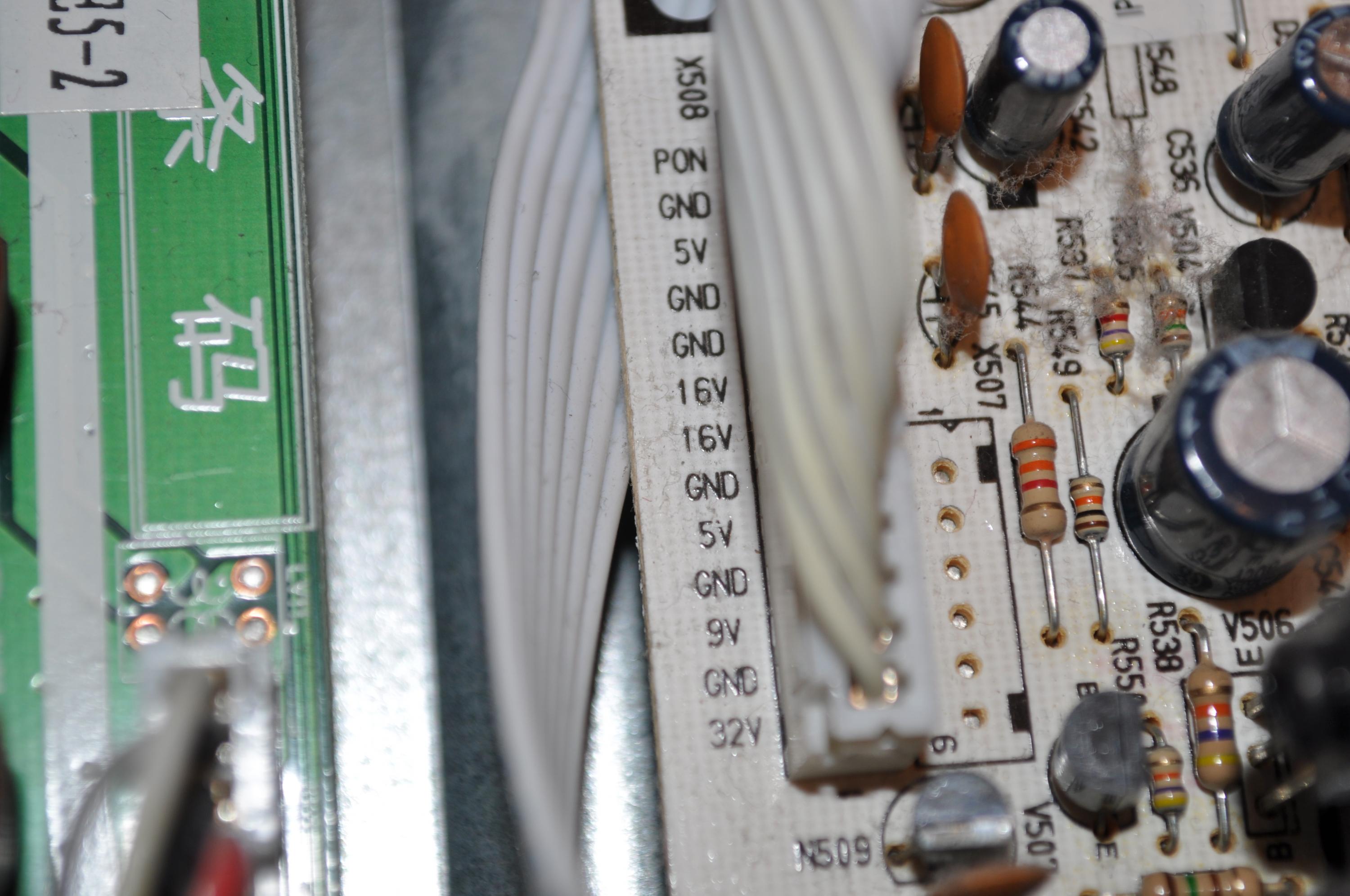

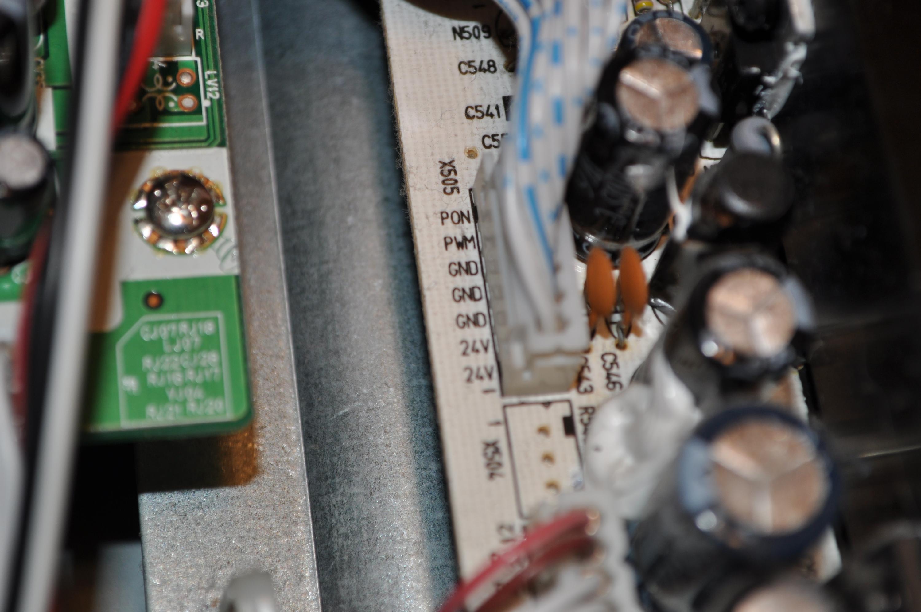

                From top of board to bottom
                PON 2.503
                GND
                5v 5.179
                G
                G
                16v 15.56
                16v 15.56
                G
                5v 5.108
                G
                9v 9.05
                G
                32v 32.35
                PON 4.827
                PWM 3.277
                G
                G
                G
                24v 23.93
                24v 23.93
                PON 4.826
                PWN 3.277
                G
                G
                G
                G
                G
                24 (5 of them all 23.93)
                  So the inverter board is getting the PON (BL_ON) of 4.827, and alos getting the needed 24v (23.93V) if I read the post correctly?
                  If that is the case, I will need good clear pictures of the inverter board.
                    Yes I believe the inverter is getting the proper voltages. I will post a pic of the inverter soon.
                      There are more than one version of this TV model, as you can see, there are more thna one type of inverter board.

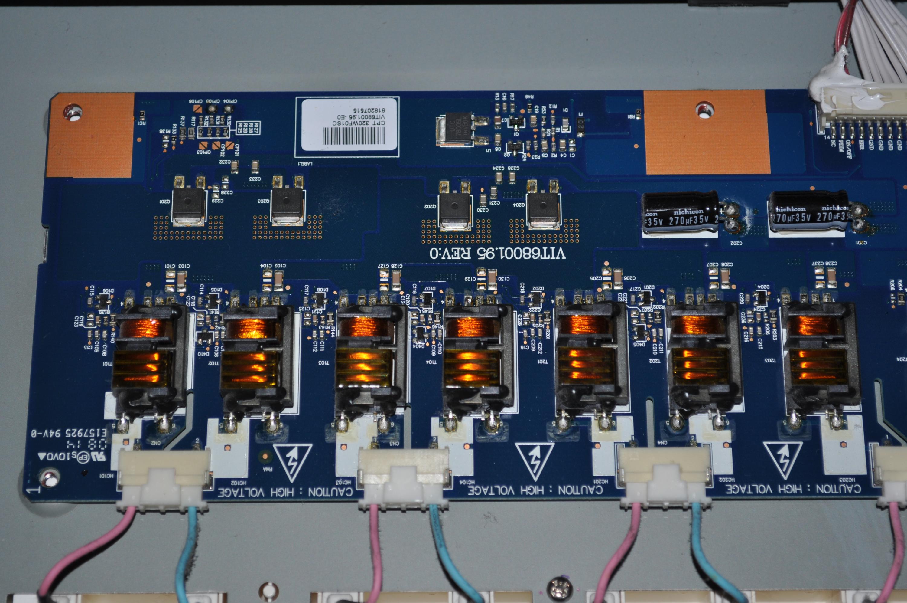

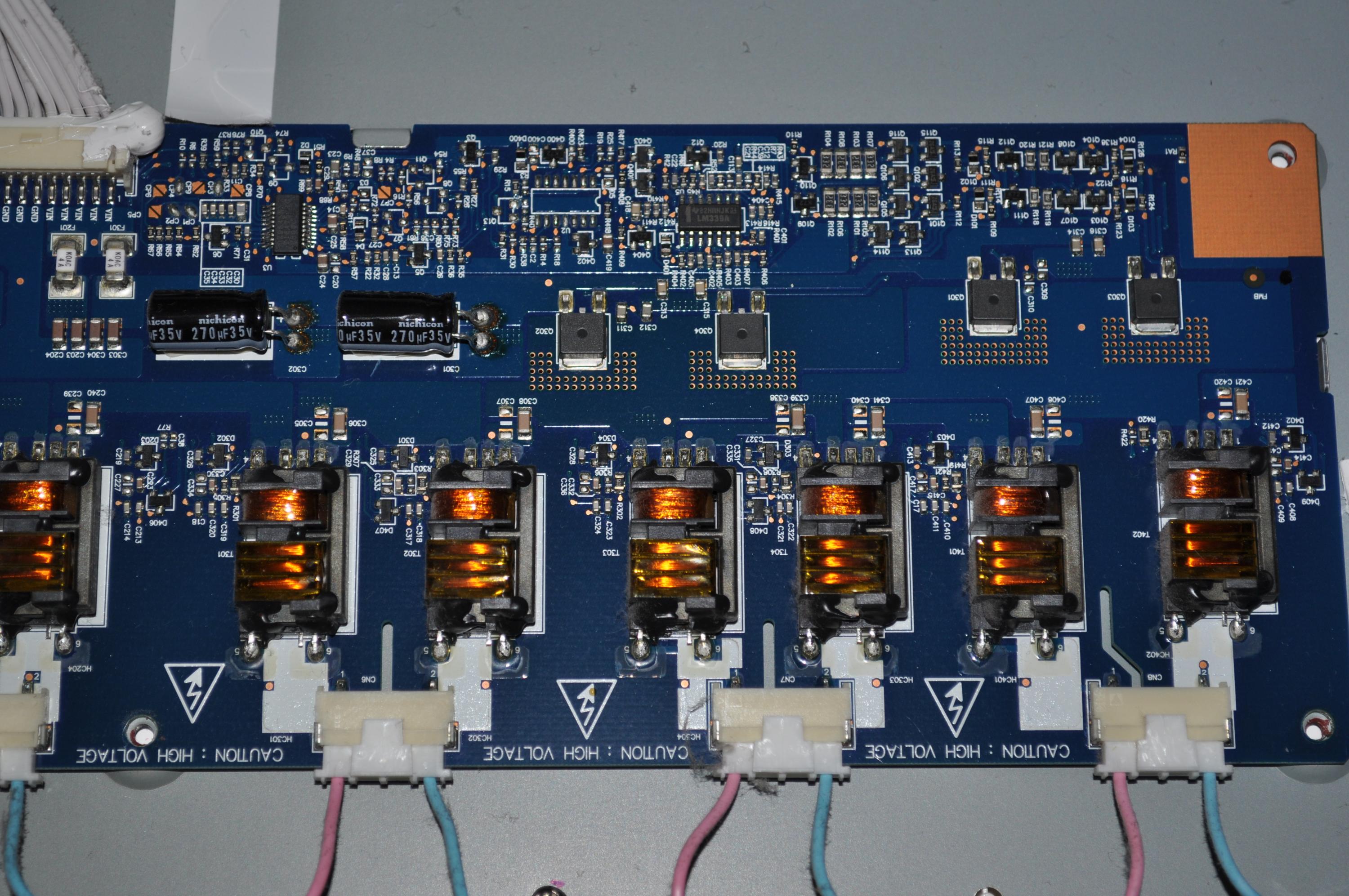

                        Here are the pics of the inverter board
                          Check the black F1 fuse with '20' on it, more likely to be blown.
                            I see a f201 ans a f301 but I'm not seing a F1 with a 20 on it although I may be blind and am just overlooking it.
                              Ok I did find it it is testing 15K ohms across the fuse. If i'm correct it should read 0 ohms?
                                F1 is bad. A good fuse should measure less than 1.0 ohms.

                                      Ok, I will give it a try. One last question. Is the 20 a reference to 20 amps or 20 ma? Digikey?
                                        I made a temp 1a fuse assembly and it appears the back lighting comes on. I have read you can solder the new fuse on top of the old one, is that recommended?
