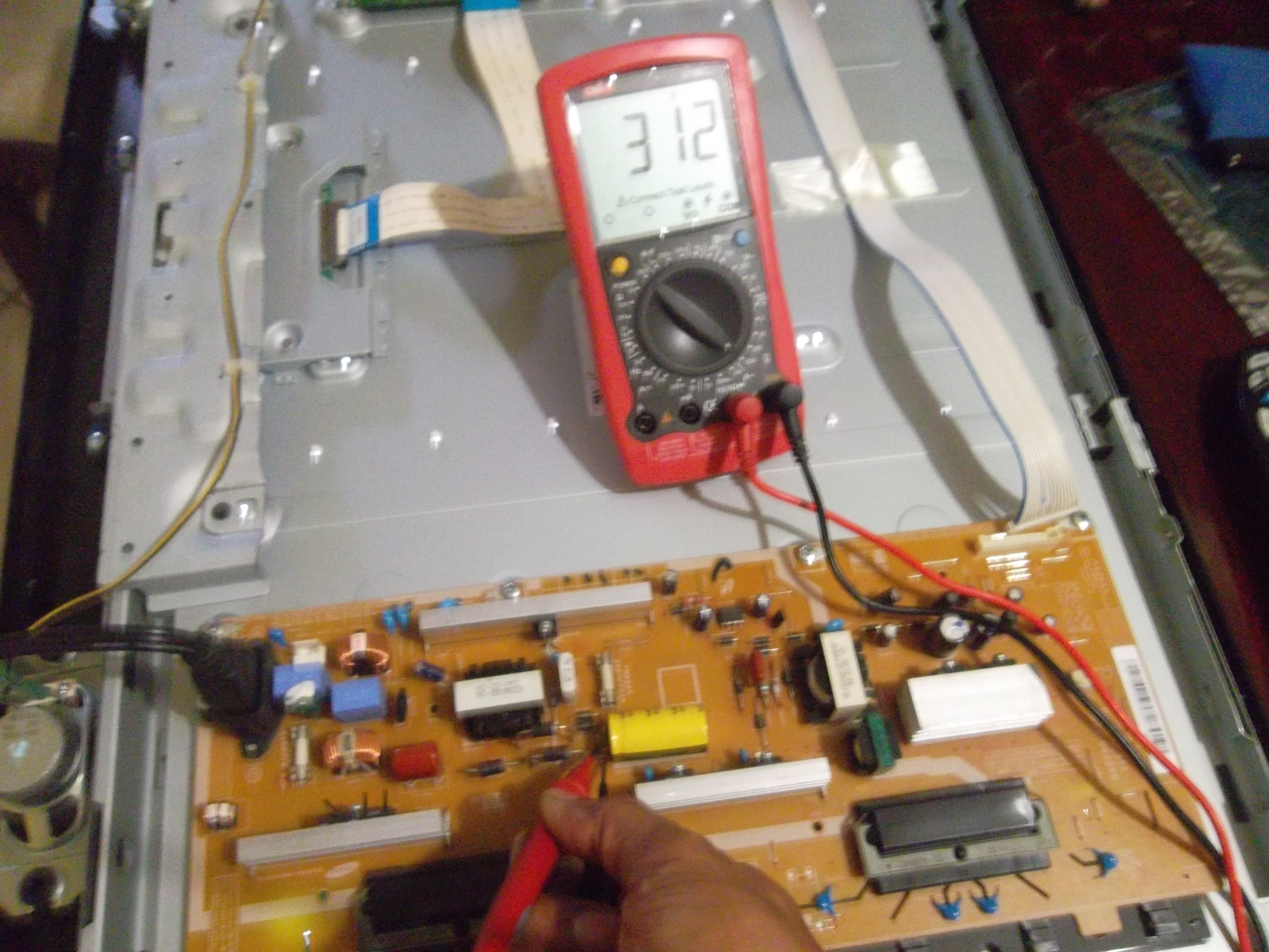

                                      Re: Samsung LN32B350F1 no video
                                      when the backlight is on the voltage at CP815 is 312v,did some soldering at CM852 and CM876 was checking the caps.

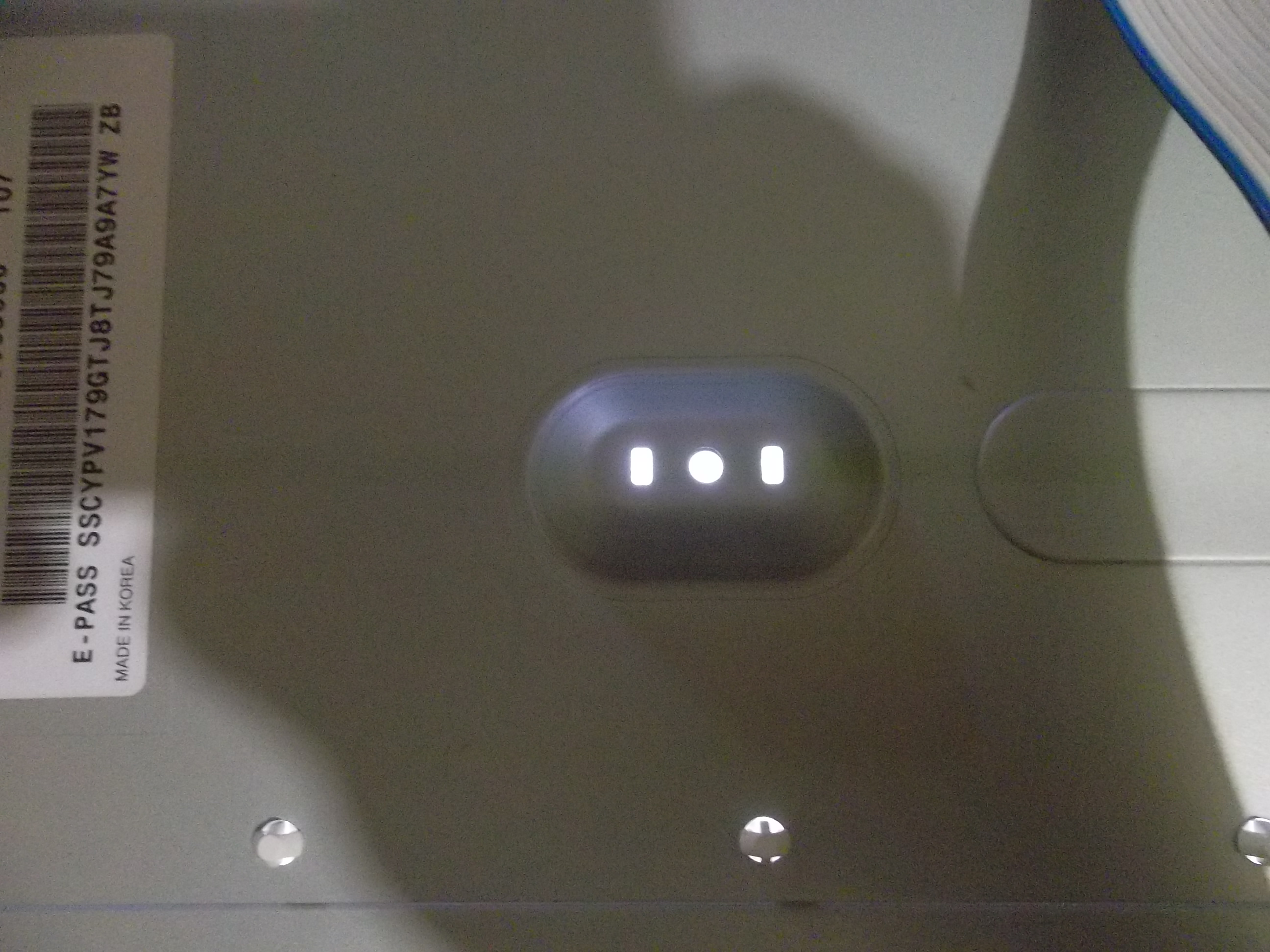

                                        look at the pics with the backlight on.
                                          #40
                                          The 312V is very marginal for the inverter circuit to work properly. Do you have capacitor meter to check the capacitance of that large cap since if the PFC not working, I expect the voltage on the cap to be at 230V (your country line voltage) x 1.414 = 325V but with very poor regulation due to failed PFC.
