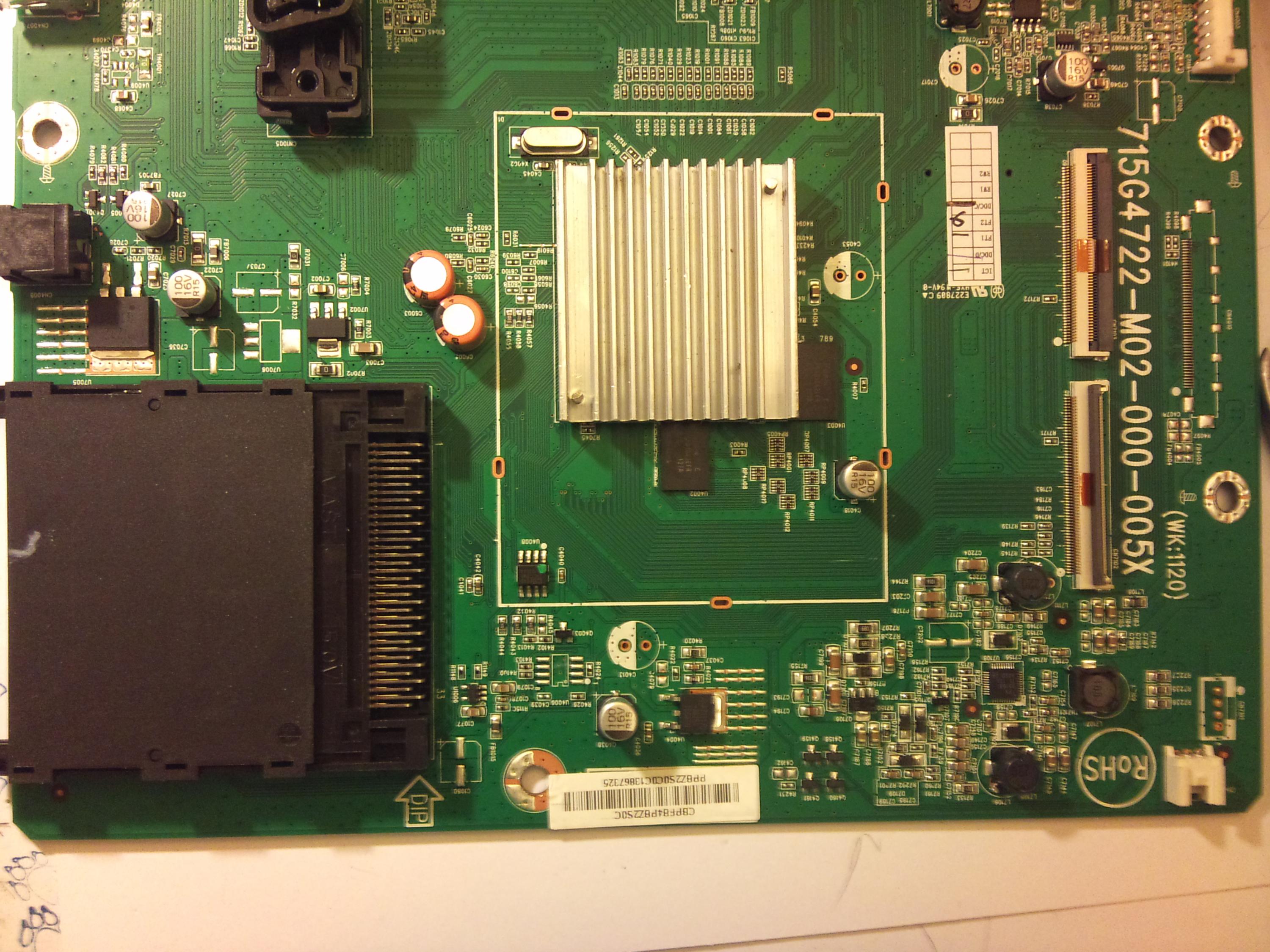

          I'm hearing some sort of coil noise (not hiss) on the logic board where there is the CapXon capacitor every time the image gets corrupted.
          (I don't know if there a way to embed a video here.)

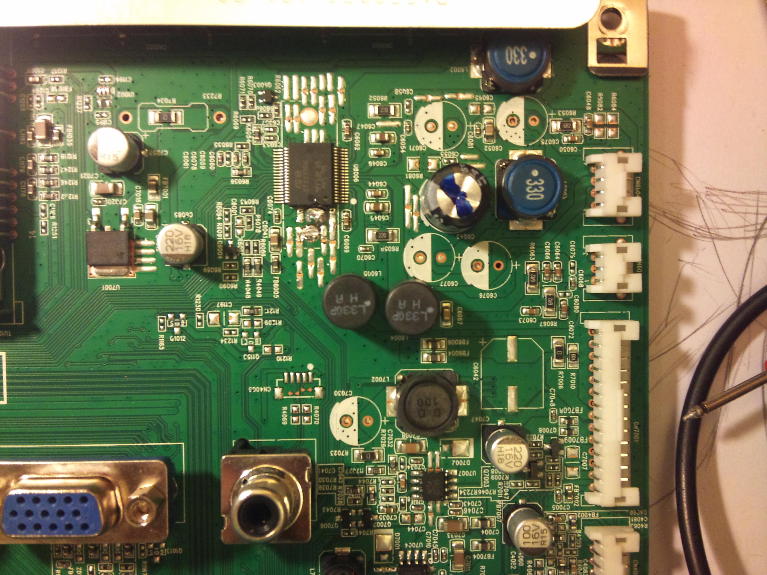

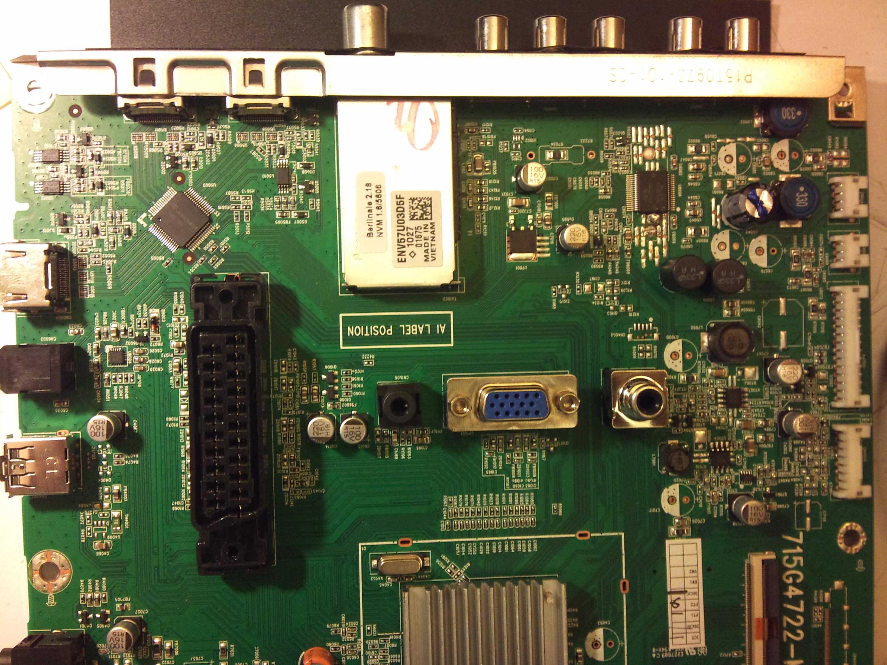

            Re: Philips 3PFL5606H/12 - good image for 3s / corrupted for 3s and so on
            Does the menu get corrupted too?
            Can we get a photo around the coil and CapXon capacitor?
              Yes everything gets corrupted, that photo is actually a test image from the menu.
              After looking closely, that CapXon capacitor seem to be part of the sound system so I doubt it has anything to do with the problem, but I'll take a picture of it and of the board.

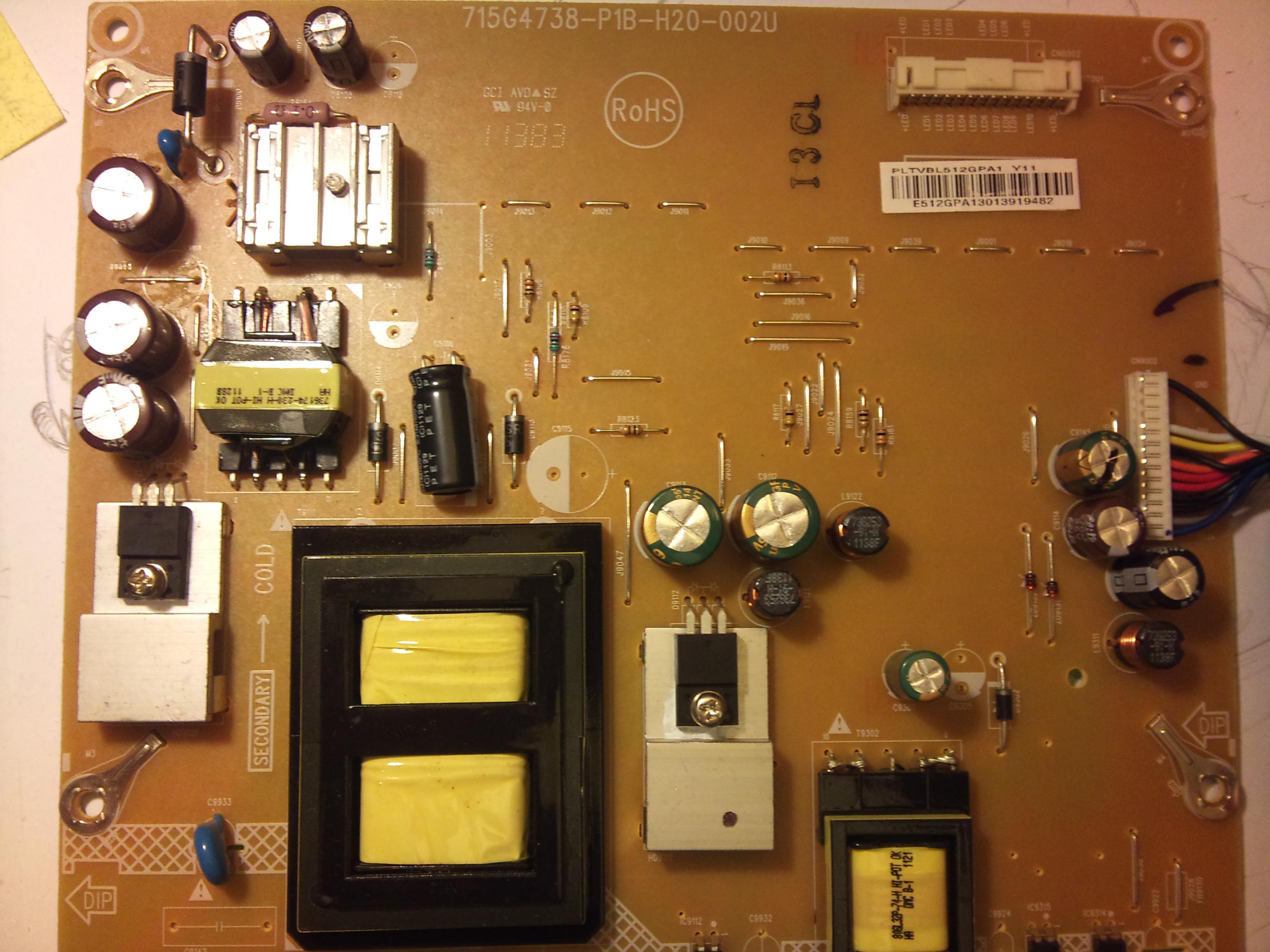

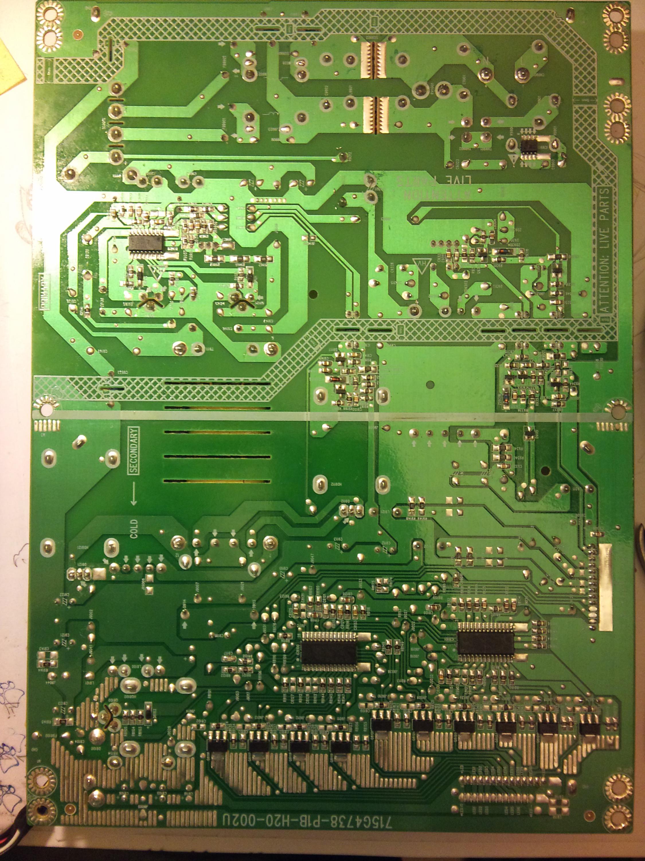

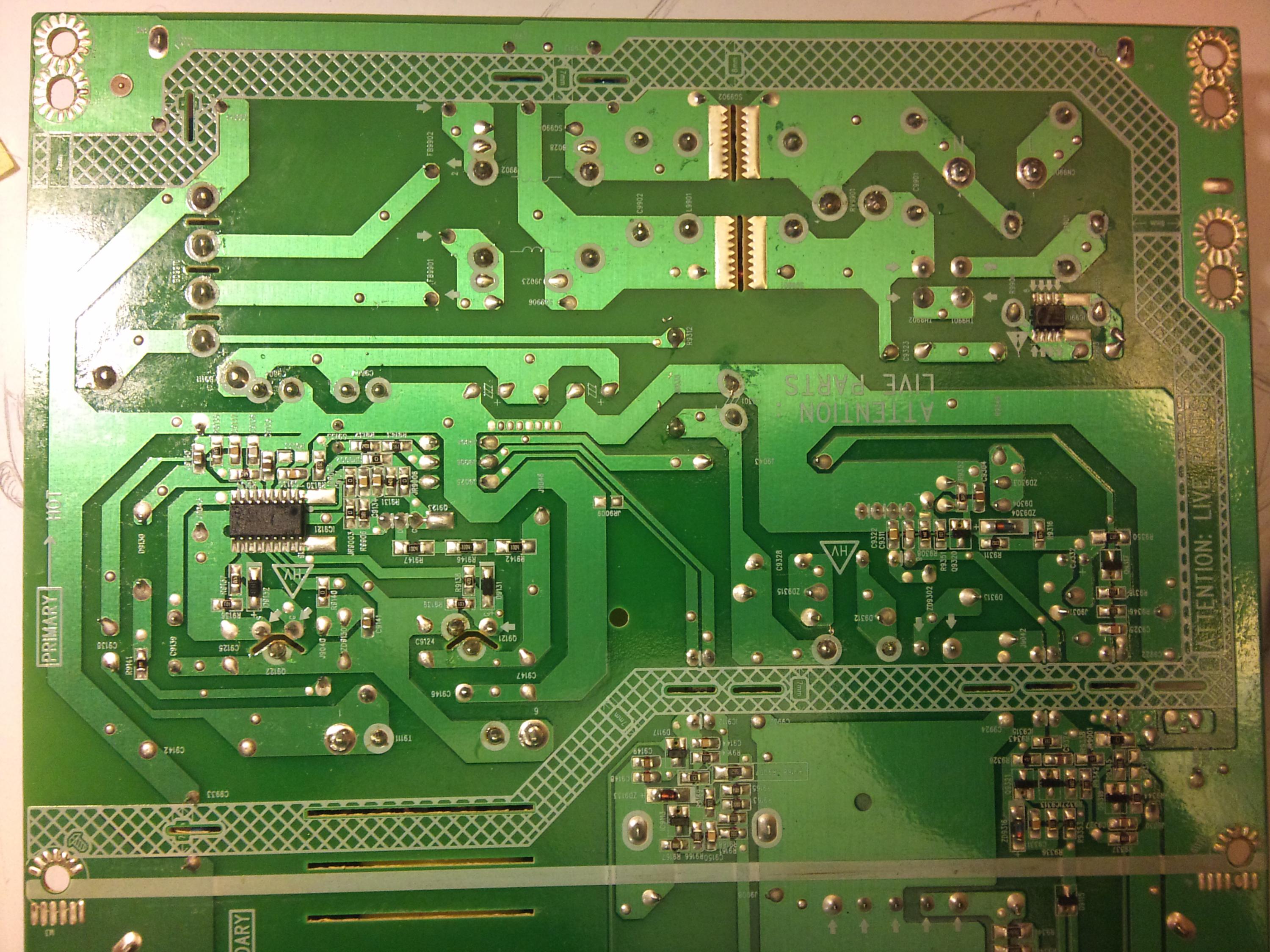

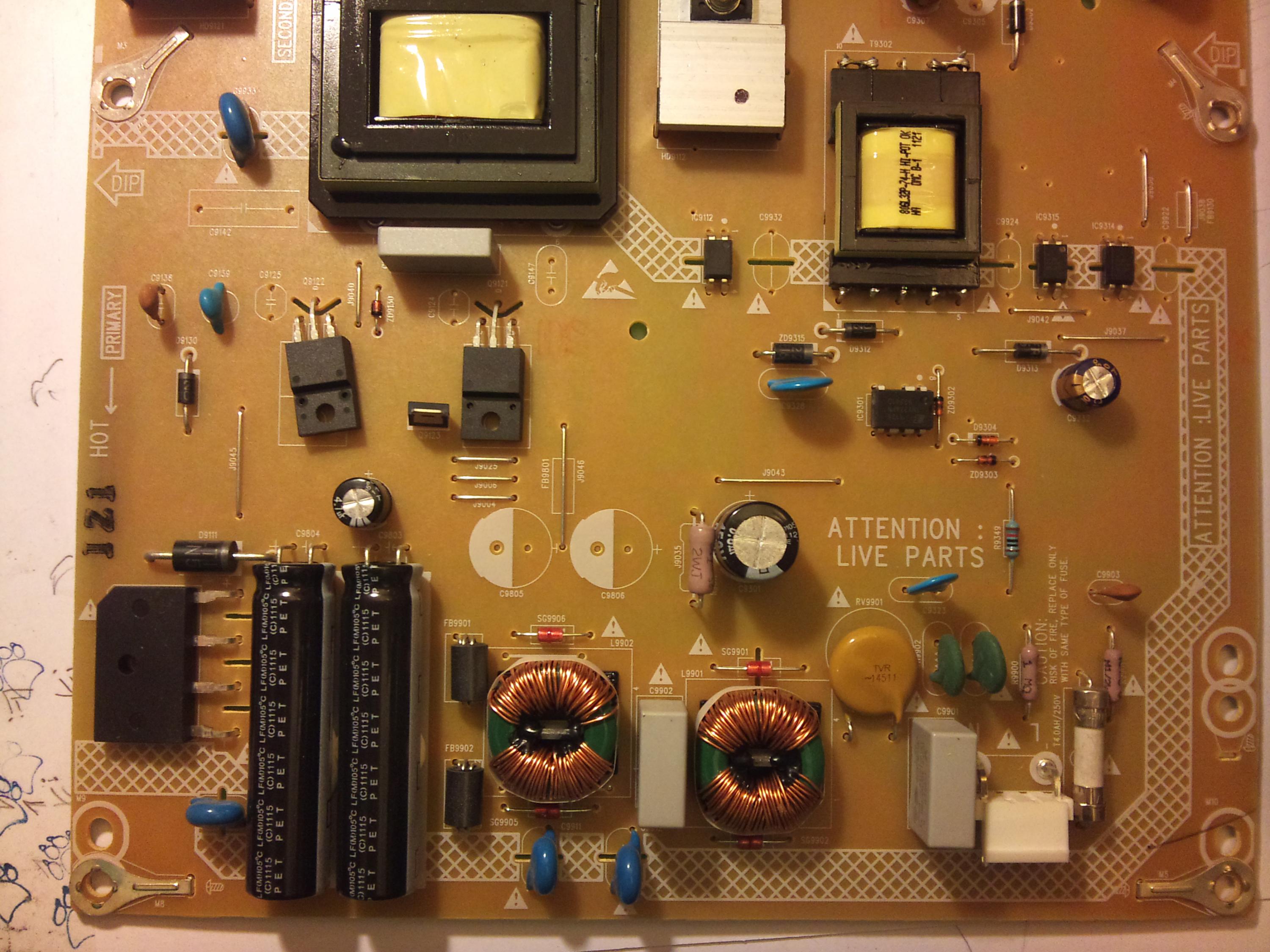

                  Here are the pictures.
                  I've just noticed something by the way, there is a fluctuation at the 12V pin where the harness of the PSU is plugged to the logic board (the two red wires) :
                  When the image is fine, I get 11.94V with my multimeter, and when the image is corrupted, it drops to 11.89V. It's a slight drop but it might be important.
                  So it could indeed be a problem from the power supply. But what could make the power drop so regularly ?
                  At the +12V voltage regulator, I get a drop from 11.98 to 11.94.
                    Ugh, this isn't a Philips TV. I mean, it has the badge. But it's just a Unihan OEM.
                    Check the 5V line too. Maybe that is dropping by too much.

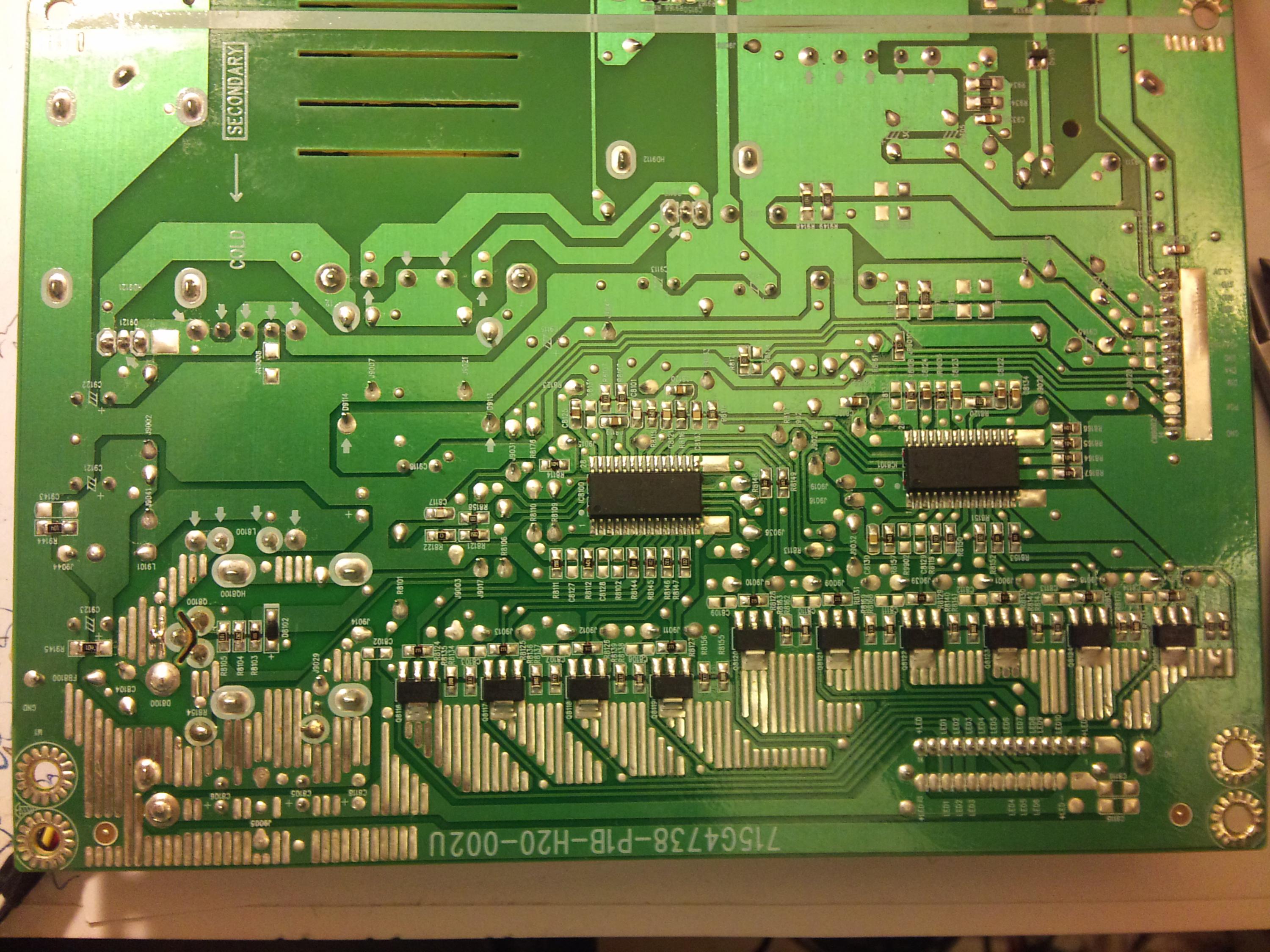

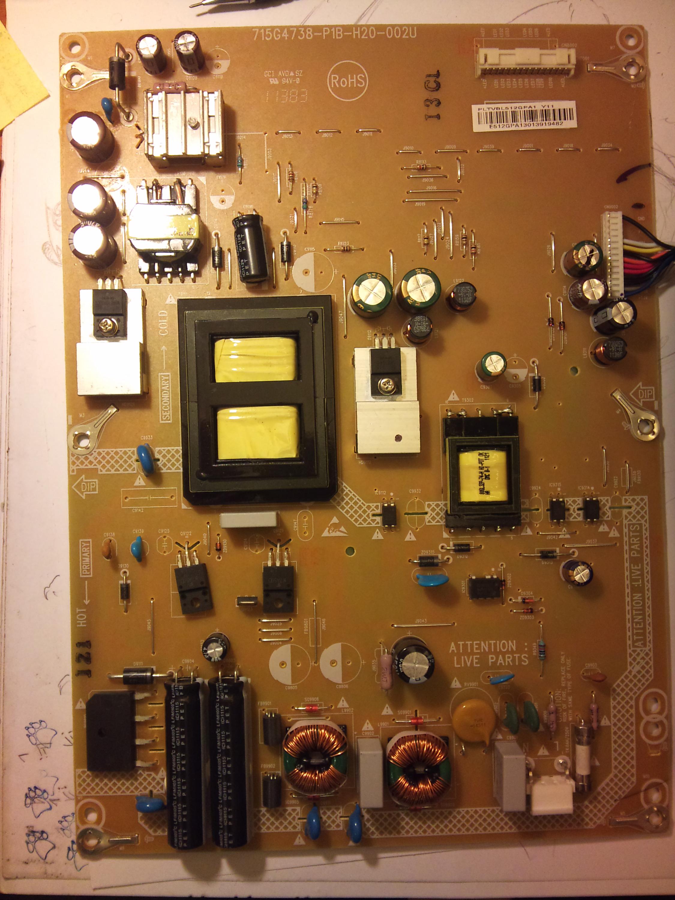

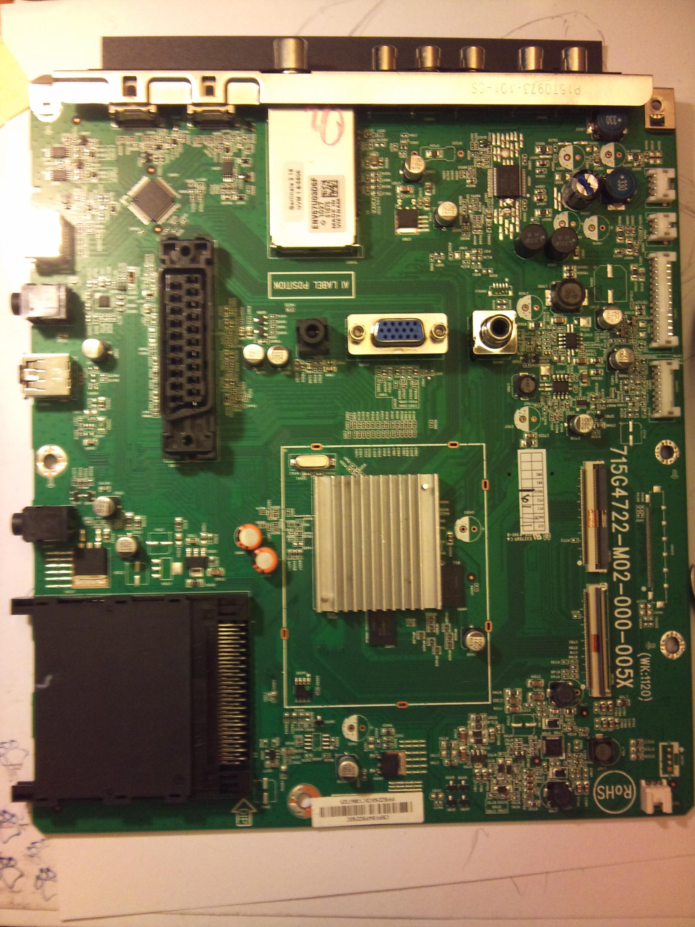

                          Pictures of the T-CON? What are the voltage labels on that connector of the power supply board to the main board? Not all the pins are used so it may not have 5v stby, but it may use 3.3V stby instead.
                          • SuperDuty
                            • Mar 2011
                            • 299
                            • France
                            The T-CON board, you mean the one that controls the LCD panel ? As far as I can see, there are only two small boards for left and right display under the panel. So there's no other board than the two I've shown above.
                            If there were a problem with one of the LCD panel boards, I doubt I'd get a problem on the whole screen since each one of them are for one half of the panel if I understand correctly.
                              Ok here are the labels of the connector on the PSU board :
                              +3.3V - blue wire
                              STB - grey wire
                              GND - black
                              GND - black
                              +12V - red
                              +12V - red
                              +24Vsnd - orange
                              GND - black
                              ENA - yellow (mesuring 4.91V stable)
                              DIM - white (mesuring 2.94V stable)
                              POK - three empty slots
                              GND - black
                              I can't update the firmware...I need the remote to start it...that's stupid cause I can move into the menu with the buttons in front of the screen, but not for the firmware update :/
                              I'm getting very unstable voltages at the Q9121 and Q9122, not sure what I'm supposed to get there.
                                        I've made some further tests and found the slight coil noise wasn't coming from the area around the CapXon cap, but on the opposite side, on the lower right of the 9th picture.
                                        I've noticed huge losses of power on the D7106 and D7107 diodes (just above the small mosfet), going from 22.2V when the picture is good, to 14.8V when it goes bad.
                                        And the power increases on the small inductor (L7105, the one at the very bottom of the picture) from 1.70V with the good image to a 2.60~2.80V range when it goes bad.
                                        All of this is located around the TI TPS65168 IC : http://www.ti.com/product/tps65168#technicaldocuments
                                        High Resolution, Fully Programmable LCD Bias IC For TV
                                        The TPS65168 provides a simple and economic power supply solution for a wide variety of LCD bias applications. The device provides all supply rails needed by a TFT-LCD panel. VI/O, VCORE and RST for the T-Con. VDD and HVDD for the Source Driver and the Gamma Buffer. VGH and VGL for the Gate Driver or the Level Shifter. The VGH voltage can be compensated for low and high adjustable temperatures, if GIP technology is used. The transition from one programmed VGH value to another is made using an external thermistor connected to the IC. All output rails and delay times are programmable by a Two-Wire interface: a single BOM can cover several panel types and sizes whose desired output levels can be programmed in production and stored in a non-volatile memory embedded into the TPS65168.
