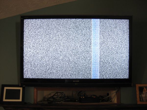

    Well, I'm going to continue working on the 47" Toshiba I picked up last week but in the mean time I saw this on Craigslist just now. May be able to pick it up for under $100. The listing says the picture can be seen through the line. It would appear that way in the photo although they took it with only static on the screen. Anyone seen a Sharp with this symtom? Its an Aquos 120Hz LCD.

    Re: Sharp LC52D85U with vertical line in the middle of the screen
    After reading some other posts I'm thinking maybe tab bond on the panel, but if the actual panel is bad I'm certainly going to pass.
      $75 is too much for that IMO with bad panel being a possibility.
        Thanks Tom. I'll steer clear then. Was hoping it might be something simple since the picture was still visible.
        Just trying to learn.
          Any time you see a regional defect (one bar/line/etc in middle of panel) it is almost always a panel fault, because the other parts work on the panel as a whole, half or quarter and defects are usually consistent in those areas.
            I've repaired a few of these now but they were all power supply or main board issues. Certainly makes sense that if most of the screen is working than the fault lies in the screen itself. I'll keep that in mind from now on.
